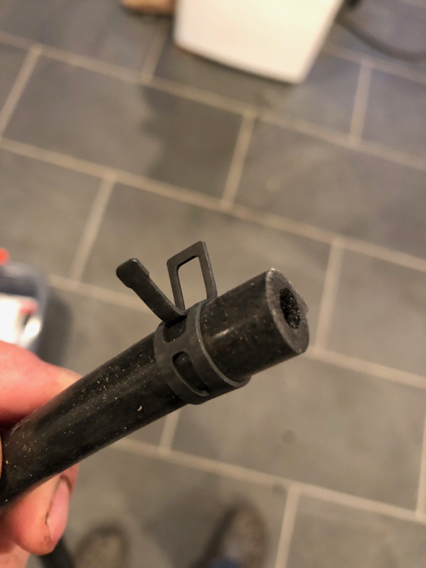

Damn I need to take control of my OCD. I’ve been on a quest for an OEM hose clamp that will work in the 6mm silicone vacuum hose. Finally have them coming in

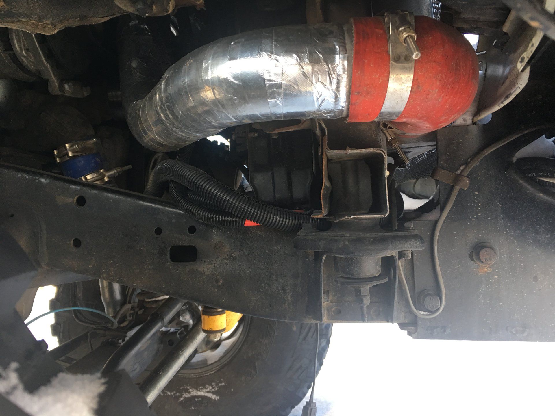

Yea, but my engines intake is on the driver side so I doubt I would route it the same with the 1FZ. Having dual batteries makes it more challenging. My plumbing is ugly after last summer I finally wrapped most all of it in heat tape to delay/prevent the heat soak.
Pass wheel well, driver wheel well, bay layout:
I used all 3" piping and 3" inlet/outlet IC which is overkill for this kit. Using 2.25" would make the job easier and still be plenty big and not restrict air flow. I can see using a FMIC setup like this where the in/outlet is kept on the passenger side.
