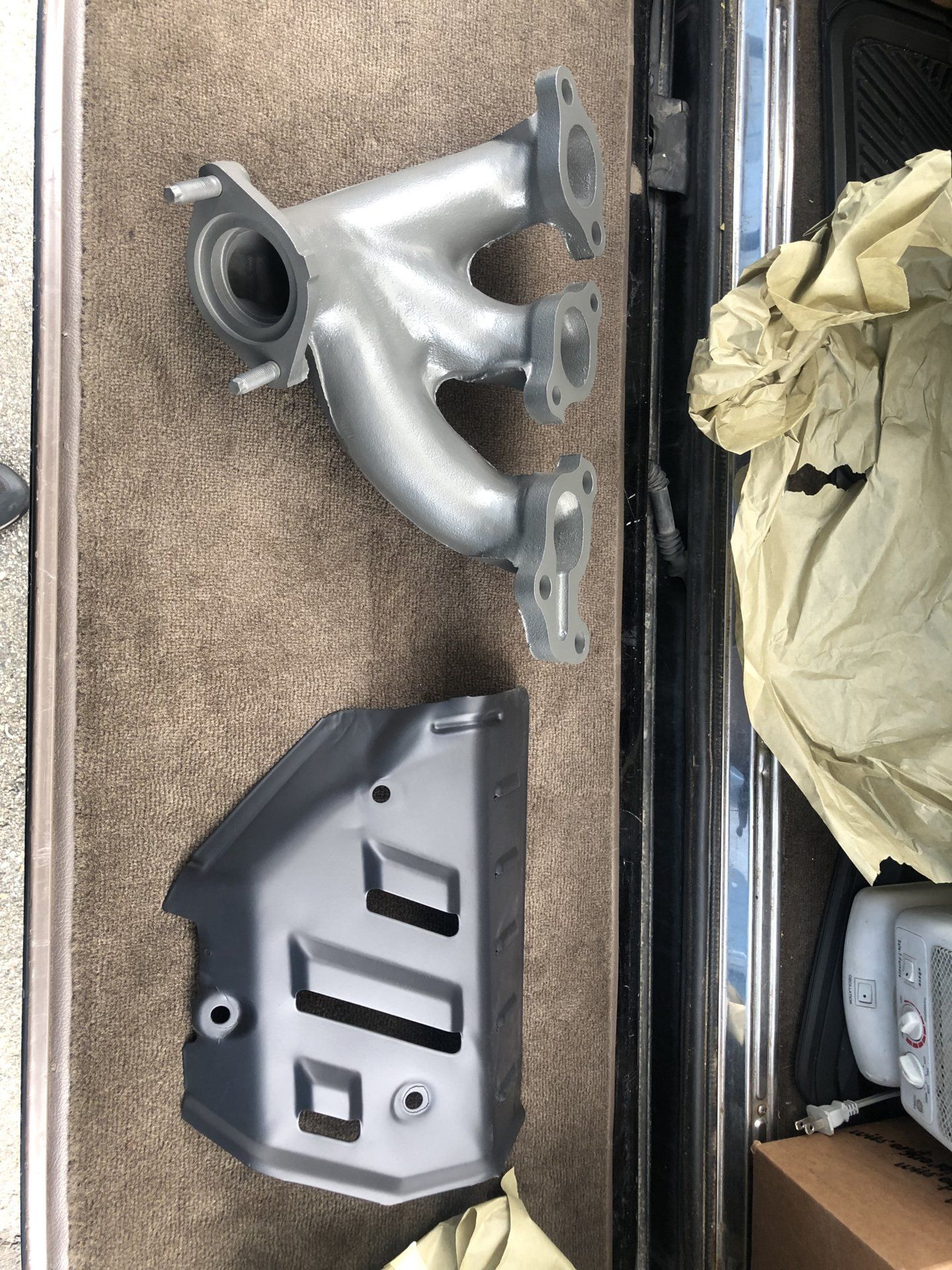

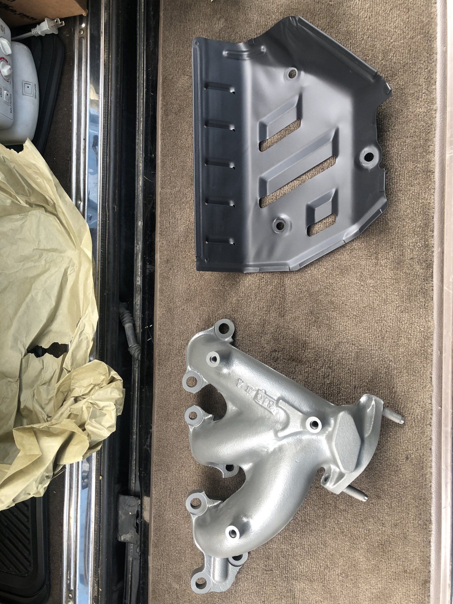

I had the luxury of having a parts cruiser sitting in my driveway. Which meant I could pull stuff, clean them up, & ceramic coat, with having my LX450 down for any real period of time.
I took the exhaust manifolds & heat shields & made them pretty.
Claim is 20% heat reduction. I’m skeptical of that, but they do look great.
I’ll have to do some research & see what else to look nice & colors, before the turbo is ready.
1903204
1903205
View attachment 1903204View attachment 1903205
Exact thing/color I did. Very happy with results.
