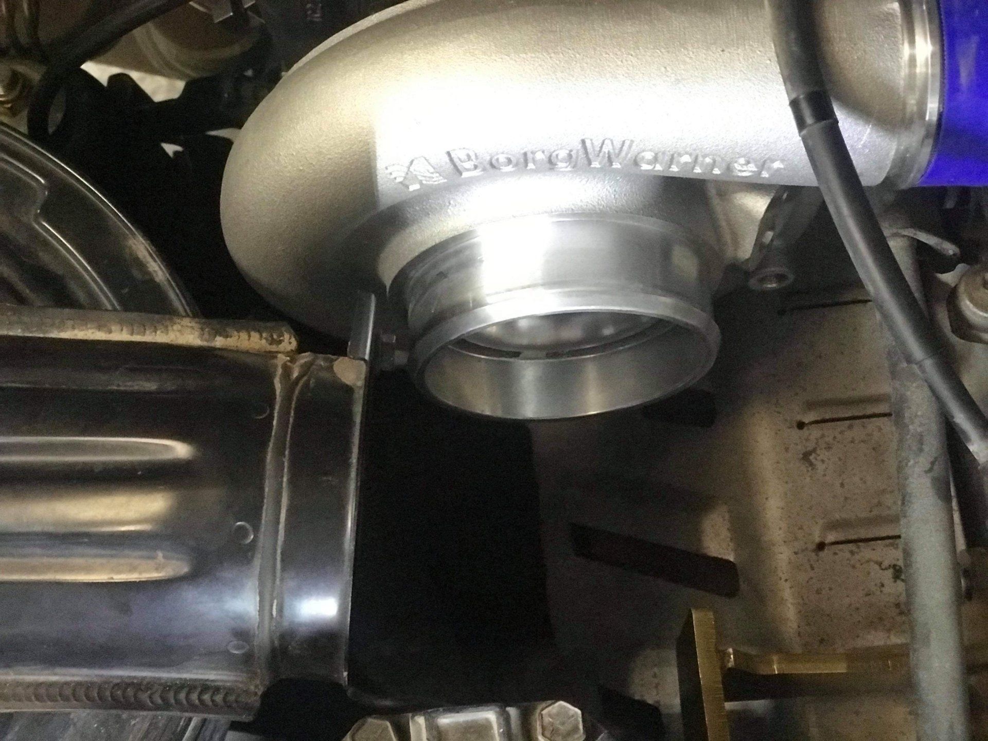

No you really don’t want to put the MAF in a bend we already looked at that.
A single custom piece from the air cleaner top straight to a 90 to the inlet, with the MAF in the middle, would be tits.
Are you saying take the lid of the air cleaner apart? Create a new custom piece that would have to be welded back into the lid? If so beyond the scope of "bolt on" turbo kit. But yes could be done.
No, MAF in the straight part, before the bend.
Bolt-on is way different than cut-to-fit and paint-to-match. Two totally different approaches.
