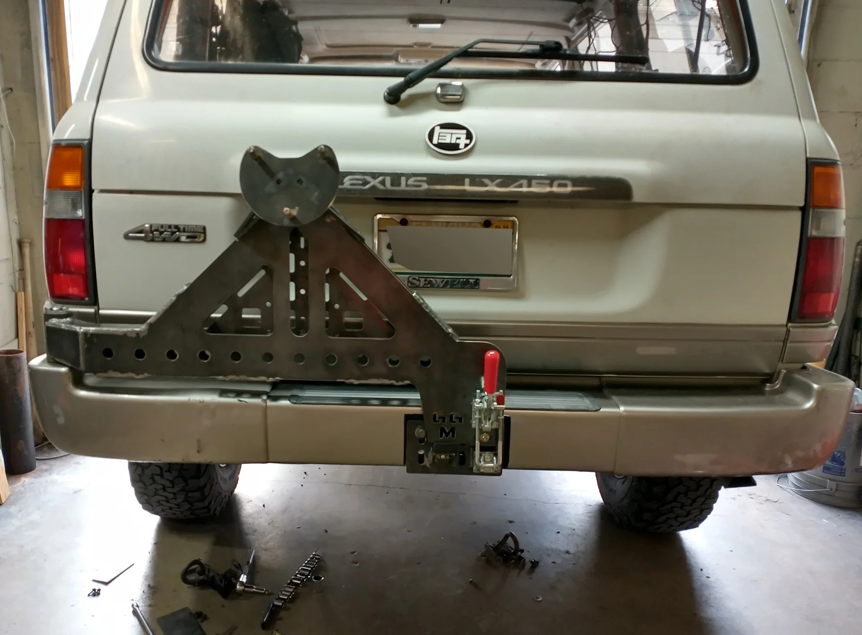

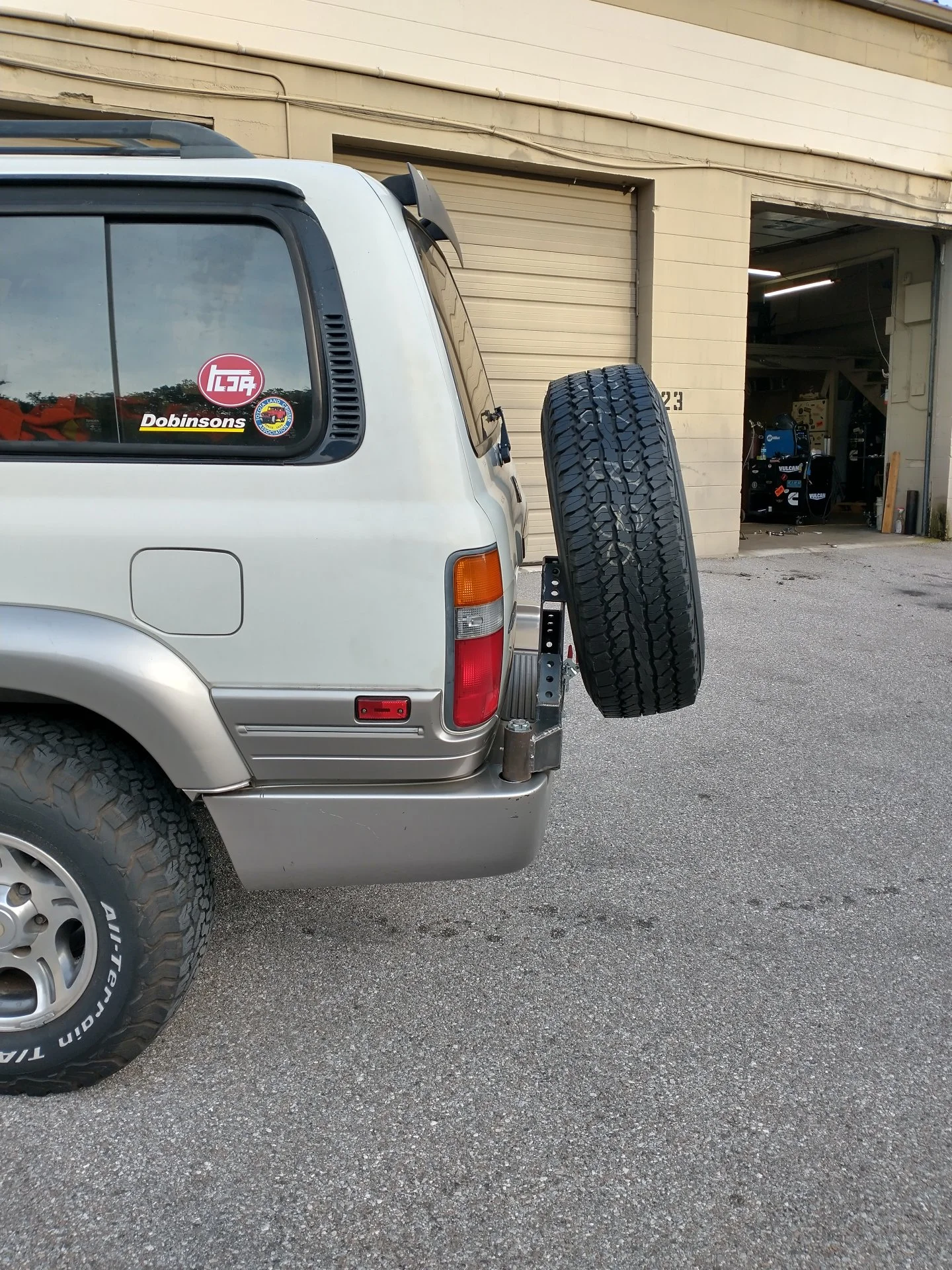

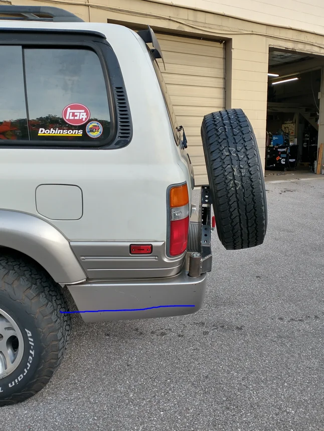

Install was pretty straight forward. I wish I did a better job of cutting the corner to fit the bumper cap. I think I took off more than I needed in areas that didn’t need to be cut and left too much in spots that needed more cutting. You can see in the picture my bumper cap is at an angle and I assume this is because it’s still hitting the corner. I ordered the limit linkage today and will need to remove my bumper cap again for this anyways so maybe I’ll get it cut properly while I’m in there this time. For those ordering now I believe Matt makes this cut for you.
You will also see where once installed my gf immediately let it swing open and damage the body of the cruiser. Be careful these things are heavy. She helped with the entire install and many other cruiser installs as she’s an engineer so I can’t be too upset, sigh. Limit linkage install should fix this from happening in the future.

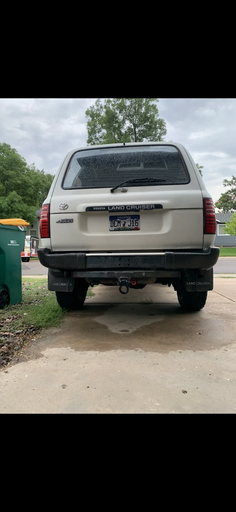

Here’s what I did to refresh the backend. I removed the spare and tow hitch from underneath, painted the plastic corner bumper caps, mud flaps and metal bumper cap in the middle with black raptor liner. My girlfriend used a paint pen to redo the LandCruiser lettering. I am really pleased and it all came together thanks to the carrier.

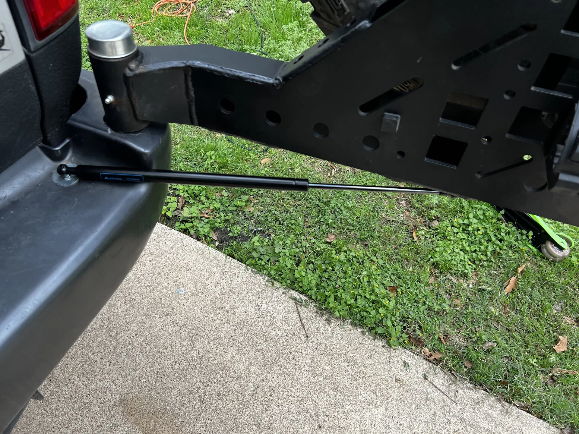

figured it out myself. Strut I had is too long and wants to keep it rotating out and thus contacts plastic bumper. Testing a 20” strut in the near future. I used an online calculator to get my placement window then bolted it through the bumper metal and put another ball connector on the bottom side of swing out. Pics attached

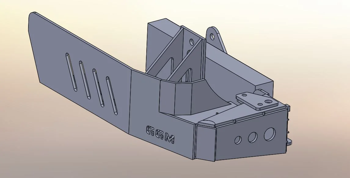

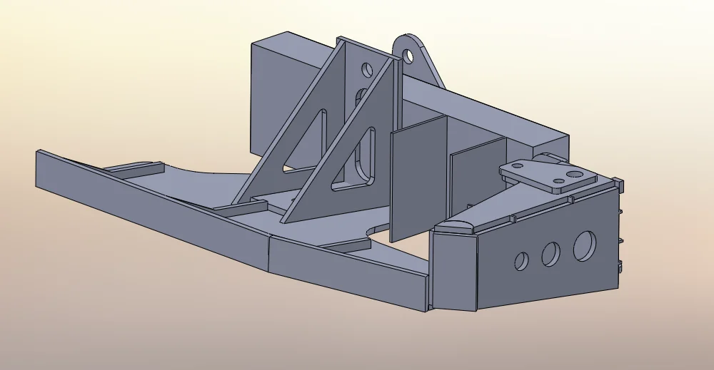

I'm working on a couple different concepts for the "corner armor" all of which will work with the tire carriers already out in the world. Right now I have 3 different ideas and want to hear some of your feedback.
Idea 1: Corner armor completely replace the bumper plastic and integrates with the existing frame mount. This would be the middle of the road on cost and weight. pictured without the spindle.
idea 2: Full corner replacement. This is essentially a bumper but without the long piece going across the truck. it would gain more clearance than idea 1 and be the strongest and most protection while also strengthening the tire carrier. It also will be the most expensive and heaviest of the current ideas. I don't have a great model to take a picture of yet but it would look similar to above but gain about 1.5 to 2 inches of clearance. It would replace the frame mount for a 1 piece unit.
Idea 3: Reuse the frame mount and plastic but trim the bottom of the plastic to gain clearance and add a plate to the bottom that would protect the corner if you drop into a hole/rock. This would go along with the theme of keeping the stock look but add the protection needed all while staying mostly light. This option would be the cheapest and lightest of the three. It could look something like this underneath the plastic.
The plastic would be cut levelish with the frame, something like this
What are your thoughts/preferences??

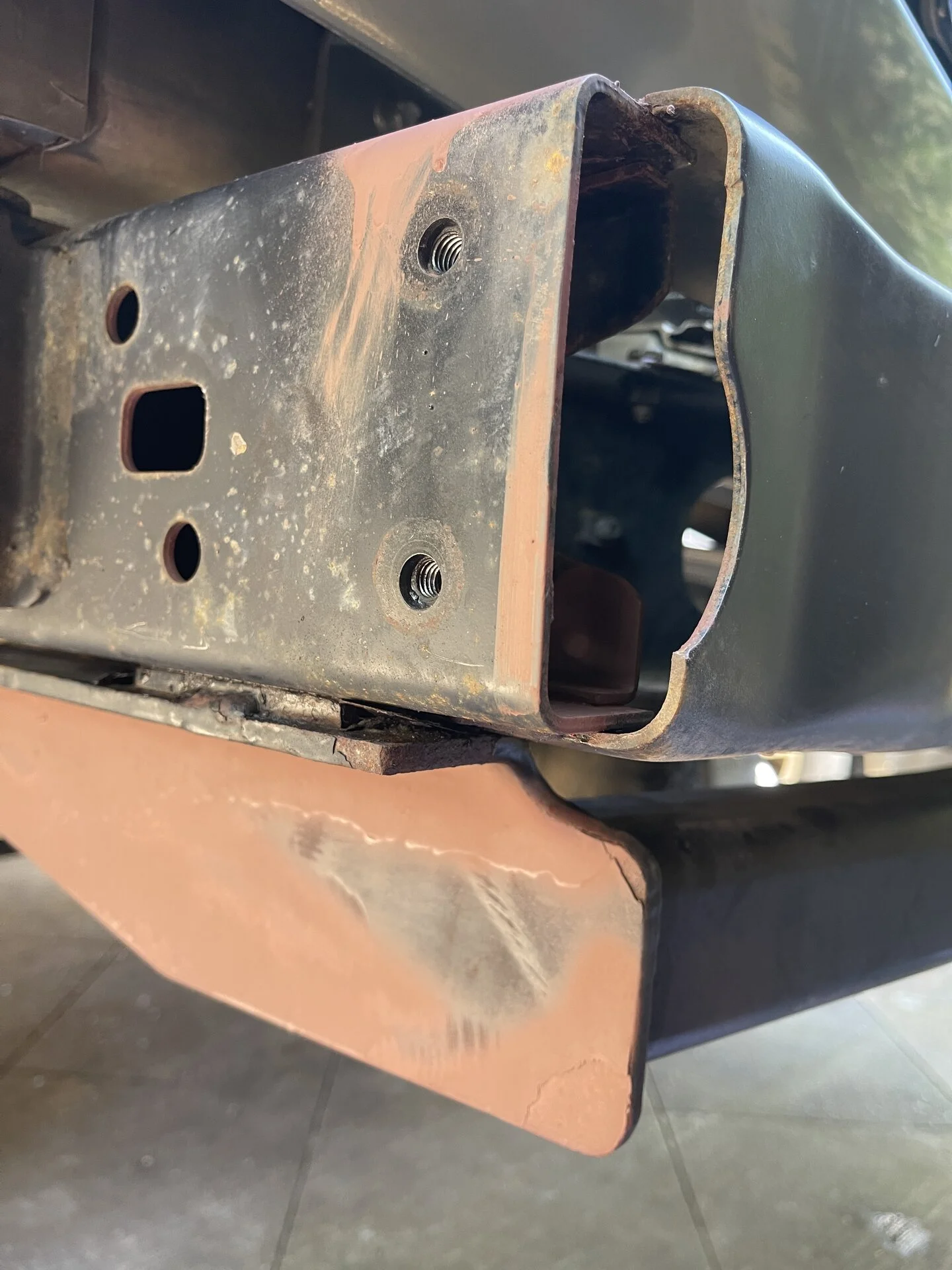

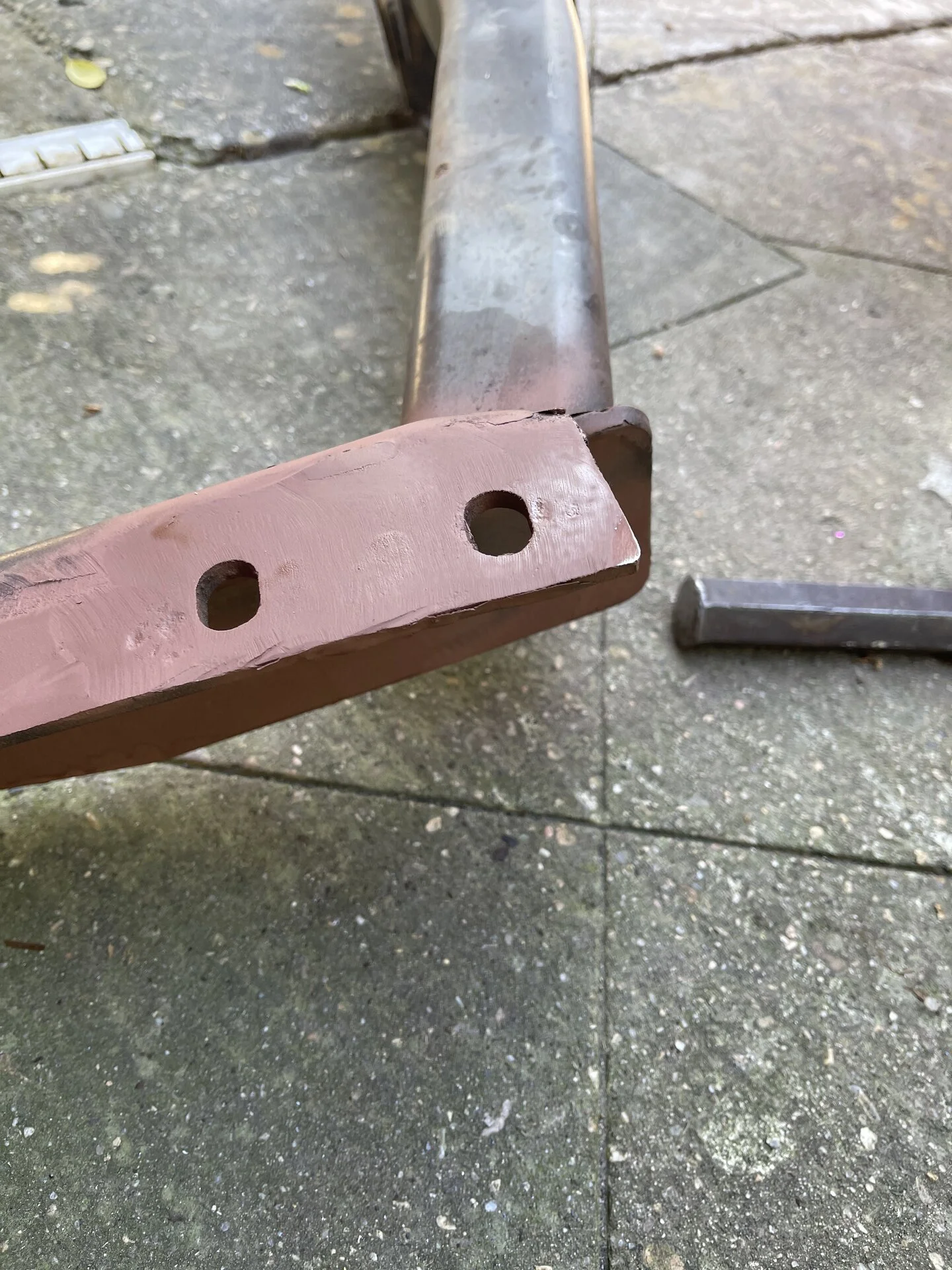

Just a heads up on my install. I have a 97 40th, original owner so it came from dealer with the Valley brand hitch on back. I have seen many 80's with same brand. When I went to attach spindle it was too low and holes didnt match. There is spacers welded to the hitch bracket (2 on each side). I had to remove hitch assembly, grind the one spacer off prep and paint and install the spindle under frame. The width of spindle piece that tow hooks mount to, is sandwiched between frame and tow assembly and luckily was same thickness of spacer I removed. Everything lined up and was perfect. Just passing this along in case someone else needs it.

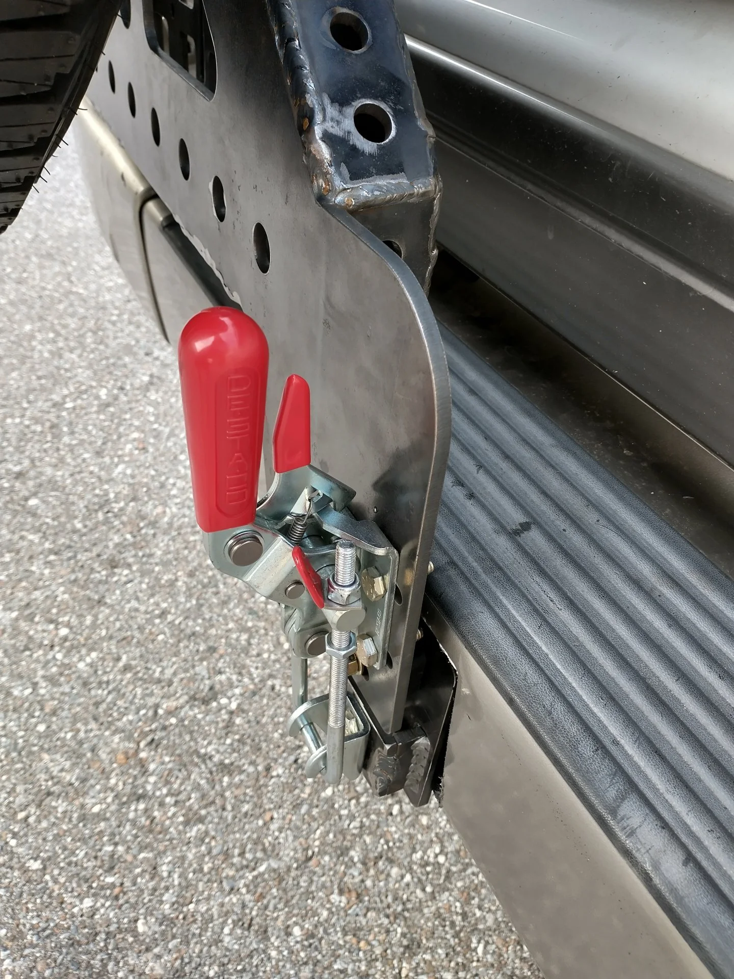

For those that need a spare tire carrier but don't want to spend thousands on a new bumper, here's the solution. These pictures are of the first prototype, minor changes may be made.
View attachment 3131566View attachment 3131567View attachment 3131568View attachment 3131579
This kit is mostly bolt on, a hole will need to be drilled through the bumper plastic and some of the plastic on the middle of LX models (as shown). There are also 2 threaded holes on the frame of 93-97 models that were used. 91 and 92 model years will require a bracket to be cut off the frame and 2 holes to be drilled. NO WELDING NECESSARY.

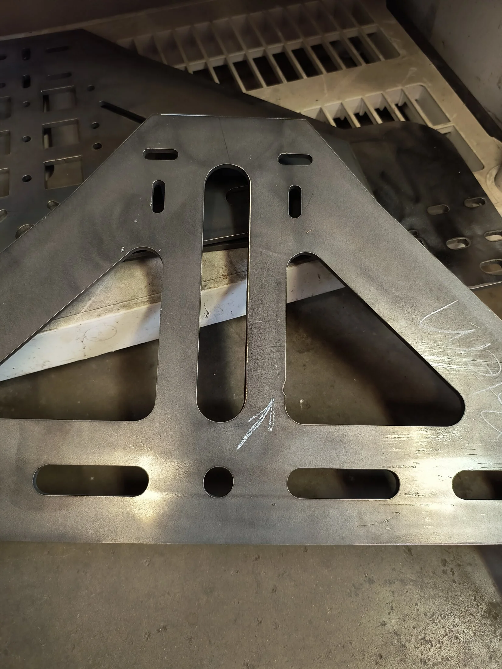

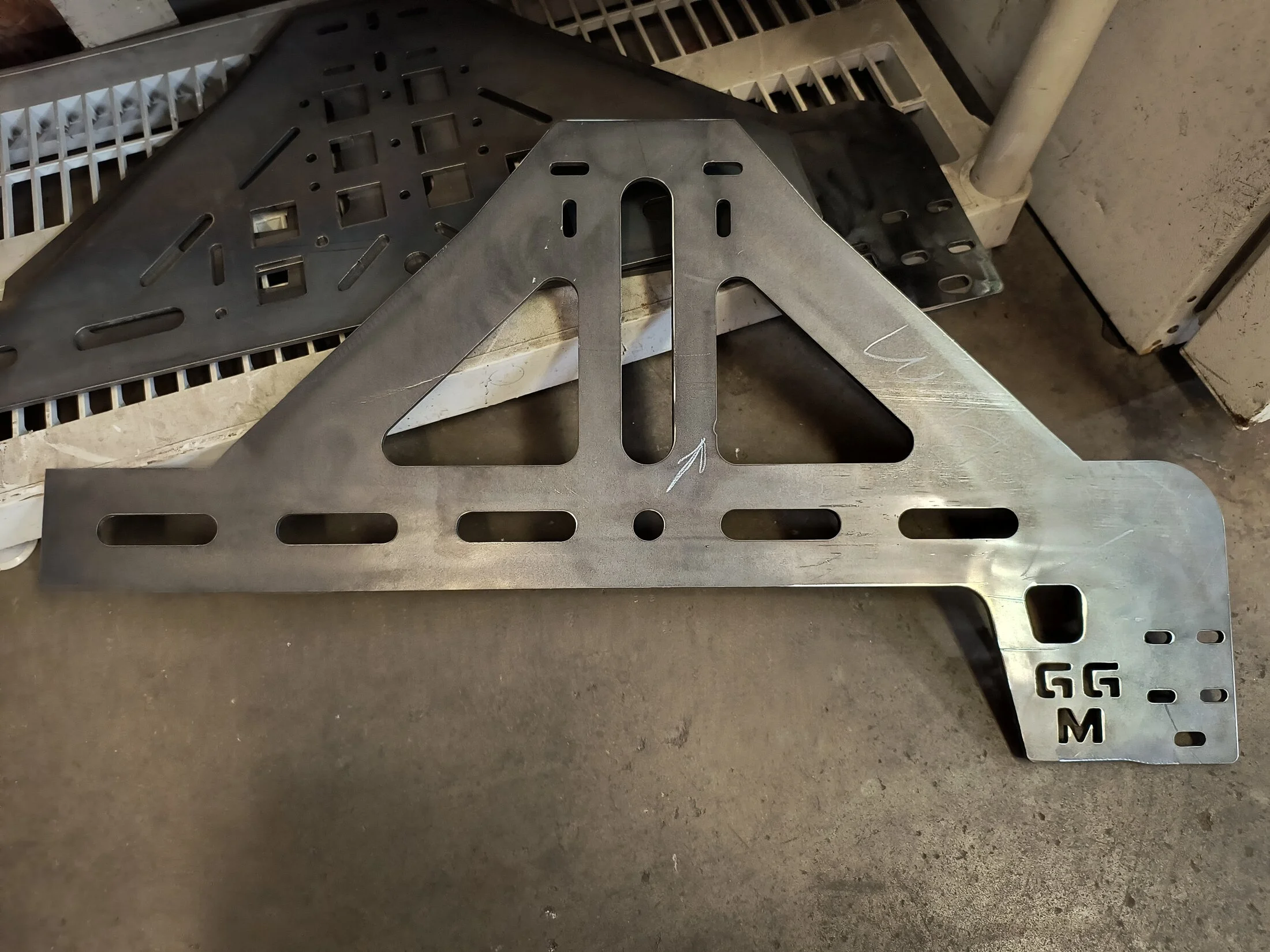

I have a blem tire carrier that I wanted to offer here first. I didn't see the deep scratches in the steel sheet before cutting and had a indention in one of the cuts. I haven't built it yet, but if anyone is interested I'll take 20% off the price. Send me a email at generalgreenmanufacturing@gmail.com.
