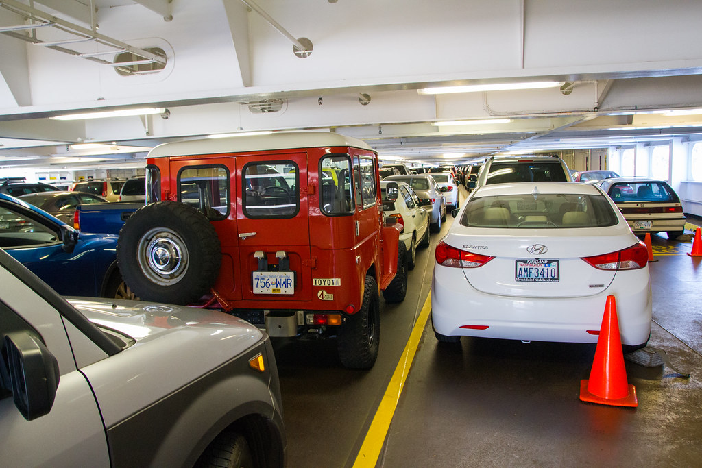

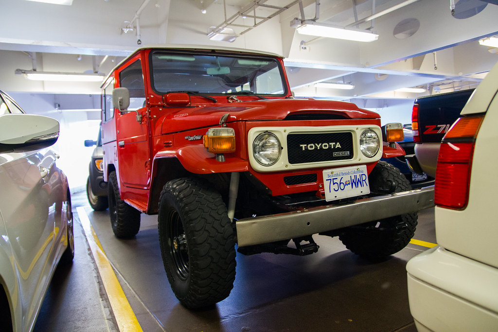

I took a ferry over to Vancouver Island on April 13th, 2014 and picked it up from the owner. I've never taken a vehicle on the ferry before so that was fun.
A couple pictures from when I first picked it up...
1982 Toyota Land Cruiser BJ42 by Tanner.K, on flickr

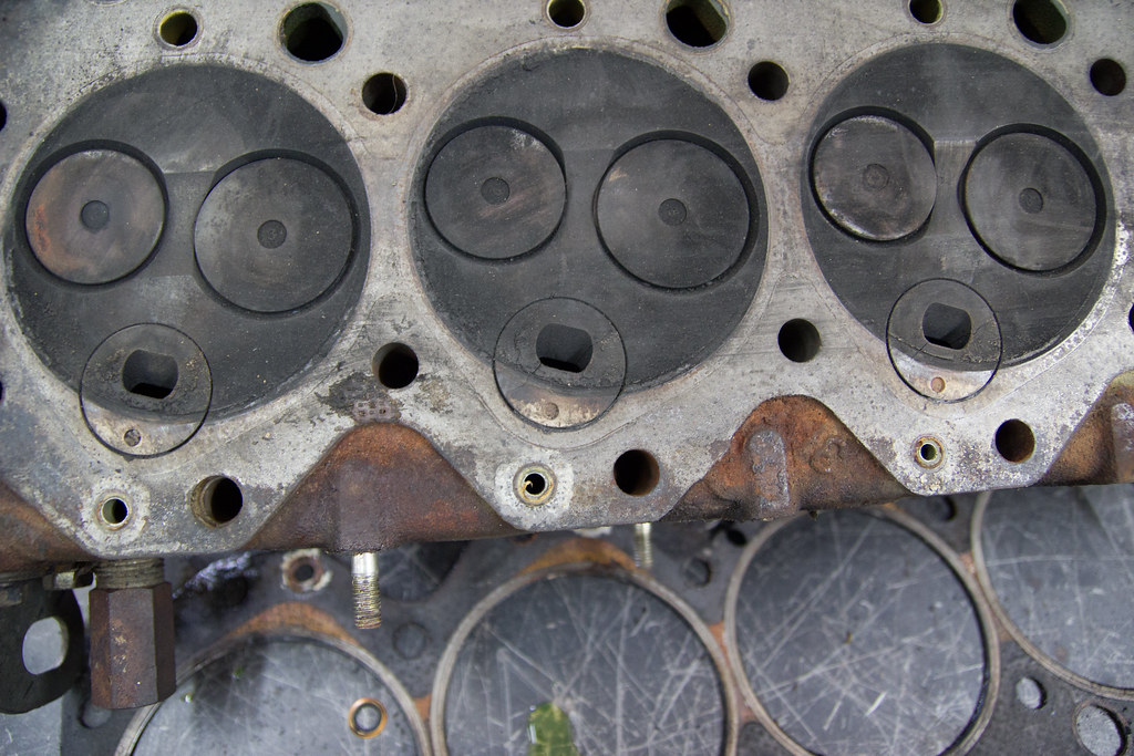

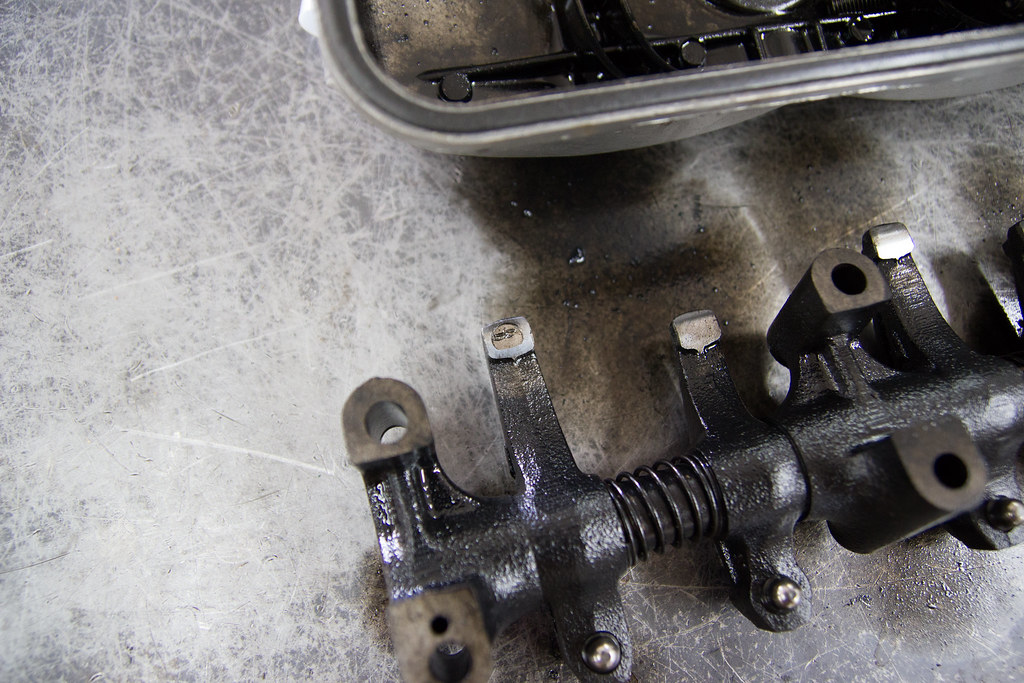

Along with a new MLG headgasket. The head was going to be sent off and cleaned up. The valve seals were going to be replaced and the valves re-lapped. Upon further inspection. Two of the rocker arms were badly worn, with one being quite bad - if anyone is reading this, go inspec those rockers and adjust the valves. These are going to be replaced.
Toyota 3B diesel - Rocker arm by Tanner.K, on flickr
Plus, all four pre cup chambers had cracks, so those are getting replaced too. There were small, hairline cracks between the valves in two of the chambers. They were too small for the camera to pick up and are quite hard to see - but none the less, they are there. I'm going to run it how it is; a new head wasn't in the budget at this point.
Toyota 3B diesel - Head by Tanner.K, on flickr
Along with the head work. The whole fuel system is getting a look over. Injectors are going to be removed, cleaned and re-tipped. Injection time re-set etc. Once that is done. The glow system is getting checked as well. When I had it, it smoked pretty badly most mornings and after work. So don't think it was glowing properly. Further more, the transfer case is getting taken apart. Needs a new rear seal and output bearing thus far; will know more once its apart. Lastly, the front axle is getting rebuilt. New axle seals, bearings, front brake pads and rotors etc.

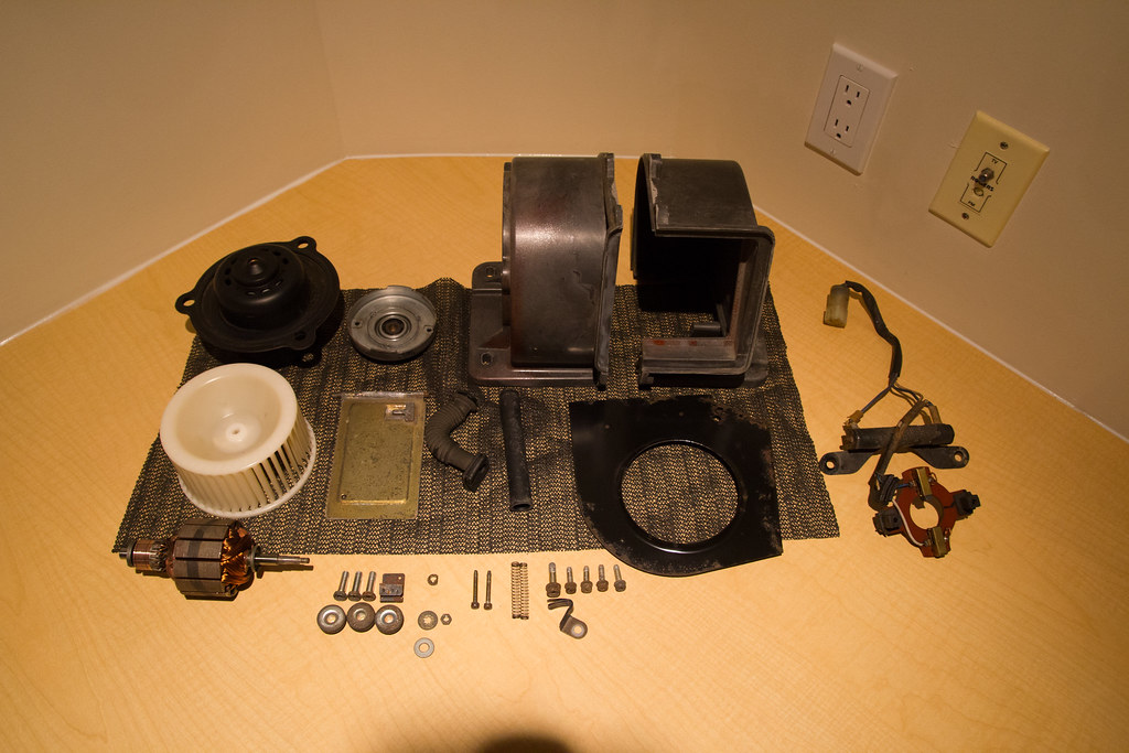

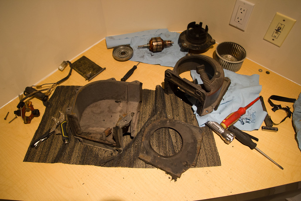

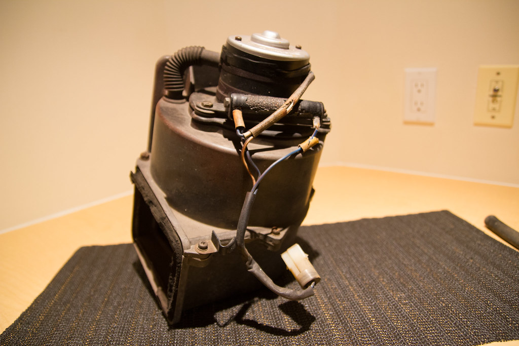

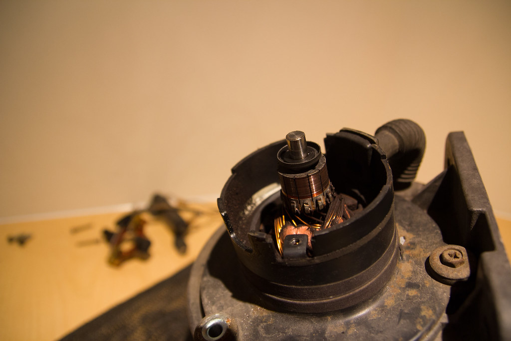

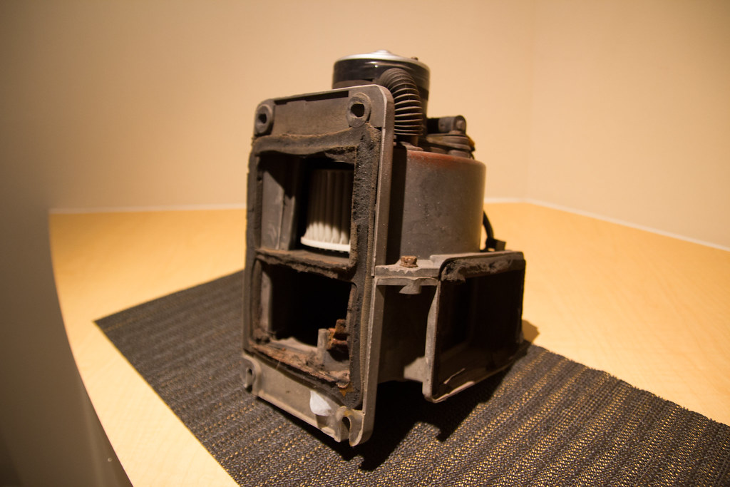

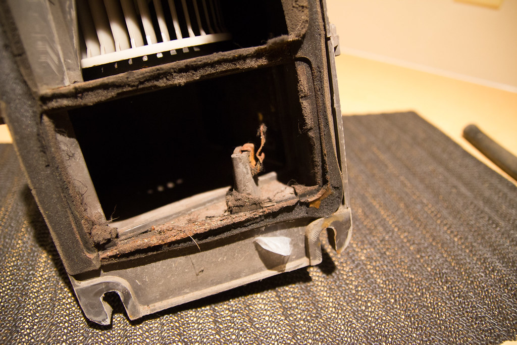

So, the 42 isn't running right now, well, kind of is. Need a new voltage regulator. So while I try and locate one of those, I thought I'd do a little restoration on the blower motor housing. If you want to read about my charging issue, you can read about it HERE
I intended on just replacing the foam, hoping it'll help keep some of the diesel fumes out of the cabin and get better flow. Just replacing the foam...yeah, who was I kidding. As soon as I removed it, I thought, why not clean it up a bit. Then that turned into, why not add a little paint here and there...now it is fully taken apart haha.
BJ42 Blower Motor #1 by Tanner.K, on flickr
BJ42 Blower Motor #2 by Tanner.K, on flickr
BJ42 Blower Motor #3 by Tanner.K, on flickr
Still a lot of material left on the carbon brushes; so won't bother replacing them.
BJ42 Blower Motor #4 by Tanner.K, on flickr
BJ42 Blower Motor #5 by Tanner.K, on flickr
Yup, just going to replace the foam...
BJ42 Blower Motor #6 by Tanner.K, on flickr
I spent a good part of the night cleaning all of the parts. I got every last bit of foam off. A little sanding here and there, then time for paint.
BJ42 Blower Motor #7 by Tanner.K, on flickr
BJ42 Blower Motor #8 by Tanner.K, on flickr

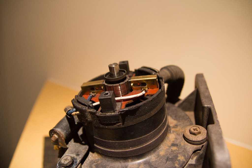

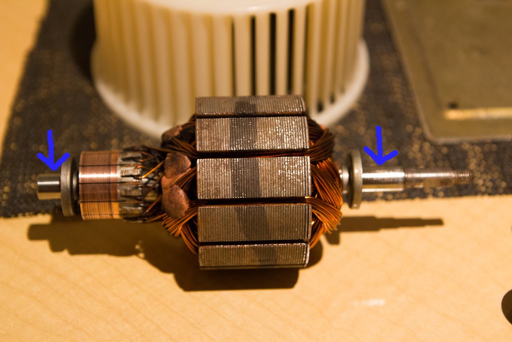

In the last picture above, of the motor. During reassembly, do I need to put any kind of grease(?) on the ends - blue arrows?
Given I did not plan on repainting the housing or pulling it all apart for that matter, I do not have paint hah. So that is where I left it for tonight. I'll grab paint this week.

..... do I need to put any kind of grease(?) on the ends - blue arrows?....
-Tanner
Hi there Tanner...
You're doing a great job there...
A good smear of MP grease would help I think..
Don't copy this though ..... I think I put a little too much there:
And I used an old "sleeping mat" (sold in camping stores to place under your sleeping bag when your sleeping on hard/cold ground) to cut my new gaskets from:
:beer:
I used the kit from TLC metric for my fan and heater because they were in rough shape. If your fan looks like that. Have you checked your heater?
Tom, that gasket doesn't quite match the OEM paint, how could you bring yourself do to that? ;cP (LOL)
I Like the camping mat idea loastmarbles!! I bought some foam weather stripping from Home Depot that I am going to cut up and use. I'll see if I can make that work. I was thinking of using dielectric grease on those ends?
Hah, my heater is far worse than this. I ordered a kit from Metric TLC is December. Looks like it got lost in the mail so I'm hoping the second one Shane sent me arrives this time. While I wait for that, I decided to clean up the blower motor too.
Snow Peak. Took forever to get mine as well i think they forgot till i reminded them. Got the kit and it worked well.
... I was thinking of using dielectric grease on those ends?......
Noooo. Don't do that Tanner.
That stuff is not for mechanical lubrication.. It is indeed meant for use on electrical things .... Granted.. But it's used to:
  • exclude moisture (so you don't get short-circuit/arcing problems caused by moisture), and
  • to enable rubber boots etc (on electrical stuff) to be more easily removed/refitted.
:beer:
(It has enough lubricity to aid occasional movement but not enough to act as a true lubricant.)
