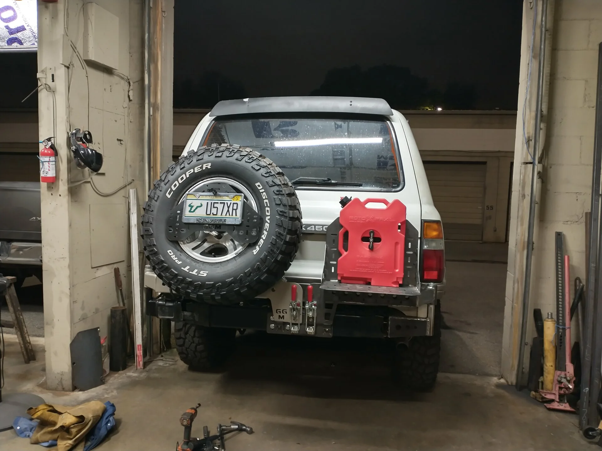

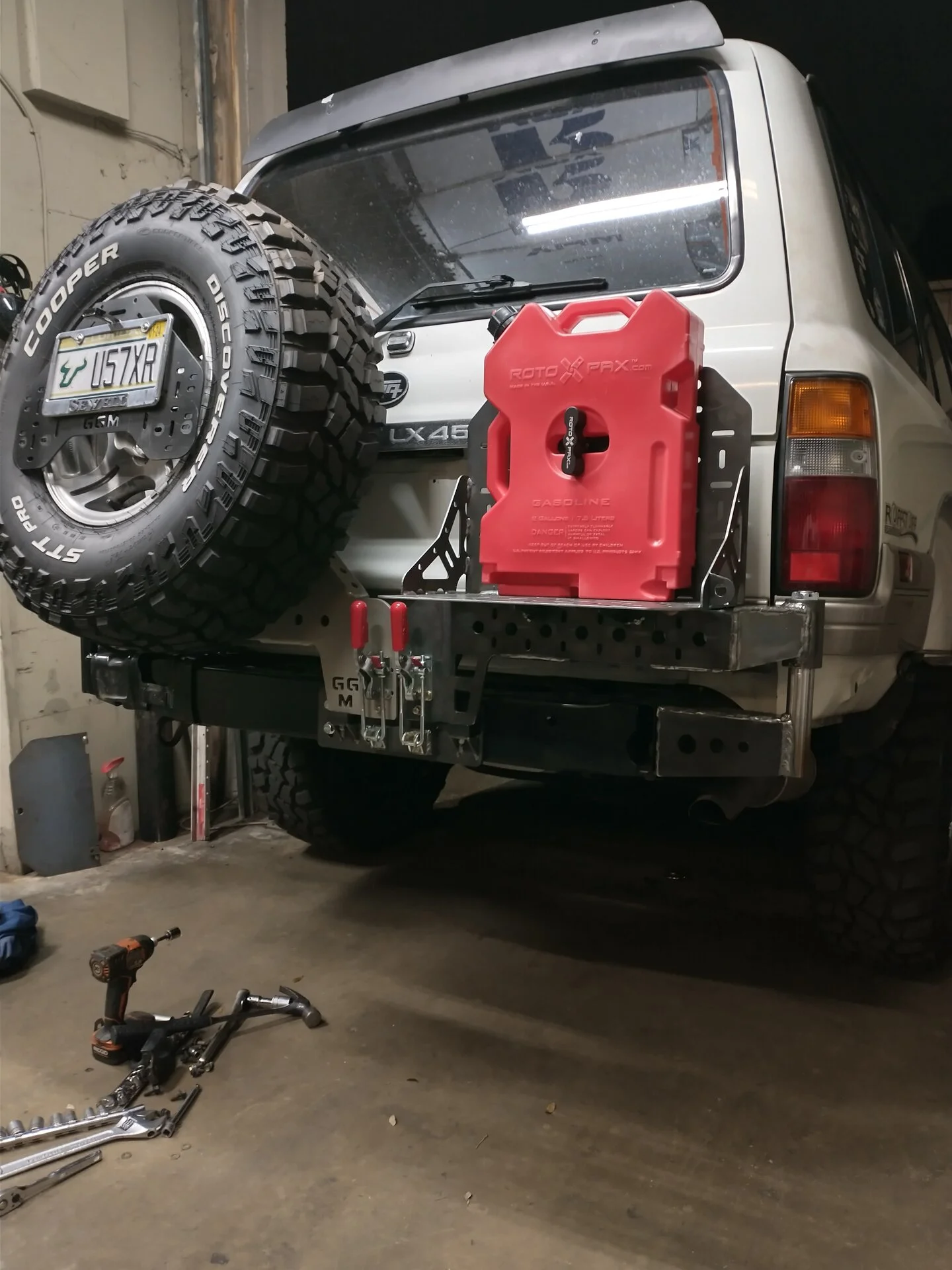

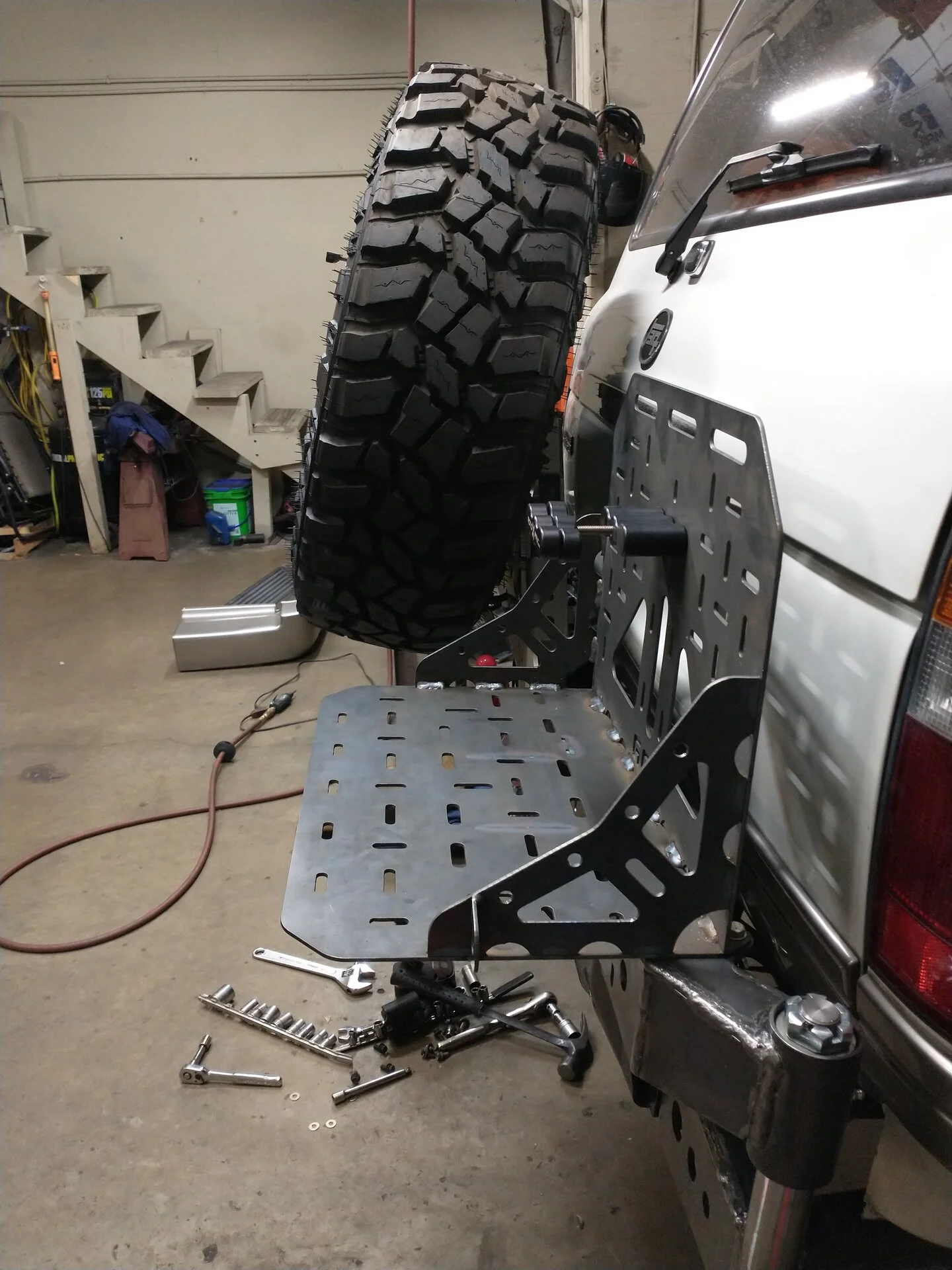

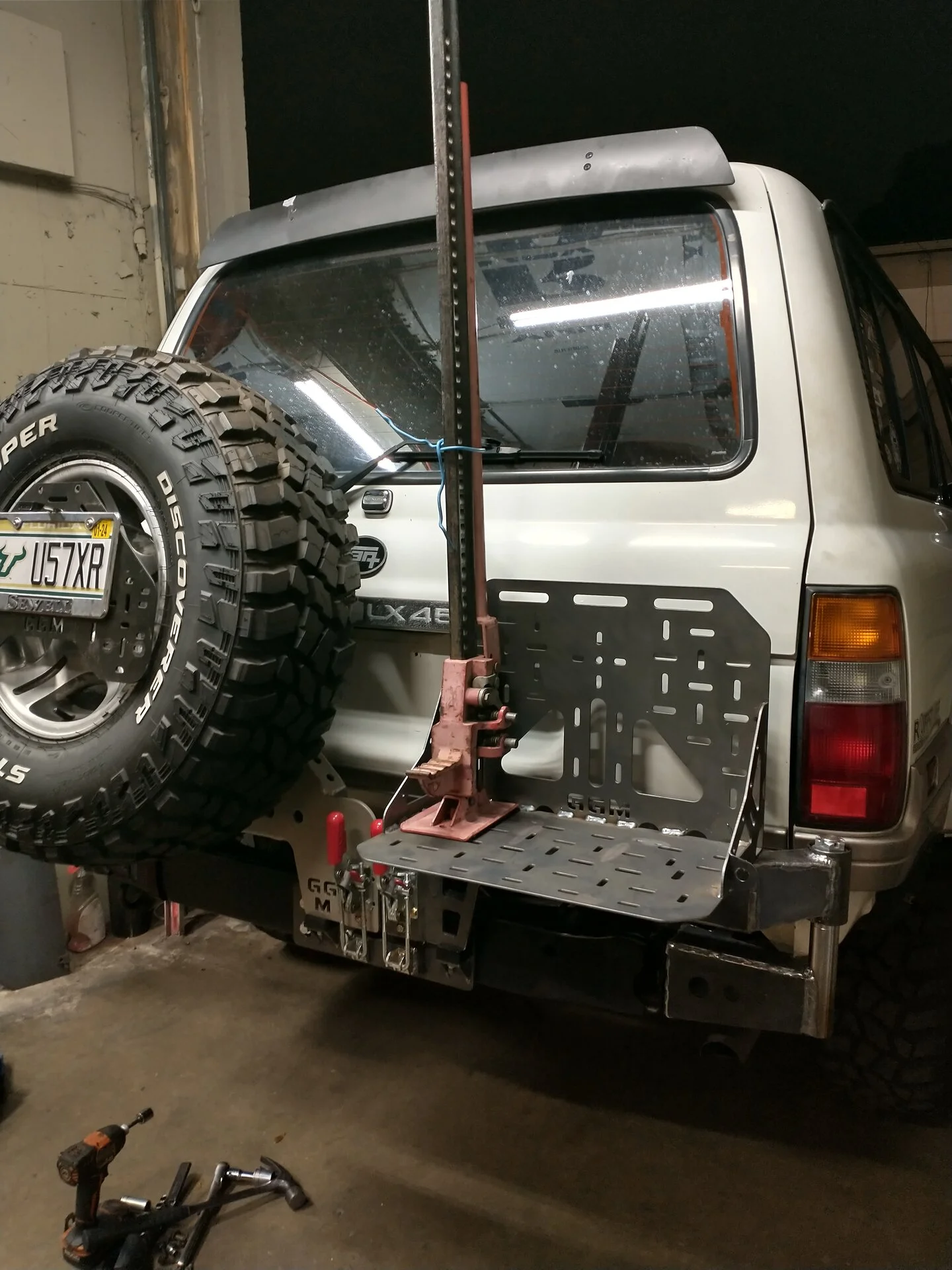

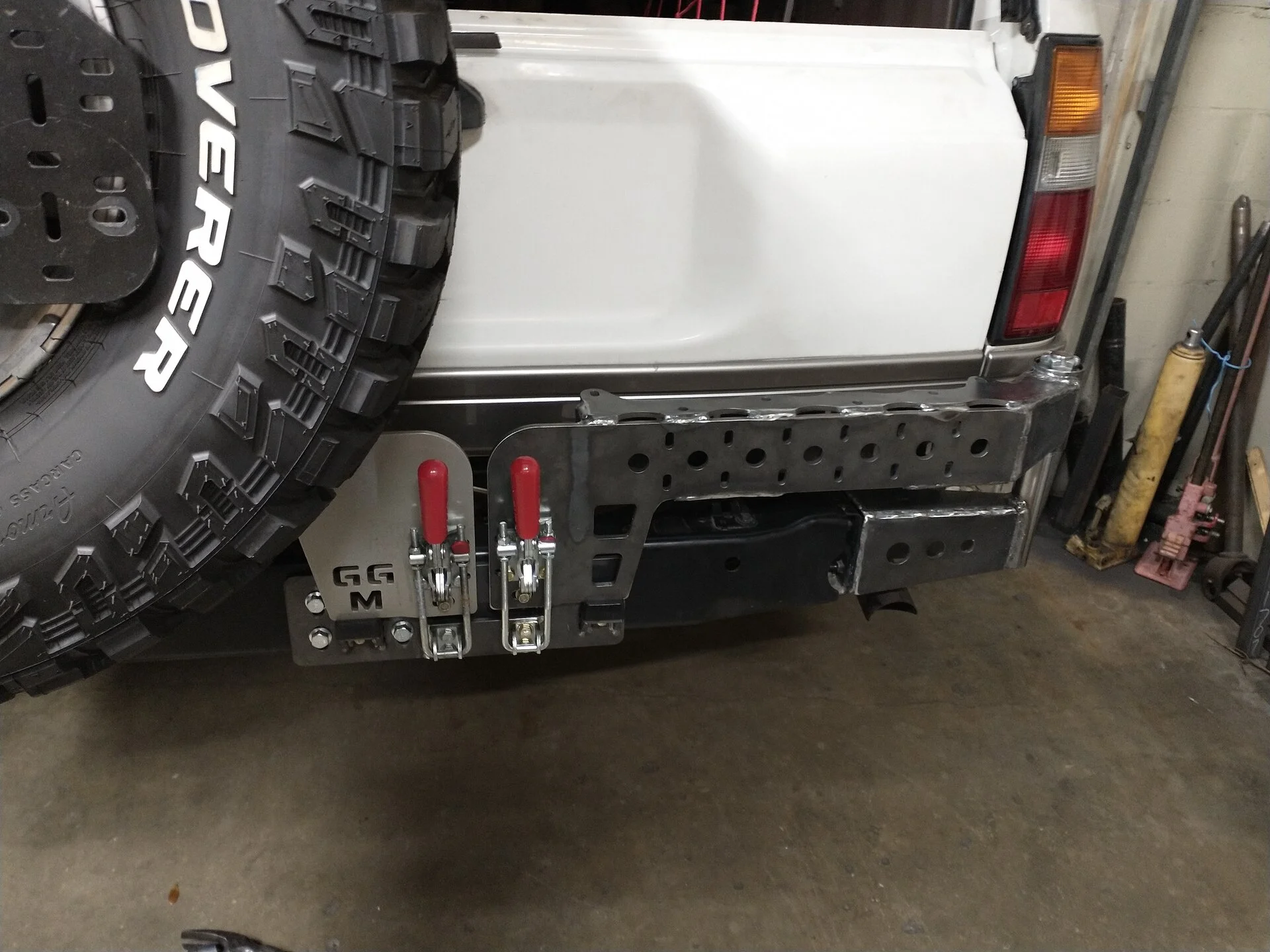

Here are some pictures of the second arm. The idea is to provide a base and then other things can be bolted to it. The first thing that will be offered is a basket like mount that can hold 2 jerry cans and a hilift jack. I plan to develop other things down the line. There are mounting holes all over this thing if you want to try and find other accessories to fit or build your own.
View attachment 3252409View attachment 3252410View attachment 3252411View attachment 3252412View attachment 3252413
I love it!
That's great work!
And thanks for fabing for two standard JCans!

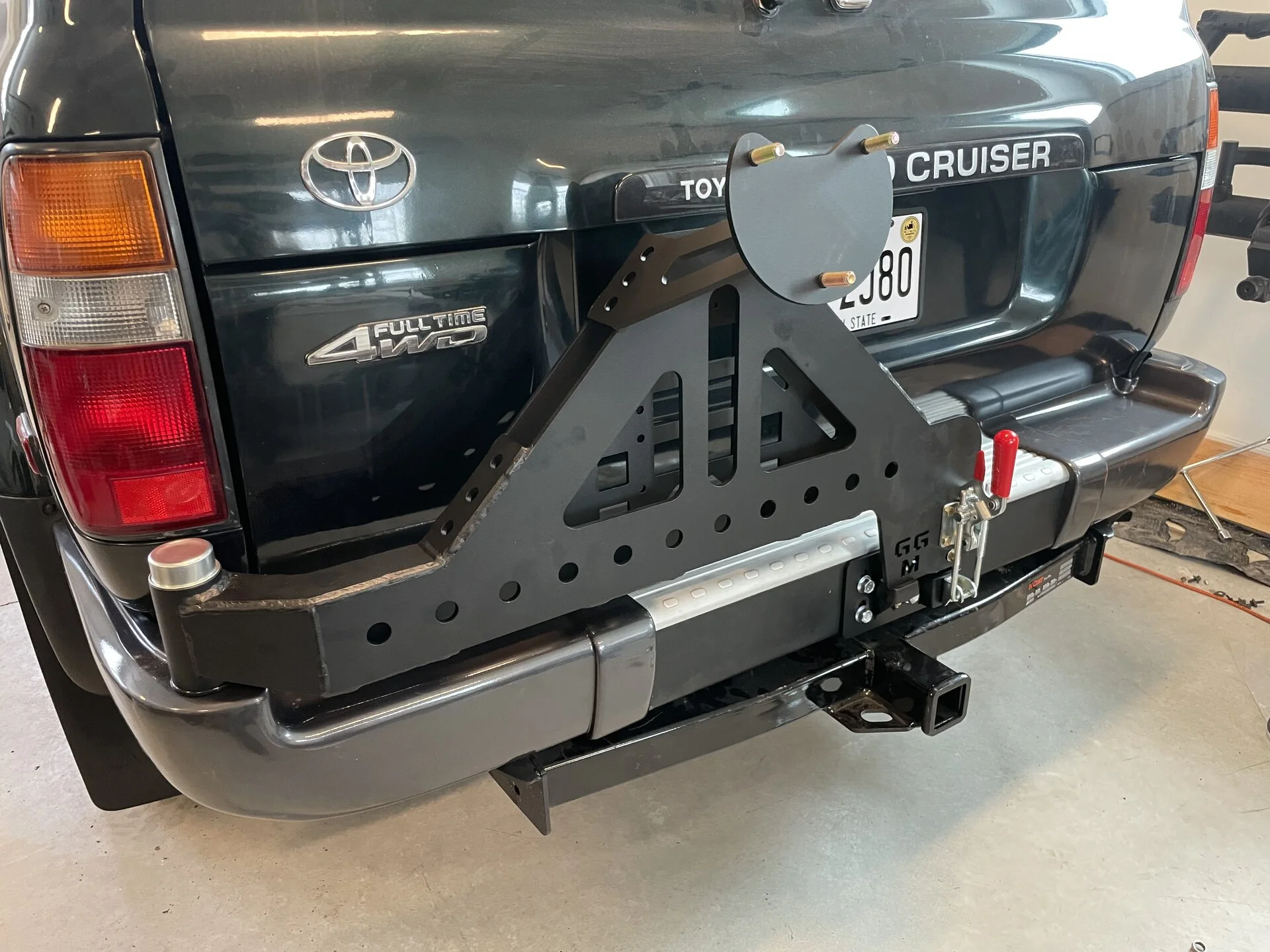

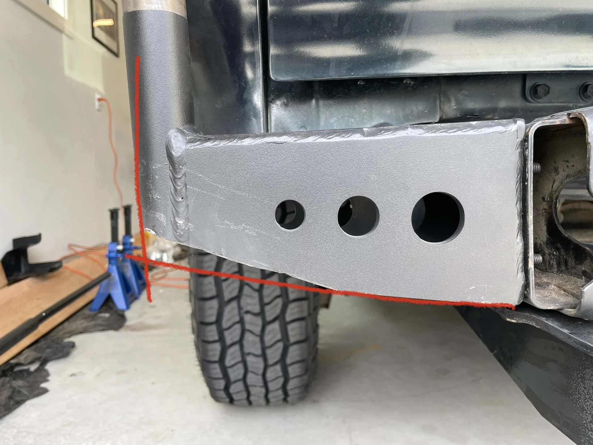

After some fitment issues that resulted in me needing to remove quite a bit of material from the spindle mount (and some back-and-forth emails with Matt), I was able to create the clearance I needed to get my plastic bumper extension to align with all the mounting points. I don’t know if I’m just a problem child or what, but there was no way I could reassemble the bits without cutting and grinding. It looks great now—all mounted up. I’m very impressed with the quality and design. Changes the look of the Cruiser in a big positive way. Big props to Matt for his patience and help with my odd fitment issues.
First photo: red lines indicate approximately the original profile of the mount so you can see how much I removed
I'm in love with that dark green 😍
I'm glad you stuck with me and pushed through, it looks great!
Thanks again for all your help.
Matt and I have emailed about my issues and based on his observations there is a likelihood that the driver side rear frame may have been bowed just enough to cause my issues. I do know that it took some degree of a hit there (in its previous life) because the plastic bumper extension and underlying bracket were misshapen. I purchased a brand new extension and it matched up perfectly—after I removed some metal. All I know is I am really happy with the end result and just as happy to put this one behind me!

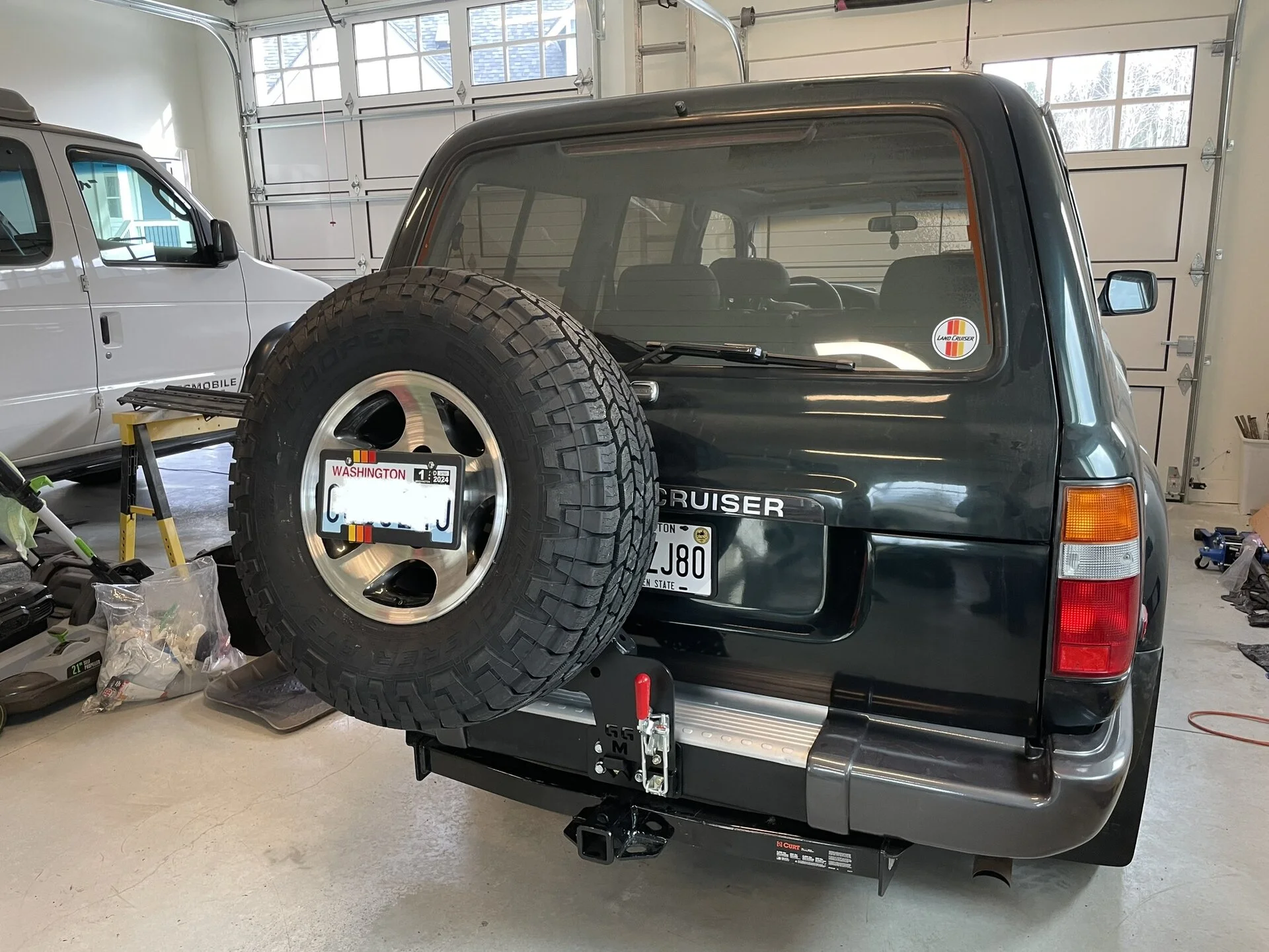

Nice work @GGM , this is a really sweet setup! Definitely would've considered this prior to going full rear bumper with swings on it - too late now!
Props to @Itchy Dog on the clean install AND those MINTY OE wheels! 🔥

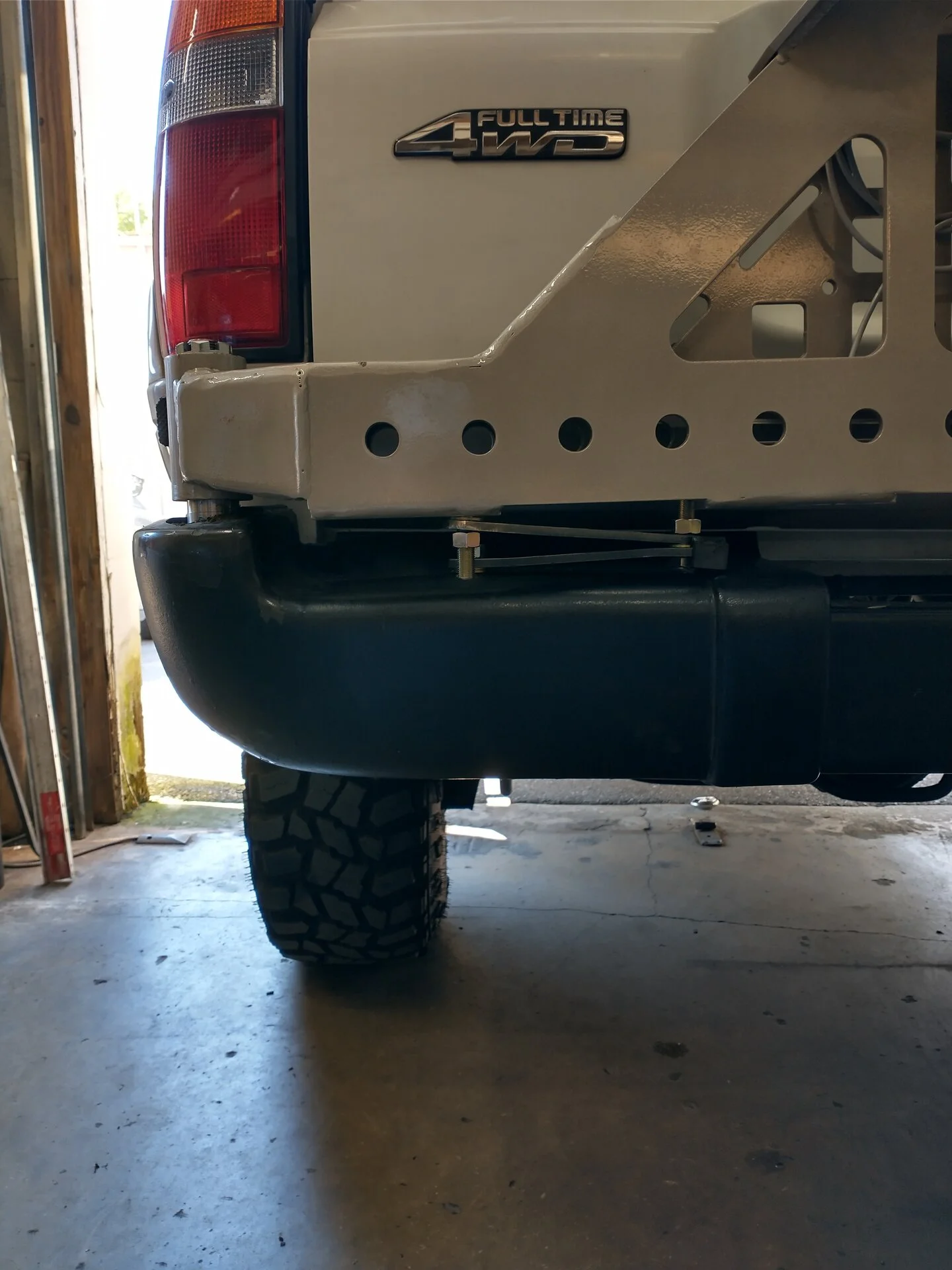

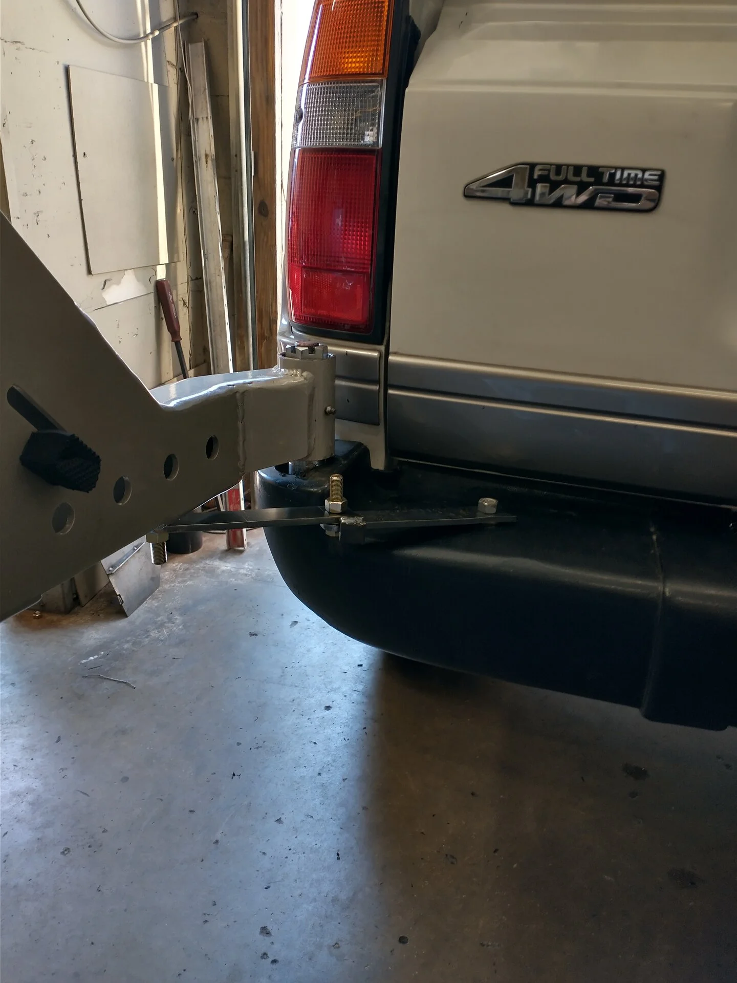

Update with fitment issues. After messing with the LC plastic for a while I think I have an idea. This is what I've come up with today and subject to change. These are rough pieces and random hardware I had on hand.

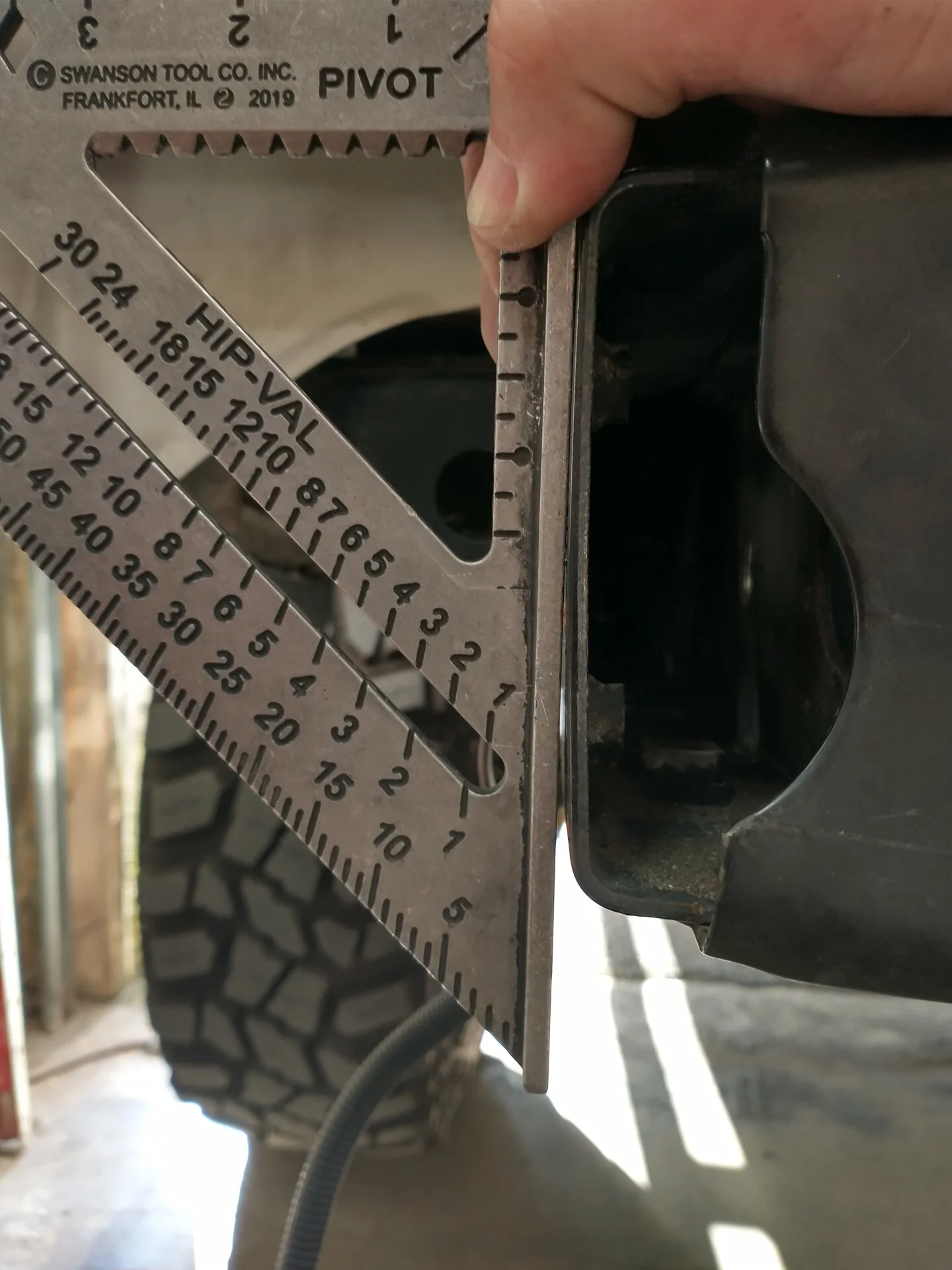

The LC plastic is slightly smaller than the Lexus plastics I originally designed around. I grabbed a spindle off the shelf, not modified and went at it. A couple observations, first I'm noticing the frame isn't perfectly flat, there's a bow to it. I think this is normal but it can potentially make other things not align. I think I'm going to write up a procedure to shim for correction. You can see in the picture there's a gap at the top and bottom, I also think the order you assemble things has an affect on how the frame pulls flat too.
Next, F that steel piece! Remove it! The plastic will bolt to the crossmember and wheel well. This leads me to the next thing. Two birds one stone. A linkage will bolt to the top of the frame mount and will sandwich the plastic down to hold everything in place AND now you have a limit strap. The linkage works similar to the tailgate linkage. The idea is it swings past straight and folds in on itself, there a tab to stop it and locks it in, preventing it from closing. Then to close you just pull on the linkage and it swings shut like normal.
The plastic fits snugly and could probably use a bit more of a relief but everything goes on and comes off easily.
I'm still experimenting with angles, lengths and things but it's in motion.

You have my attention! I’ll eagerly await instructions on shimming the spindle mount. And the limit linkage is very intriguing, although drilling another hole in the plastic is already causing me anxiety 😆
Matt, you might want to try and get a wider angle with that limit strap. At its current angle, the drop down table won’t clear the tailgate when they’re both down. I mean, sure it won’t affect too many ppl, but for those intending to use a drop down table in junction with their tailgate won’t be able to.
