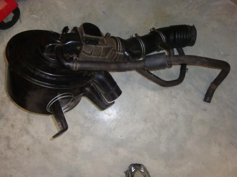

Air filter Assy?
attachment.php
$50 a reasonable price?

AFM is the silver box with black plastic lid on top of the air filter assy.
