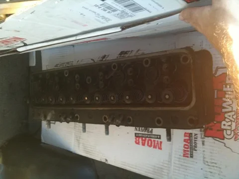

So I went down to Valley Hybrids today and took apart a 3FE that Georg located for me. I got the entire EFI system, unmolested harness, exhaust manifolds, exhaust headers, all 3FE accesories, head, injectors, and thermostat with all sensors. Only set me back $350. Not to shabby. Everything is in really good shape. Very clean. So I pretty much have all the parts that I need now. Just need to start cleaning everything up and start prepping for install.
