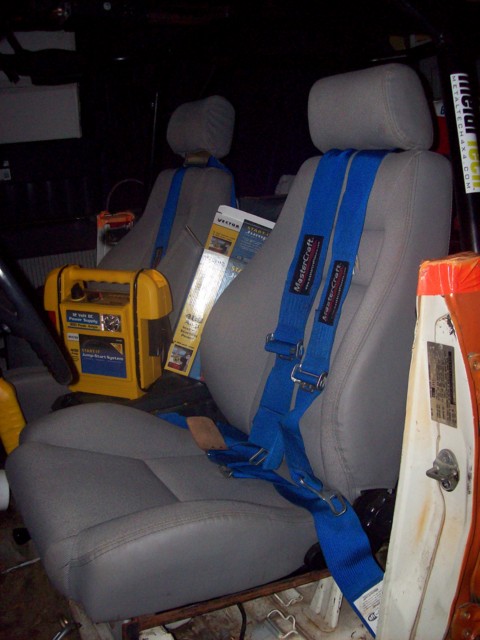

I didnt do the empis cause my head suck out the cage 3 in :lol: I had a set of SmittyBilt seats for my other 60 so I tossed them in and the cool part is the holes in the brakets that matched up to the stock brakets :grinpimp:

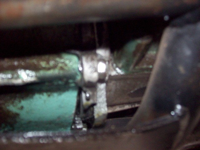

a pic of the truck after we winched out of the canyon :crybaby: rear shaft and front nose cone no pics of the nose cone but I popped all the ears in one bang :steer: 0 wheel drive hooked to 2 Heeps to get out as I winched I need to whgt this pig and give her a diet she HEAVY
not to many pics we wheeled too fast :steer:... great day till I heard POP ... the front clears ok but I need open the rear up. it's all over the springs under full turn in the front but I dont know that I want to limit the stops yet

if you look at the pic you can see the guy on top of the ledge over my sholder there was a point on it the hit right on my shaft :bang: the pop was so soft everyone was like what was that .... the nose cone was LOUD :meh:
Hey' I have a few shafts that look like that. Once you dent them its all over.

thank as you can see fron the white on it was ALL over the rocks :steer: I just hope I can get it fixed before round up... lookin for some sch 40 pipe tomarrow :hhmm:

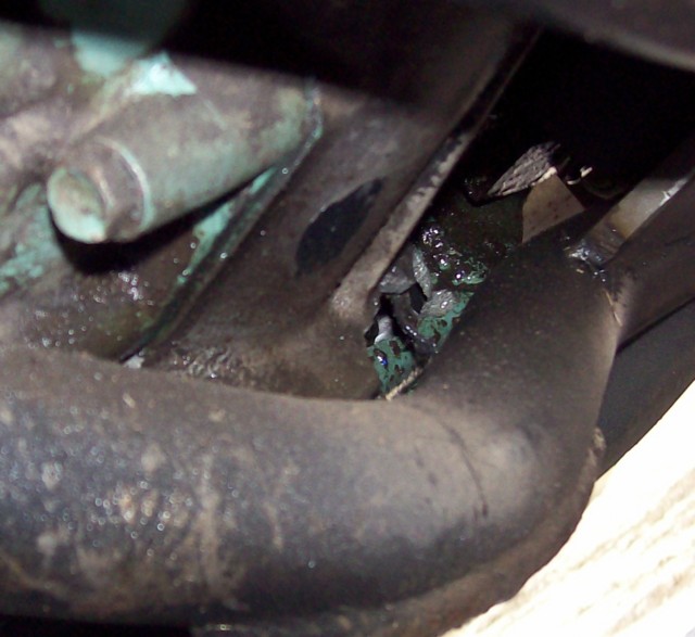

Pic of the nosecone....?

after I get a rear shaft built so I can get her off the trail and pull it apart the cross member covers it up real well... but if you grab the shaft it moves all around about 2 in at the flange :eek::lol:
That rear shaft looks like an easy fix, sure like to see that front cone.
Why do you think that broke? Do you think it was a traction thing, front shaft bottoming out, loose bolts, worn out parts like bearings or isolation mounts,...?
the shafts going thick pipe so it wont pop like that again ... and as for the nose come I'll work on pics but it a old school 3sp case so I dont know, but George (orange45) had a great idea that sound right ... he said the gears under great load push the front out and popem like this and well I was bound up in front wheel drive trying to get over a 3-4 ft under cut ledge and WOW what a sound when it went .... everyone said you broke a locker or axle and I said nope split my tcase .... we just pushed the nose cone out :meh:
lookin at the brake at the lower right I think I broke the case too :crybaby: I'll work on better pics later its cold for Texas and I have my 2 year old with me so I cant take him out side to work
