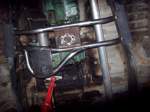

Is your crossmember hard mounted to the frame with the bushings @ the cases or are the bushings mounted directly to the frame?

cross member is hard mounted to the frame and the Toy box mount( stock p/u) is used to mount it all the cross member .... thanks I love the look as well but i hope it not what killin the t-case I think if I had rear wheel drive it wouldnt of happend but only time will tell ... heres the bottom shot of the JK customs crossmember

gotcha... I've heard of lots of people breaking cases when they didnt hard mount the cross member to the frame... especially true when they hang a heavy 205 behind it. I dont think the splitcase is heavy enough to warrant a second crossmember tie in but it probably wouldnt be a bad idea given the amount of torque you generate in first gear. How are the motor mounts?
That looks like a great blue print for me to start from/copy for my new cases. Any chance of you taking some more pics of it when you get a chance? No hurry as I know you are under a time crunch right now.

broke the drivers side twice or three times... now its solid chunk of alum the passanger side is stock ... what pics do you want I'll get any angle you need arnt you going 203/205 ?? or are you still runnin mini truck cases ?? I wont have time to work on it for 2 weeks so she will just set out front under the tarp still loaded on the trailer :frown:
nothing in particular... I'm just bouncing ideas around in my head on how I'm going to build my crossmember(s) for the 203/205. If you get a chance to snap pics that's cool if not... that's cool too.

I would use spring bushings at the frame for it and the motor you want to all the flex the same ... afew guys in the club have broken alot of trannys cause they flex different ... but one guy has the same bushings mounted to the frame at the same spacing and he has not broken on since he has 2 on the motor and 4 on the tranny/cases I 'll see if I can get him to shoot some pics as well

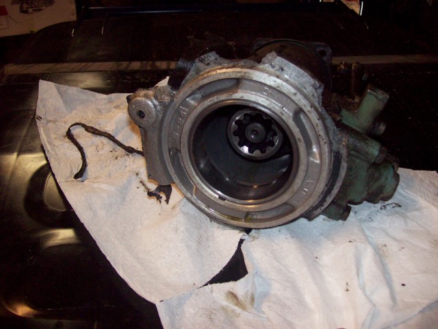

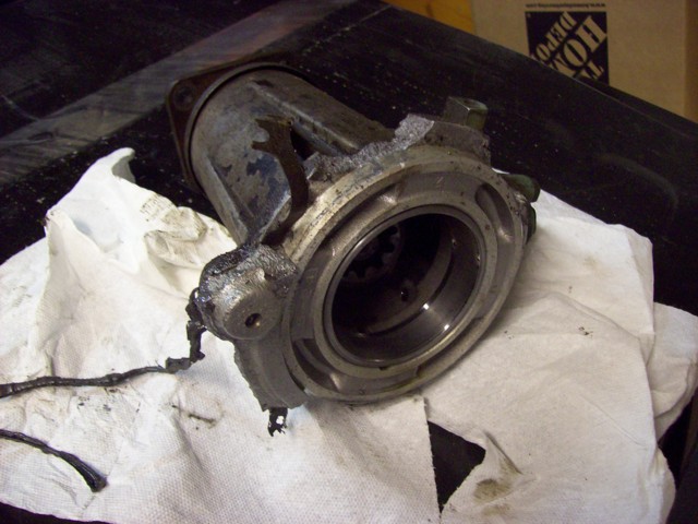

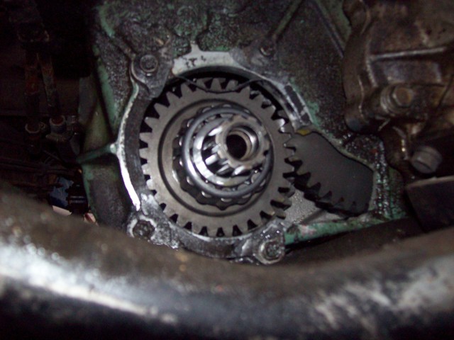

I pulled the drive shaft and shifter linkage and it just fell out :lol: I didnt know I needed a 36 mm socket to get the tcase off SOOO I will have to buy thandt and start over later :mad: I hope Orange45's tcase saver will help this from happening again .... but I dont think it will but I will carry spare drive shafts from now on ... I think I would of been ok in 4wd not just front :hillbilly:
I'm thinkin 2 ear on the top were cracked allready cause the brake has two shades in it what do yall think
