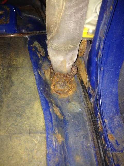

Ha, yeah, I dove right in the rabbit hole. Already took apart the rear heater to clean it, so might as well peek at the front heater system :). I only want to do this fiasco once so I am trying to do it right in one swoop. Plan is for Quiet$rap, autocarpet jute, then the carpet on top. I need to treat some surface rust first though. The gutters had been leaking water into the interior (another project on the horizon), so it caused a bit of a mess with the old jute and rug. I found this were it was directly leaking into the cab by the b-pillar.
Time for new seat belts: :eek:
