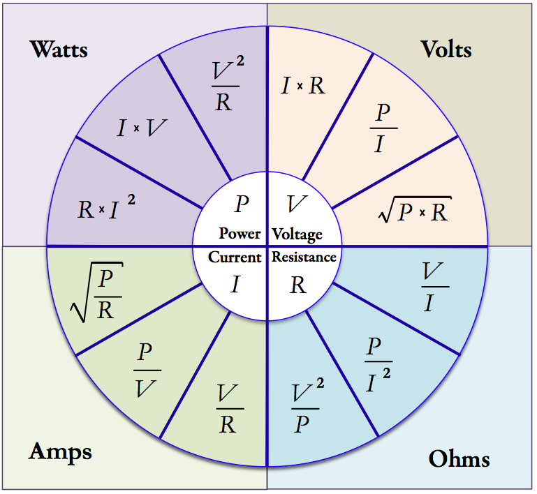

V = IR is just half of it. P = IV is the other half.
See attached.
Voltage is basically fixed for any impedance… sort of. It may be slightly lower in voltage gain with lower impedance and higher current, but it's basically fixed.
Because voltage (V) is the same, with more impedance (R), the current (I) goes down, and the power (P) goes down. Too much current will make the magic smoke come out of your amp. When you let the smoke out, the circuit ceases to work.

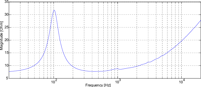

The resistance of a speaker is actually a function of frequency, not one value. For example, an 8 ohm speaker may have resistance as low as 6 ohms in the mid-range, and as high as 100 ohms at the resonant peak. This allows for a certain … “creativity” in creating speaker impedance specifications. The marketing department will have its way.
Attached is an example (from Wikipedia) of an actual speaker's resistance versus frequency... note that the resistance goes off the chart at the higher frequencies, and peaks at well over 30 ohms at resonance.
TL;DR: drop the speaker impedance too low and you stand a chance of over-driving the amplifier.

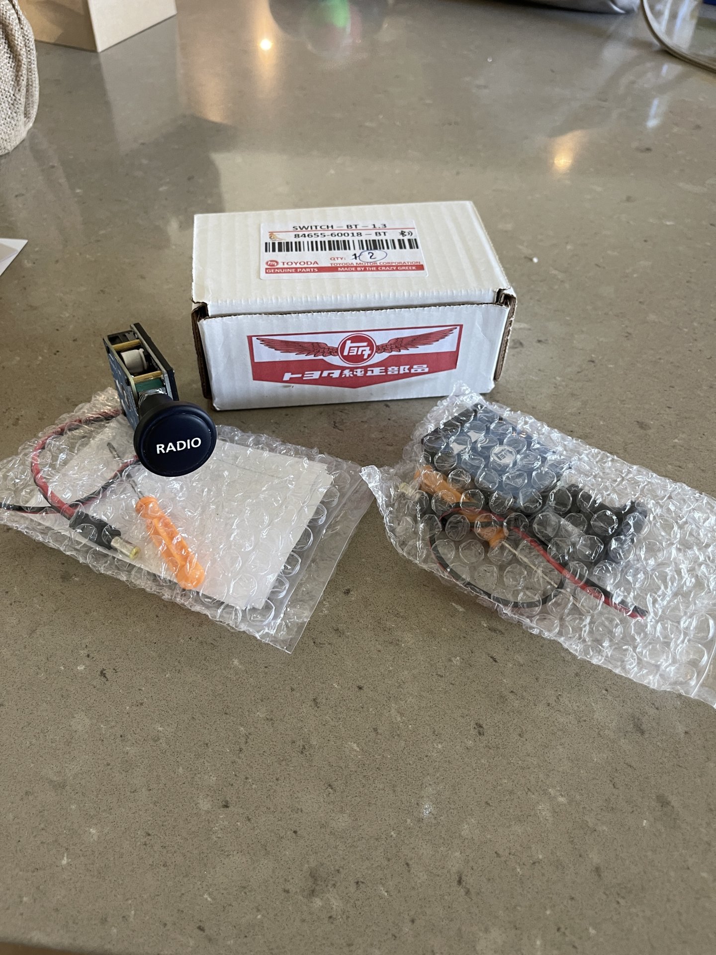

Thank you for the nice words! I hope you enjoy!Received two units down under today. Blown away by the quality of the knob. Nice work Angelo and thanks again
