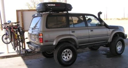

So my questions/comments are kind of like Turbocruiser's in that I'd like to know what the advice/consensus would be for oil weight for a turbocharged truck that resides at near sea level where ambient temps go over 110-deg F but frequently gets driven to snow and temps below 20-deg F during the winter. Should I just stay with the stock oil or do I need to have two fan clutches - one for extreme high temps and a stock one for general duty?
I can say that with the blue clutch in stock form I've only been able to get my coolant temp to 223-deg - and only briefly at the very end of the climb. This was with the egt's at 1500-deg, air temp at 105-deg running 85-mph with about 500-lbs of people, 1000-lbs of gear, a 15-cubic ft rooftop box on the climb up out of the Colorado R basin on I-40 - about a 4 mile climb with a few thousand feet elevation gain. Funny thing is the stock temp gauge on the cluster never went above just a hair above middle (not modded...).
