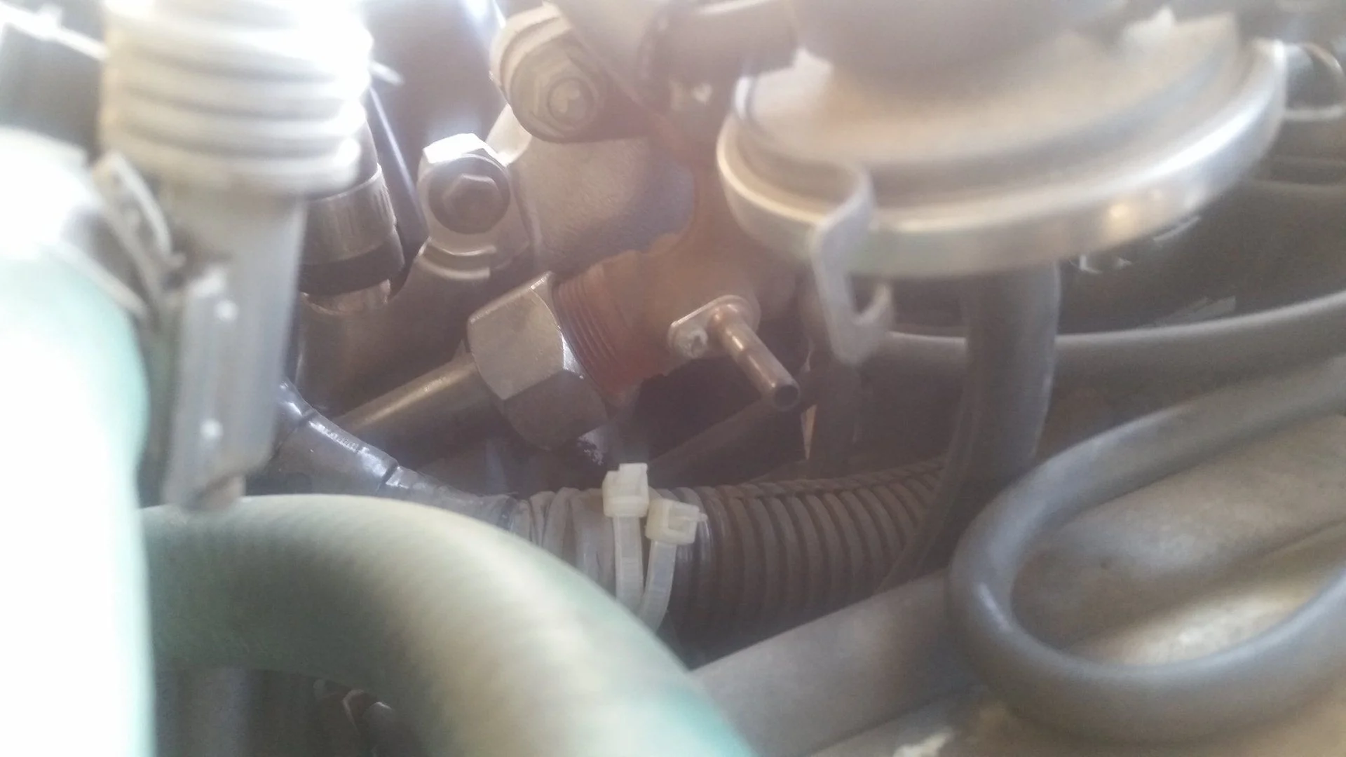

So I ended up disconnecting the modulator and just putting a cap on the output. It was just a rubber cap, and that rubber cap keeps blowing off. After looking at the FSM more closely I noticed that even with the EGR valve turned off, there would still be gases going to the modulator. You can see that here:
And here is picture that shows the output of the EGR valve where it would normally connect to the modulator
So I decided to try something a little better than a cap. So I picked up a little brass pipe and end cap and extreme heat jb weld. My plan is to cut the pipe to length and jb weld the capped pipe to the output.
But I am still not sure if this is going to work, or if this is even a good idea. What do you think? I really only wanted to plug up the EGR valve output to prevent the heat from damaging my wiring. But maybe that would send more gas into the engine, which may be a bad idea? I would like to block off the pipe, but I am not sure how to do that and do I have to pass a visual inspection, so removing the EGR completely is probably not a good idea.

If you have to have it for the visual inspection, why wouldn't you block the inlet port?
Do you mean the inlet port to the EGR valve? That probably would be better since it would close off the whole thing. But I am not sure how to do that.
I remember seeing a thread where someone said that you could unscrew the pipe going into the EGR valve and put a quarter in it. I guess I could do that. But I would like to hear from someone that it actually worked. Is a quarter really the right size? Does that really work, or is there a better thing to use as a plug?
i cut up a piece of license plate that goes between the pipe and exhaust manifold housing, uses two bolts on the flange.
So you put the plate between the EGR valve and the intake?
That would stop the EGR gasses from going to the engine, but I don't think it would stop everything. I don't think that would block the outlet to the modulator that I am trying to block. If you look at the FSM picture above it shows that the outlet would still be open and gas would still be coming out.

When I was baselining my ‘93 I cleaned the intake and noticed the EGR port was completely blocked off by crud so I made the assumption that it wasn’t affecting anything too major. After cleaning everything I just made a little block off plate out of 18g sheet metal and put it between the hardline coming off the exhaust. Works great and no hot exhaust running through the EGR pipe by the wire harness
What they said...
My bad, follow the EGR pipe down to the Head, it has a flange with two bolts or studs. Pulled the gasket out to trace on an old license plate and drilled the two mounting holes and then trimmed it out with tin snips. Reinstalled the EGR pipe for visual appearances but the pipe was blocked so no heat in the pipe that runs next to the engine working harness... Used a lead airgun pellet to block the inside of the vacuum lines going to the modulator
