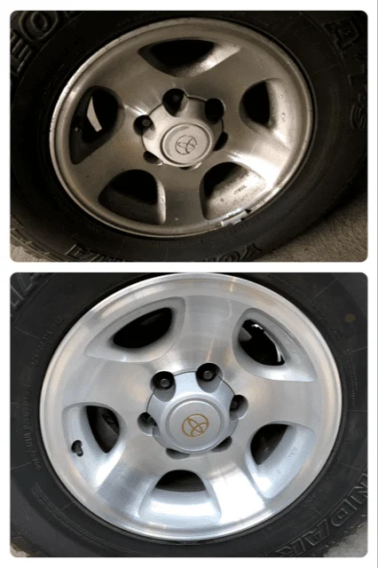

I just did my wheels by hand with an angle grinder and other hand abrasives.
They turned out fine.
That looks good! Do you mind sharing a little more detail in how you did this? Thanks!
I used one of the stiff knot cup brushes on my angle grinder with the guard removed to get the old finish off and then I used wet sandpaper to fine tune it and then used filler primer to build a smooth surface and then 3 coats of Rustoleum wheel paint in graphite. Probably 1.5 hours per wheel of prep and I didn't do anything to the back side beyond clean them.
