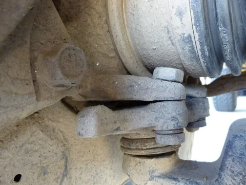

Figured out why my steering is messed up. Broke 2 bolts on my passenger side lower ball joint (I already snapped one before hand replacing the ball joint, the second one gave way on the trip). It is supposed to be flush and is bent in now. It is a minor miracle that the other two didn't snap on the ride home.
You dodged a bullet there.
Yeah, you did dodge a big bullet. The stress on those bolts is pretty great just under normal driving. Something you need to put a wrench on every so often just to check the torque. Saw an FZJ80 break off a couple of knuckle studs at SCC and it was a bitch to repair because they messed up the threads in the process of breaking and extracting.

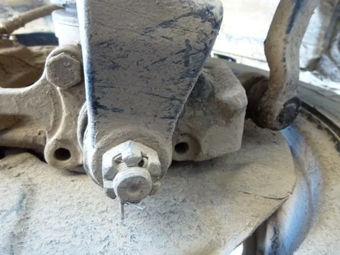

Took the day off from work and got my truck back on the safe side of things.

I had probably the hardest and most unorthodox extraction I've had in a while. I remember why I only had 3 bolts in there to begin with, I had broken off an extractor in there a while back. I tried beating, banging, drilling that stupid thing for over an hour and came up with this solution to drill above where the extractor was and beat it out from the backside. There is still plenty of metal around to support the knuckle, eventually I'll try and weld that hole back up.

Top is the bit of extractor I was trying to get out. Bottom is what my 2 bolts looked like when I got them out. I re-tapped one hole and Heli-coiled 2 more, installed new hardware and lock washers. Would have been real scary to think if that thing went on the highway.
