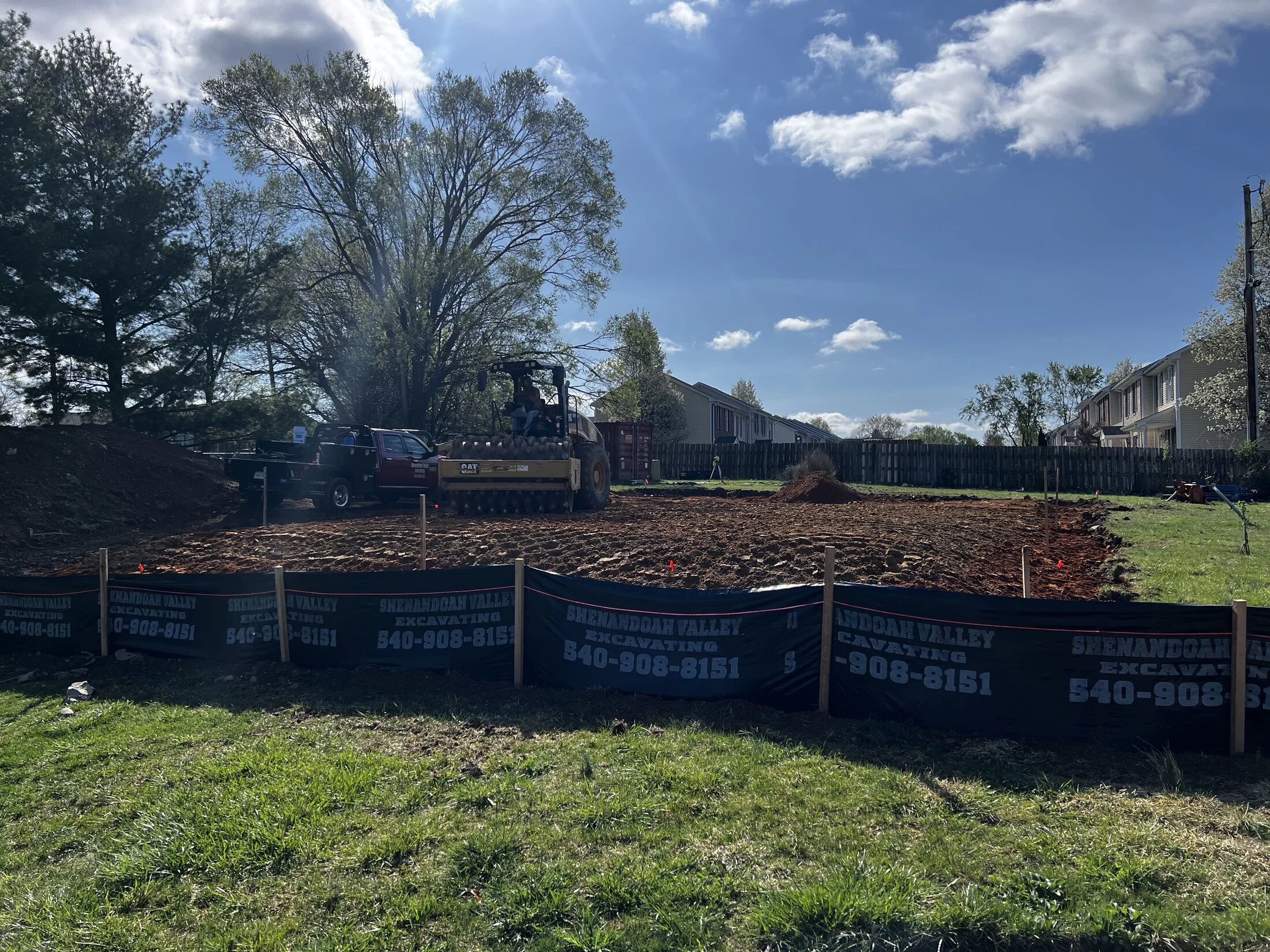

Dirt work started yesterday. Rolling in some fill material and hopefully starting footings once the pad is up to subgrade. The grade had about 2’ of fall to it. With a little creativity, there will be a loading dock on the left side of this pic

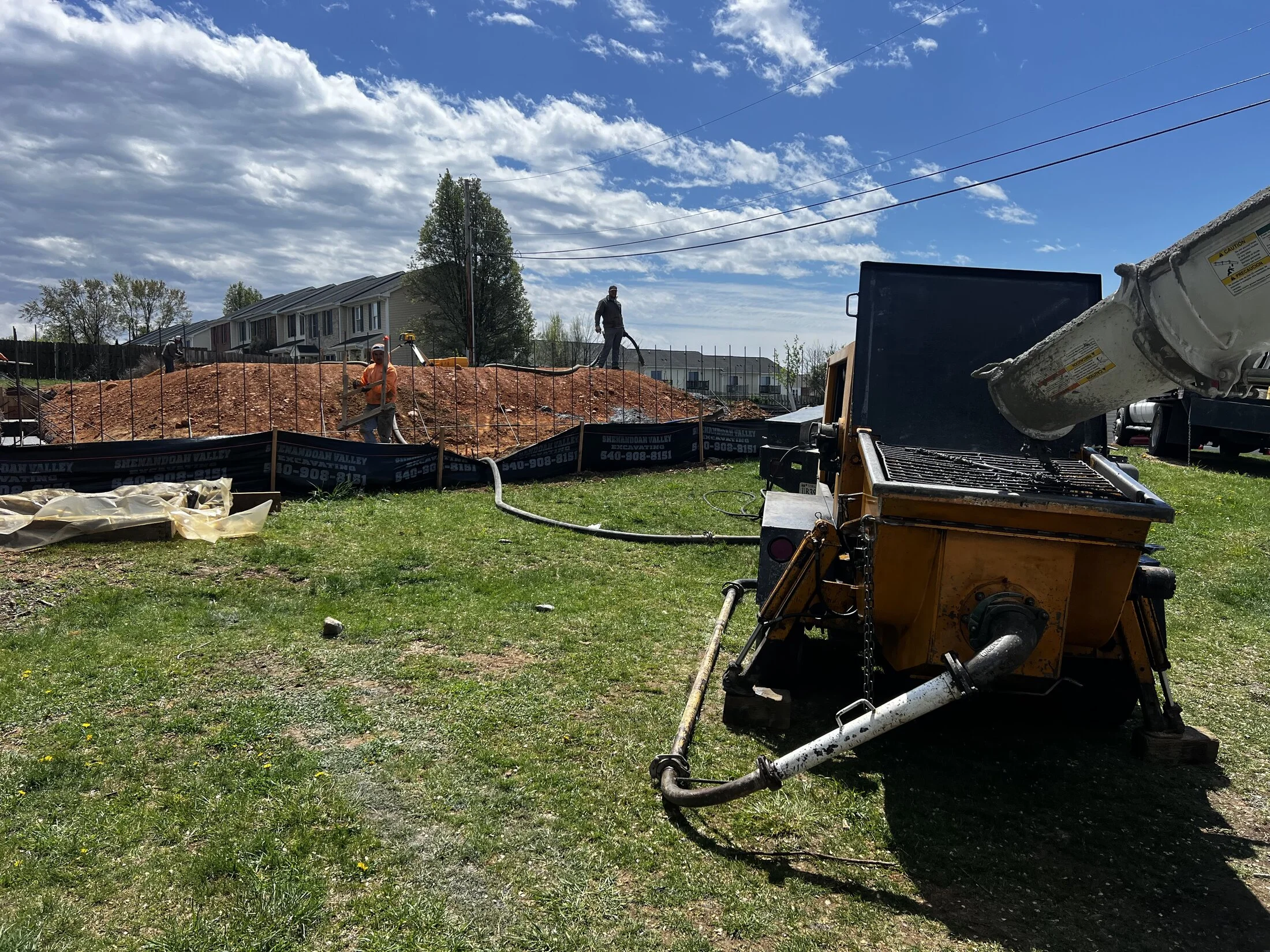

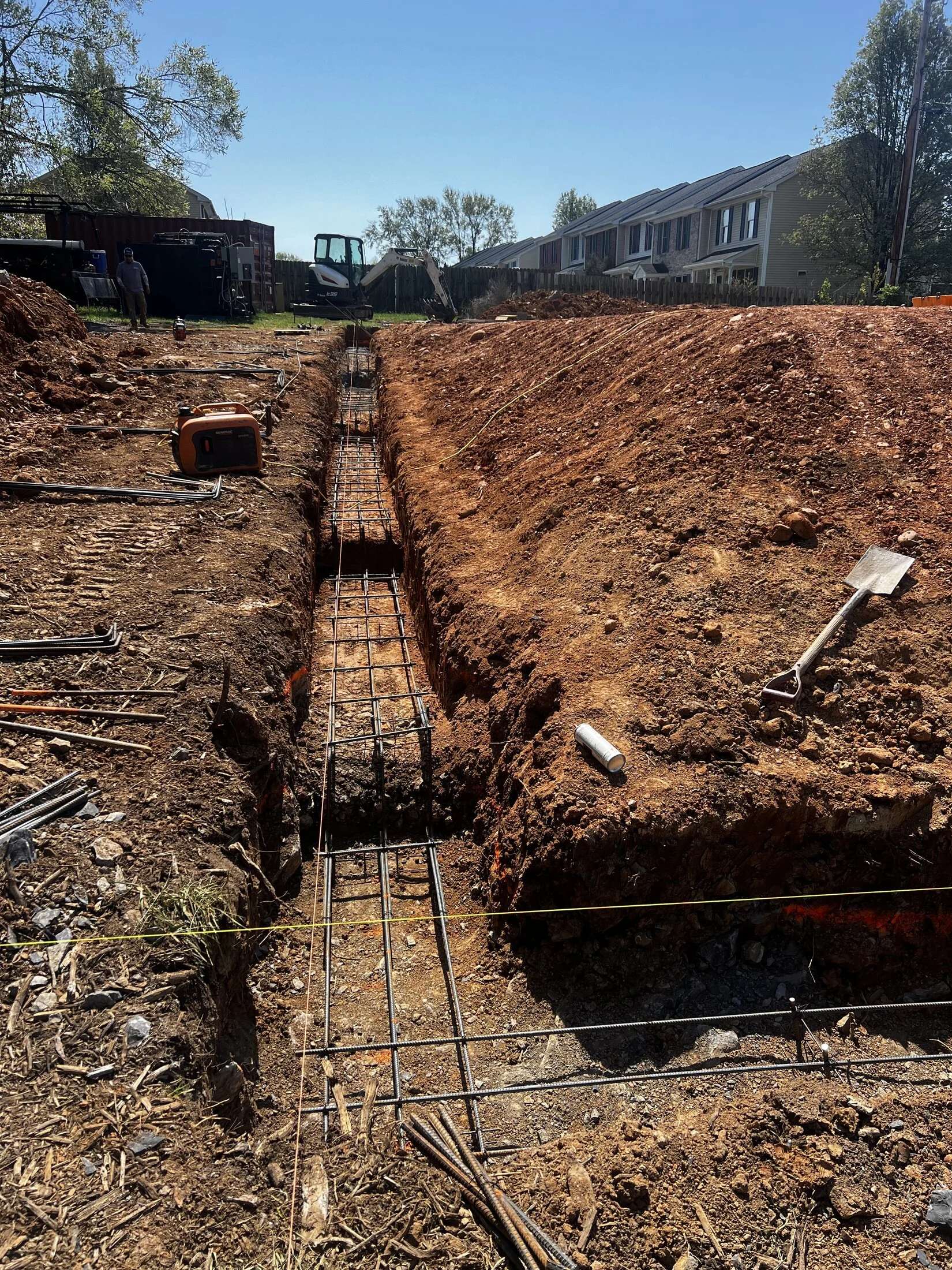

Footings were dug while I was down at Relic Run in NC and they pumped concrete today. Concrete walls being formed this week and then pouring foundation walls soon

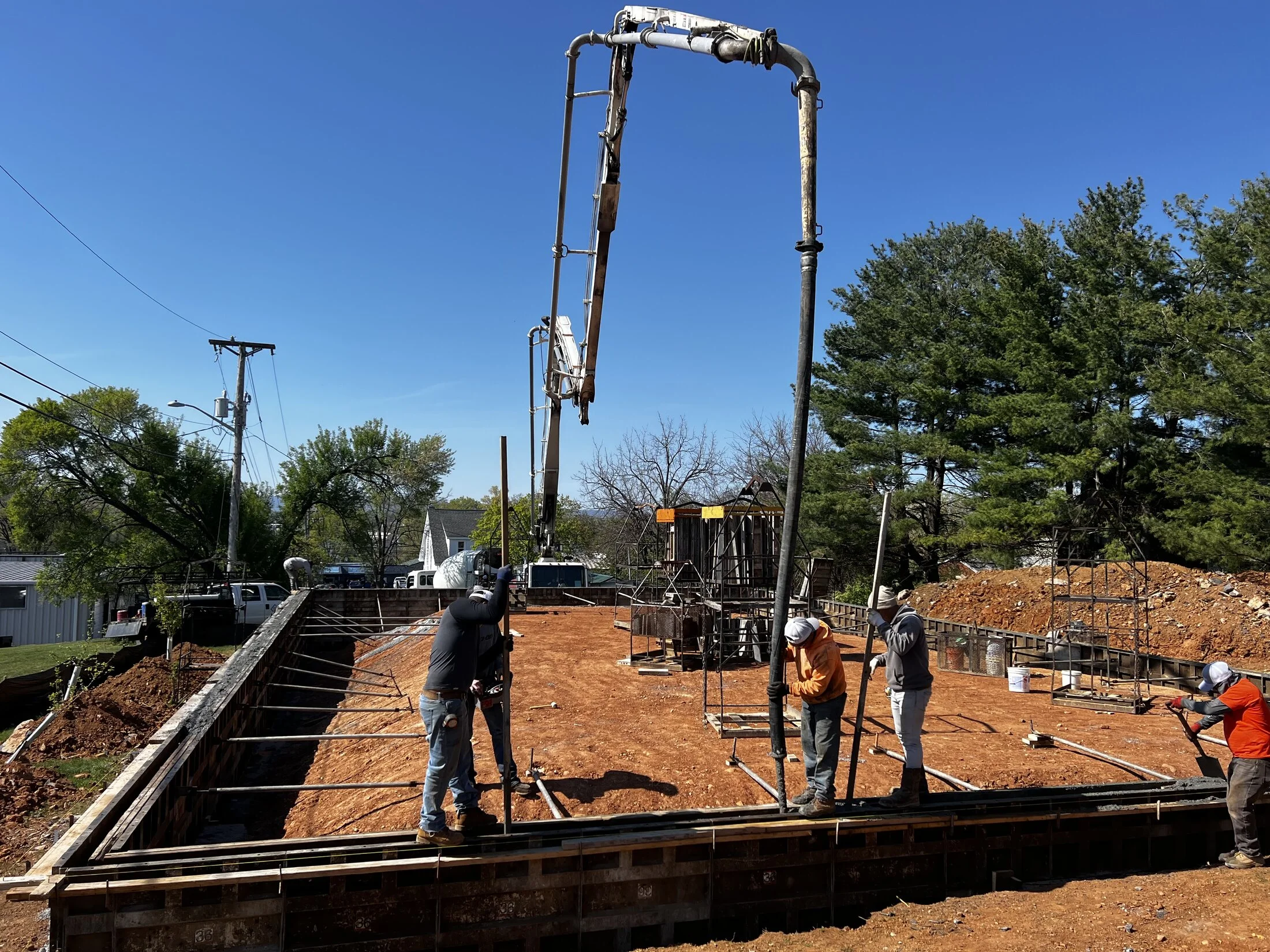

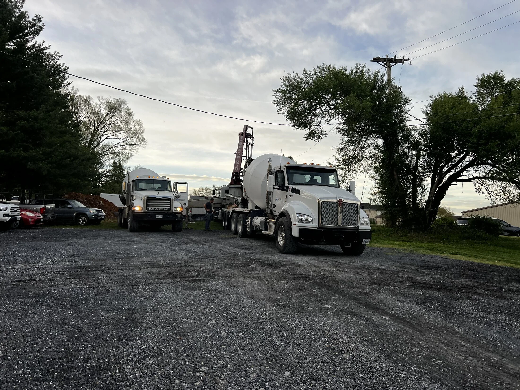

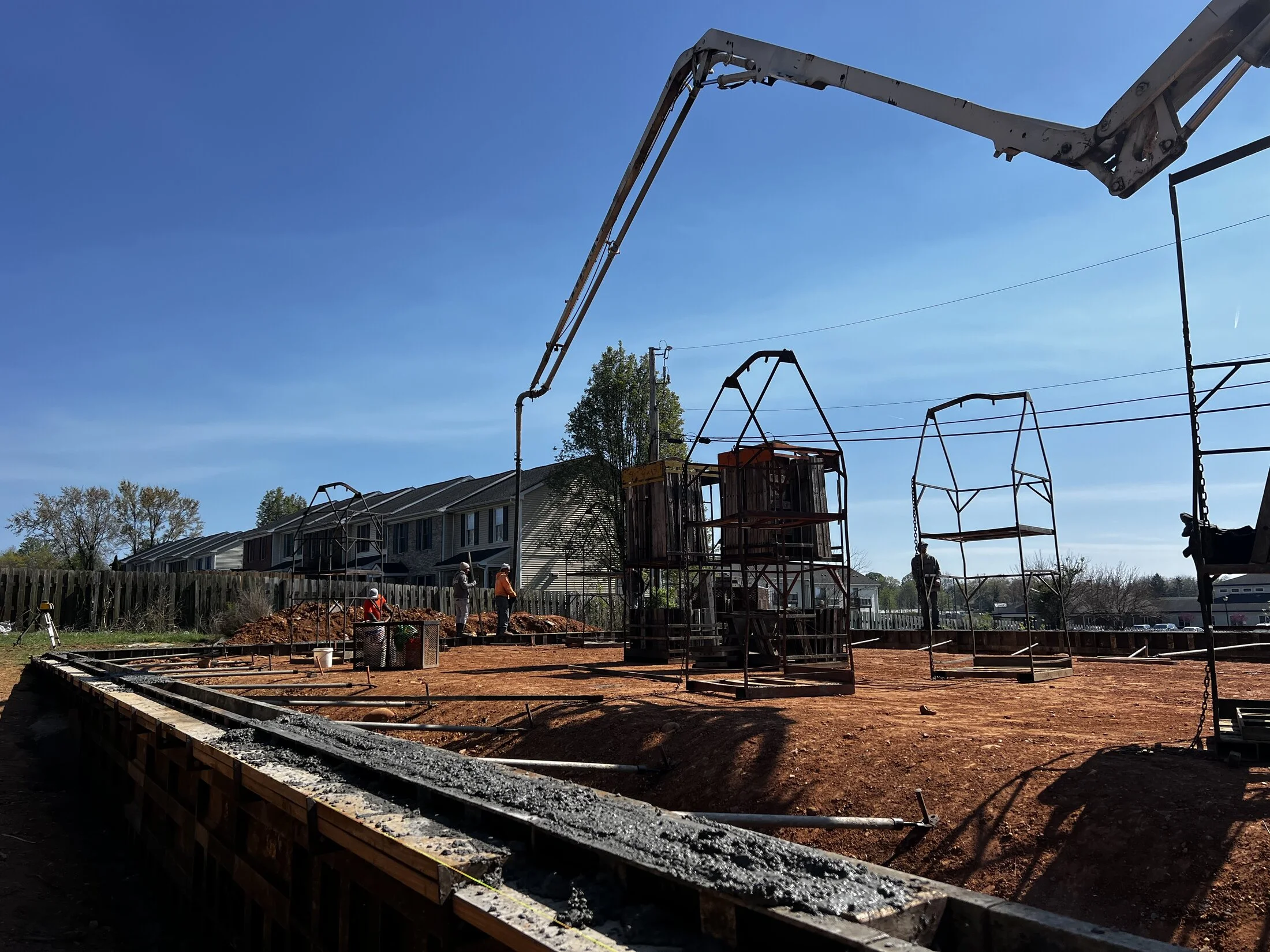

Walls were pumped full of 30 yards of concrete. Pumper’s horn beeped and then they ran out just on the last spot. They calculated it at 29 yards. Whew!

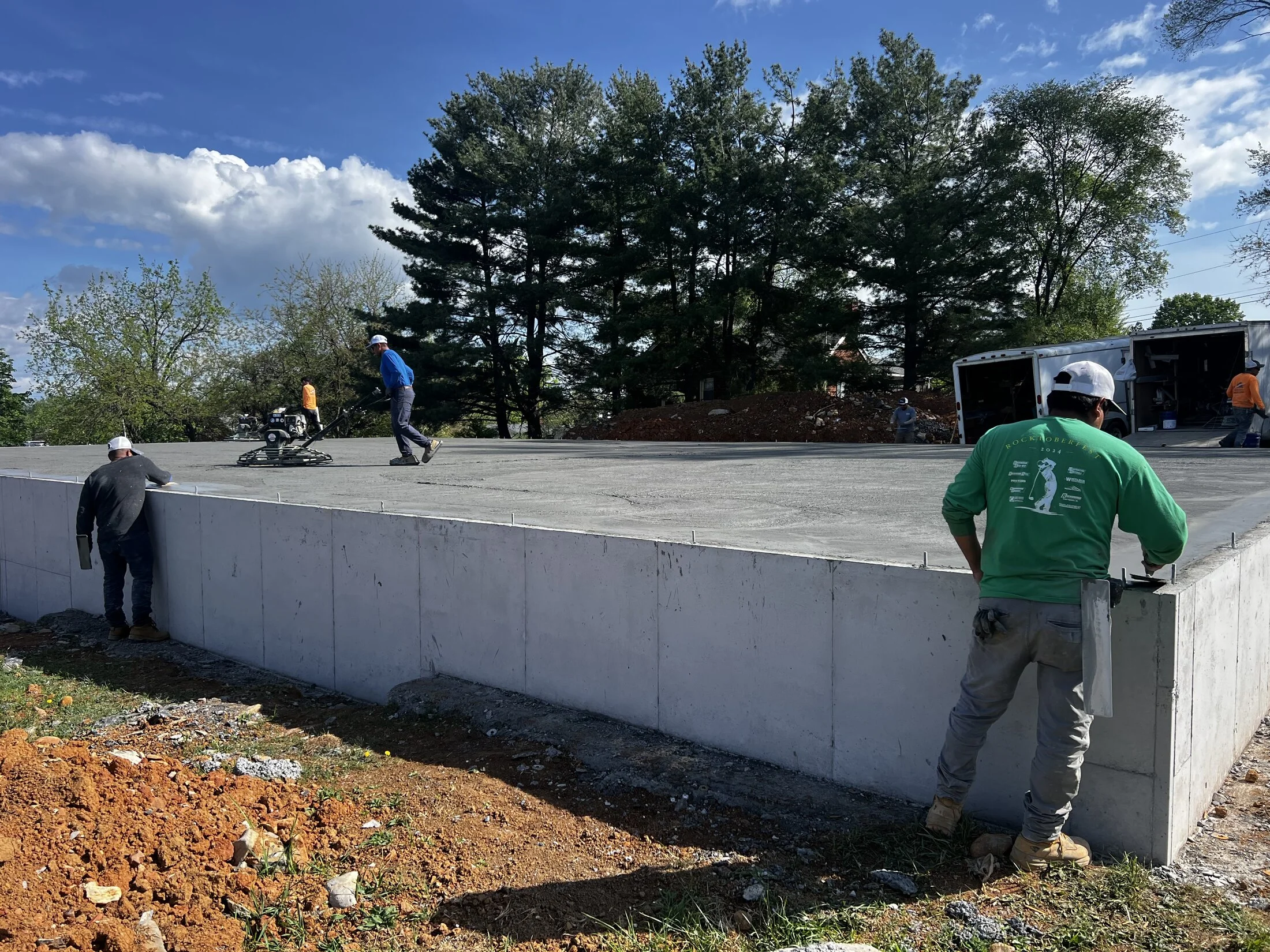

5” Slab will be up next after they fill against the walls. There are three 12’ wide by 14’ tall doors going along the one side of the shed

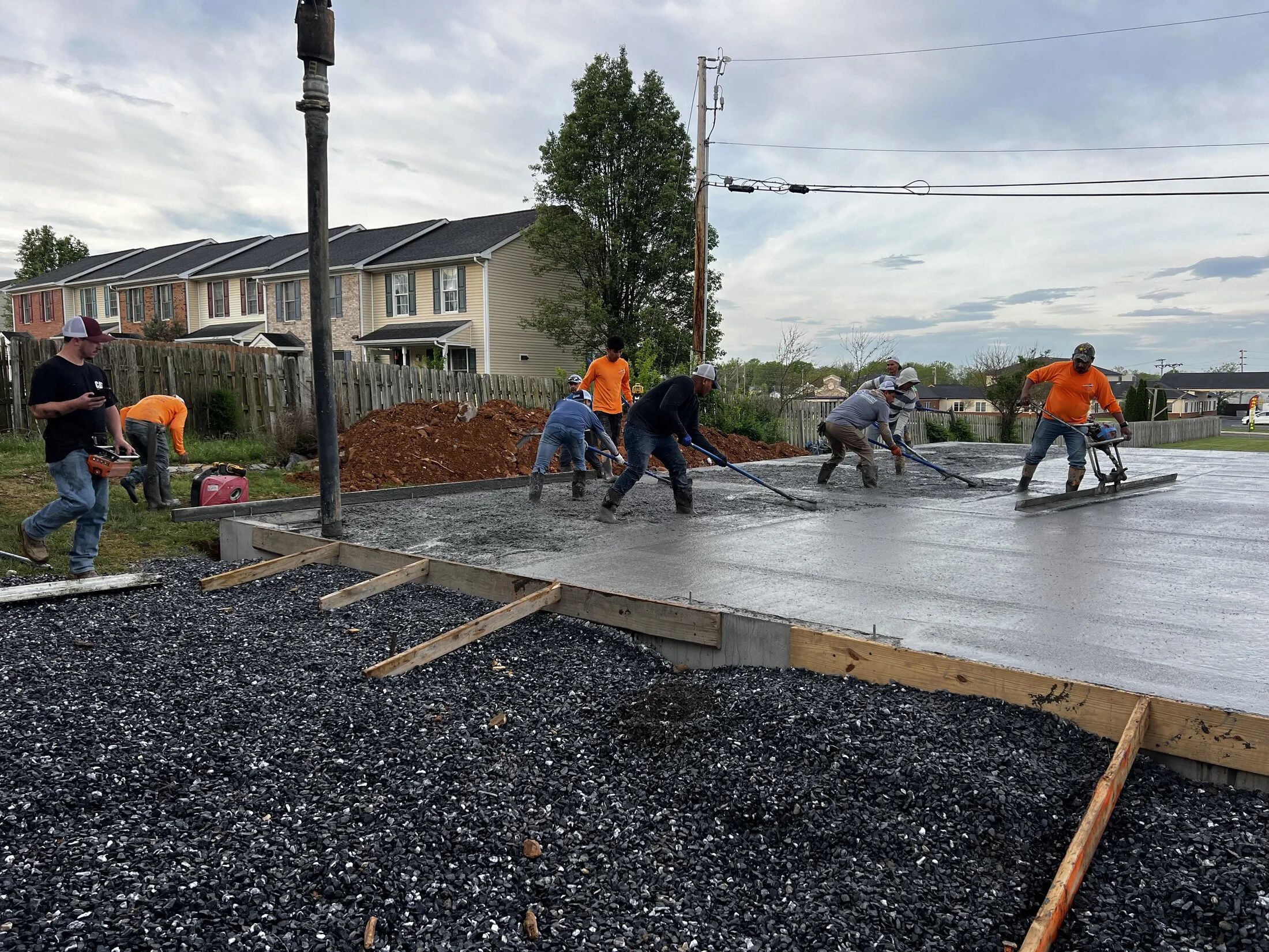

61 yards of concrete went down this morning starting at 5:30 am. Sawcutting happened right after lunch. Stay tuned for costs as they roll in on this project

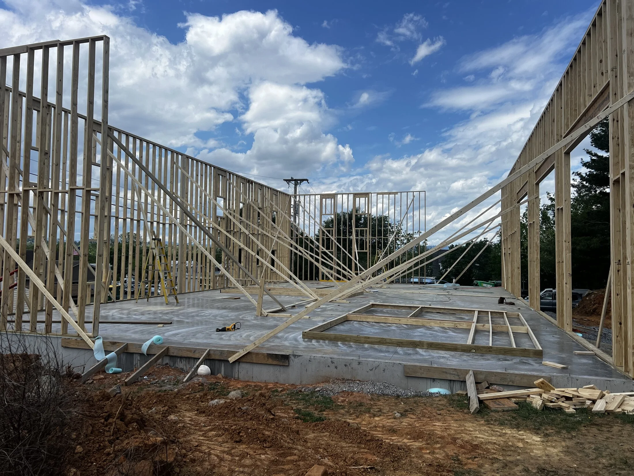

They ran out of the framer series studs with 20 to go so we went with syp #1 studs at 12” on center versus the 16 for the Weyerhaeuser framer series
Trusses are delayed a week so hopefully they can get back onsite after they finish the walls tomorrow.

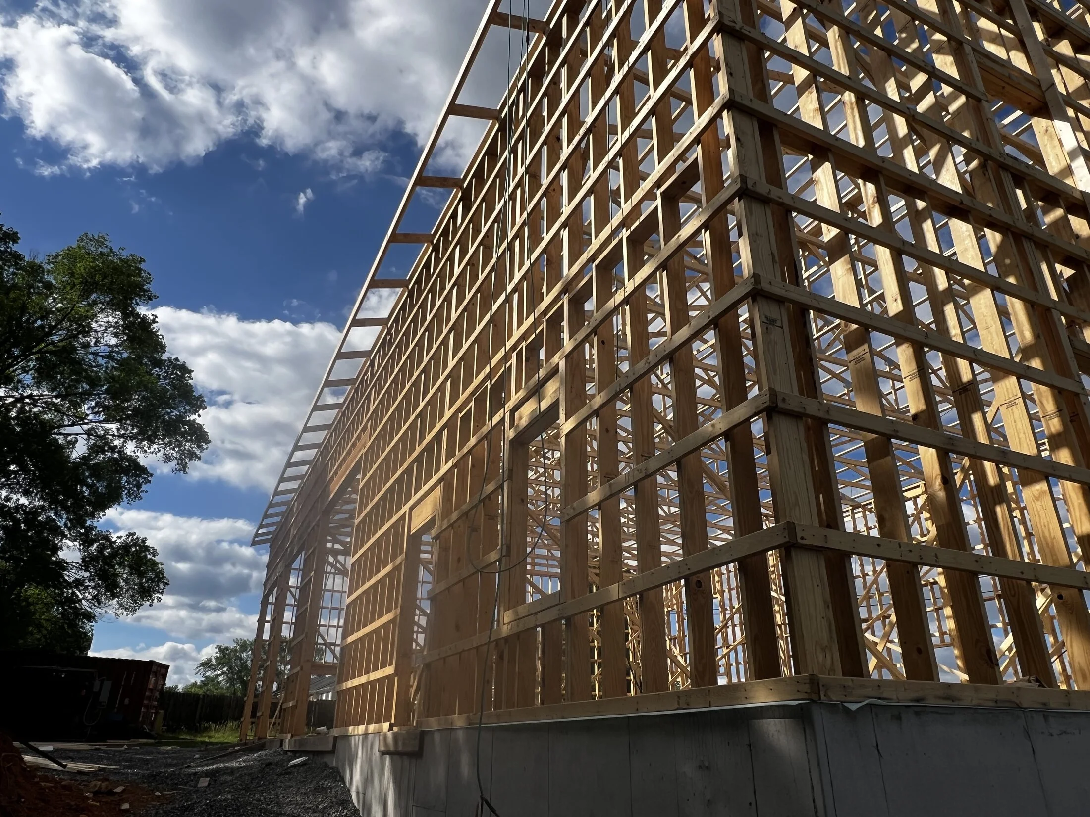

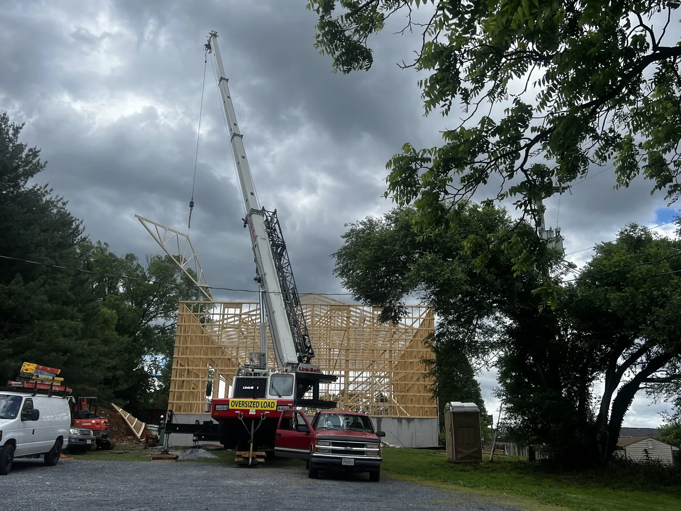

They got the trusses on, purlins on the roof and girts on the walls. Metal guy was there today getting the measurements for metal hopefully installing next week
136’ of stick out on the crane to set the trusses
Nice progress. You will have that dried in soon since you're going with metal siding and roof.
I assume as a structural engineer you looked at a red iron alternative? It seems like the cost advantage of wood would decrease with walls that high but maybe not. Just curious what the cost/ft2 difference is between the two, assuming you compared them.

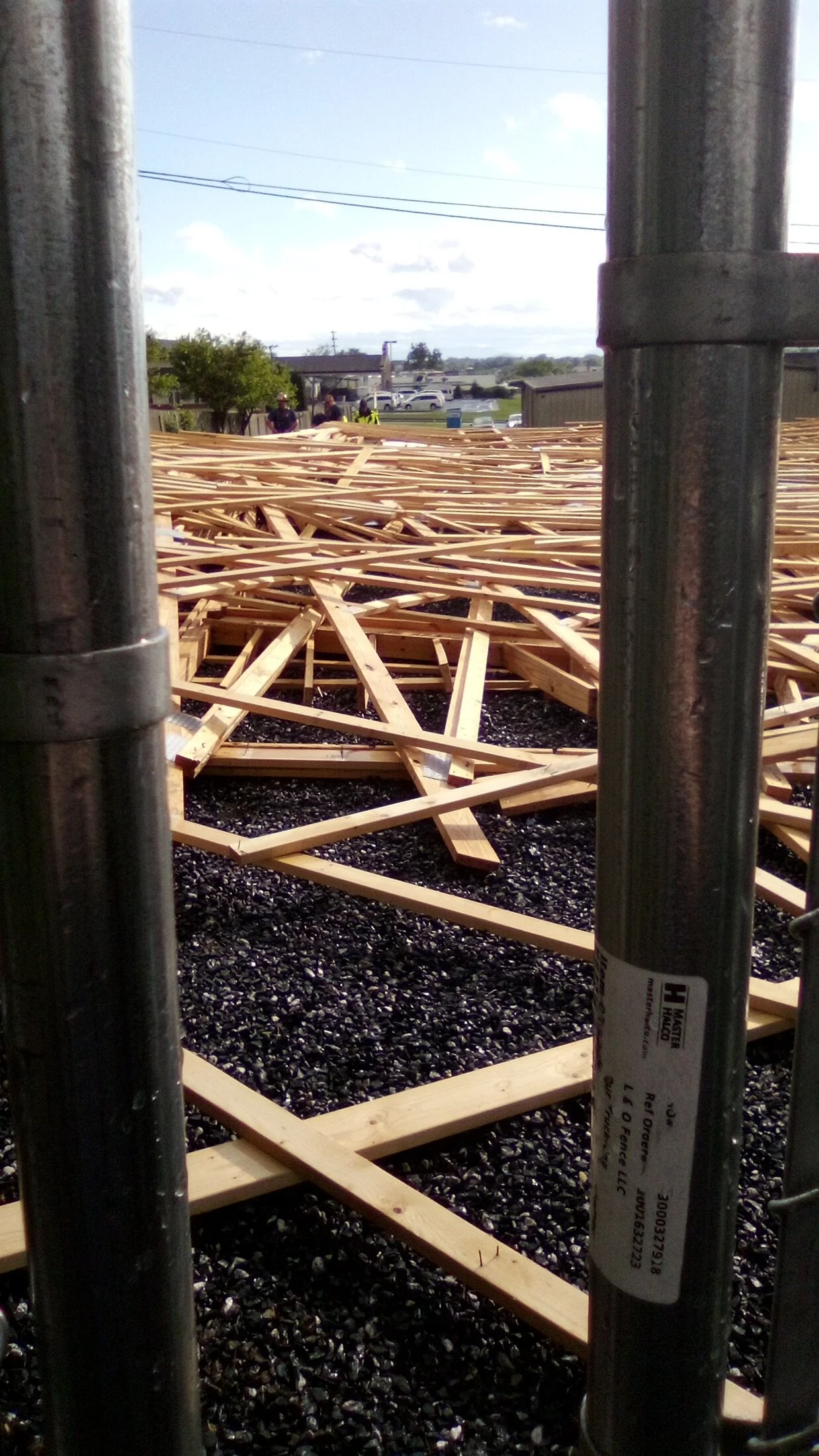

Last night we went to a small fundraiser for a church we had done some engineering for and the kids provided some amazing bluegrass music. And then my phone started blowing up. First from a friend and then from a firefighter. Then texts from friends, neighbor, and business partner.

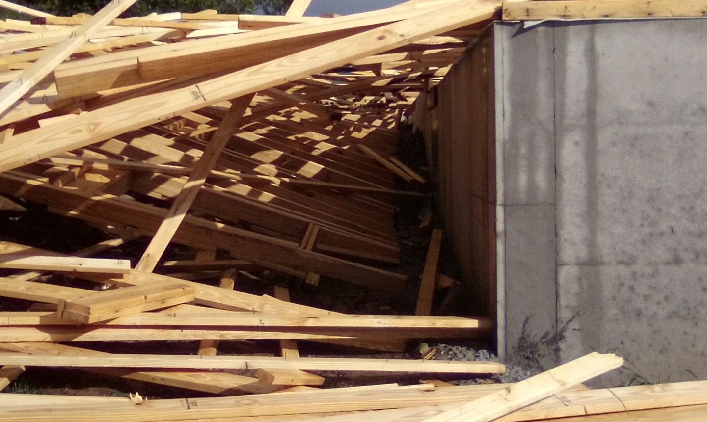

The building is now flat. Strong winds and not enough bracing would be two factors. The builder had builders risk on it so looks like it is gonna go for round two
Oh man. That is almost unbelievable. Very sorry indeed. Probably fortunate it didn’t happen on a work day.
A friend was asking me about it yesterday and how I was so chill about it and you are exactly right @WarDamnEagle - materials can be replaced. It it had hurt or killed one or more people, I would be heartbroken. For now it is just an inconvenience
we had some pretty strong winds over here as well, really glad no one was hurt.
Zero diagonal bracing. Brutal.
Hope they get it cleanup quickly and there's no problems with reordering materials.
