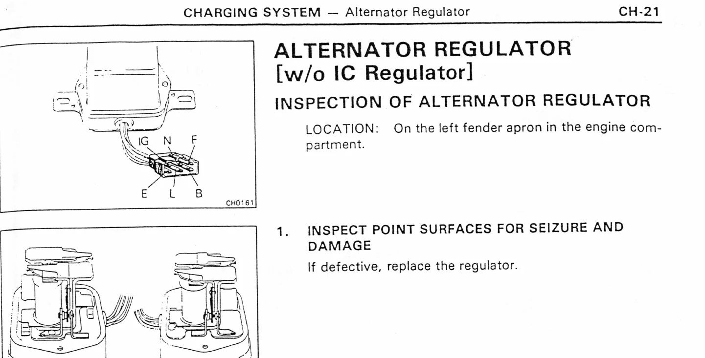

Mine is on the right side fender (right when sitting in car and looking to the front of the vehicle )(passenger on LHD), not far from the alternator, just follow the wire. There is really good info here on MUD how it work and how to test it.
I would definitely do it... You want to keep your alt healthy in a BJ since the alt/vac pump setup is hard to replace.
Mine is on the right side fender (right when sitting in car and looking to the front of the vehicle )(passenger on LHD), not far from the alternator, just follow the wire. There is really good info here on MUD how it work and how to test it. View attachment 2487114

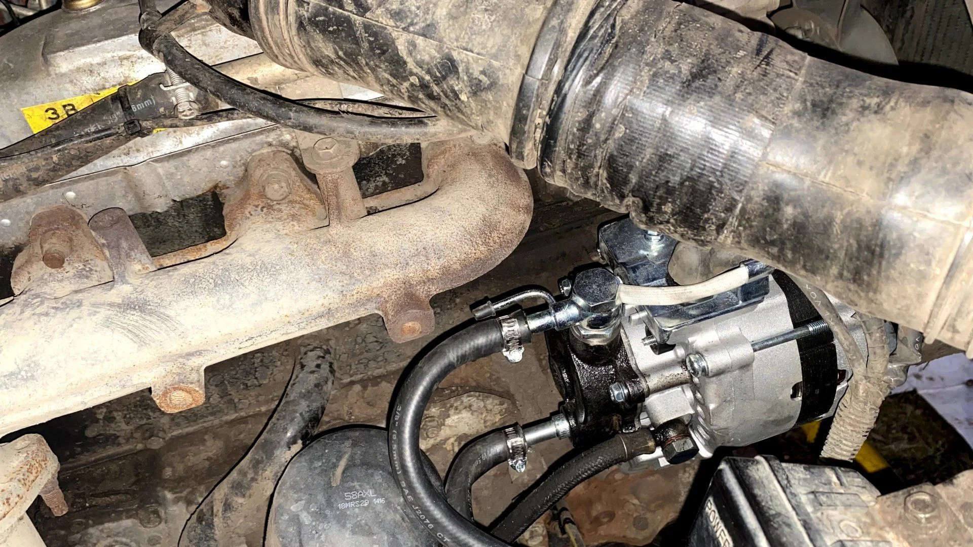

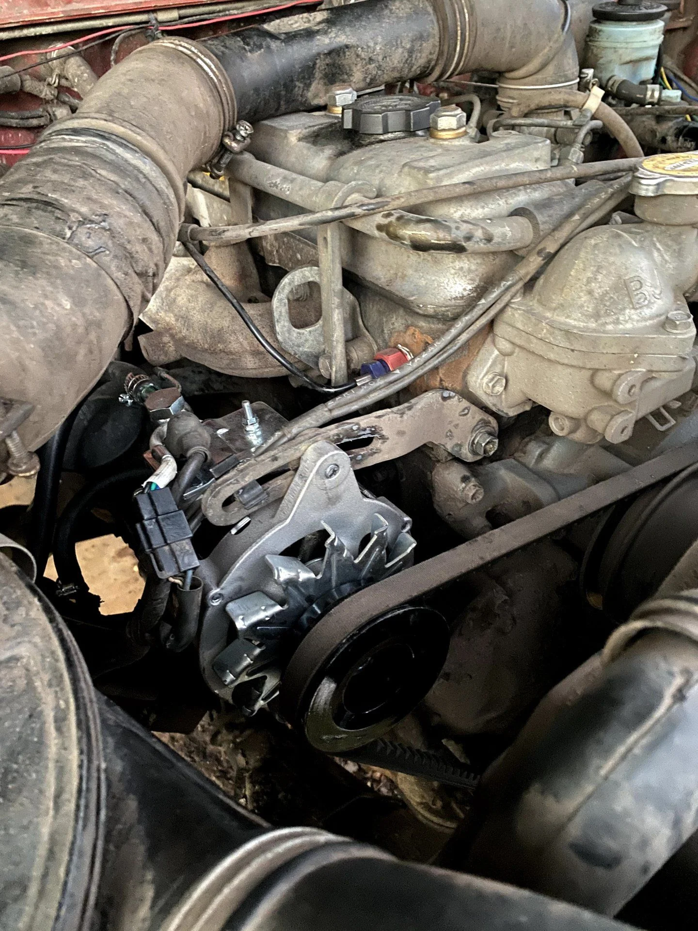

Well I lucked out and it was my alternator, that I had already purchased, instead of the regulator. The aftermarket one had some funky elongated fittings for the vacuum pump so my dad and I custom made some hoses that will hopefully hold up for a bit. Now just to figure out how to rebuild the OEM alternator... If anyone comes across this thread in the future and wants to know what the problem is 100% before shelling out $$$, then do whatever tests you need to do to figure out if it's the alternator or regulator. Thanks everyone for the help and suggestions! Much appreciated :)
