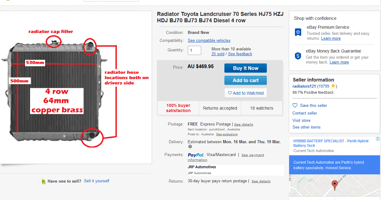

Anyone contacted this seller (99.7% rating) and see if he will do a group buy or maybe even a single unit to an overseas destination?
Mmm yes correct. But he has sold 18000 radiators and related items in 13 years, so maybe he let the office lady put the ad on ebay.
You can only ask the seller. The ad does say HZJ HDJ as well as BJ7*, so maybe they pulled out some generic pic

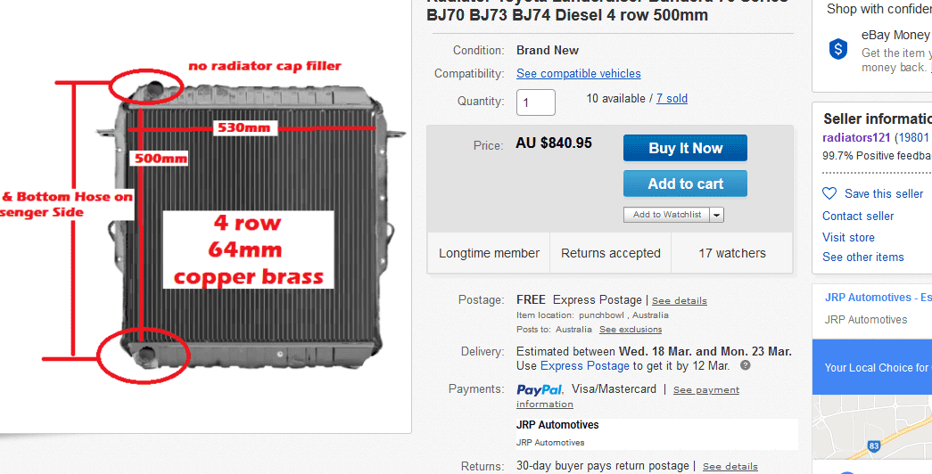

Looking through his stock list, he also has a left hand in/outlet for the B engine but the price jumps up to $840 AUD and they dont have a radiator cap.
Correct because most B engine iterations have the cap built into the top of the thermostat housing.
The radiator has no cap and has a boss for where the cap would reside.
