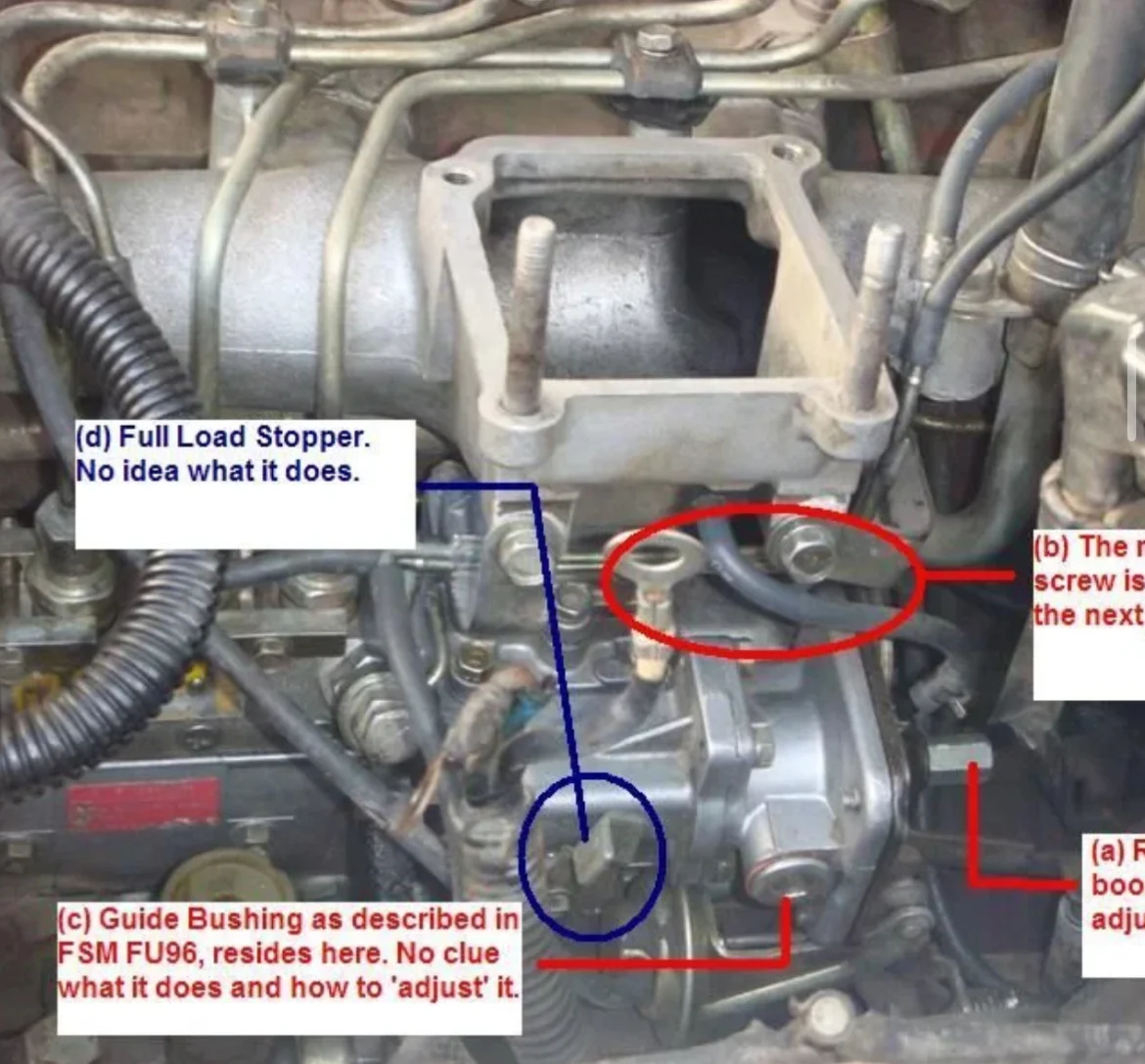

The 13bt does have a fuel stop lever you can manually move to shut the engine off.
In this guys photo it’s labeled: full load stopper no idea what it does.
It shuts the fuel off 😊. You could rig up a cable inside the cab to pull it for a manual shutoff.
