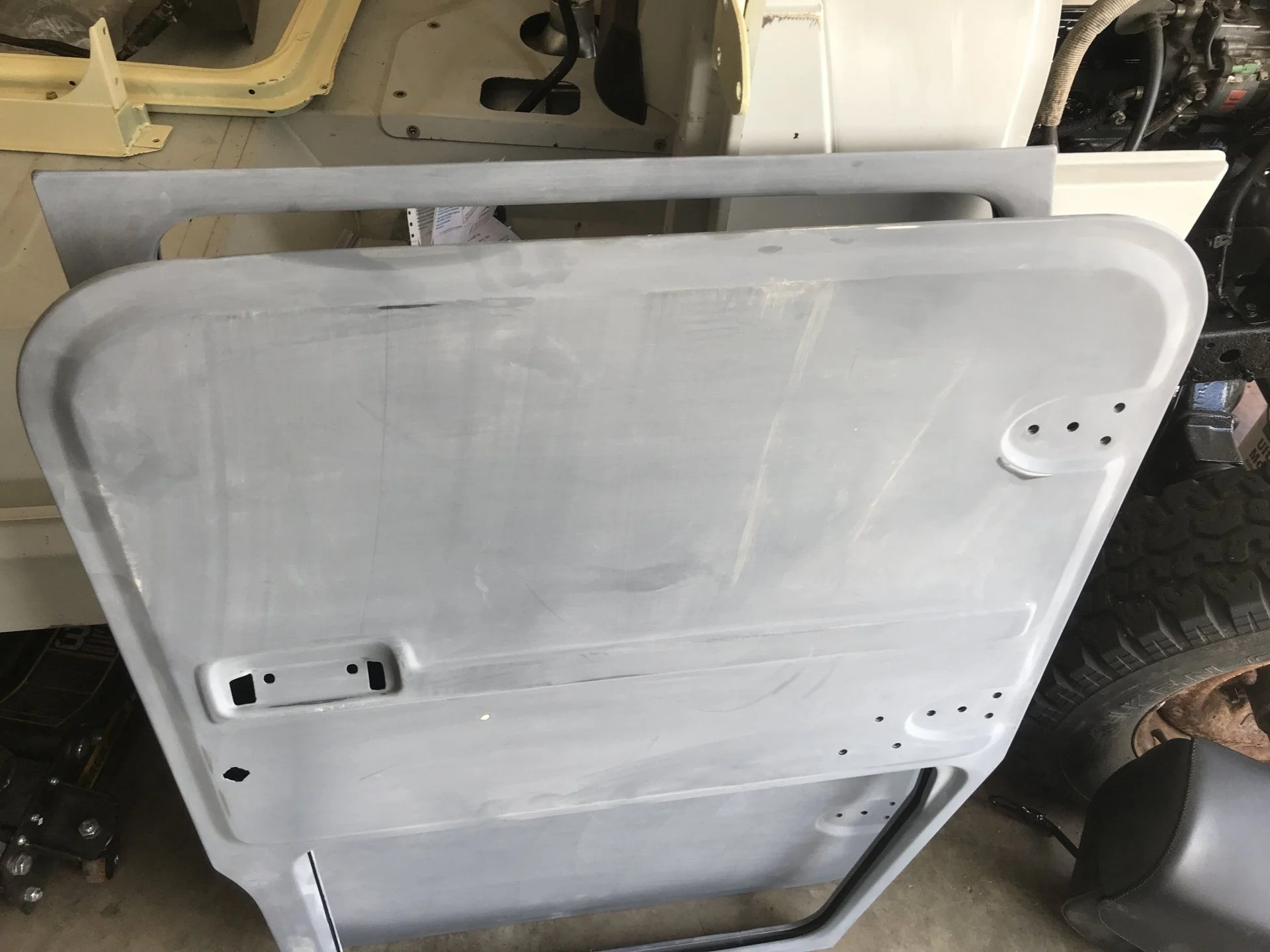

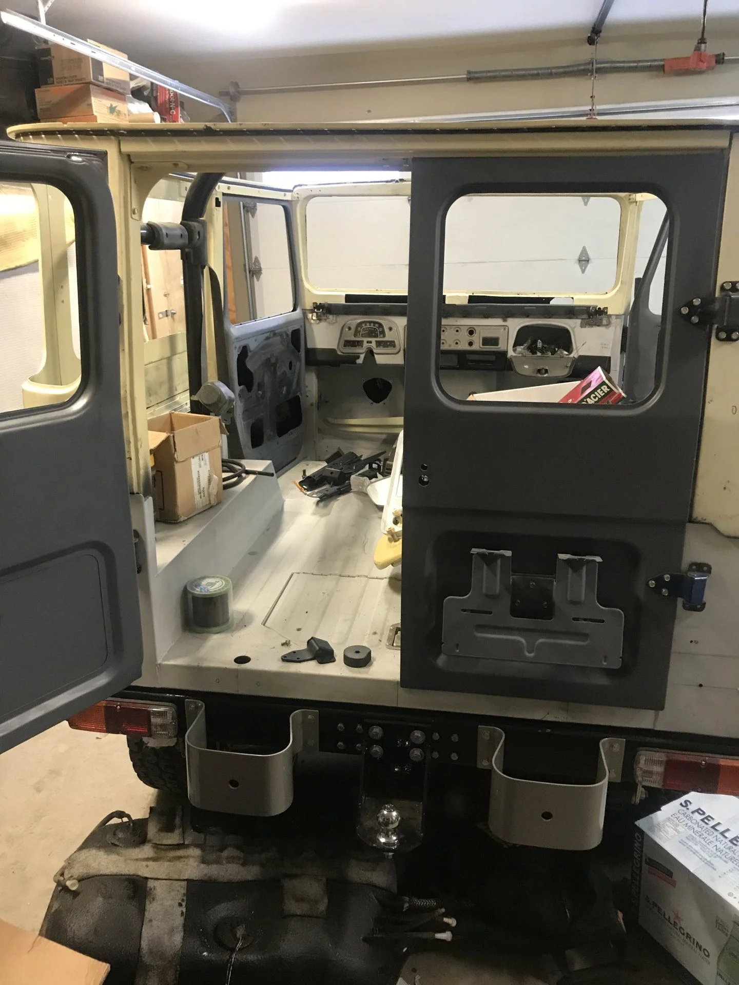

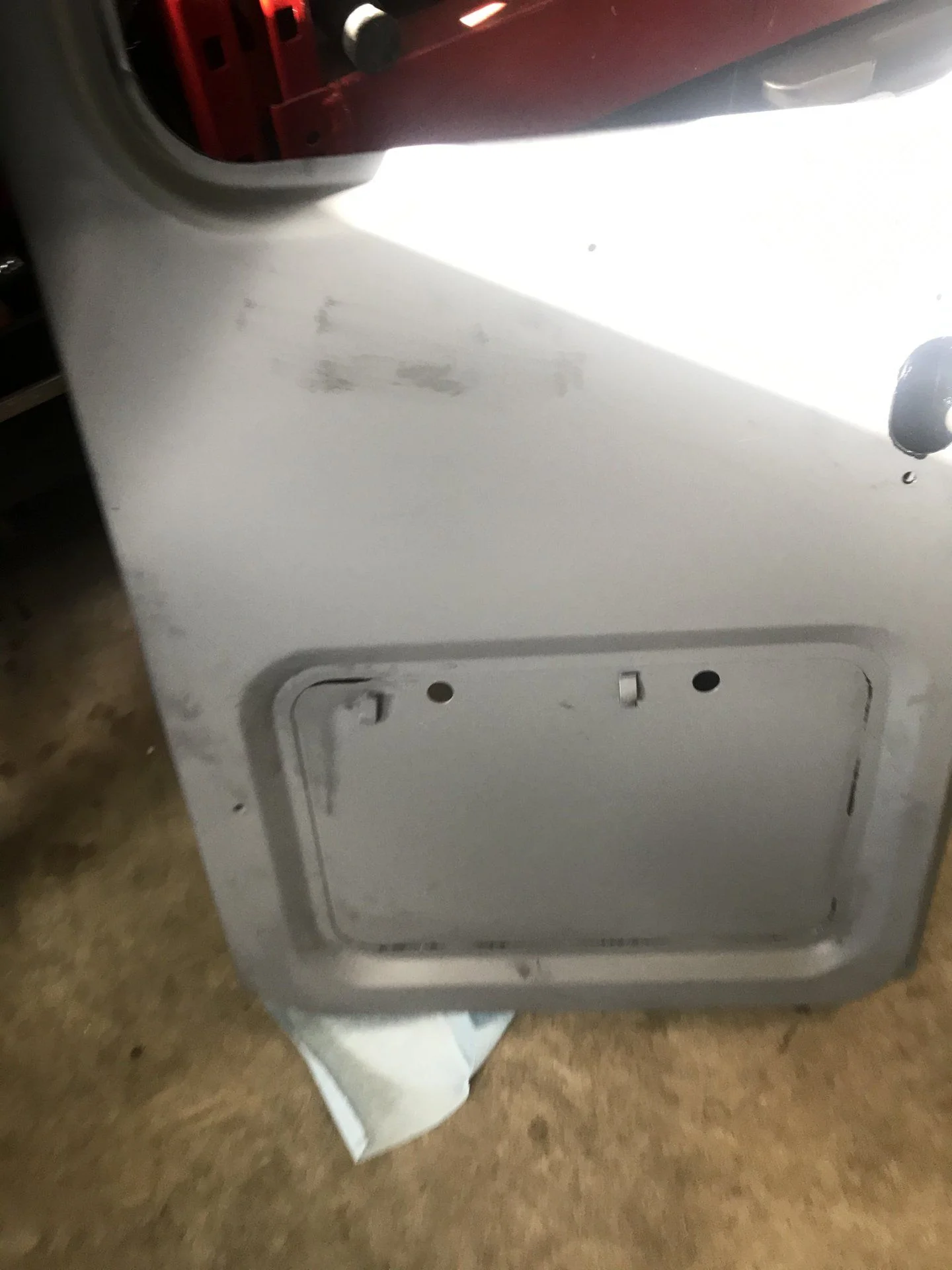

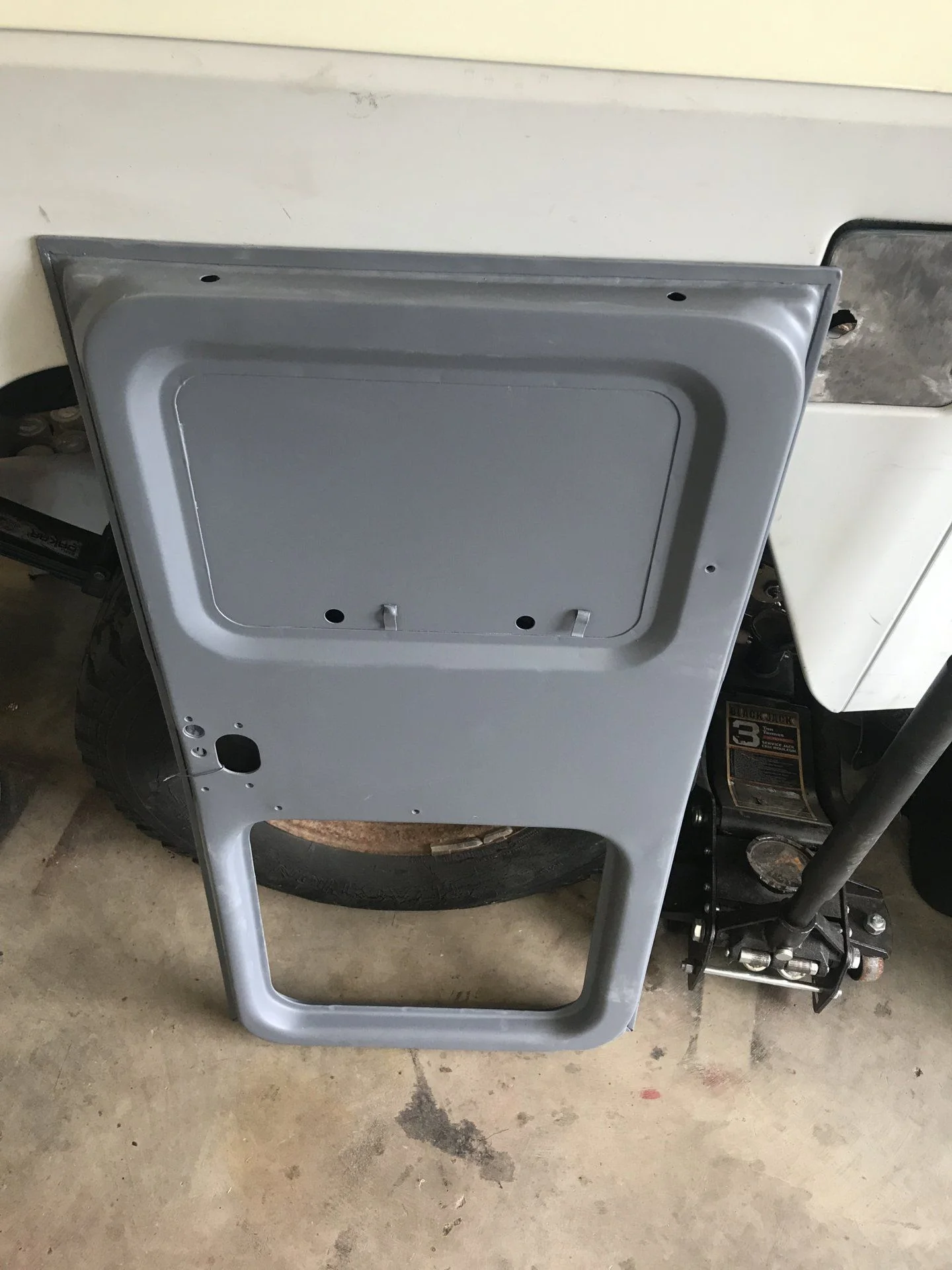

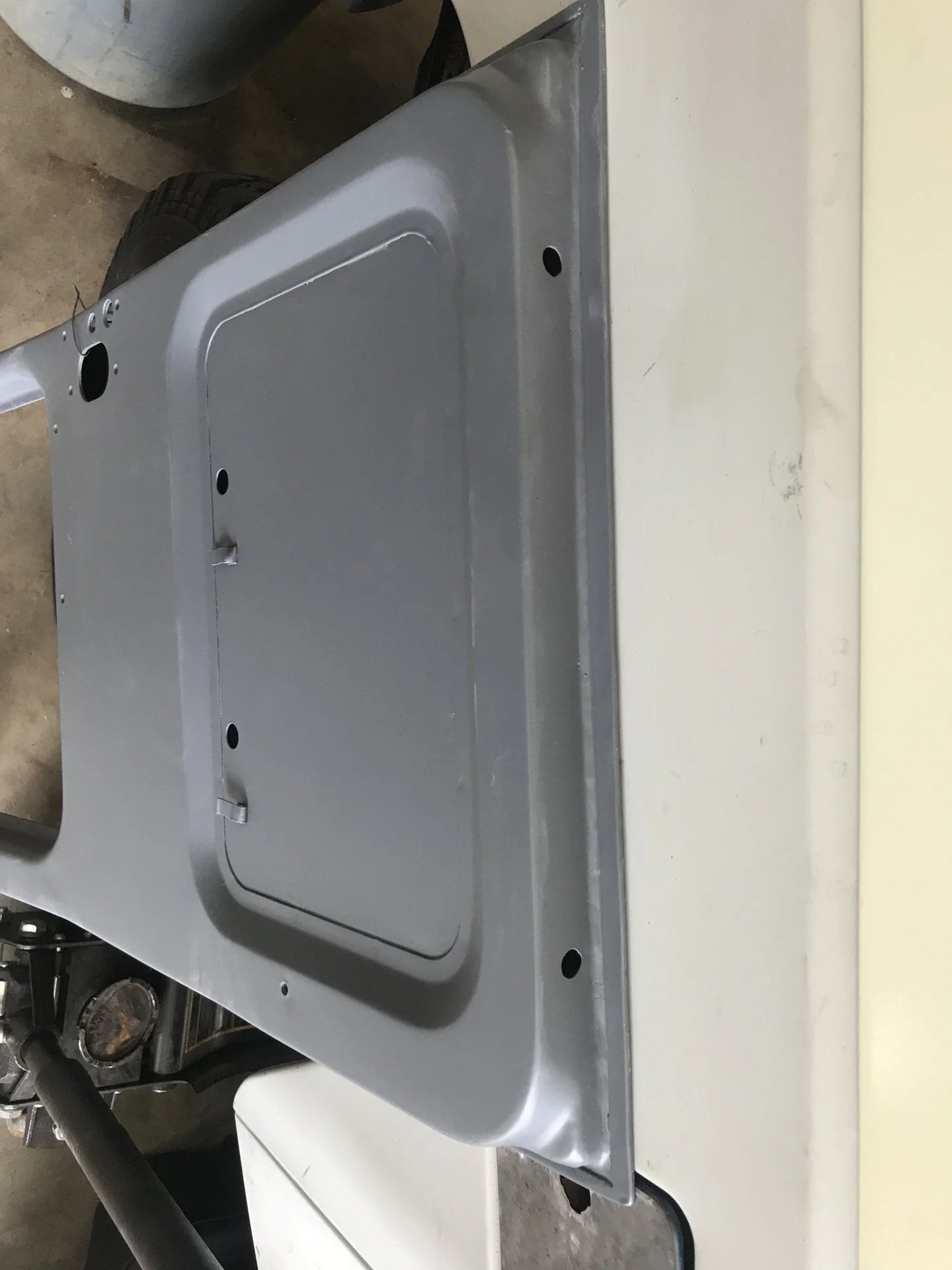

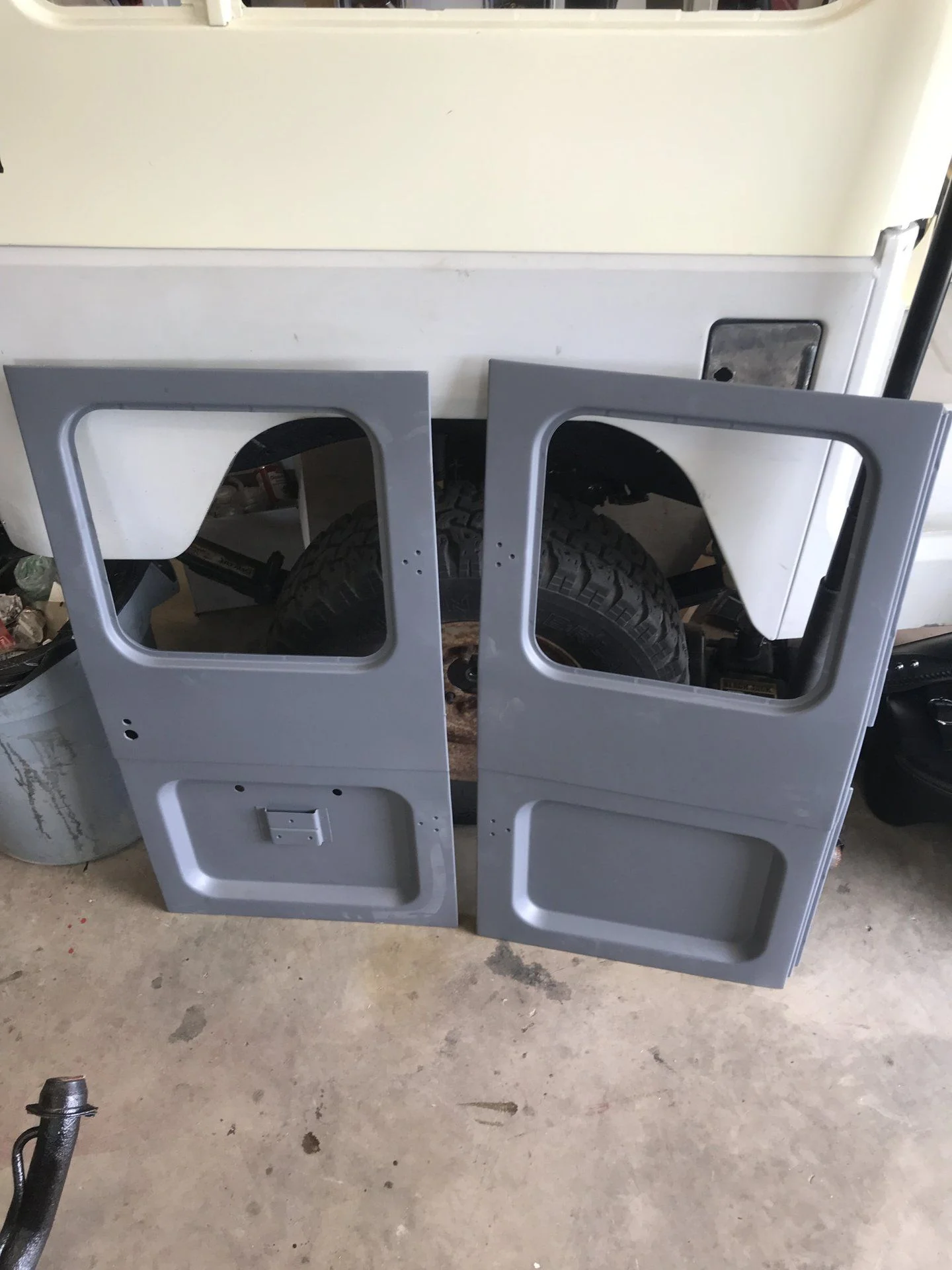

In the mean time I got my 4 doors back from Oceanside Kustoms and they look absolutely amazing. They should for what I paid for them, it was double what I budgeted for and I could have welded them in place myself but I felt that I’ve gone the extra mile so far why cheap out now. Thank god for extra shifts on the Tugs is all I can say.

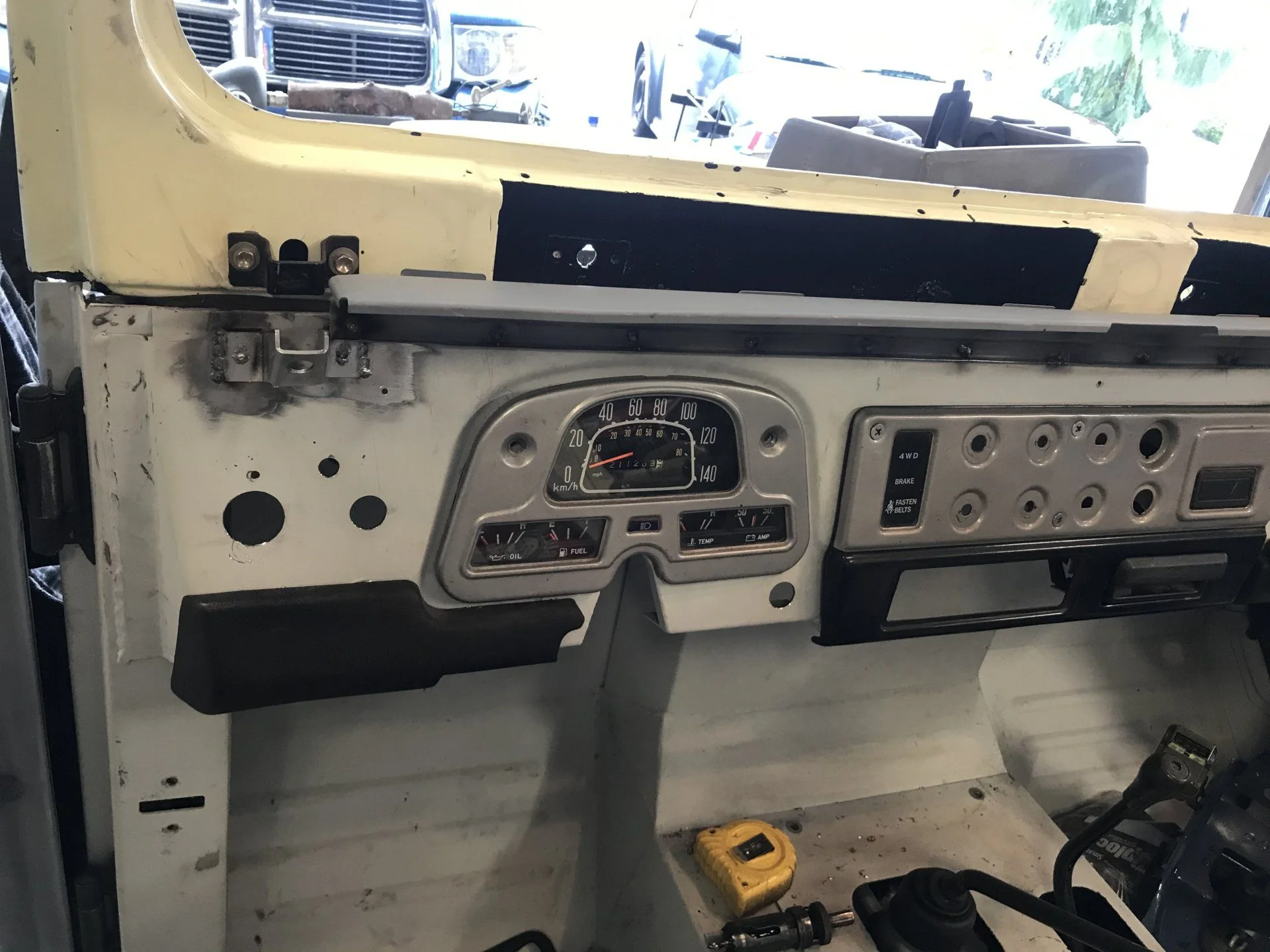

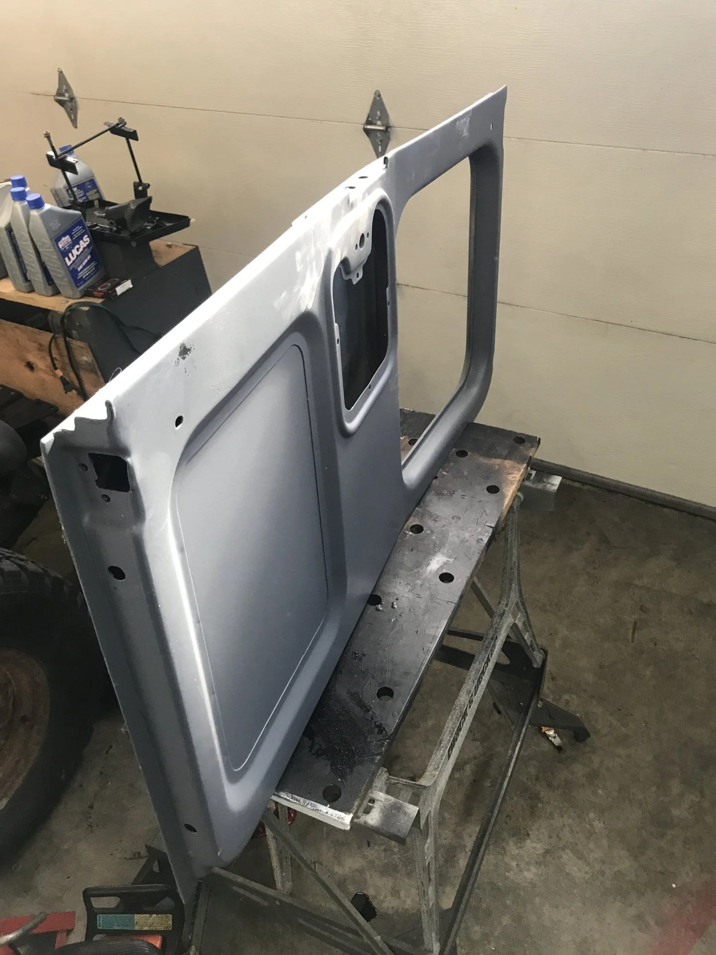

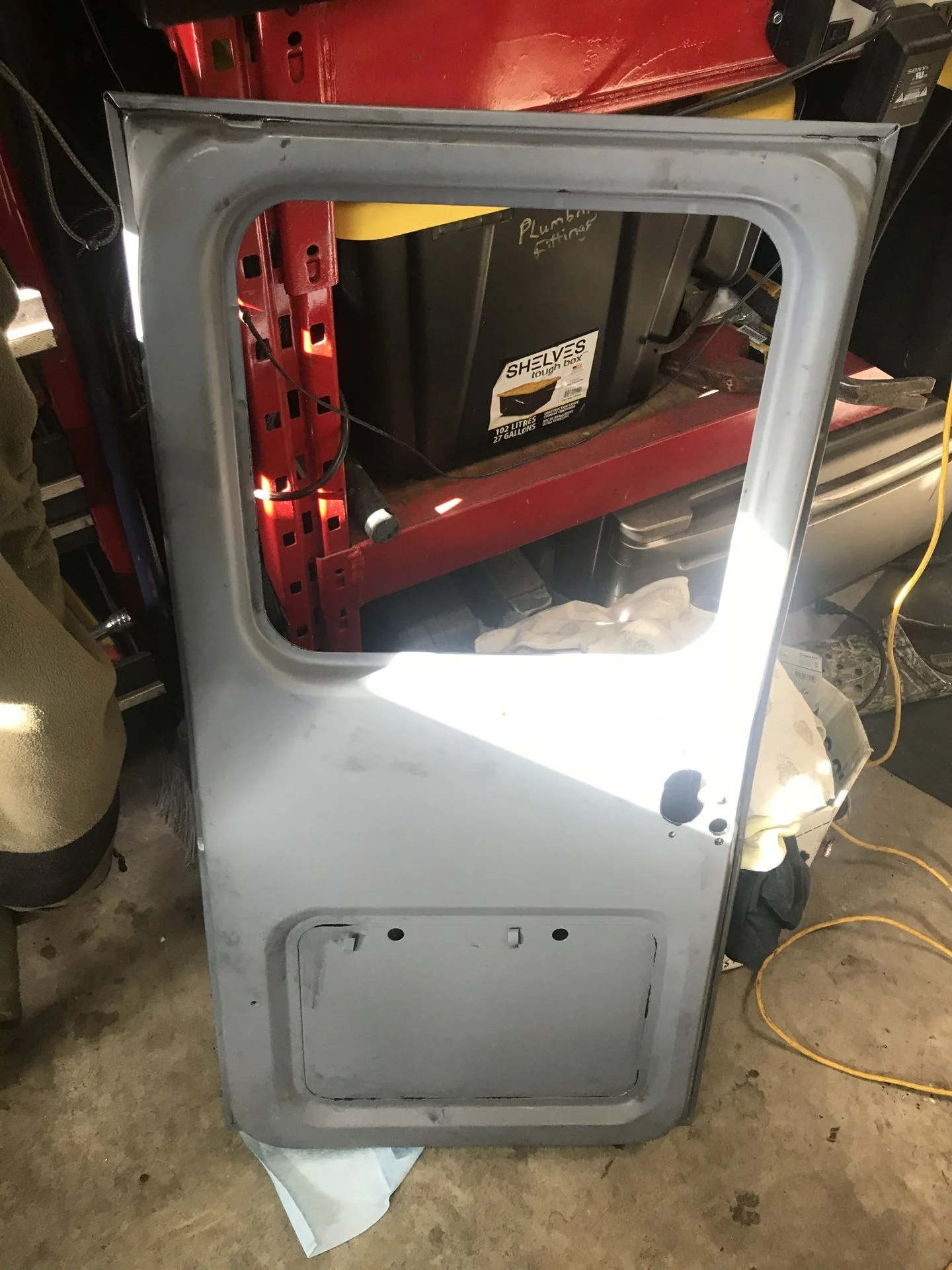

Todays project is to POR15 all the door seams and the windshield frame.
I pour some POR15 into a plastic bag and nick the corner and spray it inside the ambulance door frames.

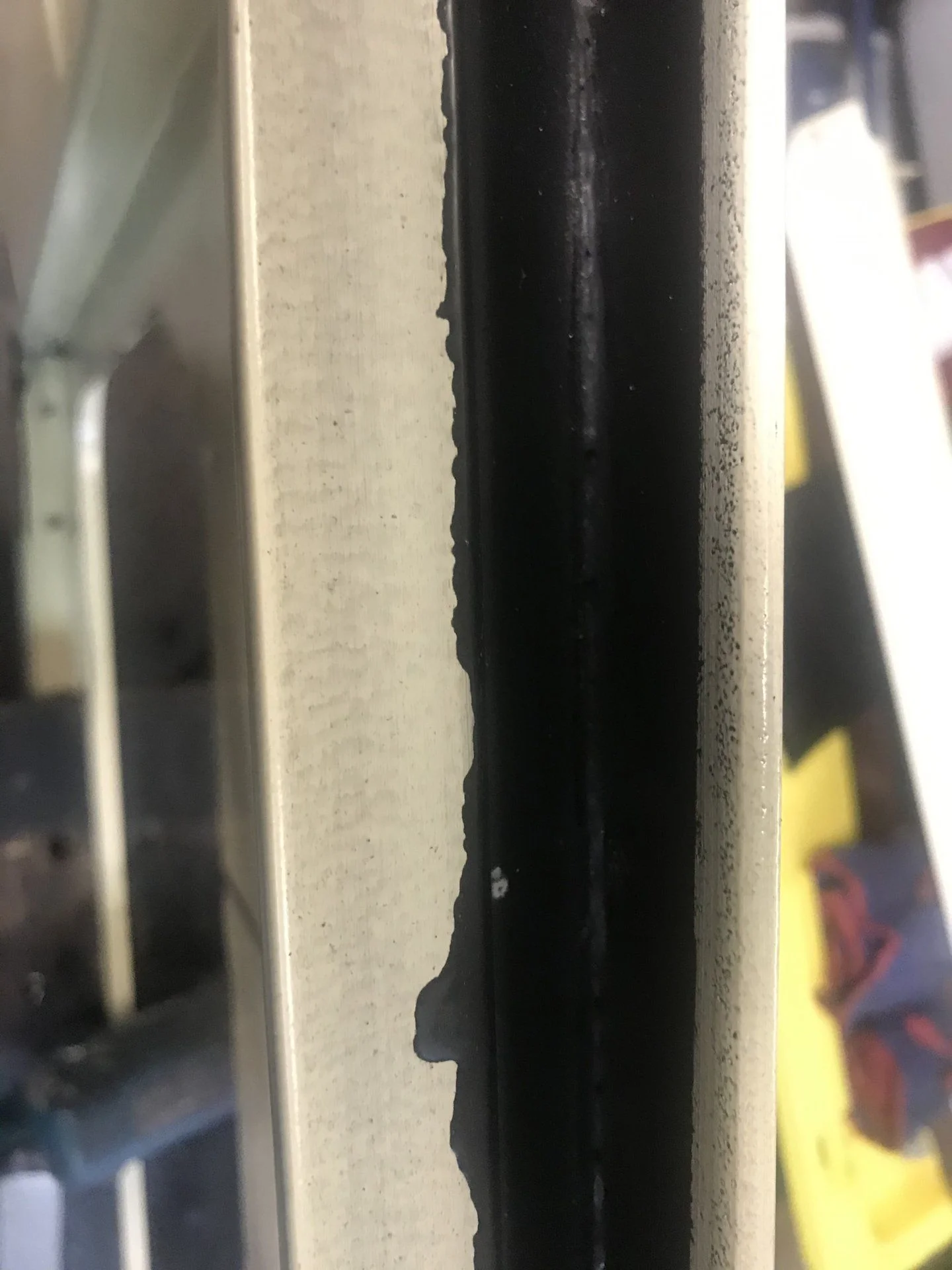

The front doors I just used a brush to cover the bottoms and seams where I had the new steel welded in. I roll the doors around three or 4 times until I figure I have it all covered and then drain the excess into the garbage can. The seams sweat black POR15 for quite awhile so I keep wiping the excess until it hardens . Be careful not to plug the door drains.

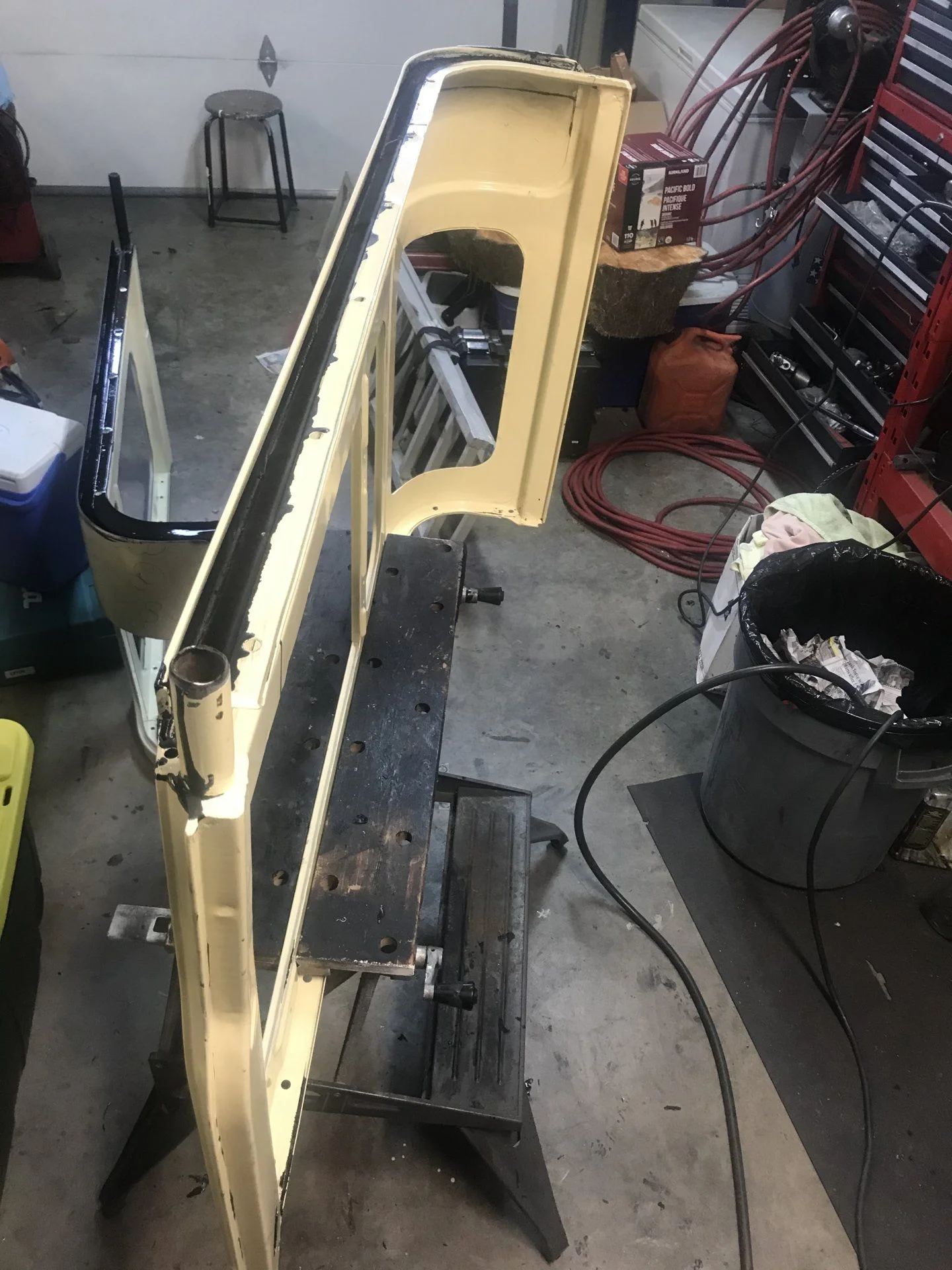

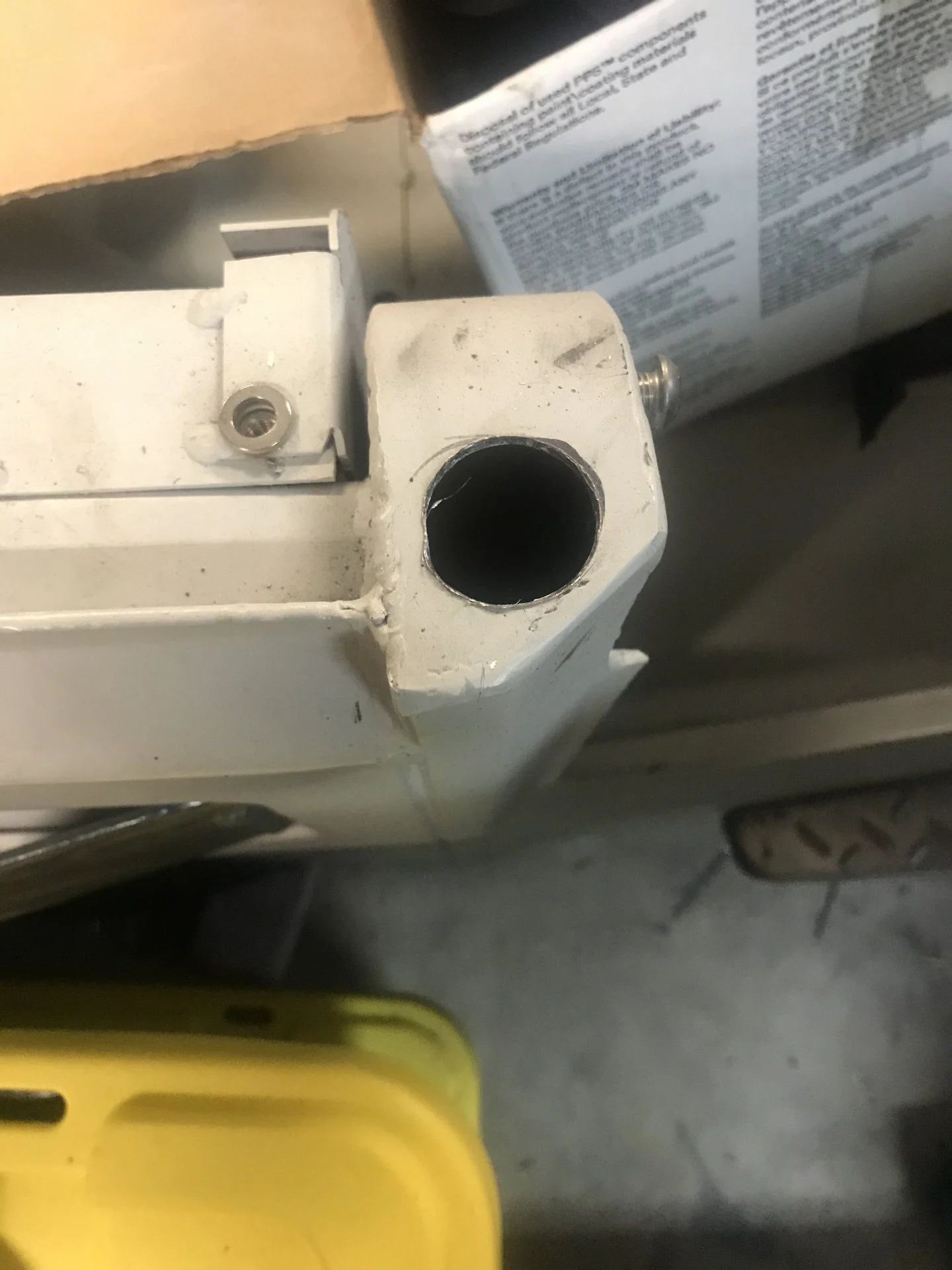

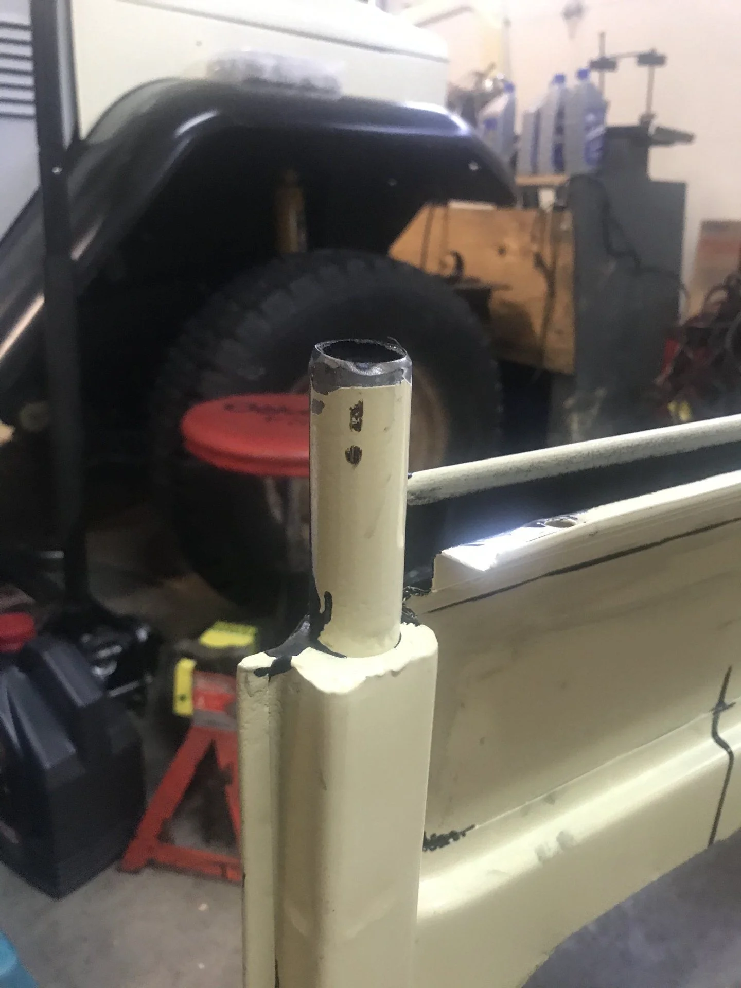

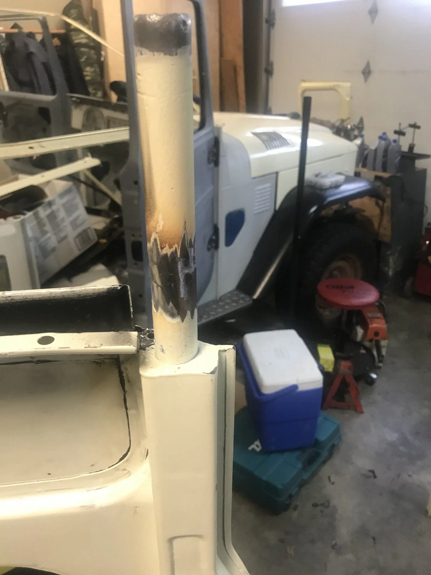

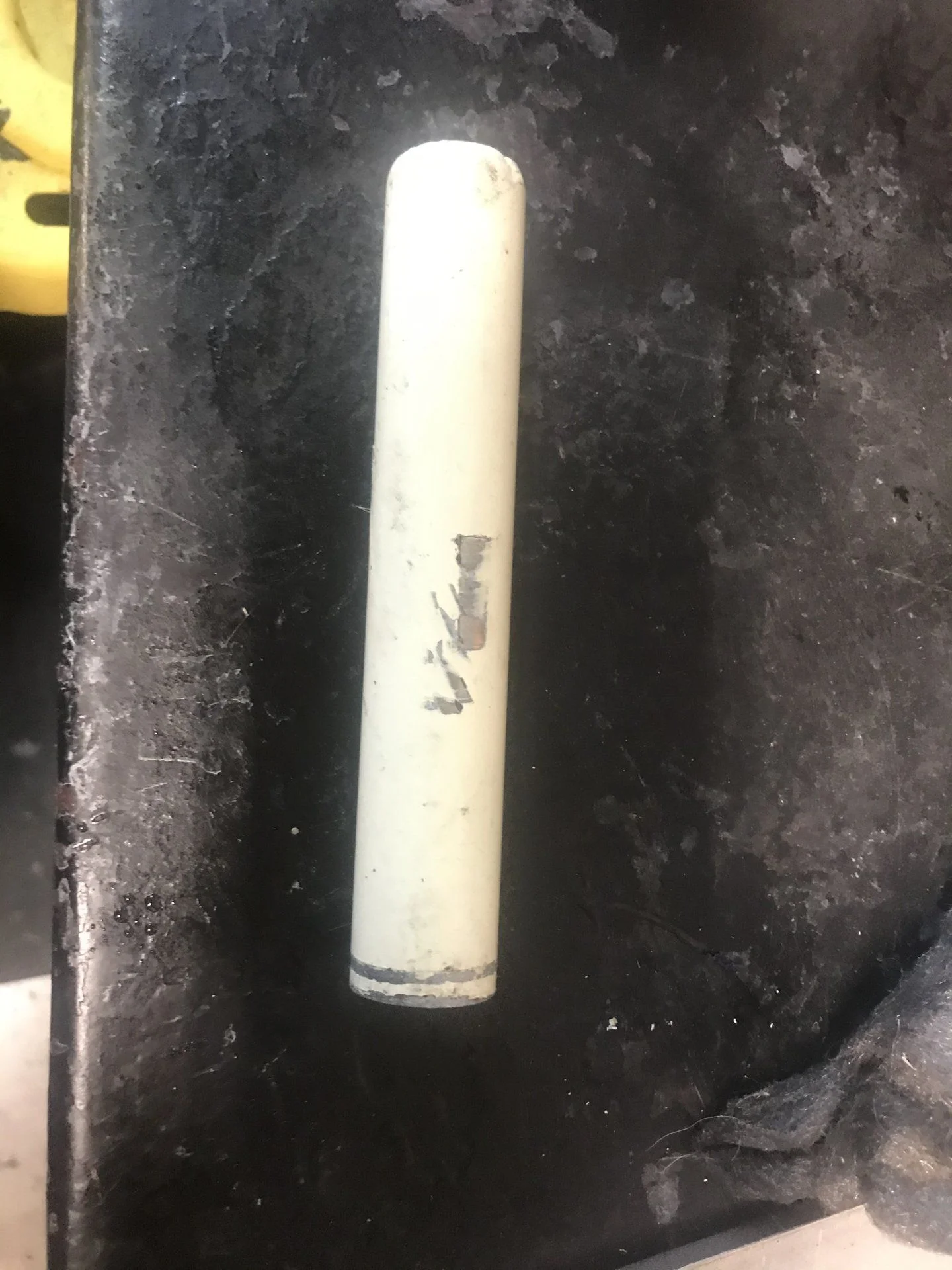

Hard top side are POR15’d what a crappy but necessary job that is. I poured it in the bigger openings and rolled the panel around as best I could to cover the inside of the panel as best as possible. Also decide to weld on the stantokns that I had to cut off when lining up the panel to the tub. They don’t drill the hole for the station to go inside so the only way I could do it was to make it shorter and then draw a circle around the pipe.
More pics of what I’m talking about. Now to acid etch primer the underside a and the stantion and let them dry before fitting them. Next weeks project is to drill and install riv nuts to permanently mount the HT sides.

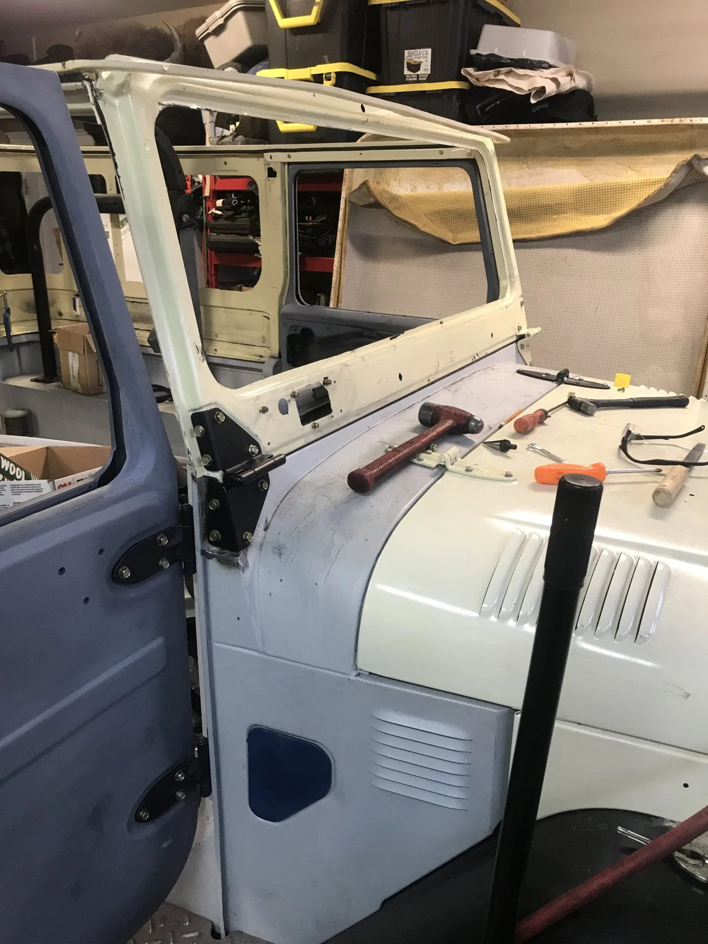

Today I will mount the LH running board and finish my last cab mount.
