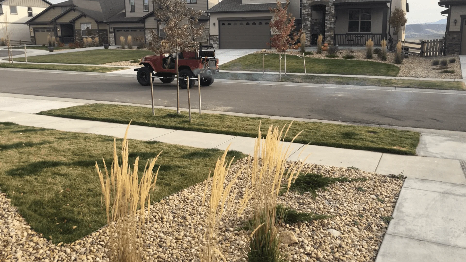

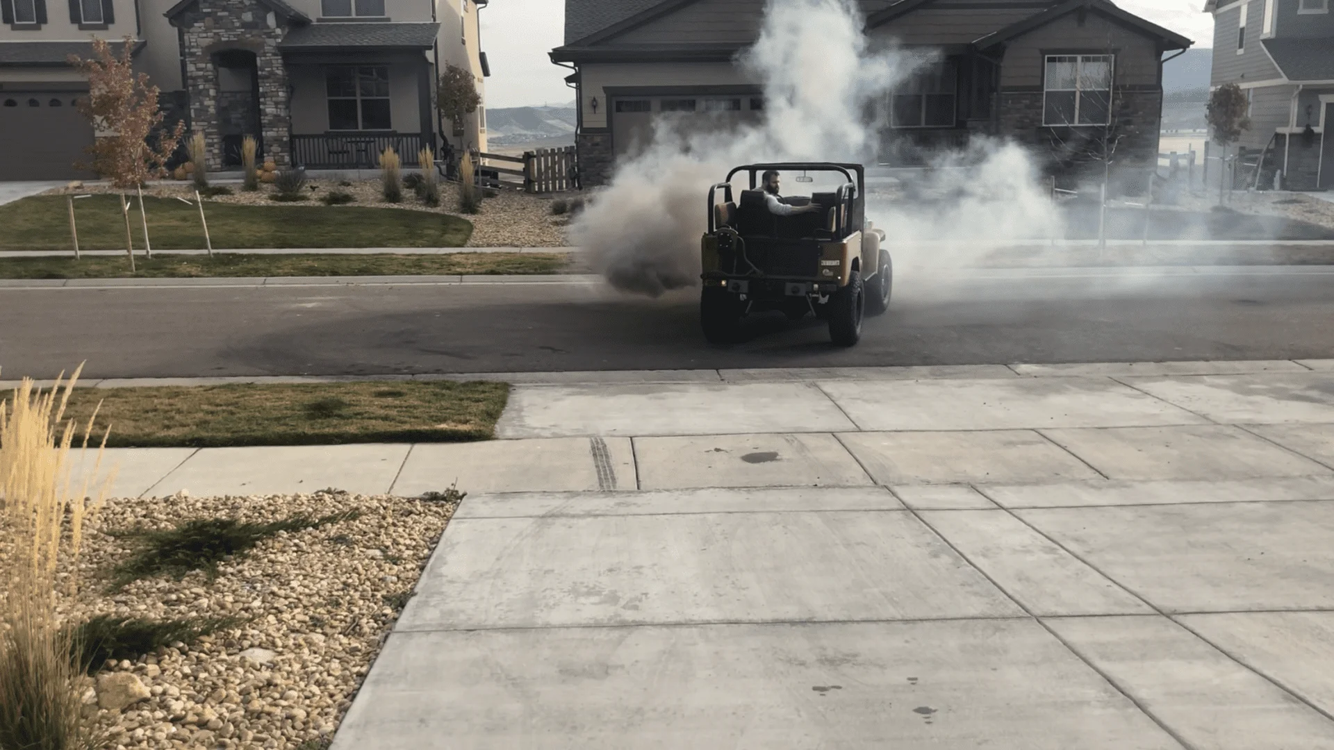

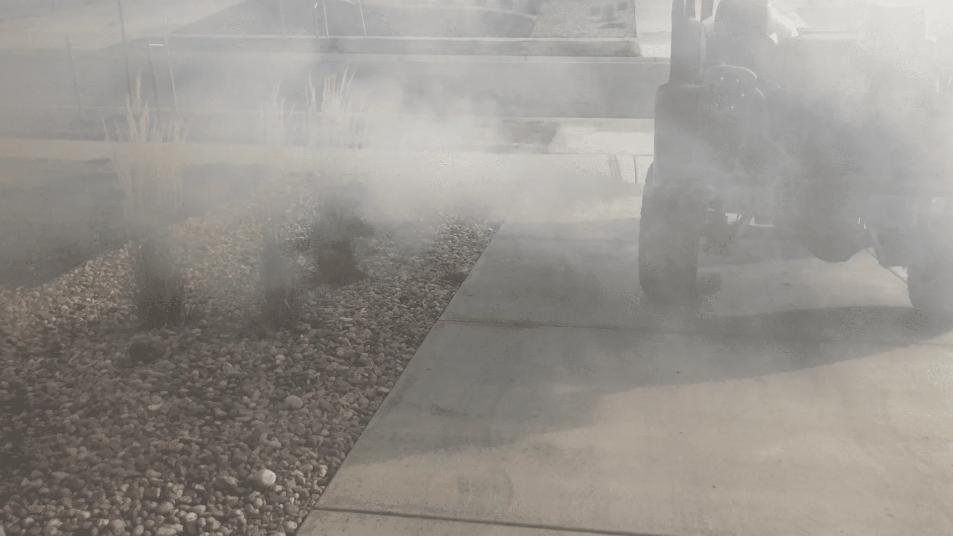

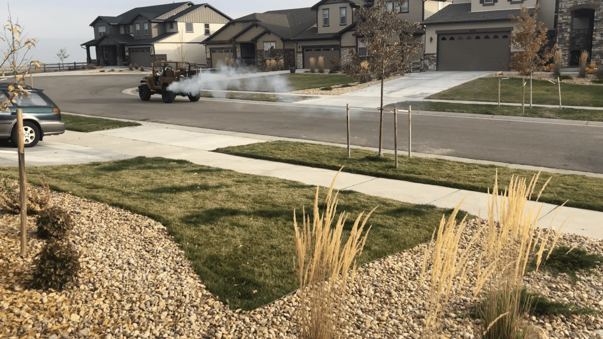

I have a 78 BJ40 that I’ve been rebuilding, and when firing it up for the first time, exhaust smoke was excessive, sometimes grey, sometimes darker and would calm to almost normal when bringing RPMs up. Attached are a few photos illustrating the changes as I start it (smoke!), start to drive w low RPMs (smoke still), drive (limit smoke), engage clutch (smoke returns) and then put in neutral before reversing back into driveway (darker smoke)

What does the smoke smell like? Is it oil or diesel? If it's diesel first thing I would check is the timing. If it's very retarded it may not be burning properly.
How does it start?
How old is the diesel and do you know if the injectors or fuel pump have ever been serviced/rebiilt?
important to note that he is at like 5,500 feet or so in Arvada. I think that will be import for the experts to know as they help diagnose.
How warm was the engine when you were driving in the pics? At a bit over 6,500ft all of our N/A diesels smoke until warm.
That was a lot of smoke but I have to agree with the winter altitude combo. Not enough heat in the air and not much air period! Does smoke go away with glow? Tuff to tell if you don't have a manual glow button. What's your timing set like? Do you run a cetane additive? Block heater by chance?
I had my diesel HJ47 in Colorado for a few months and it never smoked like that once it was warmed up. I'd suggest something other than altitude as the cause.
Have to agree with @cbmontgo. I’ve had my 3B all over Colorado and Utah this winter and it smokes very little, even at 9k+ feet in negative temps.
Based on that last pic I’d definitely try turning down the fuel and see if it improves.

No no, it’s not overfuel, it would be completely black smoke and ok when idling. You have to know what you are doing, not just turning screws and see what happens.
Timing might be off if the diaphragm is ok.
White smoke isn't overfuel on a diesel, that would be black and as @-MaTTi- says, would not manifest at idle.

Have you checked that the fuel pump’s leather diaphragm is not cracked?
2230347010 Genuine Toyota DIAPHRAGM SUB-ASSY, GOVERNOR 22303-47010 | eBay
This is by far the most common issue that causes the issues you are having and is common.
I would replace it and see what happens.

The smoke smells like exhaust but I have a rookie sense of smell in this, nothing was super horrible or sweet smelling though. It was partially rebuilt before starting that day, so it struggled some to start but later that evening started fairly quick. The engine has new valves and seals too to address that.
If the diaphragm is from 1978 and has that rubber seal, I feel I should replace it for good measure regardless so I will order that and if it still produces smoke then, try adjusting fuel down some. I forgot to mention, I could get the smoke to clear up quite a bit (and loss of driving power) as I slightly pulled the fuel kill switch on dash out as I drove... does that help with finding an answer?
