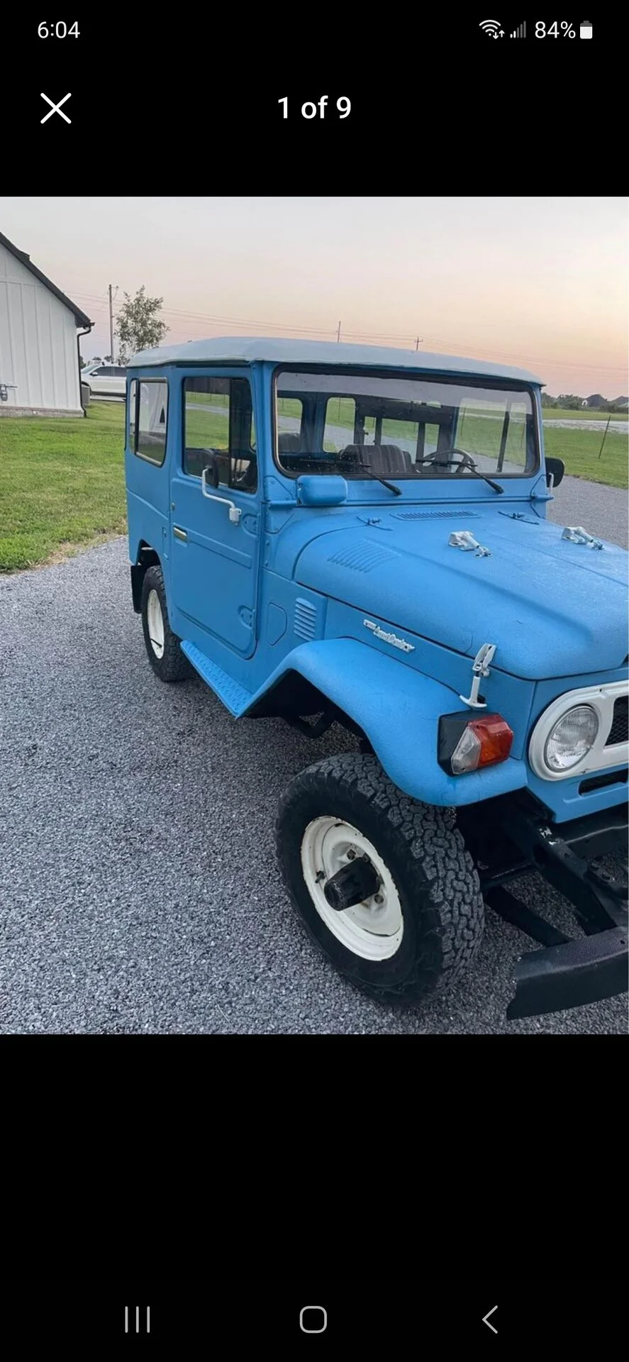

I'm looking to purchase a 1977 BJ40 import, but seller doesn't know where it was imported from. He provided a 10 digit vin but, i can't find any info with the vin.
Looks nice. What are they asking for it, just curious. Does it already have some sort of US registration if so it should be easy to get plates/title

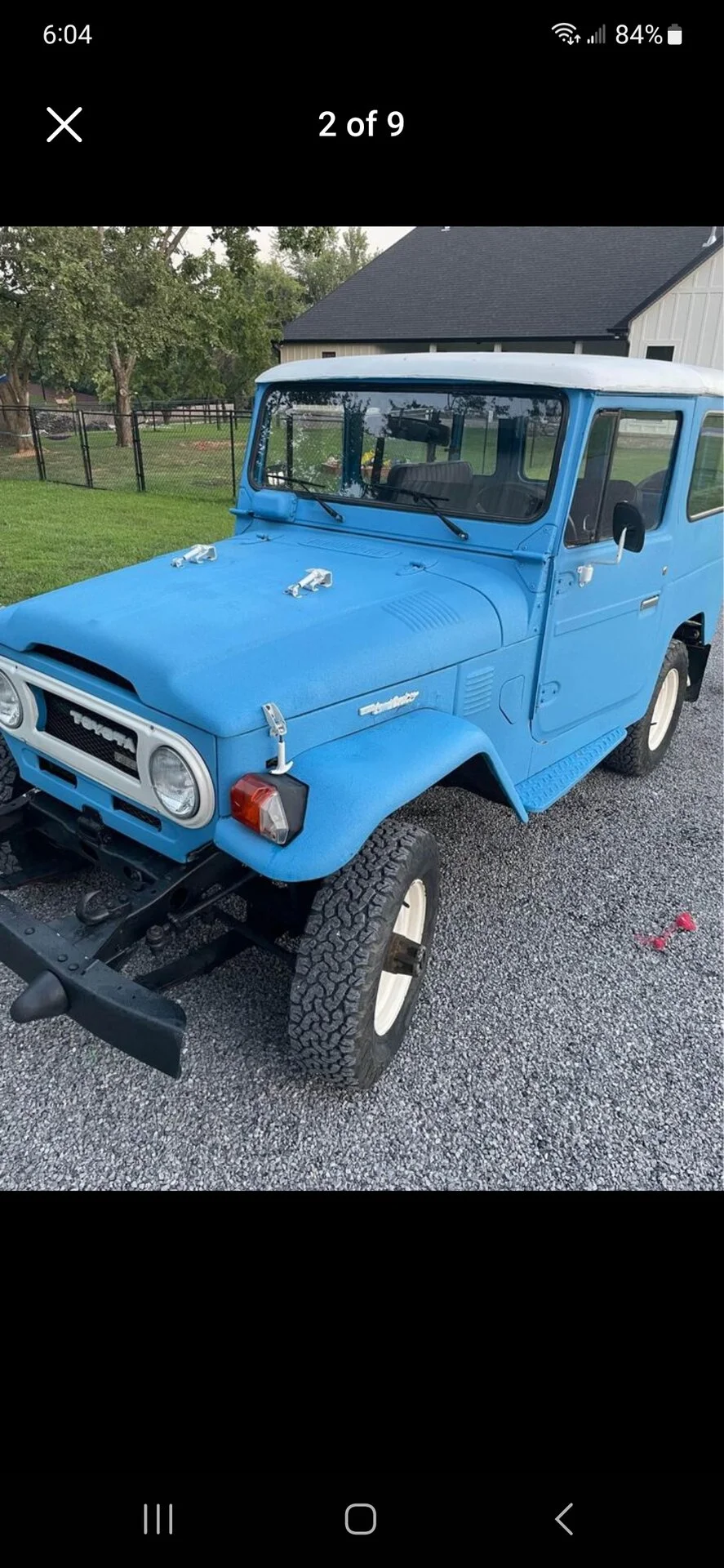

a few more pics would help,
the titties on the bumper look different than others from central America
vent window front doors
does it have a heater? rollbar? dash pad? front bench or buckets? disc brake front end?
top might have been changed
use caution before buying, if possible have someone who knows Landcruisers look at it
Get a photo of the vin plate - it will have the assembly plant on it.
Unless you're very familiar with FJ40s, I wouldn't buy that one as my first one. There could be many unknowns about the history and condition. At least have a good shop look it over.
Is it painted with some sort of liner ?
70 series indicator boxes mounted to the fenders not the side of the grille, looks a little funny.
most likely Costa Rica. Proceed with extreme caution. Especially at that price which is typically around what it cost a shop to make one of these operate safely and properly.
16,500. No way . I myself would not even consider 6,500
I'd buy it for spares for 6500.
Don't see any around here for anywhere close to that money.
Nothing wrong with a good coat of liner if you're taking it out in the bush, but it "may" be covering a multitude of sins. Or may not.
Depends if you want a German Shepherd or a Poodle.
Not a little, looks terrible to me. 🫣😝
Well ja, it does :hillbilly: but last time I called some ones baby ugly my wife slapped me stupid :rofl:
