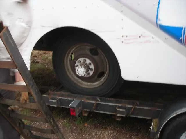

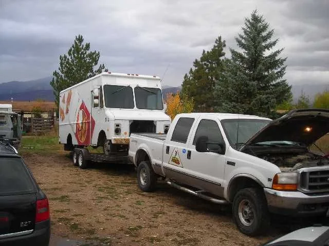

1) I finally sold the bread truck.. I basically got too lazy to tear it down and I found out guys were only getting $800 or so in scape for the aluminum, so I put it in the paper for $700 and got $650.. Guy who bought it is going to turn his '90 Dodge into a dually with it, using the big industrial truck rims off the truck, and make the truck itself into a chicken coop :)
I also had to remove one of the rear duallies to get it to fit on his trailer.. Then he drove it all the way up to Idaho..!

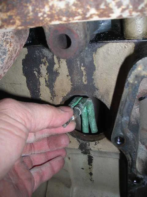

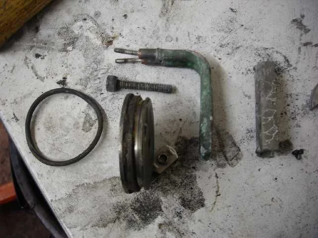

First I started doing some motor work. Getting the block heater out was a bitch but only because I didn't know how it worked.. Eventually when I dropped the back side tab, it was pressed in, so I welded a little piece of chain to it and ripped it out, sort of like a slide hammer.. I also never understood why the cummins block heater was "so good" - better than any others I've used where 20 minutes alone lets it fire right up in the dead of winter.. It's because its a wand sytle heating element directly in the coolant jacket that is around the cyl walls.. A lot of them (I think) are in place of freeze plugs. I was planning on buying a Kim Hotstart style tank coolant circulating heater, for about $100, which allows it so your heater is warm as soon as you start the truck and it circulates the coolant around... The Kim Hotstart is a better design but I'm not too worried about it and will probably stick wit hthe traditional $25 Cummins block heater again...

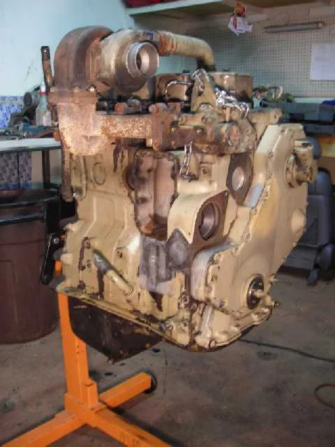

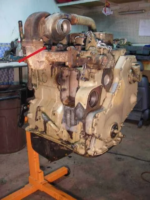

I traded my low mount turbo for a high mount from a Ford style 4BT. The 4BTs are in both Chevy and Ford vans, but the Fords use the highmount seen here. I thought the Fords would use hte actual same turbo but it appears a little smaller with a bigger exhaust housing (18cm2 instead of 16cm on the Chevyies -- I will be switching to a 9cm for much more power). I traded mostly because I wanted the manifold because I want to move my turbo up and out instead of down and in the firewall, like last time. But the problem is the high mount turbos might be too high mount.. Proffitt has installed a few of these high mount style in cruisers with no problem, but I want the manifold to be out and up instead of just "up" so I was thinking I might chop the manifold and reweld it as shown by my little line there:

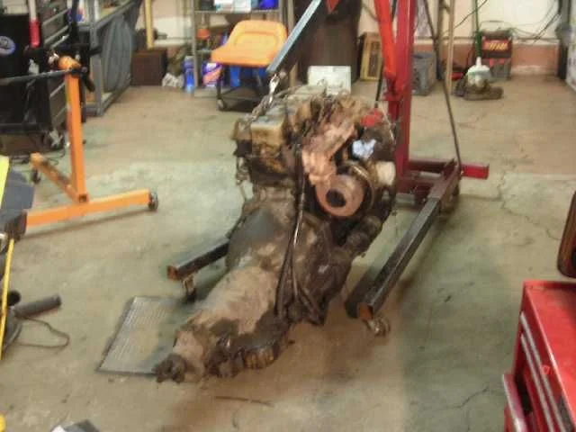

Here are old photos of the exhaust box I made on the last pig, which I am trying to avoid this time, by moving the turbo up, if possible...

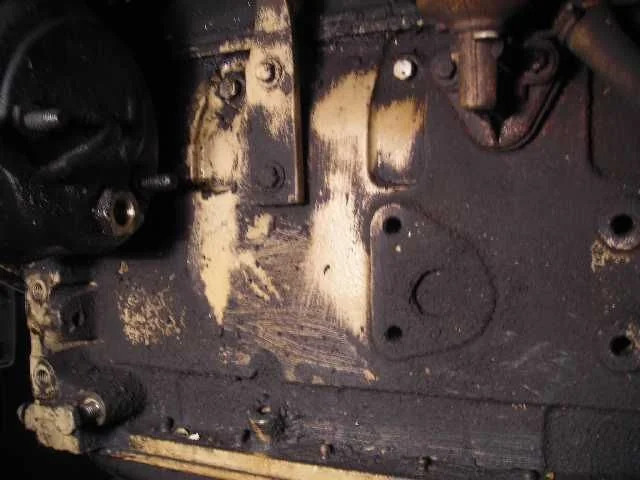

I also went to town doing even more cleaning including the timing cover inside and out, and all along the front of it.. I lucked out because it was all pretty easy to get to but on the injection pump side it is super dirty so I will have to borrow a pressure washer to clean it up, which I havn't done yet... It doesn't look like much but there is a thick layer of really grimy black soot / oil / dirt mostly from old leaky gaskets.. So I am basically taking everything apart I can while I'm here and will completely regasket the motor then paint it...
