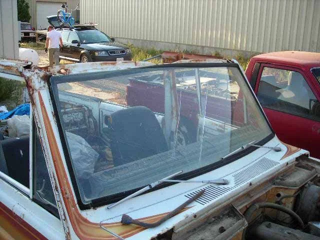

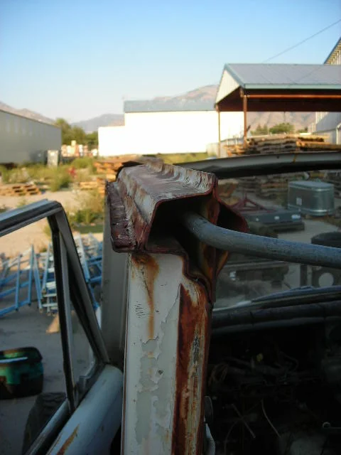

Next, late last week cruised up to Logan to the chopped top 55 that I bought to scavenge parts.. Was a pretty good parts run, but I did not get everything I was hoping for.. Still need:
engine sensors off F or 2F engine with coorspeonding gauges.
Gauge clutster pad, glove box bad
windshield
and that is really it I think...!
Damon stipping off some partsm and other misc photos of the rig...

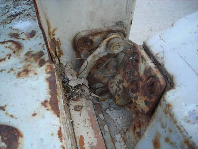

TJ here is a closeup of the tailgate.. It actually is not that bad rustwise (mostly surface) but it does have this ding. Had a big bee hive in it so we decided not to take it but if you want it let me know and I'll grab it next time I am up there...

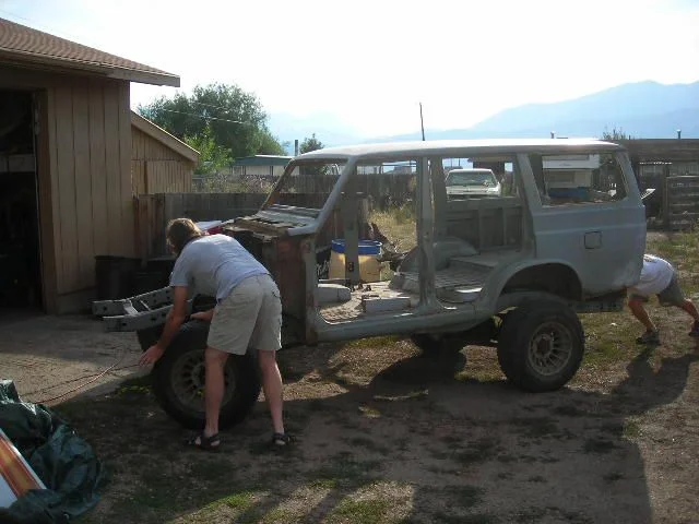

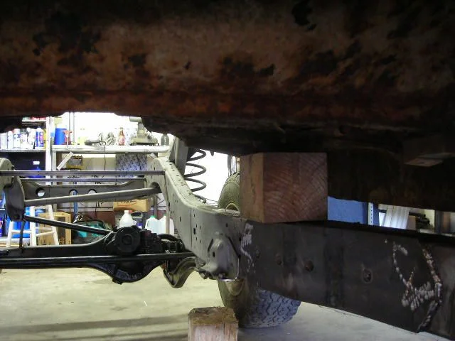

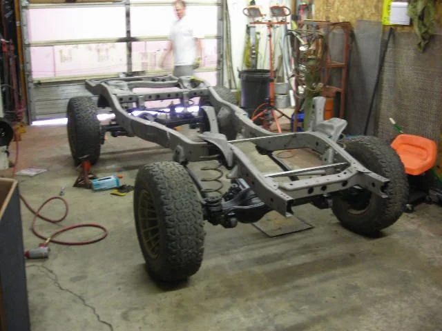

Next, Damon me and my neighbor managed to wrangle the body onto the frame. Of course did not get any pics of how we got it on the frame but it was pretty odd how we got it on there, one end at a time carefully making sure no dents/etc. In all not too heavy, 4 guys could move the whole body, but three probably cannot...

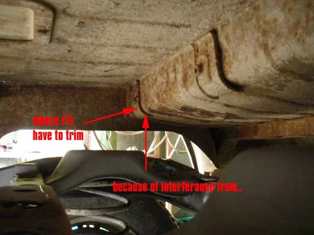

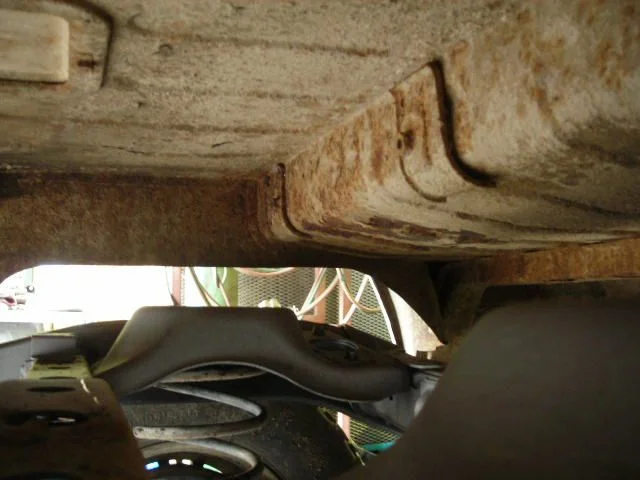

There are only two areas where I can see that the frame interferes with the 55.. The first is the rear wheel inner wheelwells.. The 80 frame is about 6" wider in the rear.. Normally, the 55 frame tucks just inside the rear wheel wells but because of the extra width it interferes.. So I will need to do some trimming before I can lower the body. I have the body shimmed on the frame with wooden blocks about 6" from where it should sit. So as you see it, you could say there is a 6 inch "body lift" or something like that...
Front blocks, so you can see that I guess it is a tripod..
Plan is, before I do any cutting is to make sure I get everything positioned exactly how it will sit on the frame.. At this point I have a lot of things to purchase before I can make some real prgress as far as modifying the body... I basically have to mod the body for body mounts and have to modify the transmission cover, and dash. Need to have the body sandblasted before that happens, and need ot have the parts before I can start cutting..

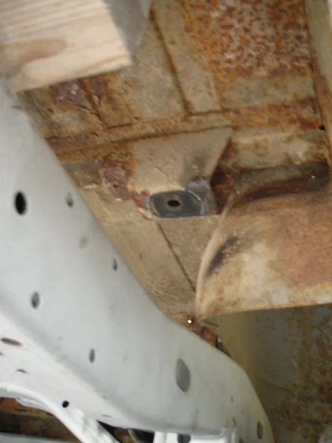

I will also have to build a custom tank I believe, if I want to keep it in the rear.. Mostly because the rear crossemember is where the fuel tank in the rear would be. You can see the access panel in relationship to the crossmember here.. So bummer on that but gives me a chance to do something custom with the tank which I sort of want to do..
Please. please. please!!!
Sorry for the delay...
