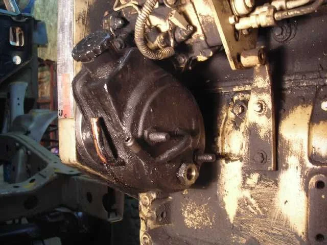

This is pretty neat, the hydroboost / power steering pump. Big old sagniaw and moves lots of fluid. I banged it up a little bit when removing it so I might get a new one, only about $75 for a reman from Napa...

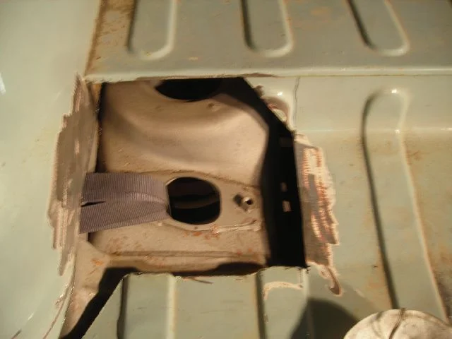

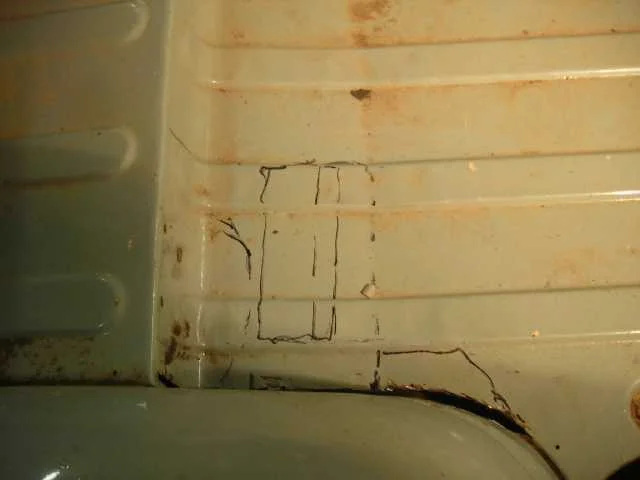

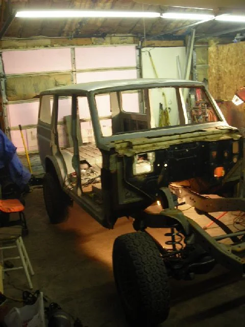

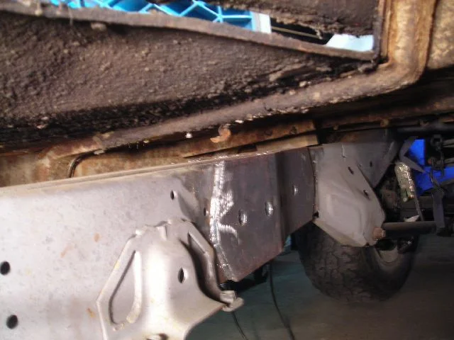

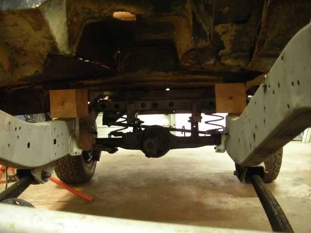

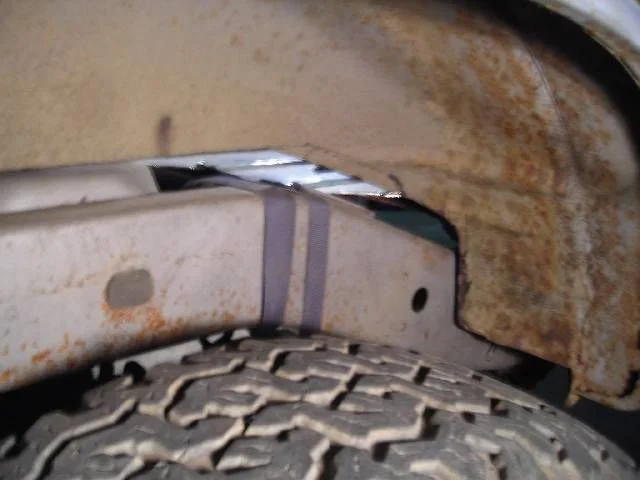

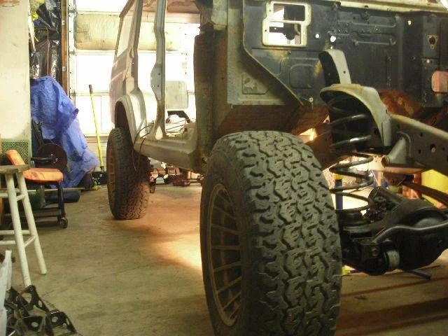

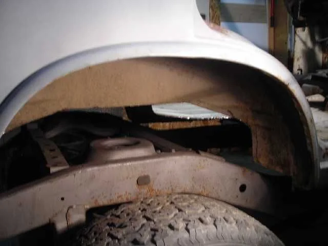

Finally, my big goal was to finally drop the body on the frame where it will sit. I had to take a little metal out of the body to do it because the frame is a little wider in the rear (about 6" overall) with the FZJ80 versus the 55 frame, which I think I mentioned earlier in the thread.. In the front, it is about the same.. I was hoping to pickup some sheet metal and make the new metal boxes from where I cut out the steel but havn't gotten that far yet..

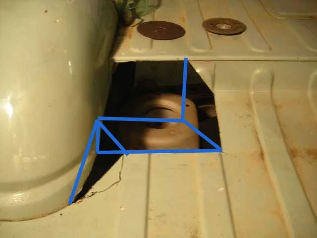

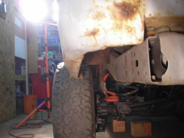

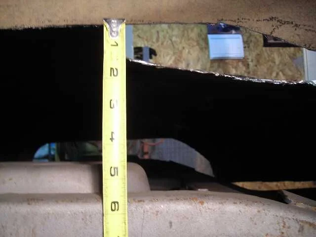

Anyway, conflict #1 was the inner wheel wells which I had to trim out. The blocks I had it resting on were 5.5" so I figured 6" of trimming is good enough...

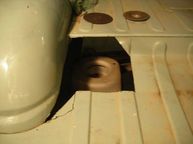

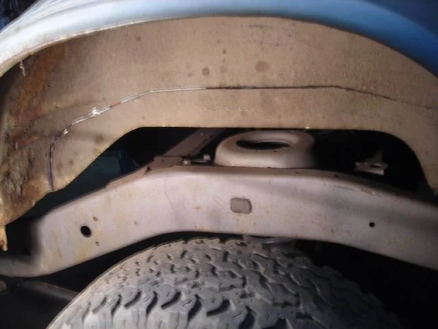

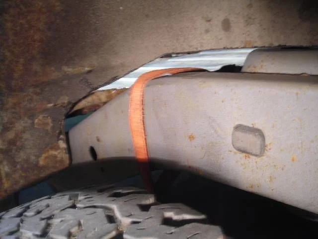

Then over to the driver's side...

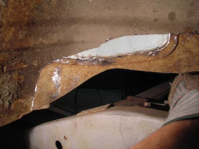

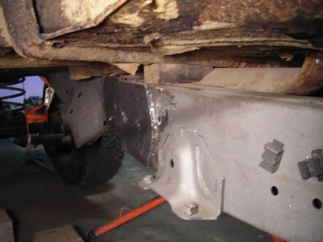

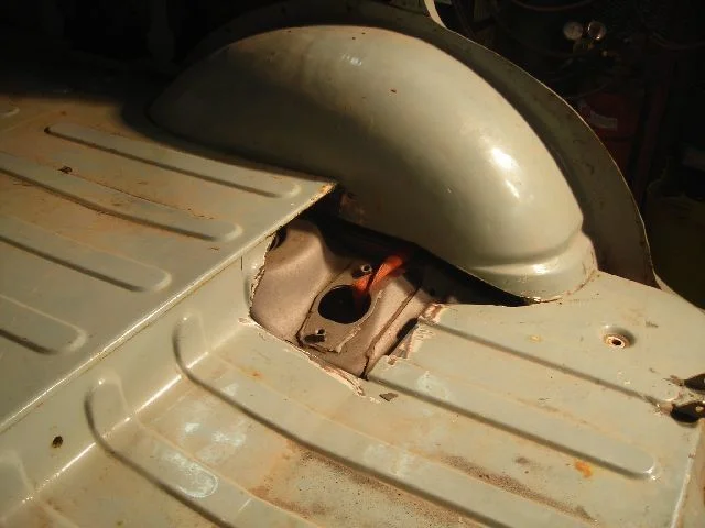

Here you can see some of the rot that will be trimmed out. You can also see the inner wheel well where it was a little banged up from when we put the 55 body on the 80 frame, and where the interferance was. The only way to keep the body from not hitting the 80 frame and doing more damage was to put in the blocks between the two.. Luckily all this gets trimmed out so no big deal..

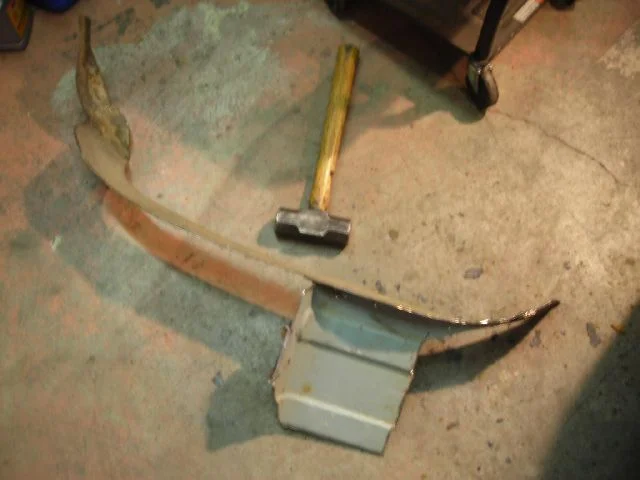

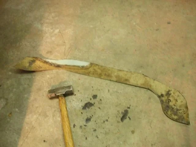

Here is the piece removed, one piece..

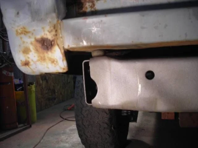

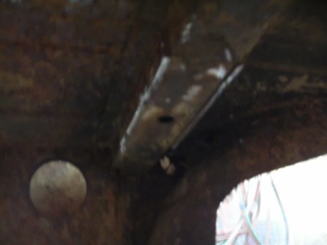

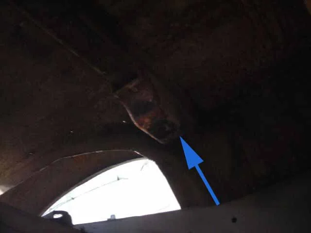

Then there were rear body mounts that also held the 55 gas tank that also interfered that I chose to remove while the body was jacked up for easy of removal... It's kind of hard to see so I put an arrow while resizing it.. Then I ground the remnants nice and smooth. You can see some of the surface rust under there, not too bad and it will all come off when at the sand blasters...

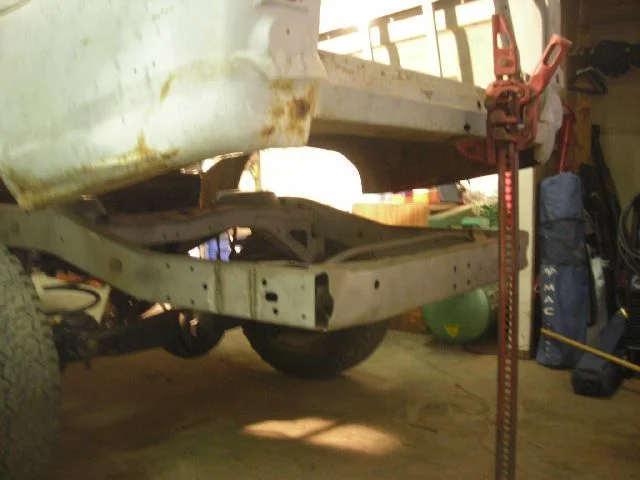

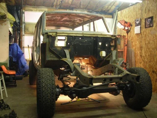

The body itself isn't too heavy, I can lift one side of it all by myself but with me lifting there was no one to remove the blocks so I very carefully used a high lift jack...
Then you can see the body sitting on the frame, basically exactly as the FJ55 was designed, with it sitting on the frame using those cushions and regular old body mounts.. (which I still have to fab up)...

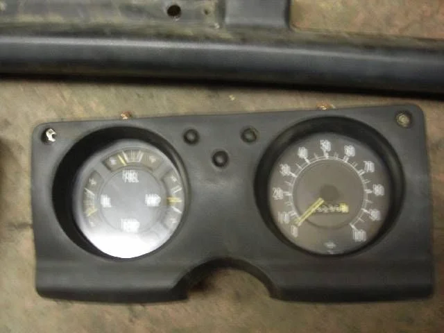

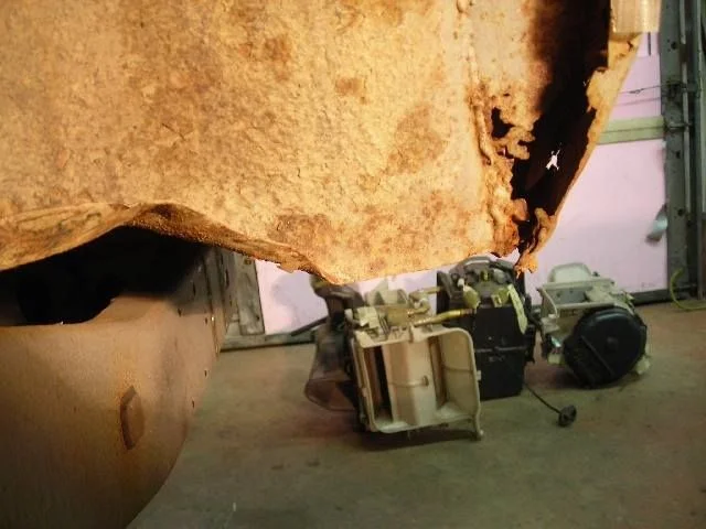

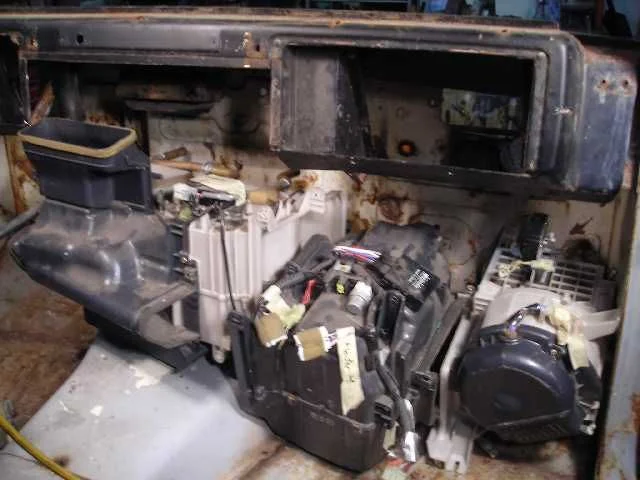

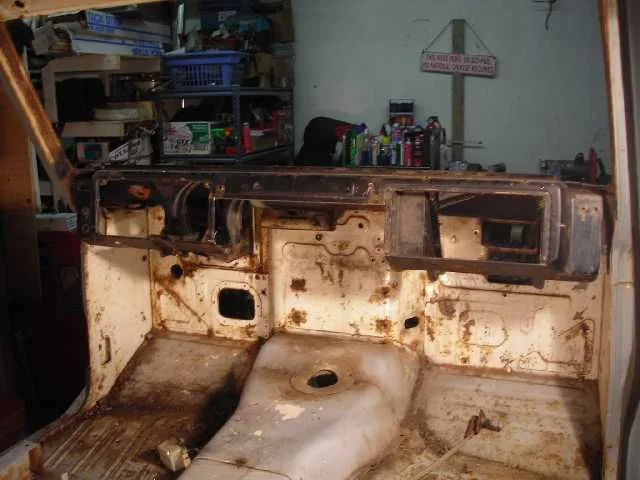

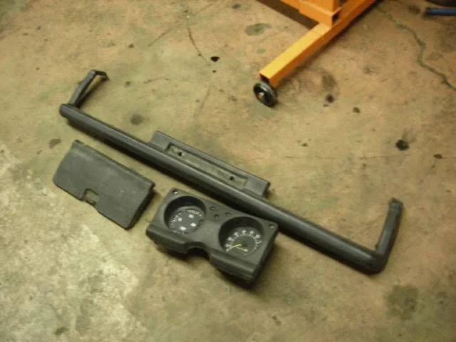

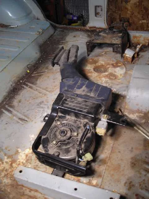

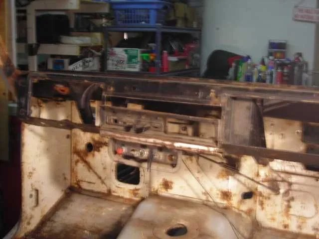

Then, onto the dash, I basically completely took apart the last of the dash, getting the dash pad out (which was a slight bitch) and the pedals and such.. Because I am planning on using some sort of later model heating system.. I was planning and was totally looking forward to using the 80 series stuff, but it is just too damn big, as you'll see below.. So I am now going to try FJ60 stuff (which is also very large) and if not, buck up the $$ for a compact little Vintage Air system which I have a feeling will unfortunbately probably be what most likely happens..
Just to throw out an idea. I saw a 40 that had an A/C unit out of a conversion van in it a month or so ago. You know the kind that mounts on the inside of the rear headliner. Not the best option for a 40 since you canot remove the top but for a pig it might be the way to go. Could get the whole unit from a pic and pull for cheap and they blow a lot of air. That way you could just use a stock heater up front without hacking up the dash.
The rear heater looks good.
that's a really good idea, not sure how/if it would work with routing all that air, but those things do push a lot...brings back memories of the ol' 93 astro, ha ha
