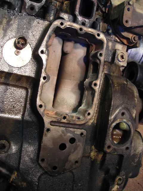

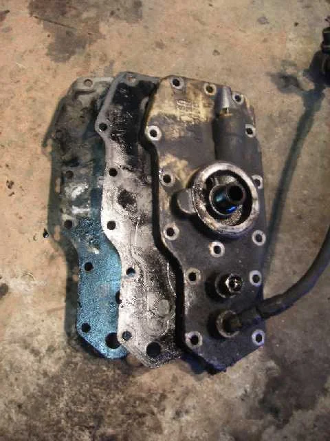

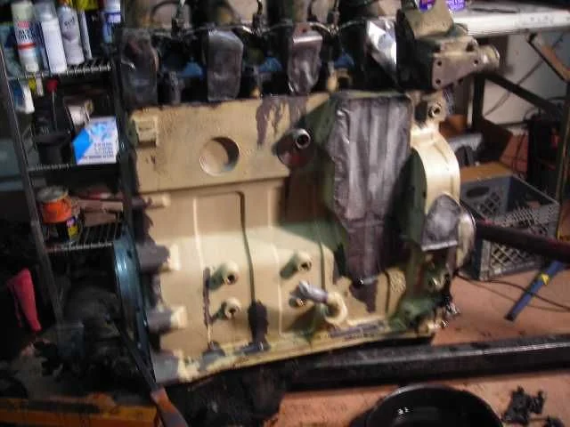

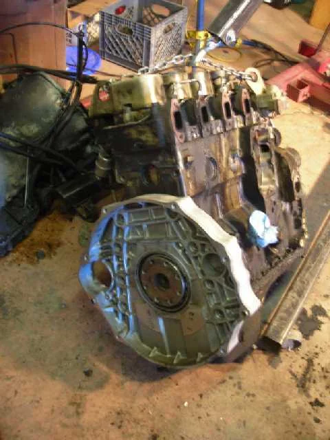

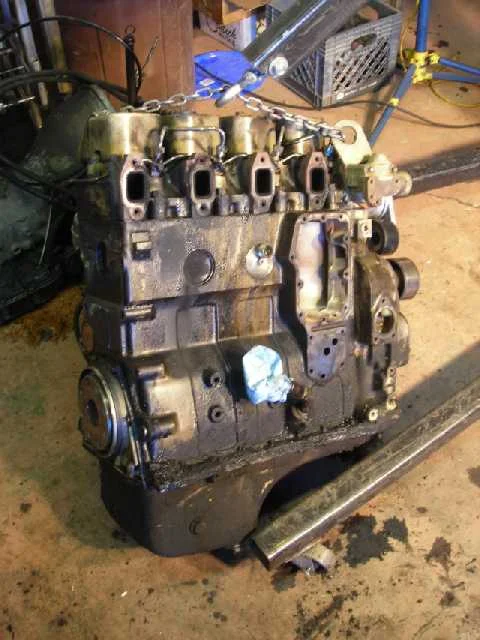

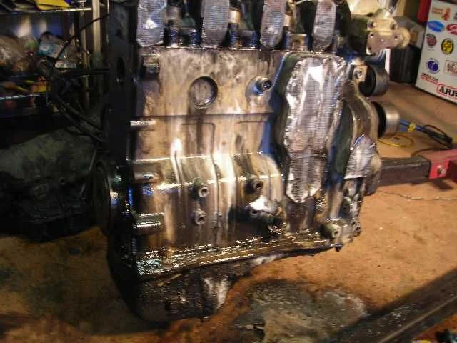

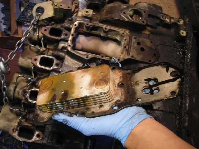

Anyway, again not much to report.. Been very busy and been out of town seems like about 3 weeks of the last month, just got back from NY for a week which was fun... Anyway, tore down a lot of the engine. Decided probably not going to reubild but I am going to do a compression test to see how strong rings are which are probably fine.. Going to replace turbo with high performance version... And have started tearing down for that. Also cleaning, I am planning on replacing entire gasket set both top and bottom to ensure no leaks which this and all diesels for the most part (not sure what it is about them) are known for.. Anyway, a couple photos...
The engne with exhuast manifold / turbo off and getting ready for degreasing..

This is the plate adapter.. I unbolted the GM patterned plate and this is a Dodge to match the NV5600. This is off a '04 Dodge Cummins and they are all interchangable. Common patterns are Ford, GM, Sae#3 which is an industrial pattern, and Dodge, among others...
