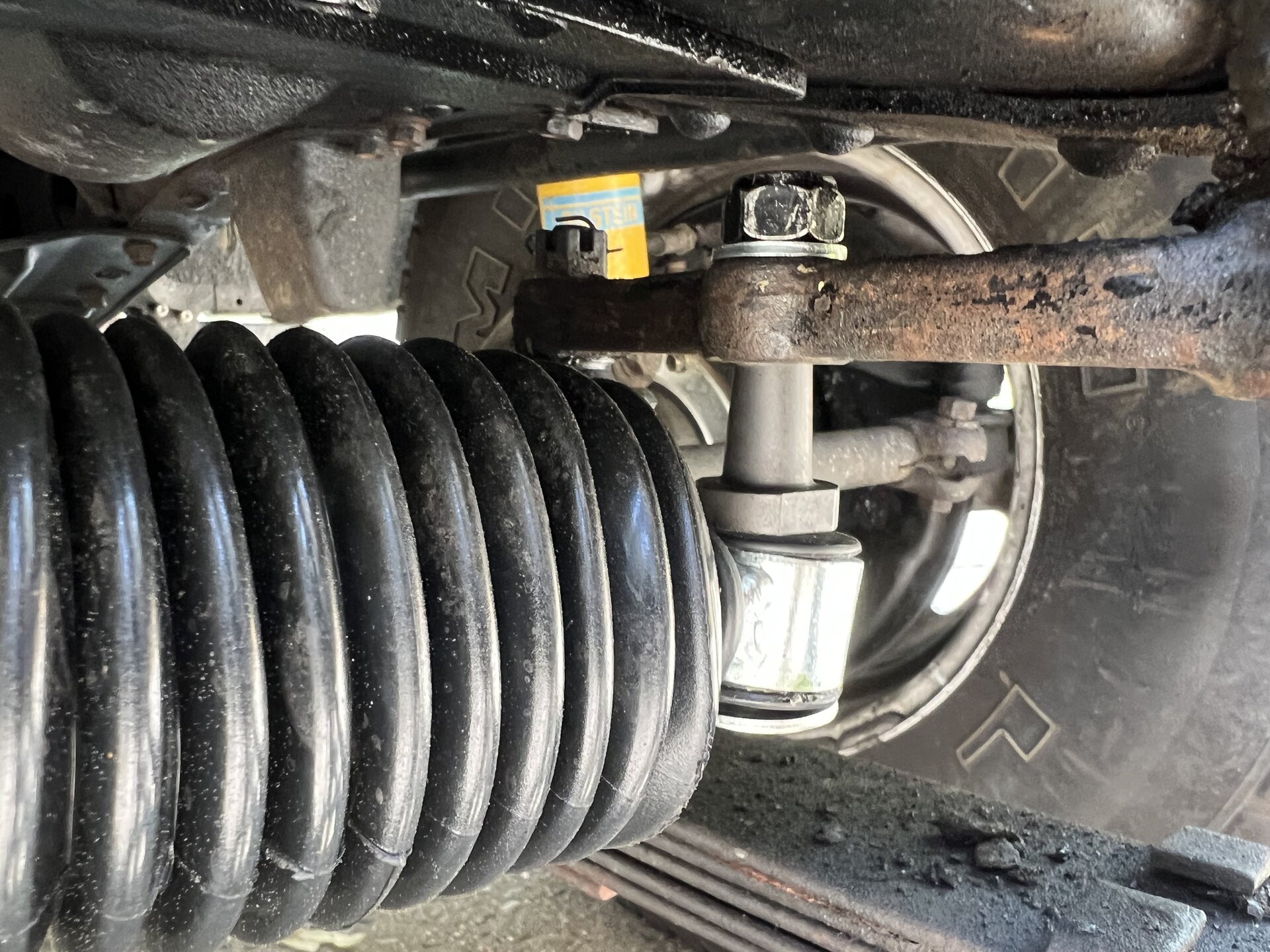

Bringing this thread back from the dead, and installed a Beilstein steering dampener/stabilizer on my 1981.
The Bielstein cantilever pin is a little bit bigger and diameter for the opening in the steering arm so I may end up removing the damper sometime this weekend and gently grinding down the cantilever a little bit just to fit more squarely in the small hole. You can see a picture here of, it installed, but clearly needs to be more inset into that steering arm a little bit more

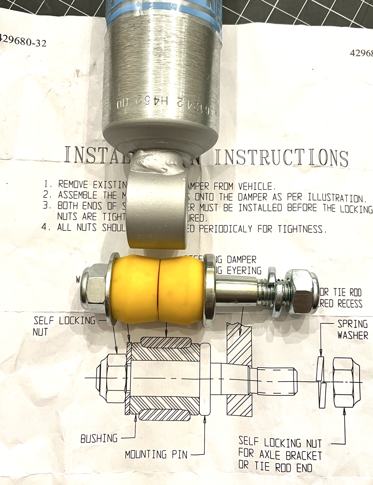

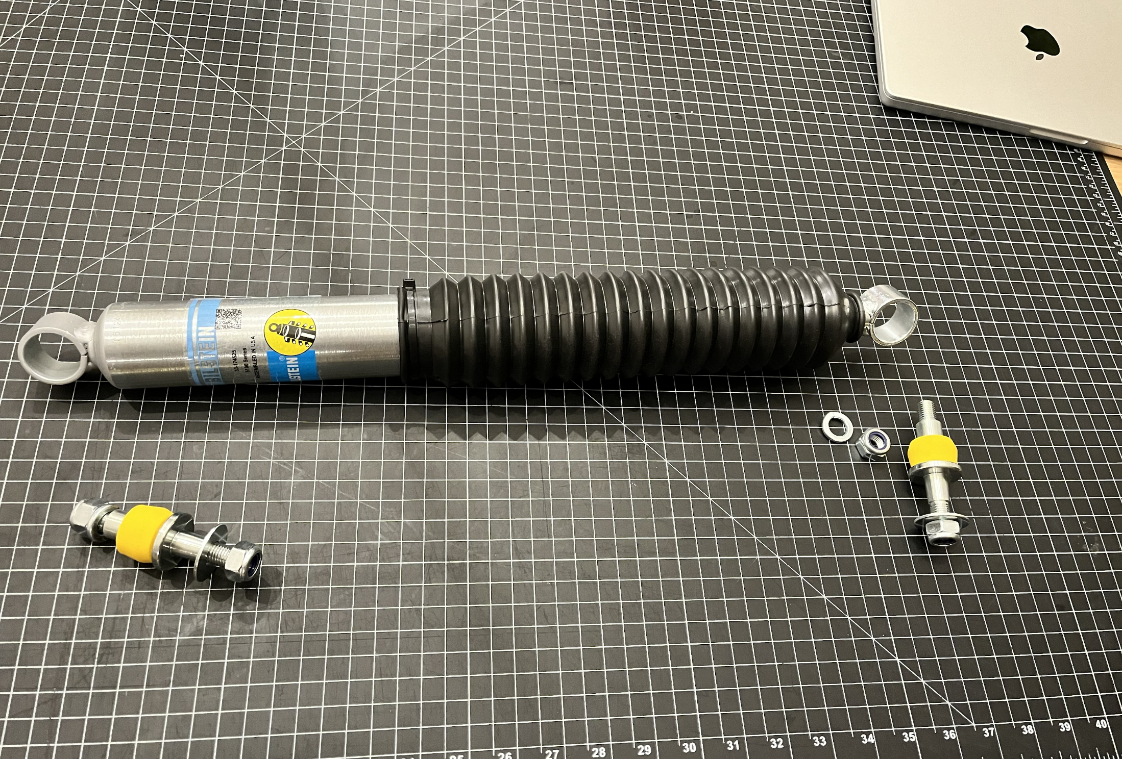

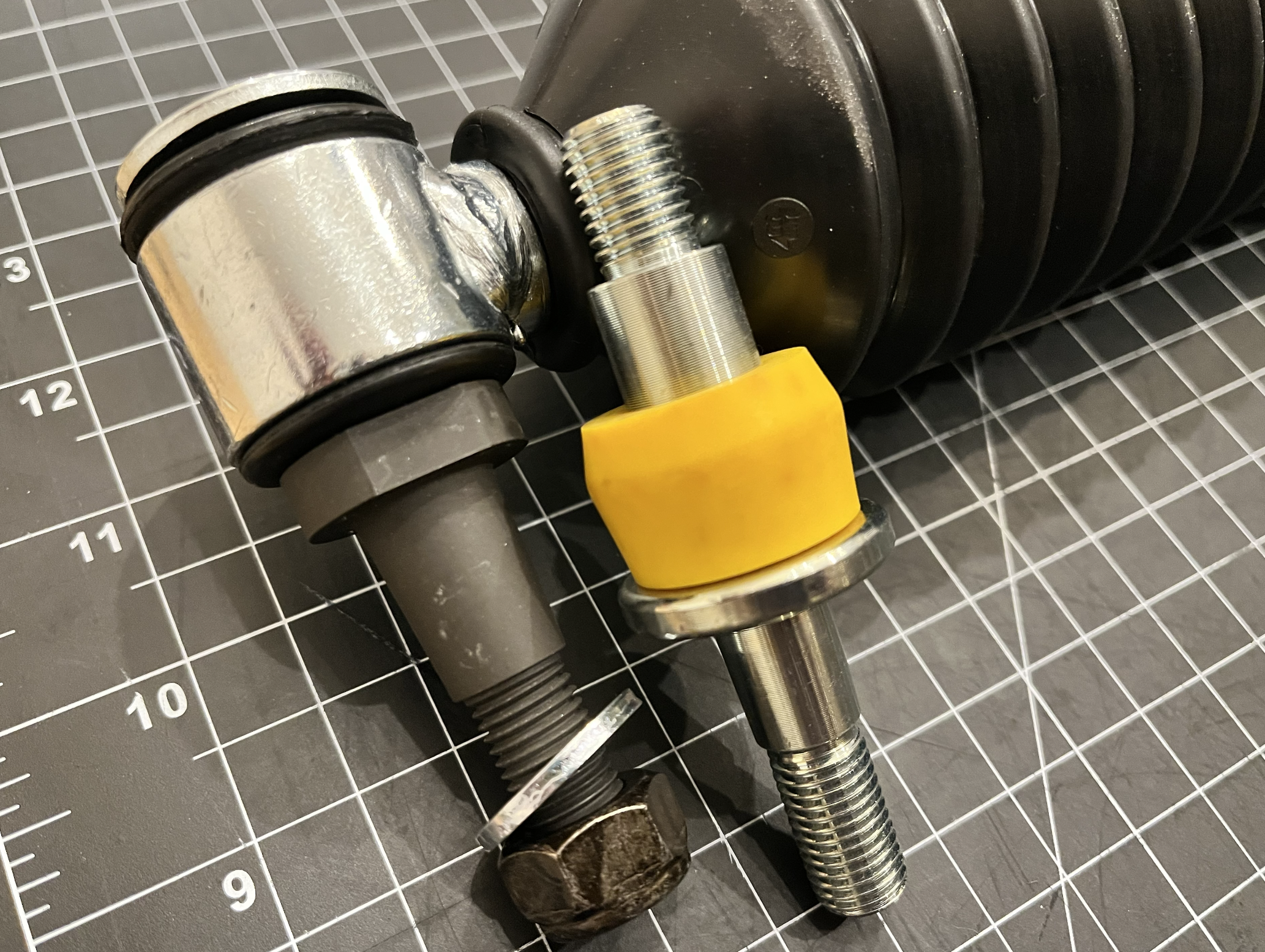

I'm doing this right now and when I ordered the lift kit (springs, shocks, stabilizer) from Manafre -- they supplied new bushings and hardware for both ends of the stabilizer like as pictured.
I removed one side by grinding off the end of the stud and punching it through. I removed the other bushing by razor blading the bushing ends and then drilling holes all the way around the bushing and punched it through.
Yep this is exactly what I ended up doing. Same thing. Make sure to use some blue thread lock on the nut that goes through the steering arm because mine worked itself loose after a few hundred miles and the stabilizer was literally hanging down on the tie rod.
