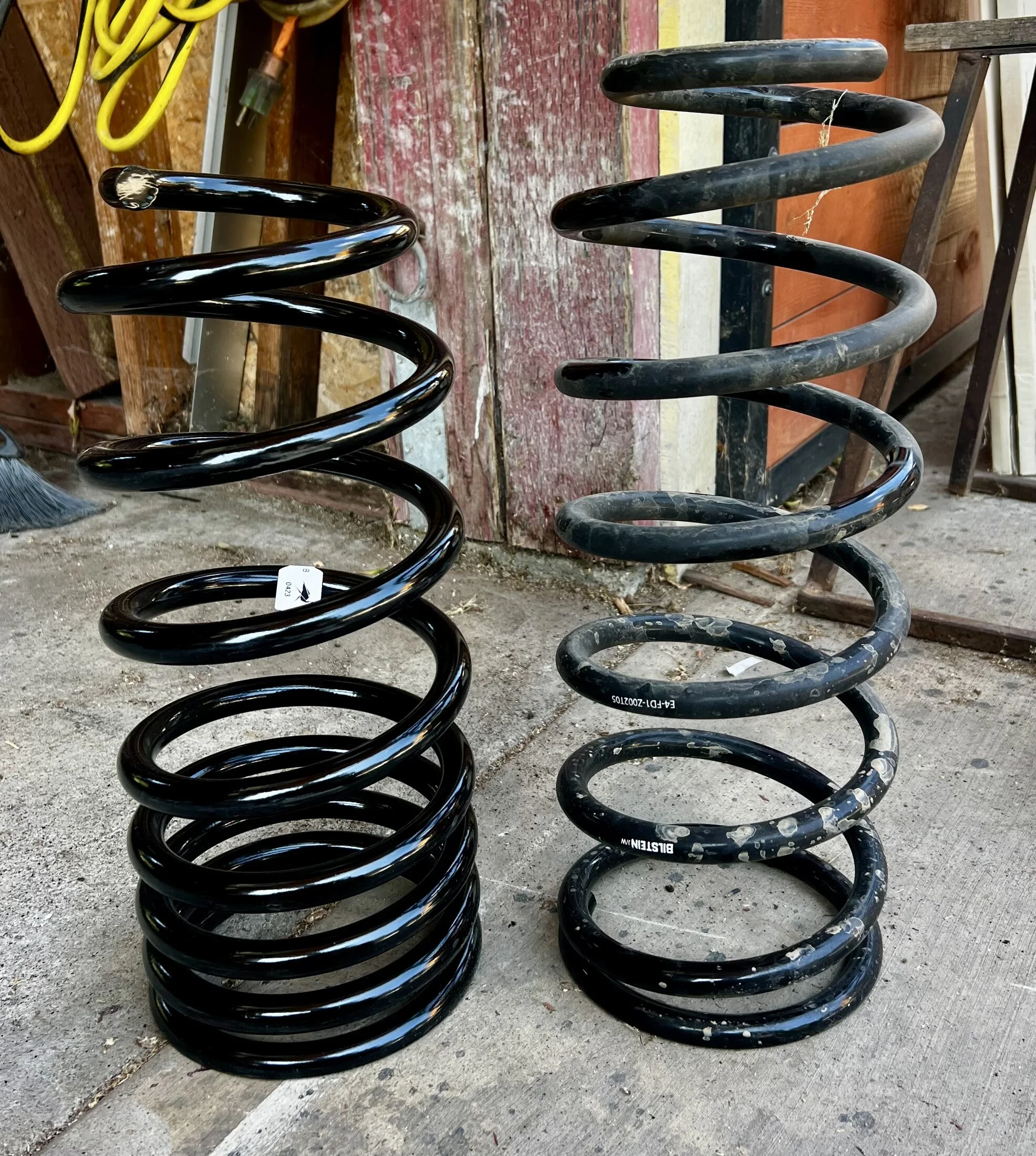

Got the 2721s in today:
When I got it bone stock:
DR: 21 1/4"
PR: 21 1/4"
After Bilstein Regular Rear Springs (NO DRAWERS FRIDGE OR TOOLS):
DR: 23 1/8"
PR: 23 1/4"
Bilstein Regular Rear Springs WITH DRAWERS FRIDGE AND TOOLS:
DR: 21 3/4”
PR: 21 3/4”
OME Rear Springs WITH DRAWERS FRIDGE AND TOOLS:
DR: 22 1/2”
PR: 22 1/2”
No immediately noticeable difference in ride quality or handling.
Will drive for a bit and report back
OME (left) vs Bilstein
