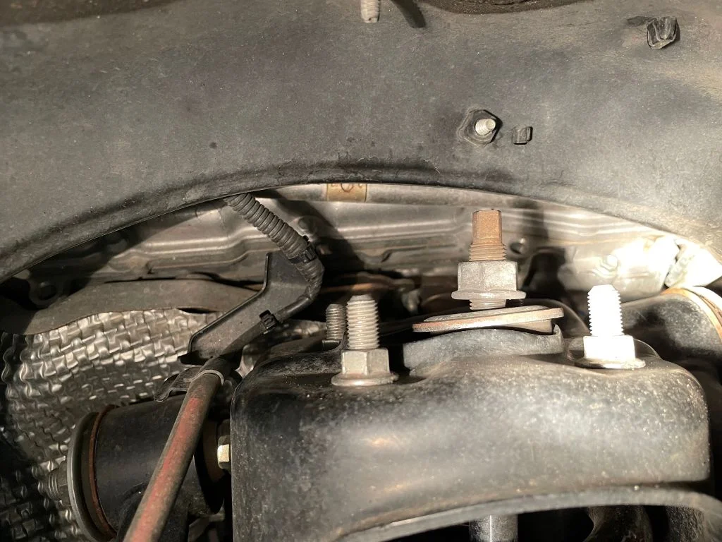

Found it!
I got these used from another mudder, who was kind enough to move the spring perches for me. By moving the perches down that must've given the top nut some play. I didn't think to check it when I first got them, that's on me.
Lesson here is, don't make assumptions! I assumed that the noise was coming from something I'd taken apart, so I kept checking and rechecking all the torque on those bolts. I should've looked elsewhere, knowing that all the other bolts were properly torqued. I tightened this one down and checked the one on the left side. While not showing threads, I was able to tighten it down some too.
