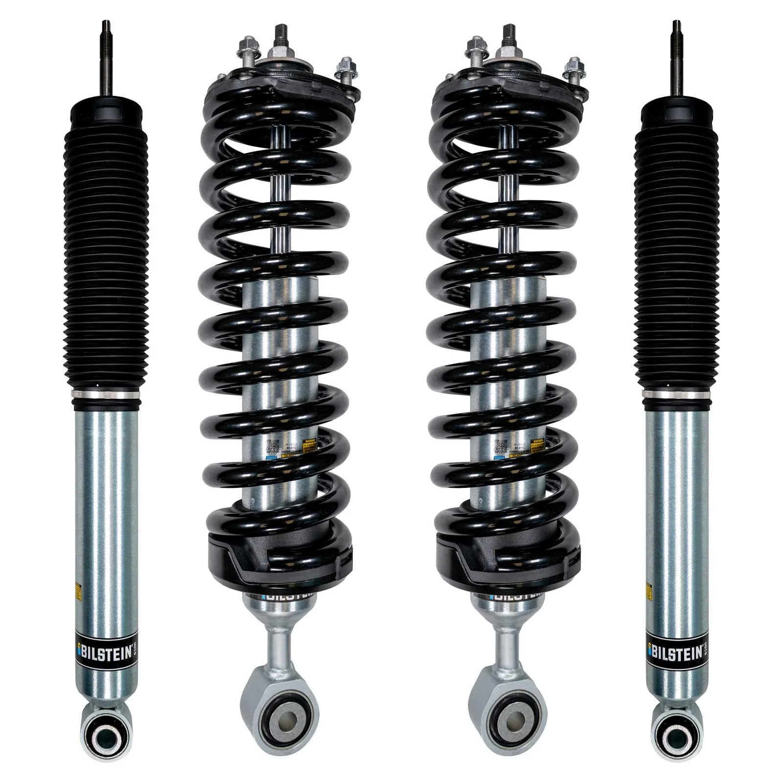

Bilstein 6112/5160 Installed

Whole system about 13 years old, with the exception of front shocks that were replaced 2 years ago since they were leaking. Lately I've been thinking of changing them out to the Bilstein 6112/5160's lowered to the 1st perch to get more rake and improve handling and retain current OME 2722 rear springs with 5160 shocks in the rear (I read some things on the thread mentioning the Bilstein springs are pretty stiff). I'd like to not raise the rear anymore than what it is now. I've previously had 5100's on some other Toyota truck's and i've always thought those were best quality for the $. I've had OME stuff in older LC's, and I've generally thought that their springs are stiffer than advertised, their shocks are good, but their corrosion resistance and bushing's wear out fast (One of the rear shock eyelets is slowly backing out of the bushing currently haha)

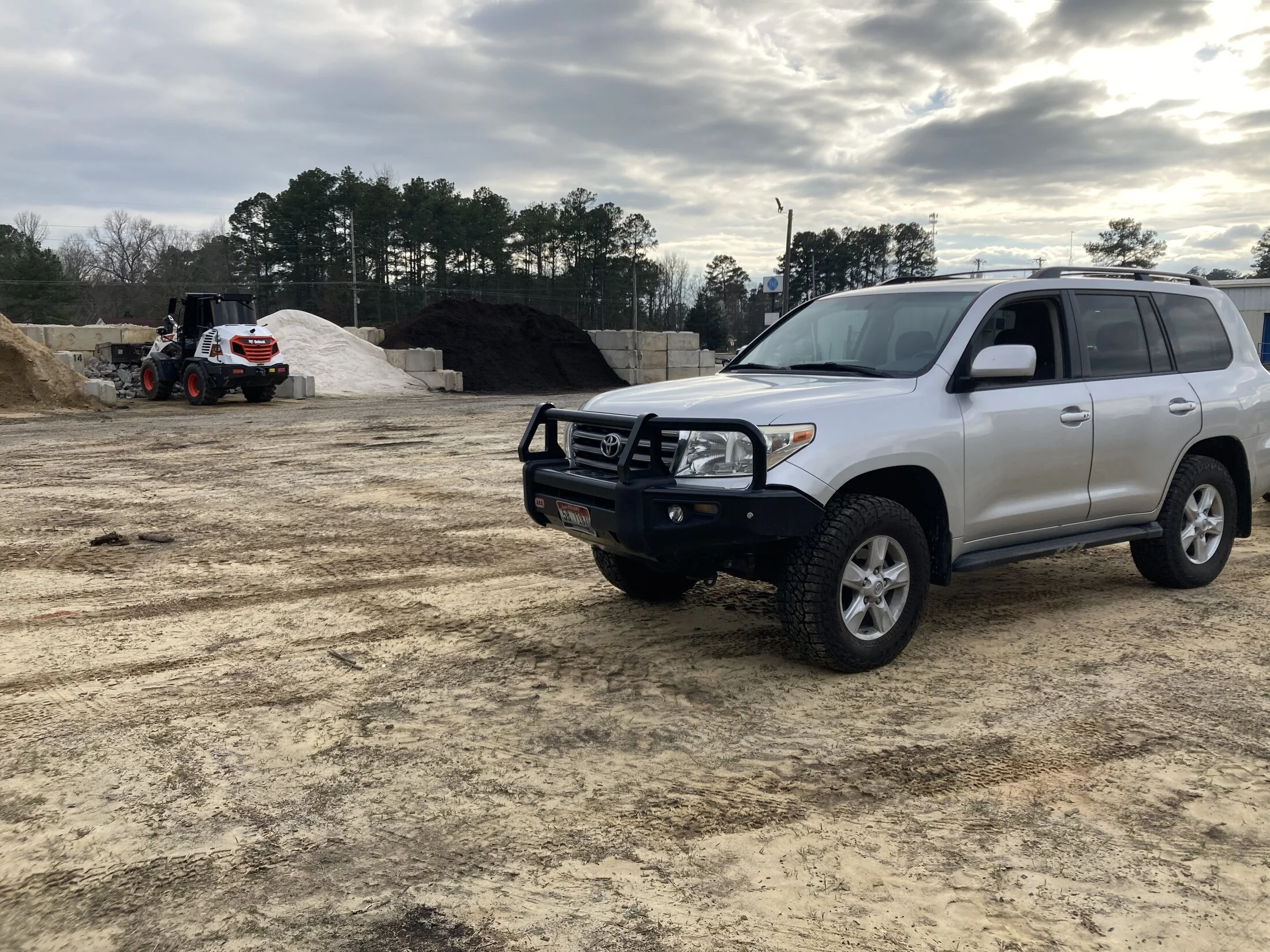

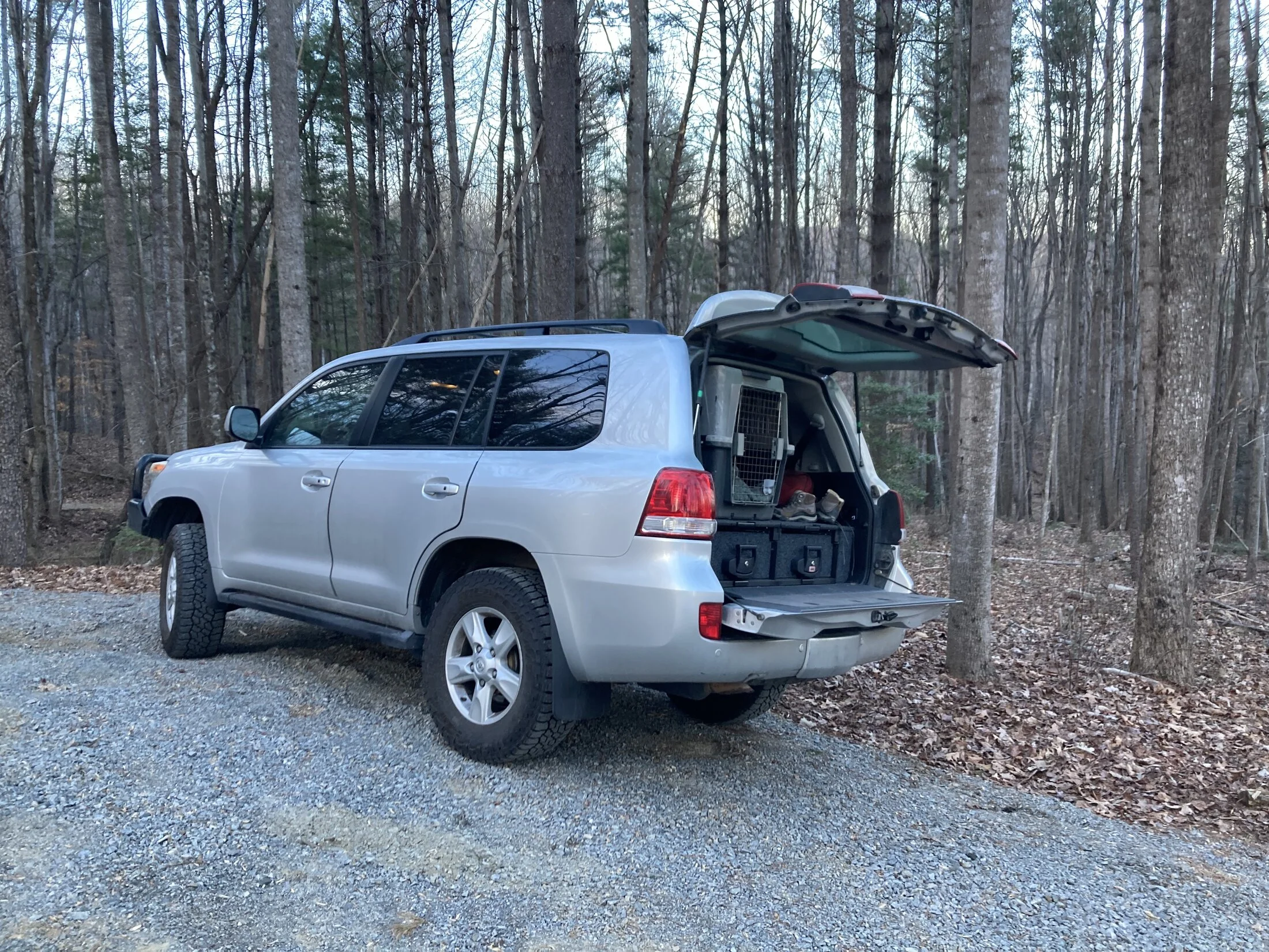

Some photos of my current setup:

i said screw it and bought the 6112/5160. already have SL rated falkens 285/65/18.
Ordered on perch 3. Is it fine going with the stock springs in the rear? Ive got a 2021 HE w/3rd row so it did not come ass end high like the other HE's.
