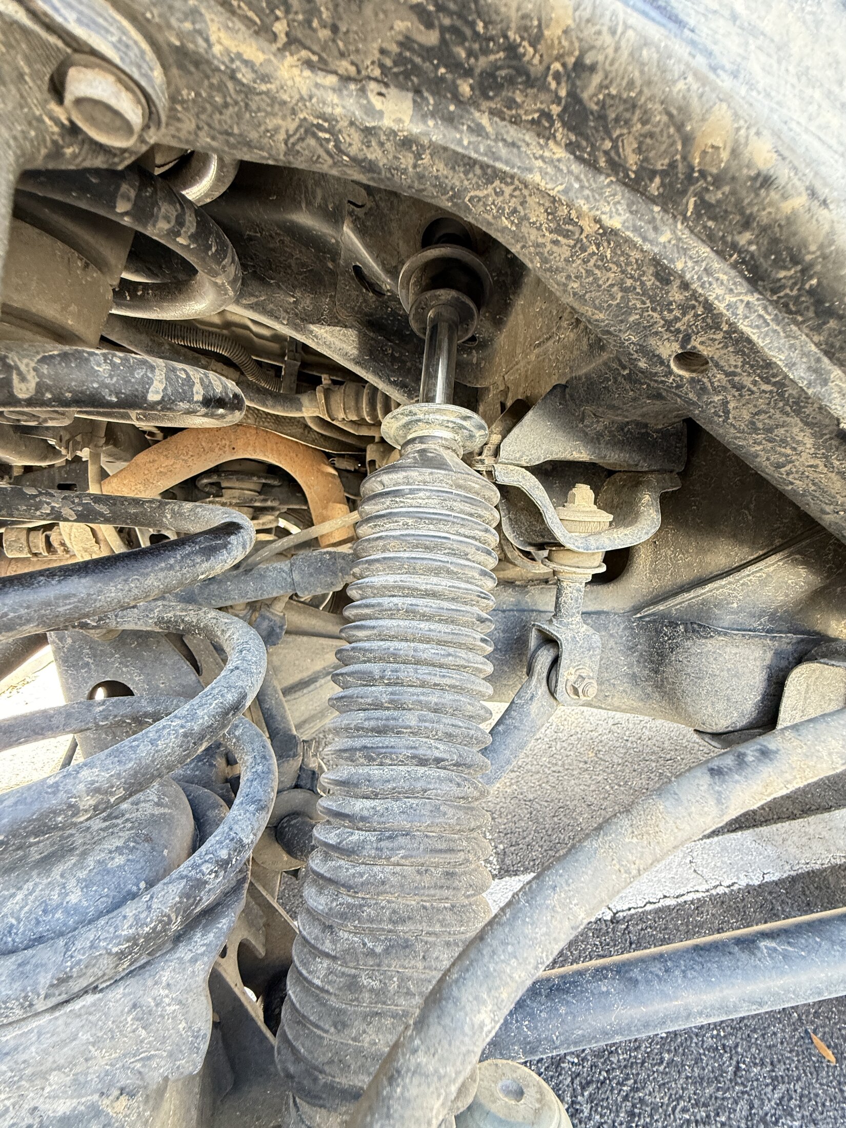

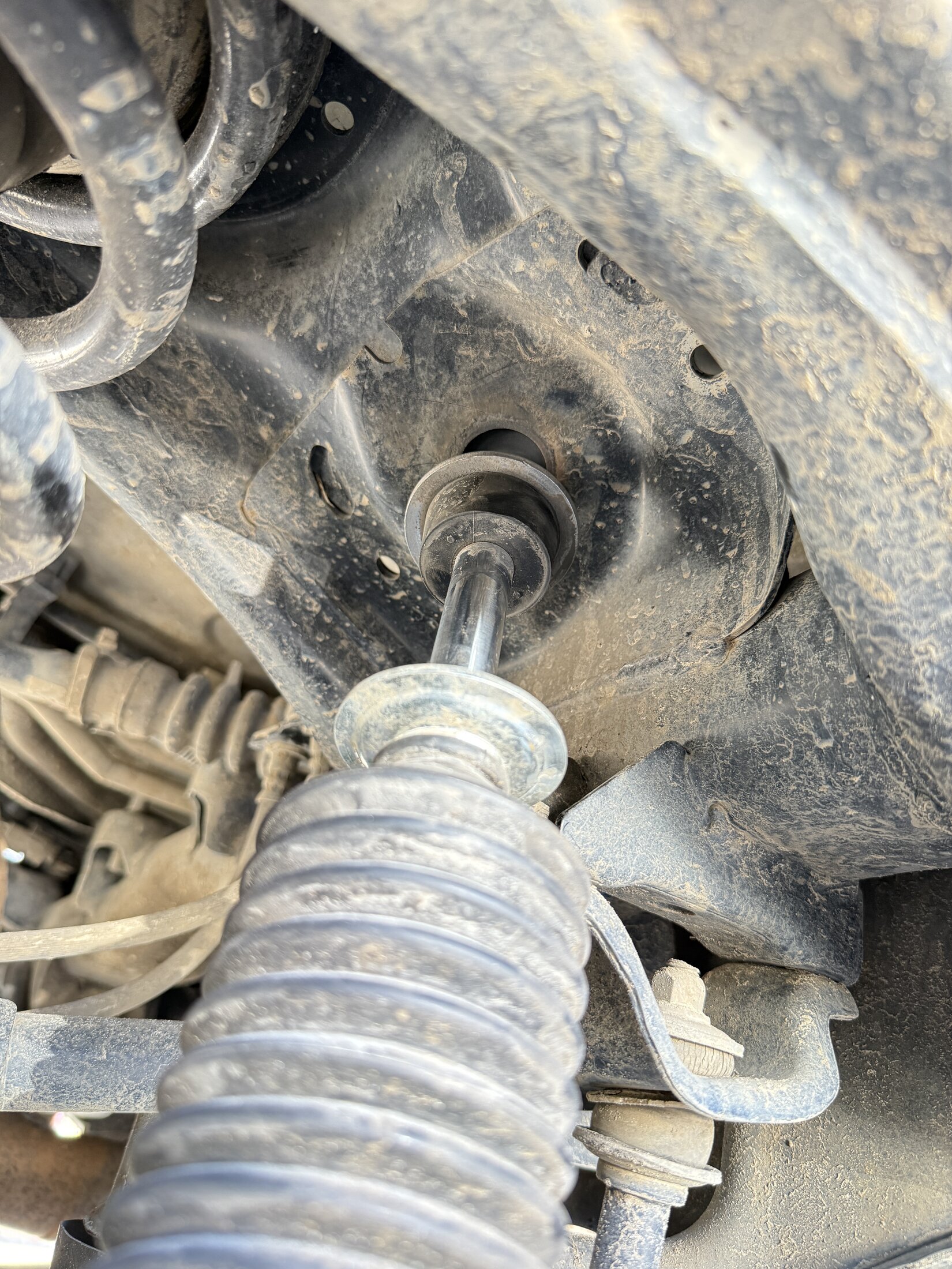

So I got a shop to install my shocks and ever since I’ve had a bad clank in the back. I thought it was the heavy springs at first but now I’ve realized the top of the shock plates are moving all around. Both of these plates around the bushing are lose. There is another plate and bushing on top of the frame.
How is this actually suppose to look? Is the bottom bushing not supposed to be there? How does the top of the shock boot get held up?

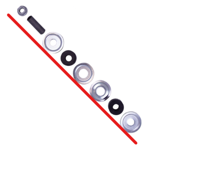

Well guys. Now that I finally got the time to get them out of the truck... Turns out the sleeve was not the issue.
I actually bought the sleeve from china, but it was installed... What actually happened was the shop put the original OEM washers in, instead of the new Bilstein washers.... so you can see how loose it is.

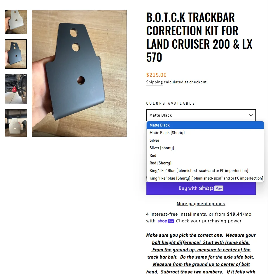

What does the Dr KDSS bracket do? Fixed the rear alignment? Seems like you added the shorty bracket in your build.
Yes, that’s exactly what it does.
The shorty works perfect for us
Posting here so others have it too. @Boston Mangler could you share the link or part number for the shorty Dr Kdss bracket? I can’t seem to find it online on their website. They either got rid of it or I’m just not looking at the right place.

Click on drop down menu
