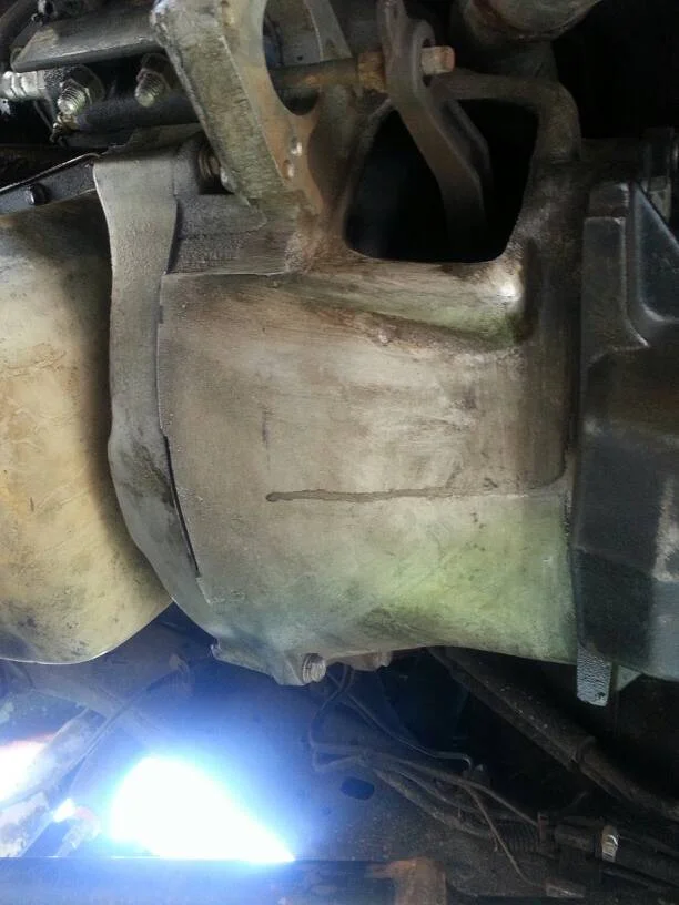

The transmission has a slow leak. So does the front diff, not enough to worry about, just enough to leave its mark.
