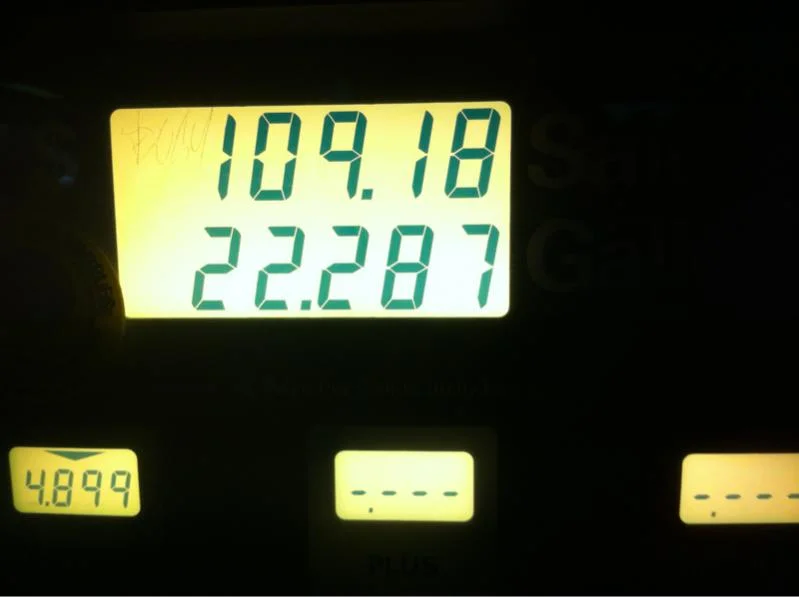

I just spent $109.00 on 22 gallons of gas. Just now. Sheesh.
OK, that makes it sound better.
New aux tank = ~348 gallons of gas.
