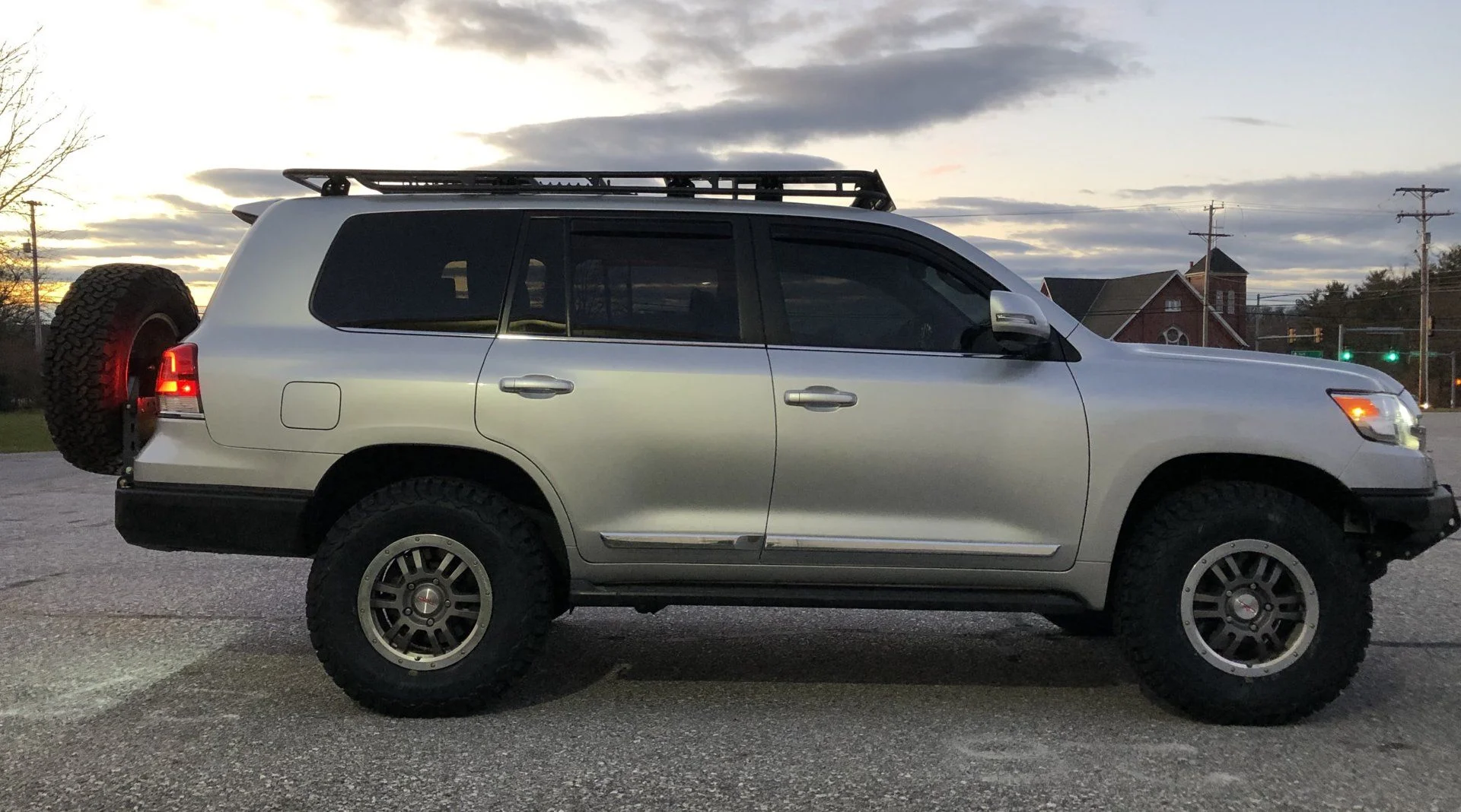

Had to remove the front mud flaps. It kisses the KDSS just slightly at full lock.
285/75/17 KO2s. 38psi. Spidertraxx 1.25” spacers. SPC UCAs.
FYI, true height of the tires is 32.75". BFG claims 33.9", so they're overstating by at least an inch.
