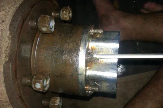

After reading ur posts & dont have a brass hammer , after few attempts , put the nut back on & tappd it , workd a treat,then drove flat head screw driver in slot and popped out , thanx for ur help . Usa/canada time diffrnce works a treat when u workn on ur truck at night / early morn & u get stuck &

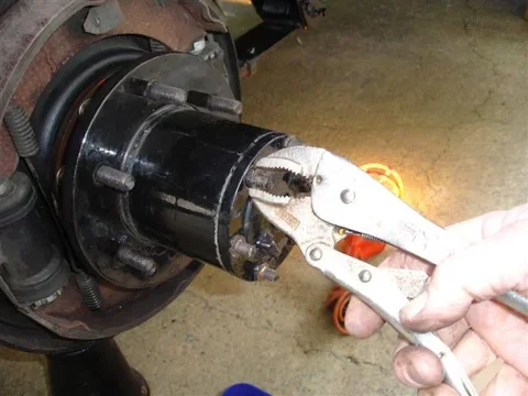

I just use vice grips and no whacking at all.

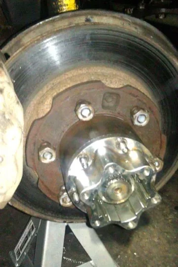

You just wanted to show off the full floater!
If you can grab them with vice grips, then they either weren't tightened enough or someone put anti seize on them before the last install. If they're tight and rusty like most, then a few whacks with a brass drift and a BFH will do the job.

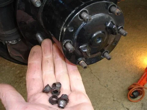

OK. I'll come clean..............
I had been into that hub before (at least a decade earlier) so those cones would have been inserted covered in copper grease.
And furthermore .... I can indeed recall the days when I butchered factory-installed (read "without antisieze coating") cone washers and had to purchase new ones (before I knew about the "whammmo method" which I admit I've never tried).
