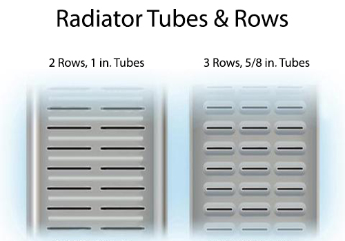

I would caution against buying a 4 core aluminum radiator just because it has more cores. More cores was a selling point regarding copper and brass radiators which had tube sizes that were limited due to the strength of the material. Aluminum tubes can span longer.
Which configuration has more surface area? Which radiator has more possible failure points? Which one has better airflow?
A diagram showing a cut-away view of a 2-row and a 3-row radiator.
1998 OE...
But don't get me wrong, there are other dimensions to take into account that might make a 3-row radiator better than a 2-row. But in the case of the 100 series, I would certainly NOT use a radiator that has a greater depth as that would put the radiator closer to the cooling fan.

As @hoser said, I read somewhere that more tiny rows might not be necessarily more efficient than larger cores. Also more failure points. So my logic is simple: 3=(2+4)/2 :rofl:. So 3 row has the best of both side. In other words, 3 row may also have the worst of both side:p
