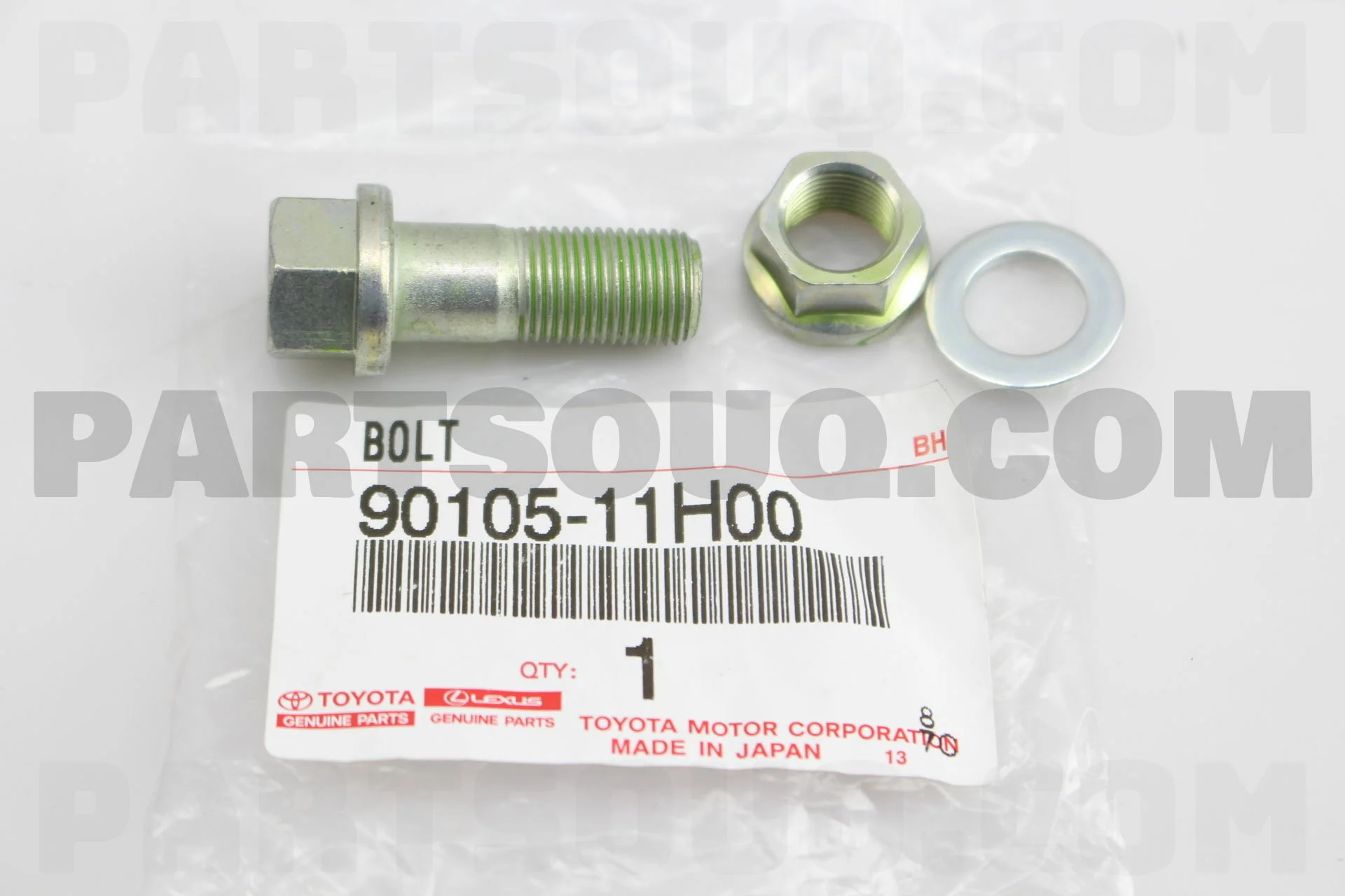

There's a (Propeller shaft) Hexagon Bolt Set (90105-11H00) which consists of a bolt, nut, and washer, the bolt and nut have the green coating (see photo).

The first two photos show different views the same part number (kit 90105-11H00) :
The top photo appears to show an uneven amount of the coating on the threads:
If you click twice to magnify you can better see the green coating in the threads which appears more uniform on this bolt:

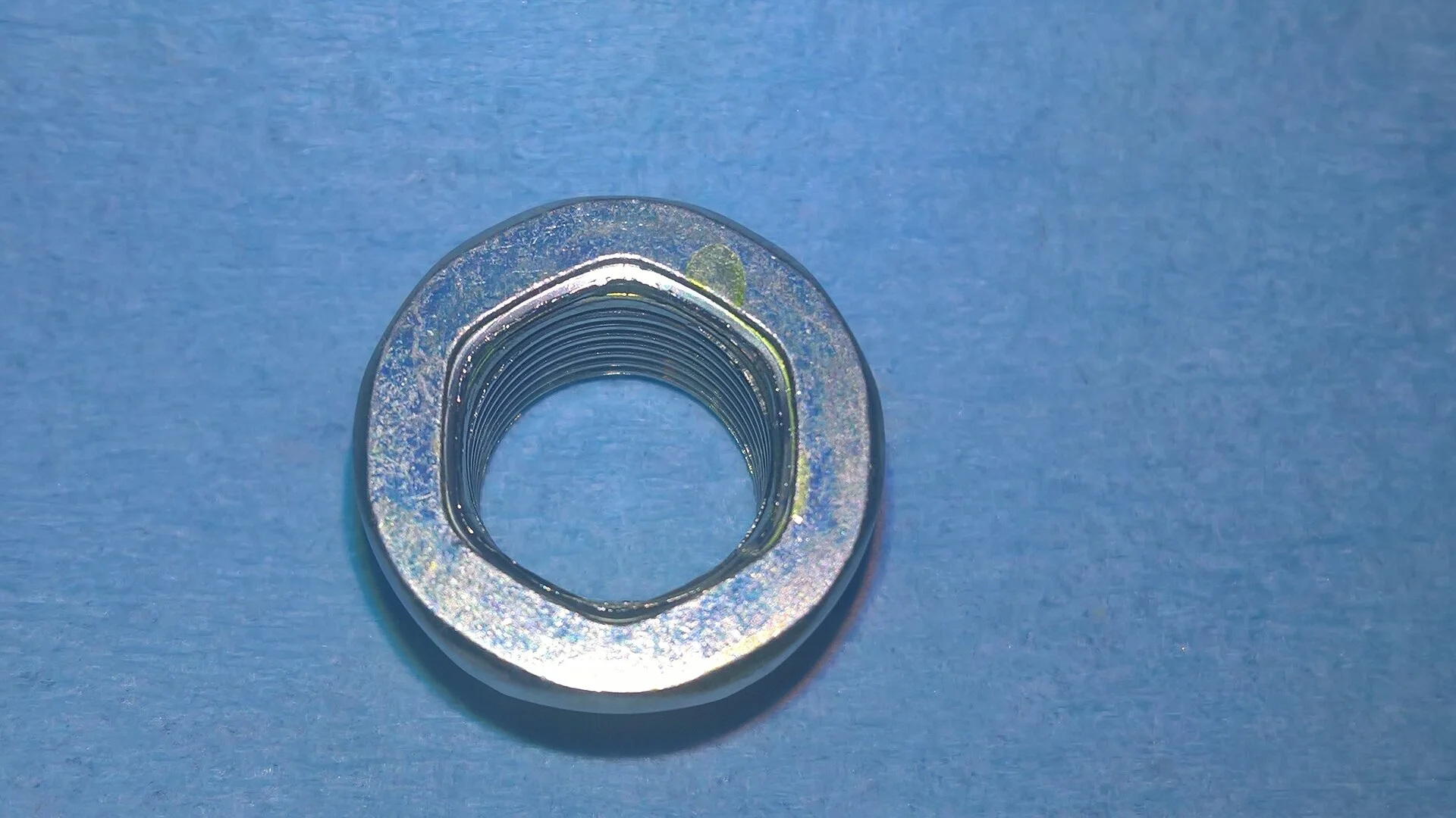

These last photos show a new Toyota (Propeller Shaft) Nut (90179-11005) which is available separately or comes with the kit above.
Top view:
The bottom views show the hexagon (deformed) shape of the lower threads, so it appears that this new unused nut may be a distorted thread type of lock nut.
Another view a bit more angled to better show the distorted threads of a new Toyota nut (click twice to magnify):
So rephrased the title a bit, particularly because (other than the torque specs) the FSM doesn't mention using anything on the fasteners. The poll is geared toward what someone has used in the past.
Either way, it's all good
If you look at the flange nuts in the photos above they appear to be a type of distorted thread locknut (? obround). What is different is that the deformed section is at the bottom of the nut/threads (IME most are either top lock where the deformed threads are at the top or in the middle of the nut).
