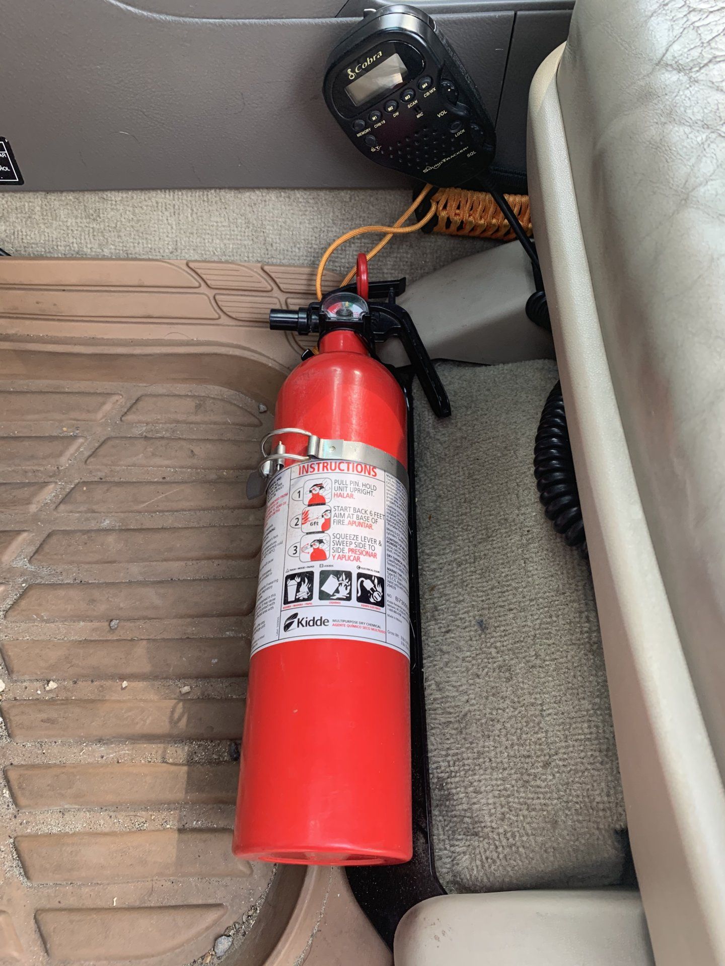

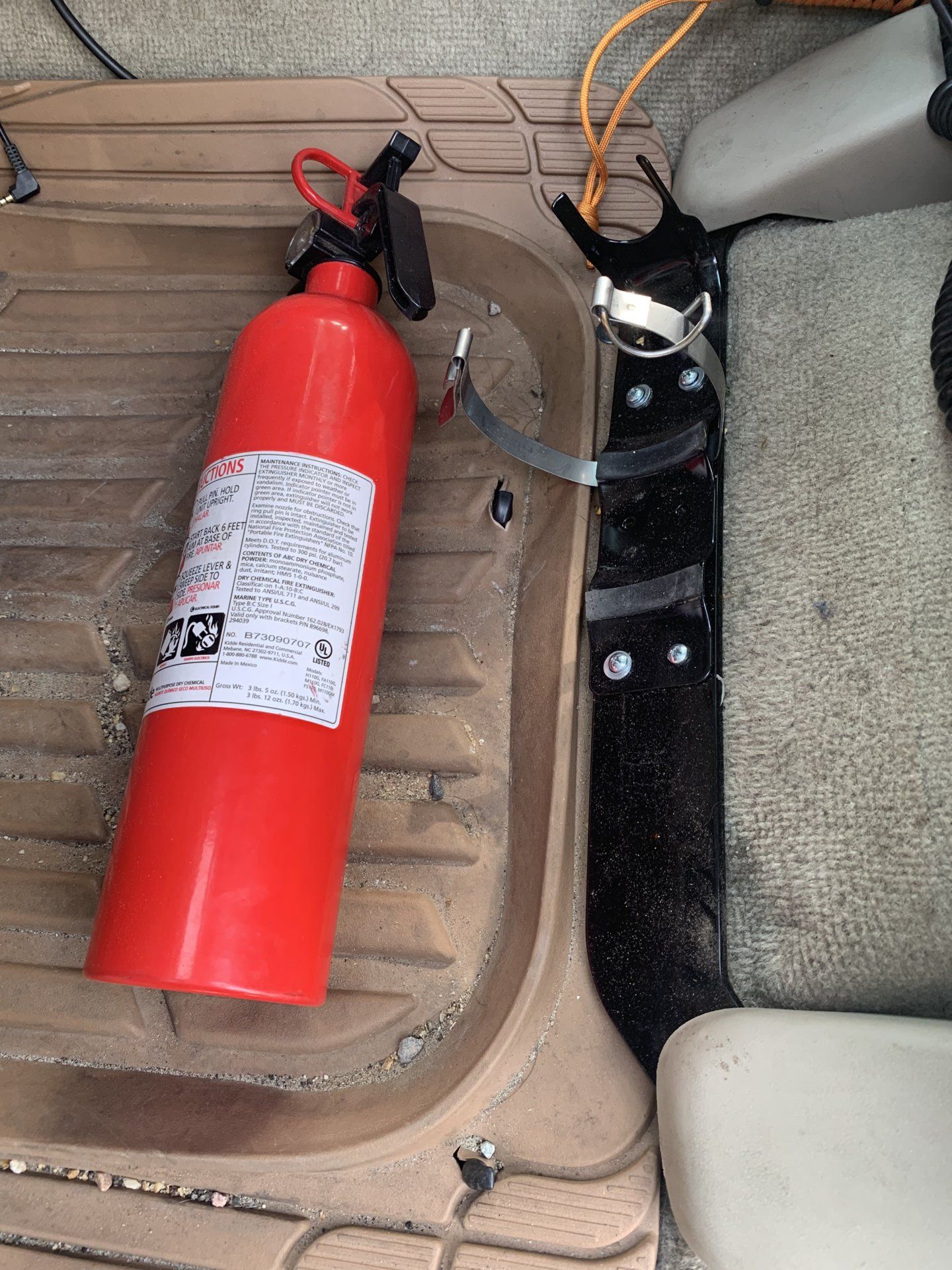

I’m not on Facebook and Dan can correct me if I’m wrong but I think just having a gx allows you to be a part of gxor. Which is why I got this:
Absolutely correct! Come on! gxor.org

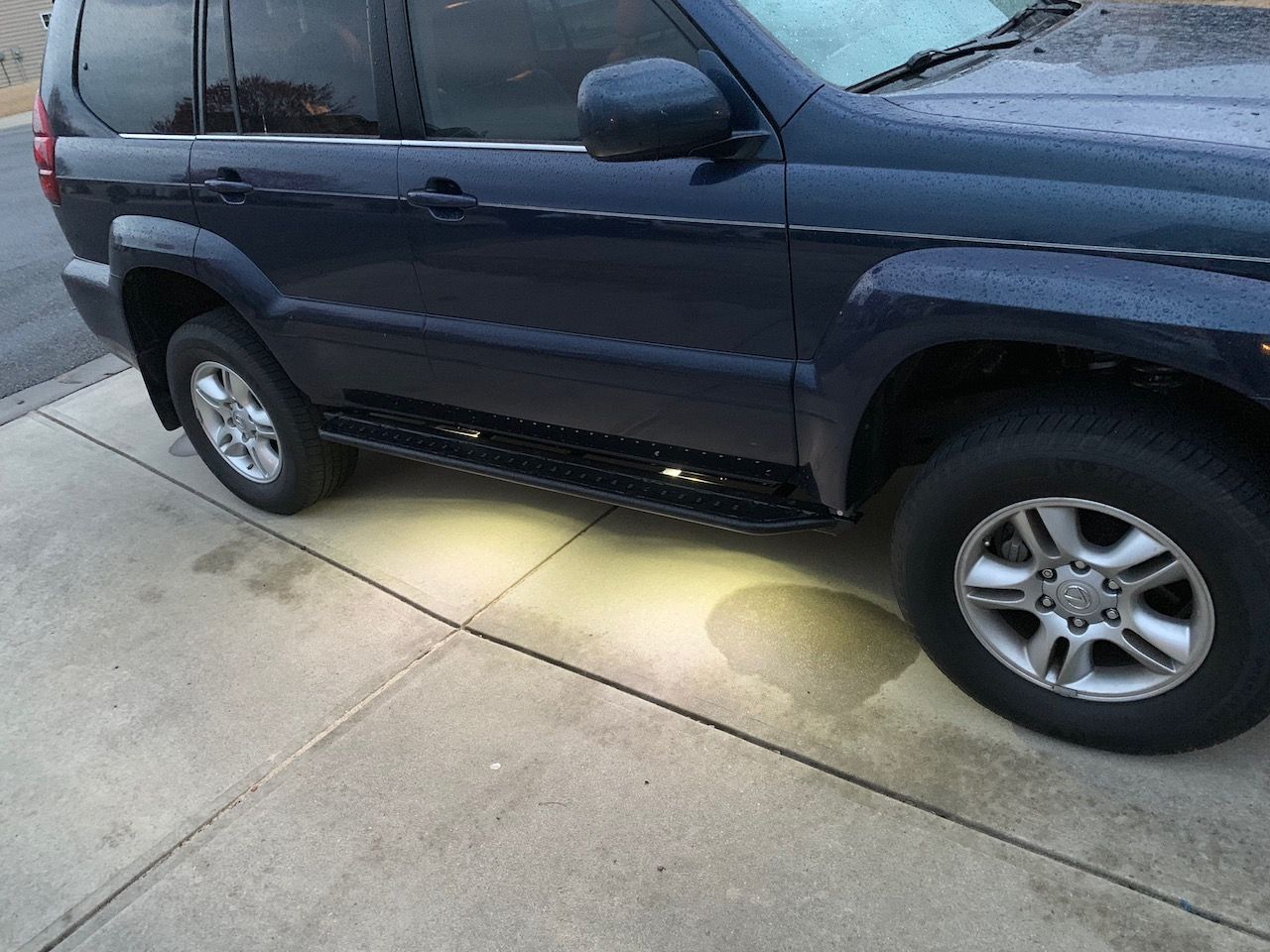

installed "rock lights" under my sliders using the plug from the stock running boards:
Rock Light Pods
1933597
Yes. the rubber pads that come with them are curved as if to fit to a tube instead of flat. So, the stainless bolts that are included are barely long enough. I will just get longer ones from the local hardware store. For $25, they are pretty bright. This is a picture from a few minutes ago (20:15). They are mounted at 45* but probably would have been okay mounted horizontally with the ground.
Also, for anyone using the factory plug, you must use both of the factory terminals as the + is a constant hot. The controller controls the ground not the positive. I tried using one of the factory running board mounting bolts for ground and the lights stayed on. FYI

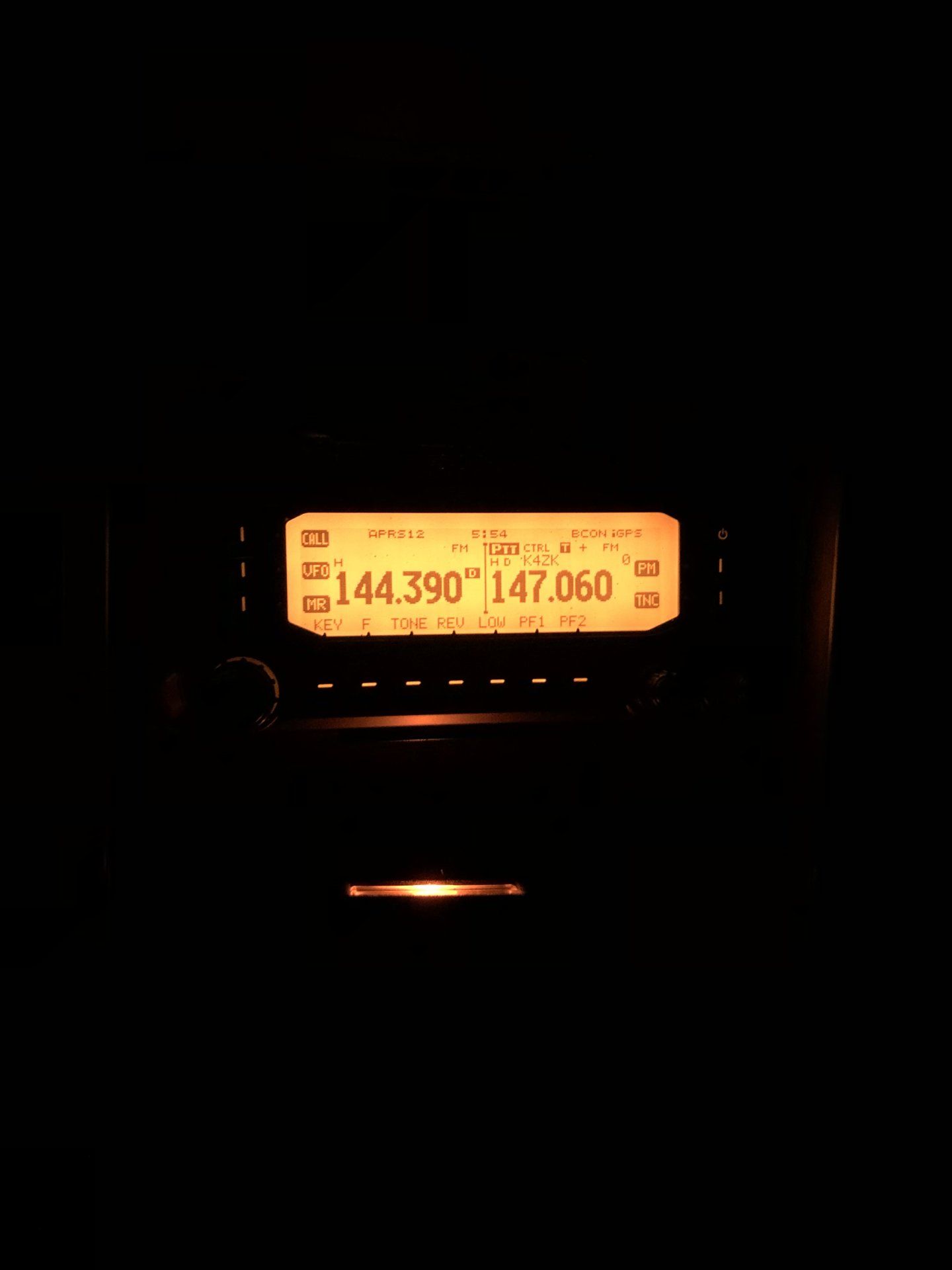

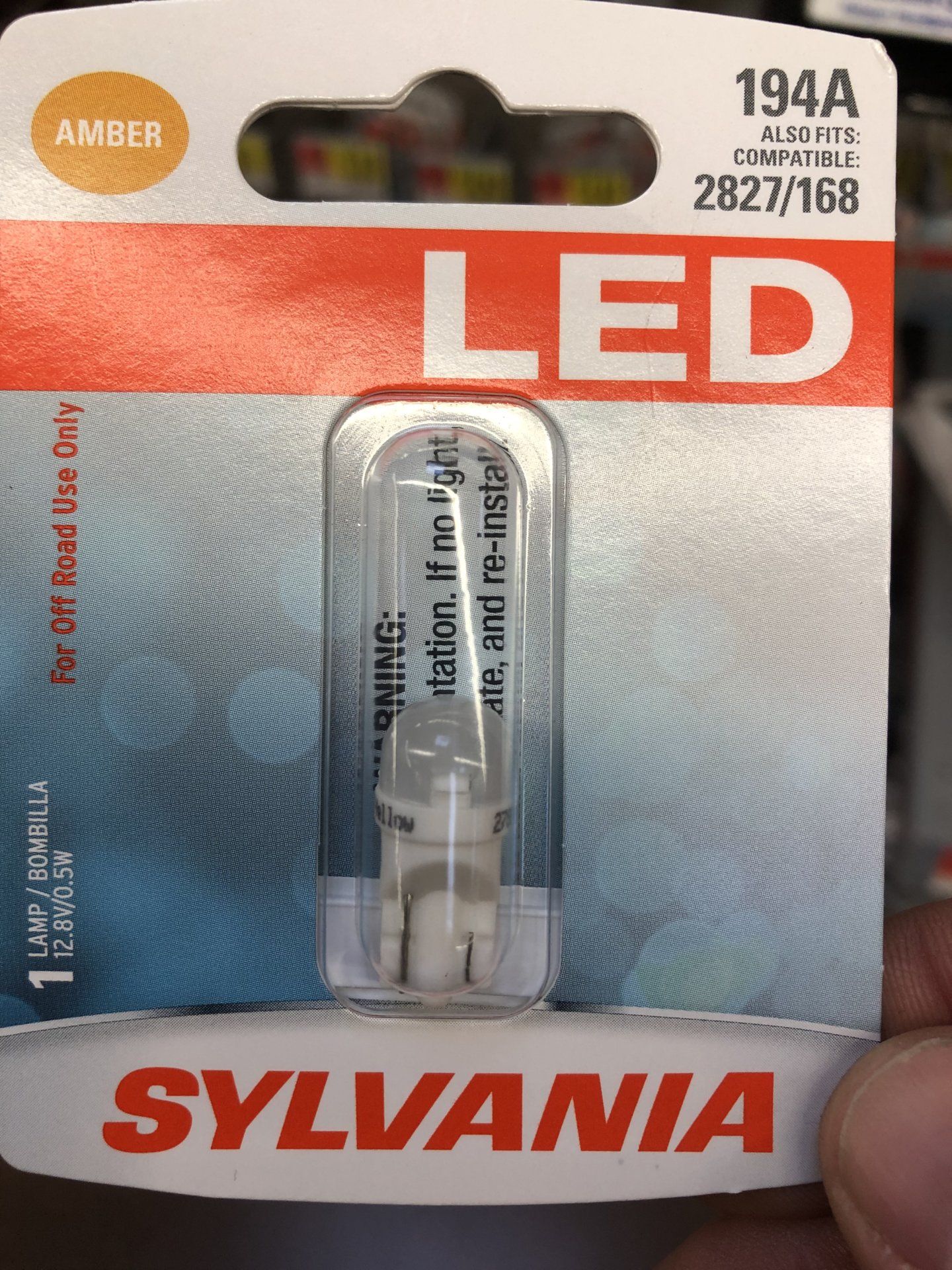

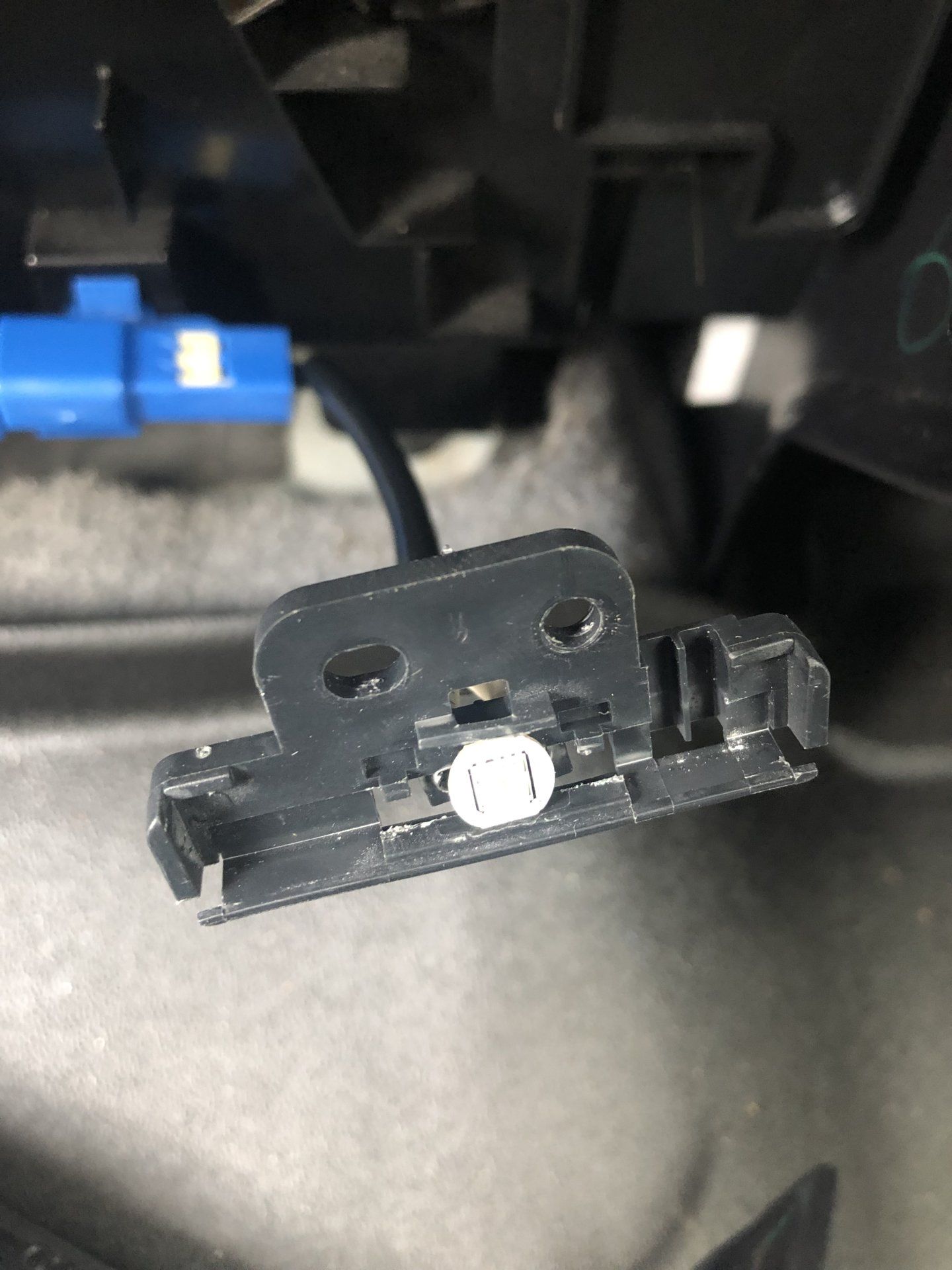

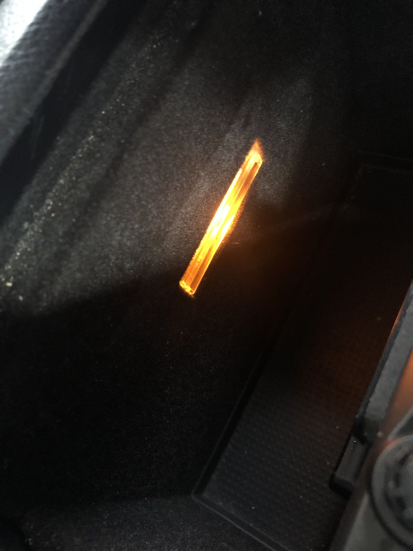

Fixed/upgraded my center console cubby light. The factory LED strip light never worked since I got my GX. It was getting power to it and I figured it would be cheaper to upgrade it than to replace it with the original. So I picked up a LED 194 buld from Walmart for about $6 and soldered it into the harness. To do that I separated the small green circuit board from the light assembly and cut the wires. Then I popped the cover off of the Walmart bulb and pulled the led out of the plastic plug. I drilled 2 holes through the black part of the factory light assembly, ran the led prongs through it, and soldered it to the factory wire harness. It was a little bright, so I put a piece of the white heat shrink that I had left over in front of the bulb under the plastic lens. That make it just bright enough. I chose the amber bulb to match my radio, but the color options are endless.
Thanks for this!
Mine's been dead since we got the GX but I haven't investigated..now I have an idea what I'm getting in to. Thanks. 👍

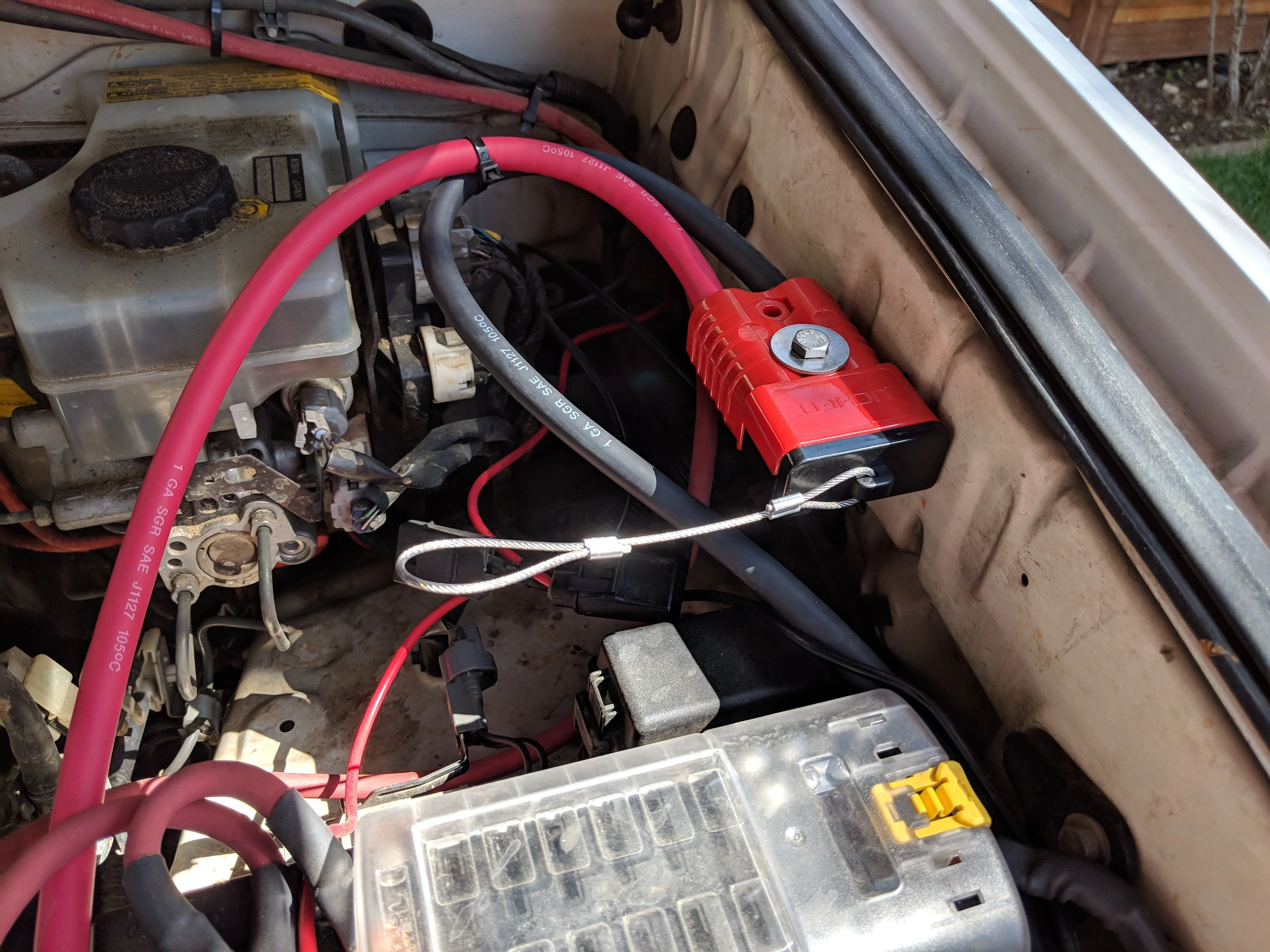

Haven't used it enough to know if it's even a good mod, but when installing my winch I went with an Anderson style connection so that I could keep the winch de-energized day to day, and I also put one on the end of my jumper cables for kicks. $30 in cable and connectors:
