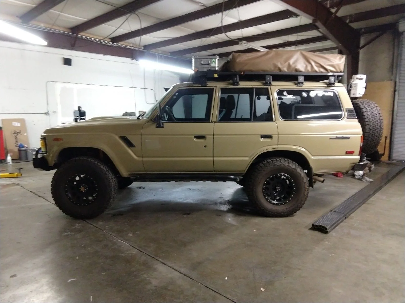

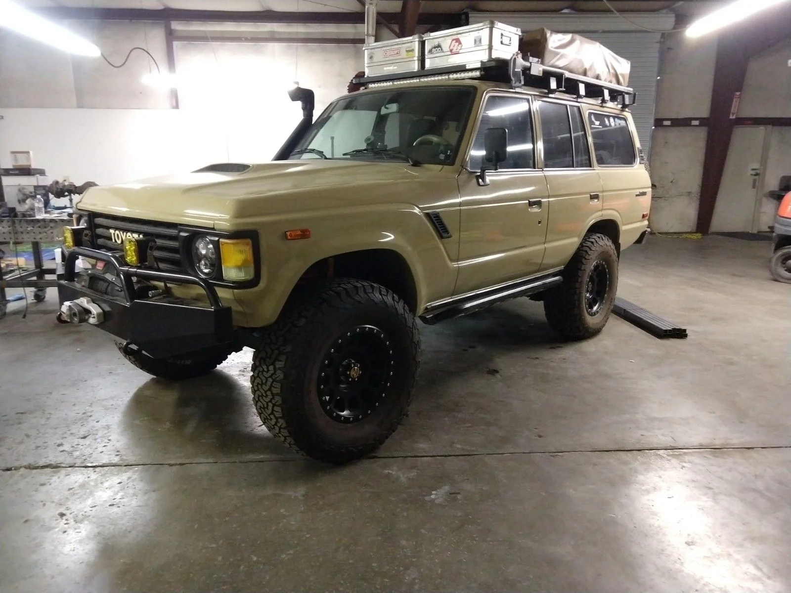

Here is the latest 3" coil conversion.
J
LOVE that hood!
That rig looks a lot like the Sandy 60. They merged a 60 and 79 hood.
Along with the better ride quality, not having springs and UBolts hanging down under there is a big upgrade. I guess the leaf spring guys can do a UBolt flip...?
The 76 on 4WD action is always getting hung up in the mud on his spring hangers and the 80 goes through OK.

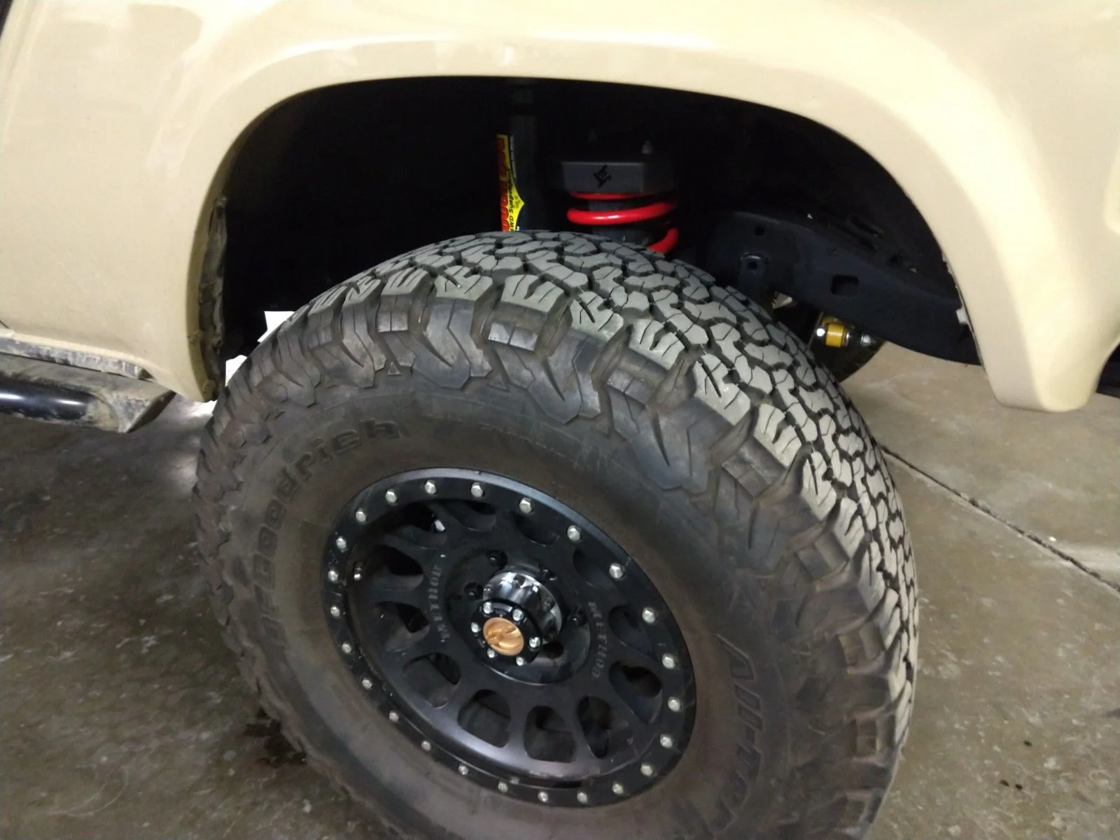

Here is an example of Dobson 4” lift with TT coil kit
