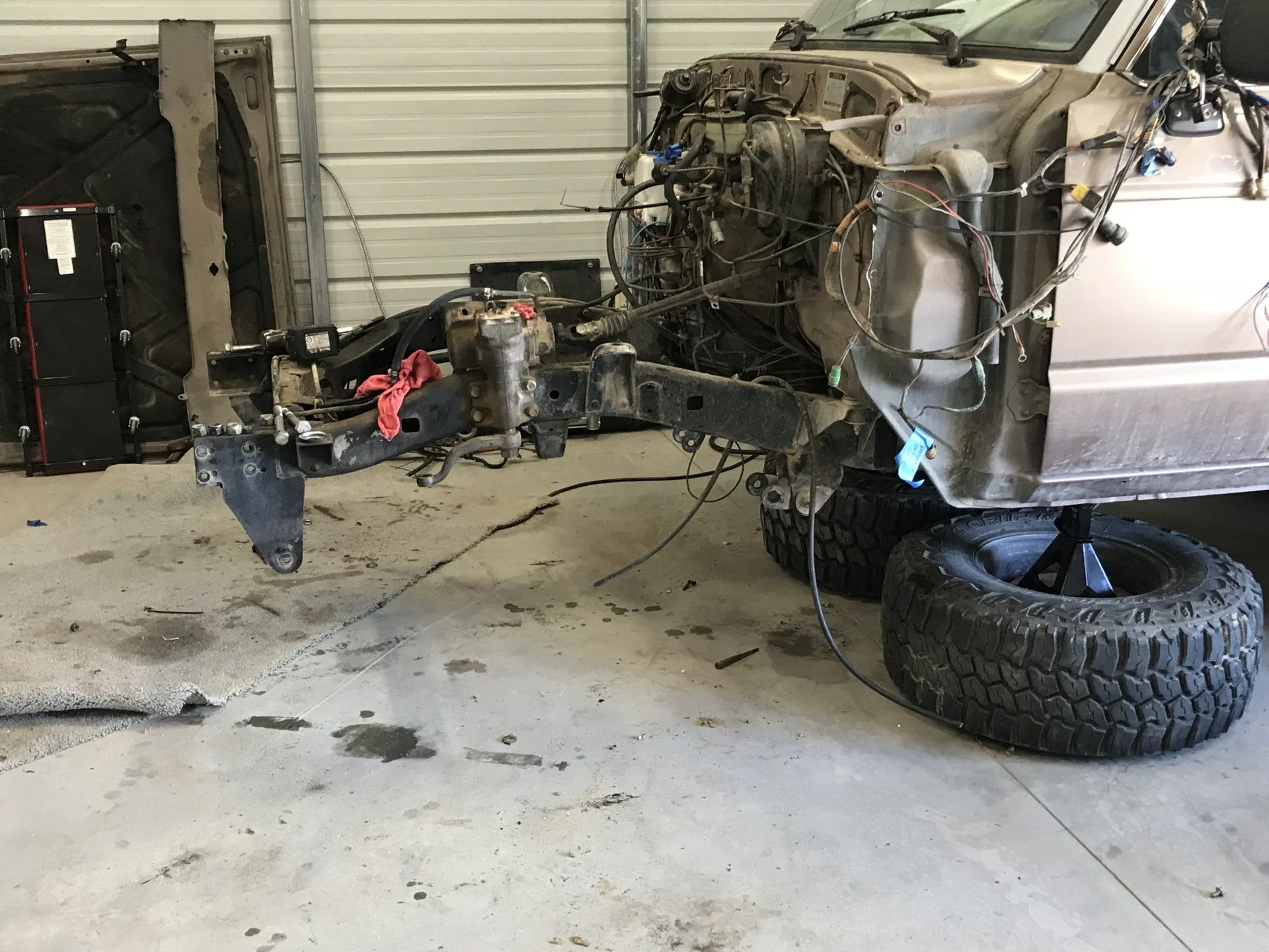

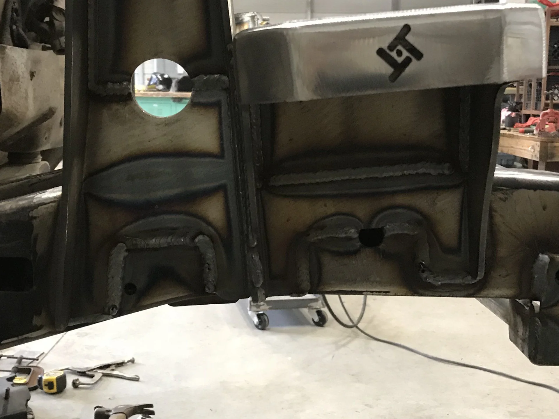

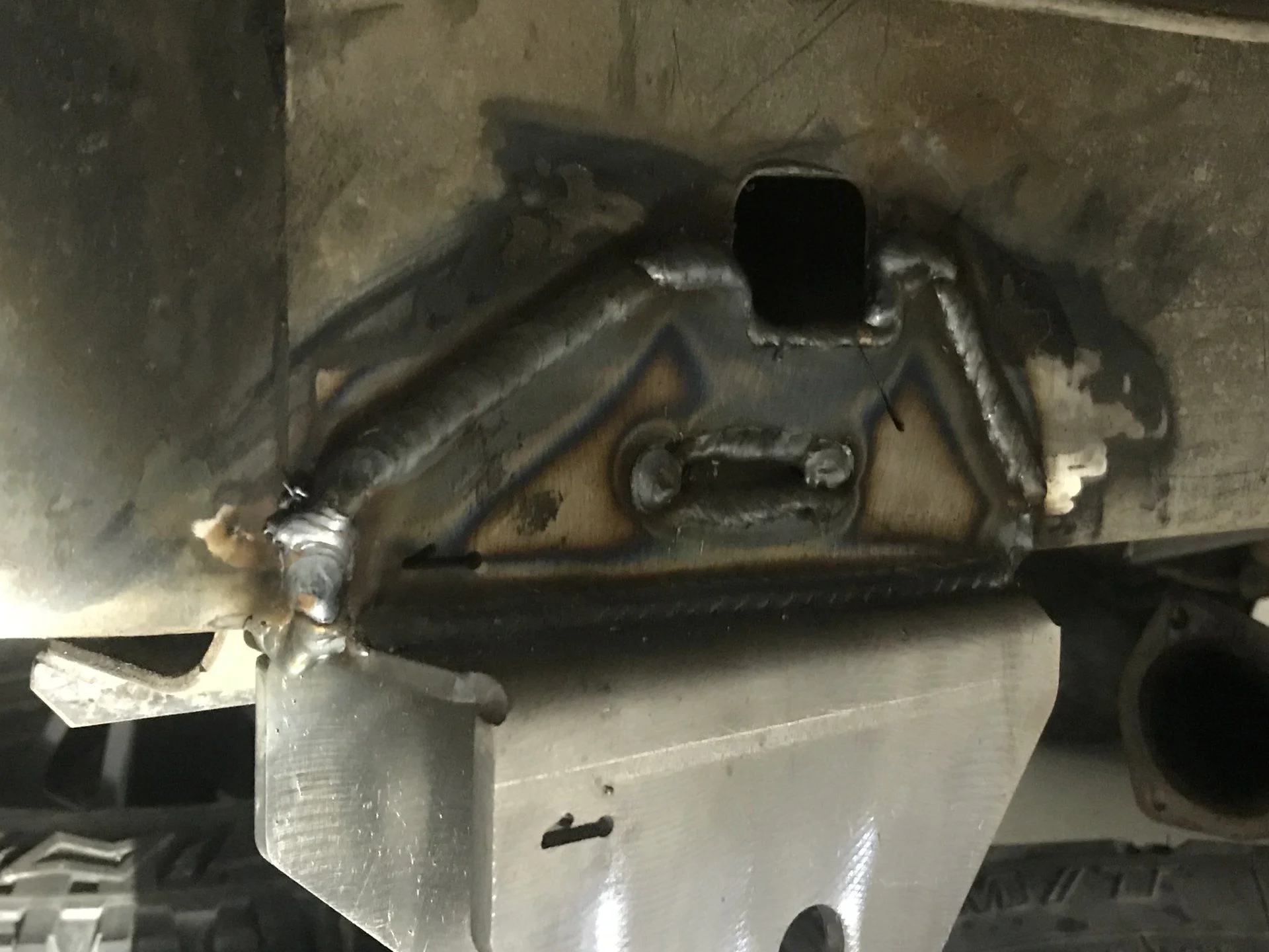

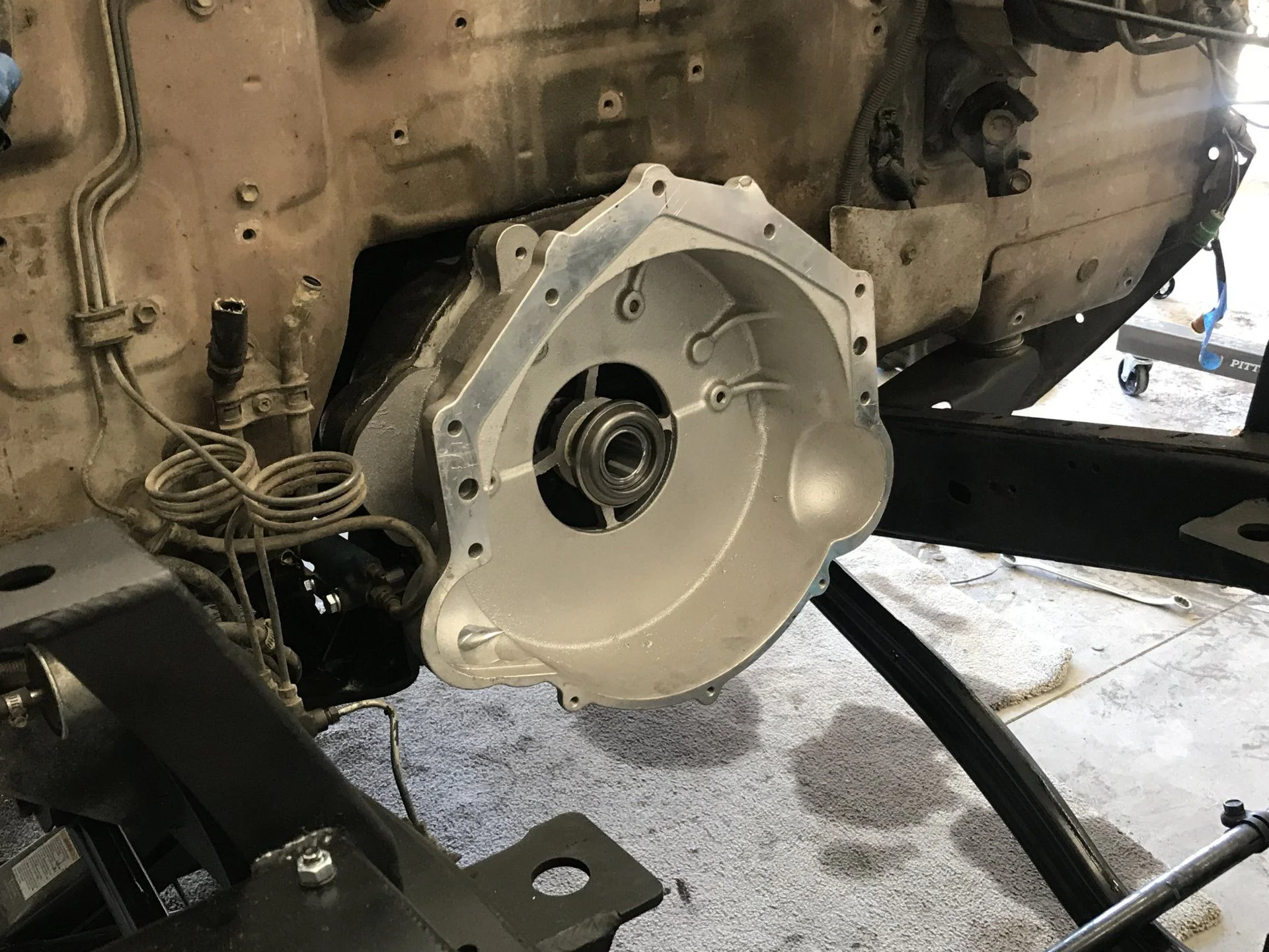

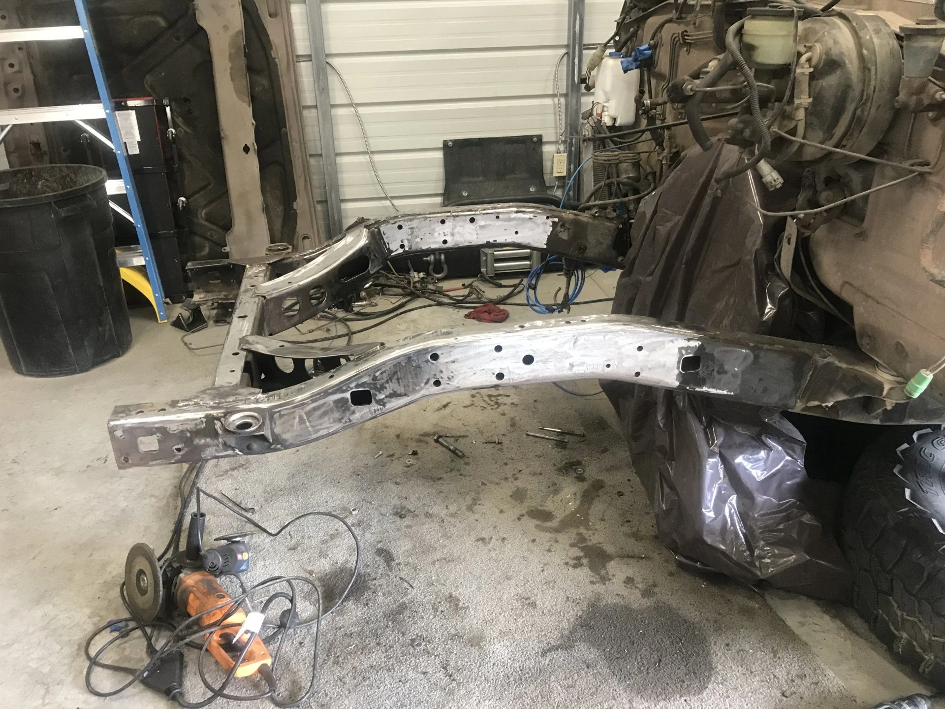

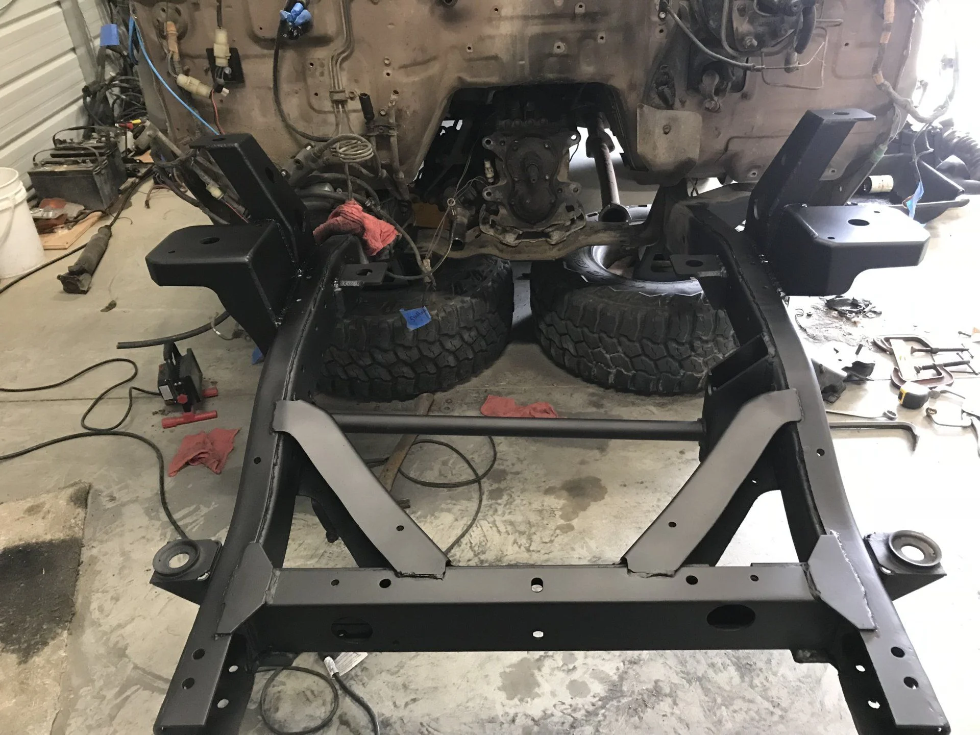

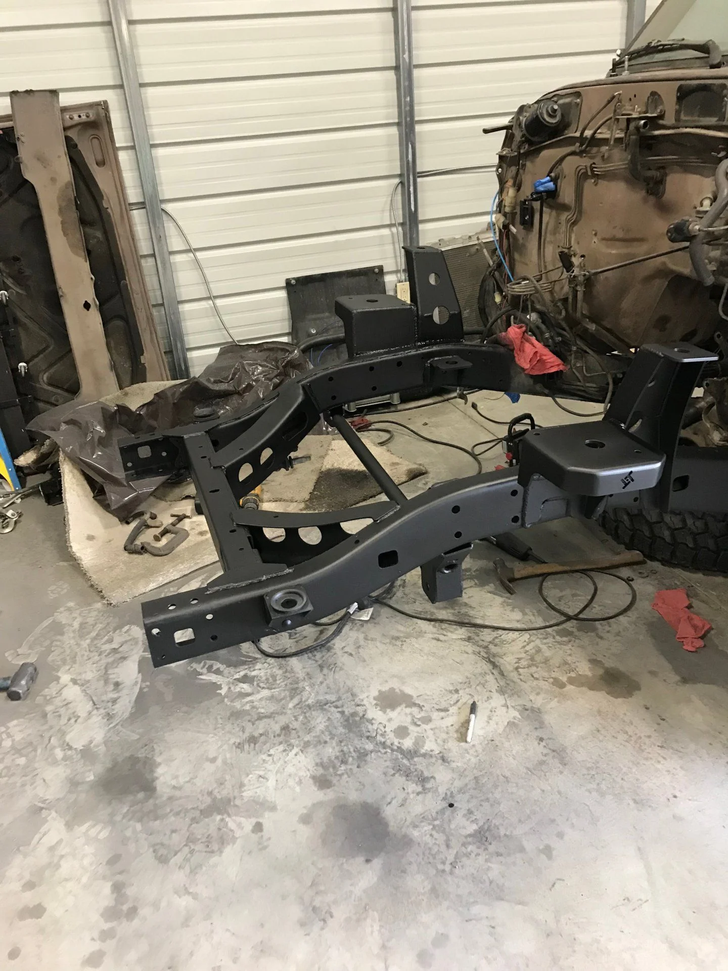

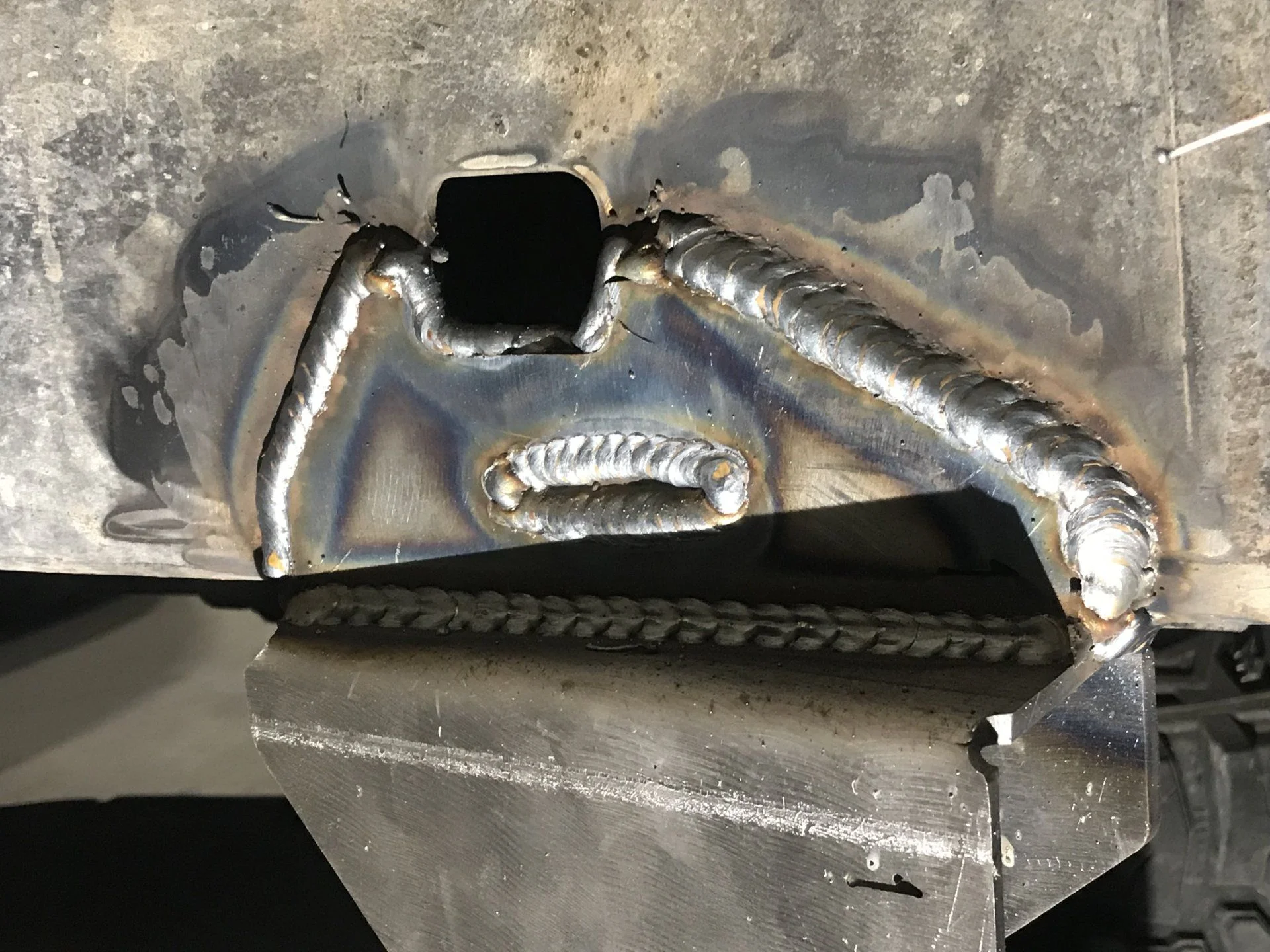

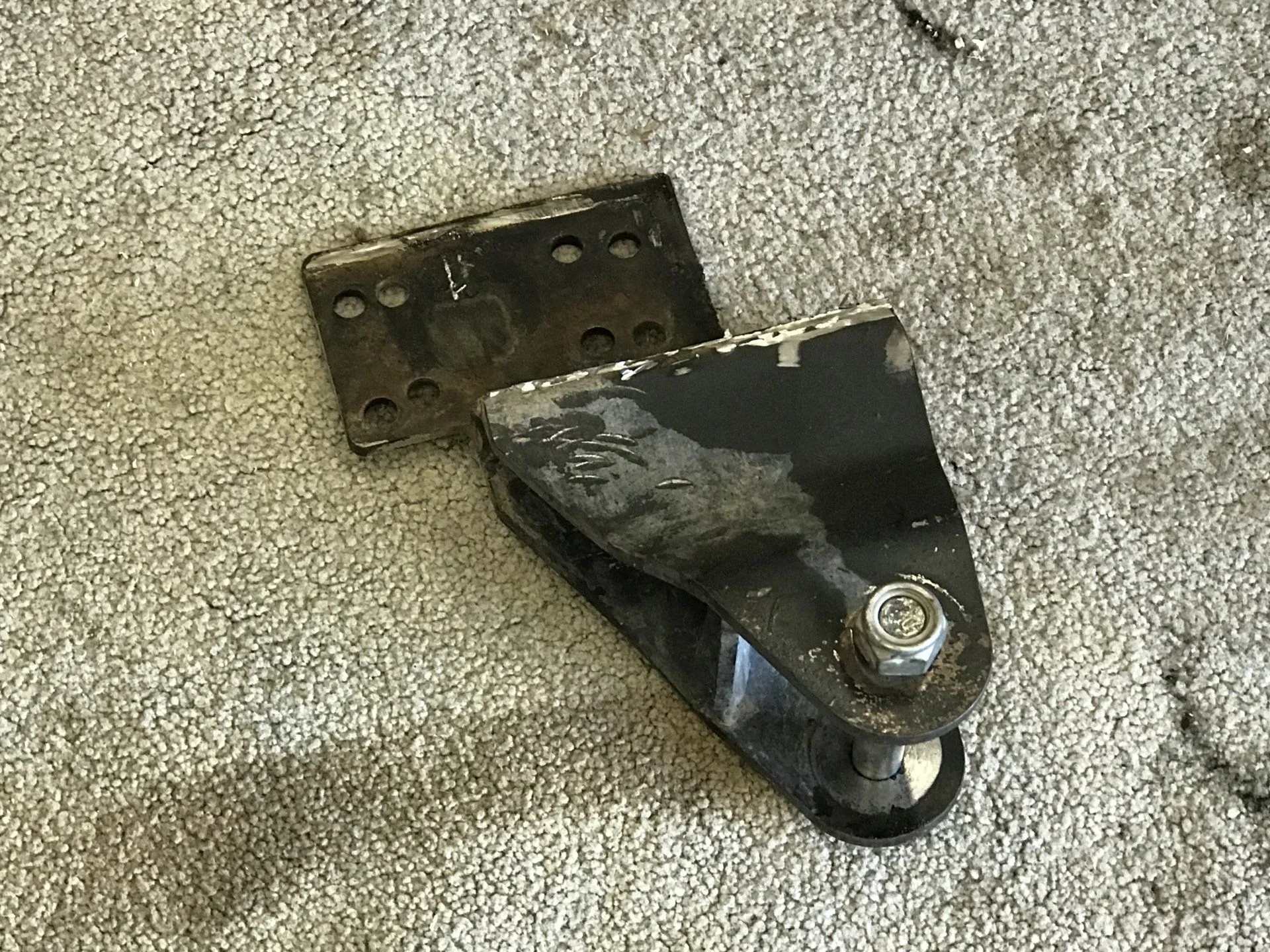

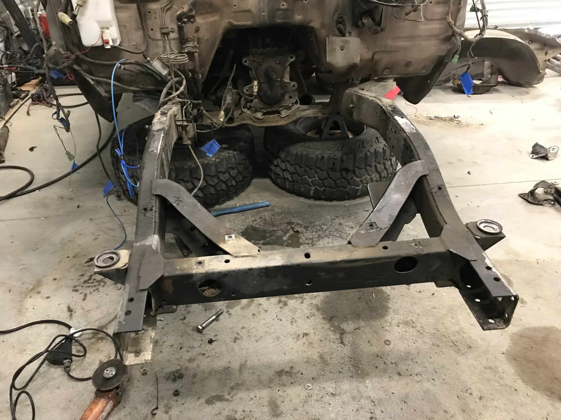

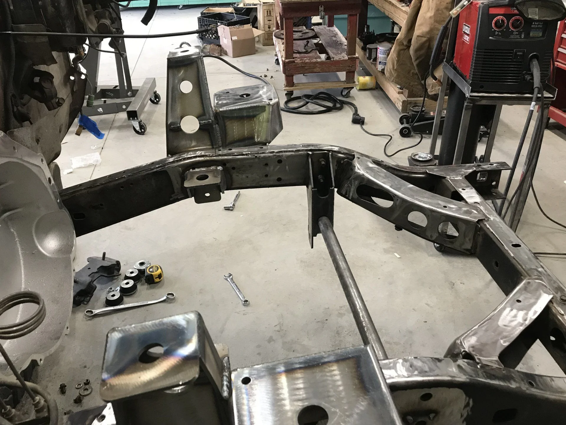

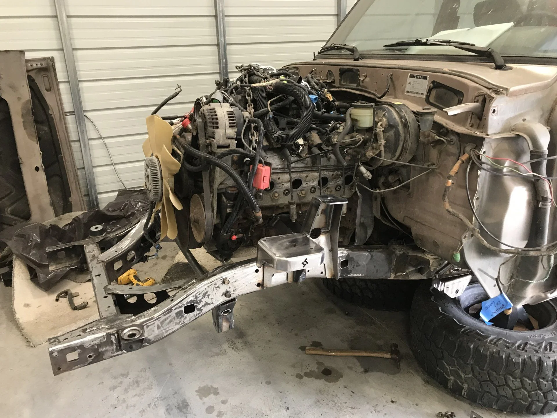

I started disassembling Fj60 a couple of weeks ago. I'm going with marks v8 conversion kit and because i'm taking the front fenders off I decided to put trail tailor coil kit on as well. I had a lot mounts I need to cut off my frame to get it ready motor and coils mounts. I cut off reverse shackle mounts, rear leaf spring mounts and shock towers. I motor I decided to go with is a 2002 lm7 5.3 from bows auto it has 122000 miles on it with a 1 year warranty it just arrived. I stared to weld in the rear control arm brackets on and before I weld in the coil bucket I will dry fit the LS and then weld on the motor mount brackets.

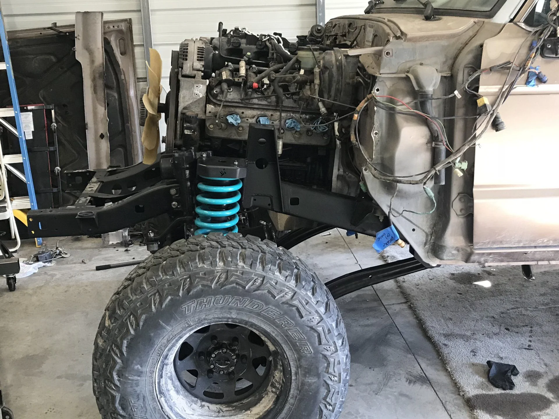

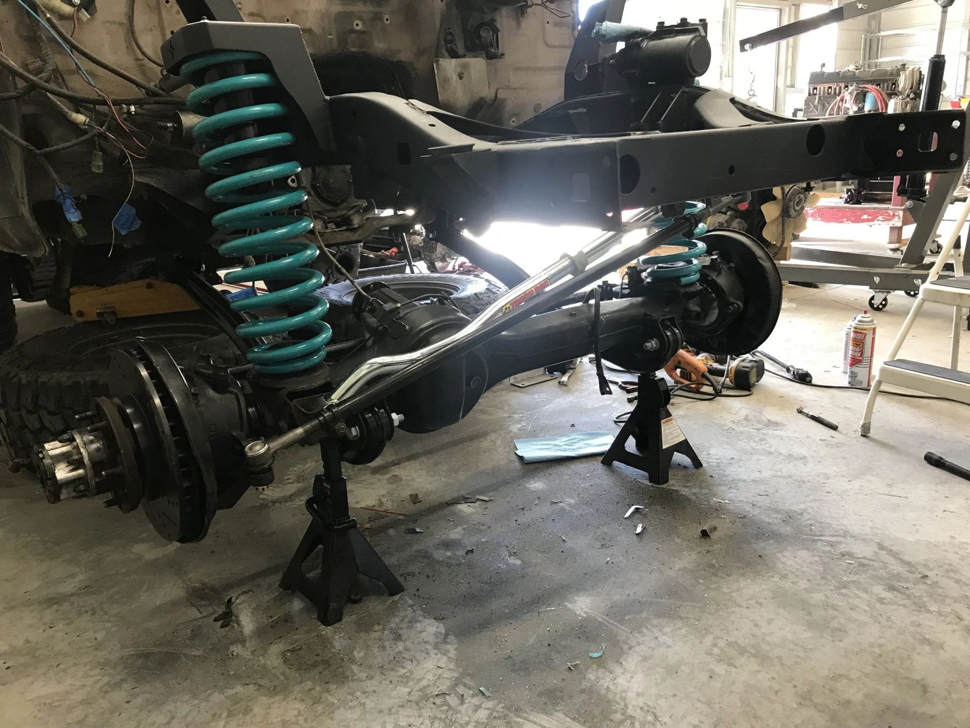

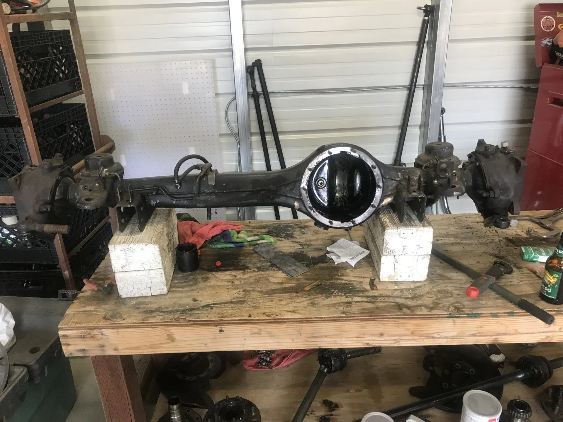

Just the front for now using Trail Tailor coil kit using a 80 axle that I pick up that I'm rebuilding and putting a arb locker.
I'm have purchased dobinsons coils w 4" lift and supperpro control arms (radius arms).
thanks Its a 97 I look in to it
thank for the info I'll take it in to work when they open back up and cut a new groove

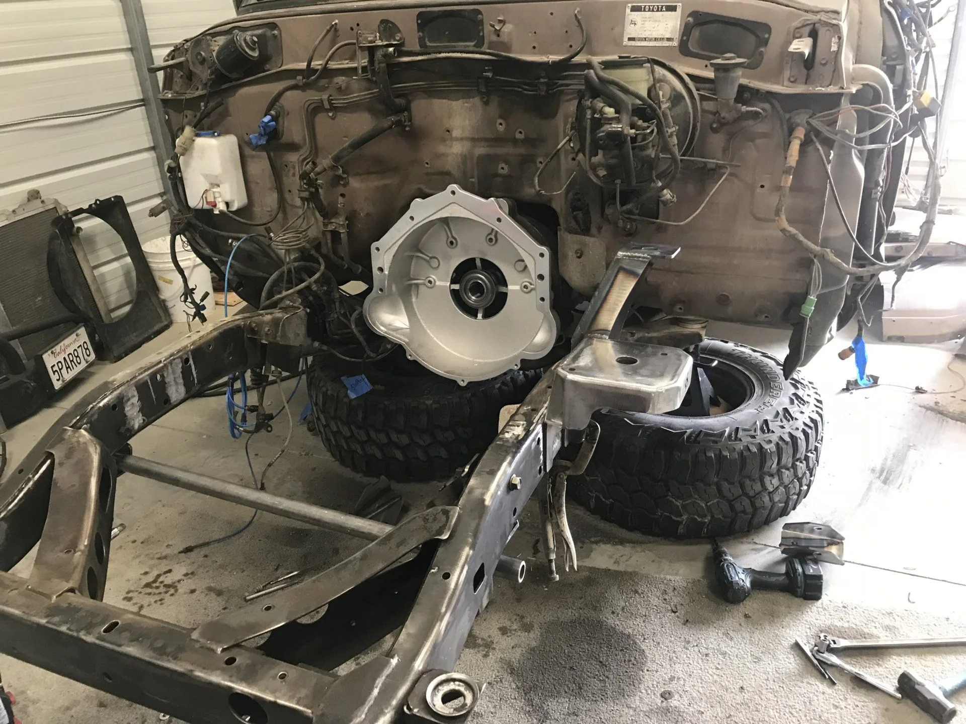

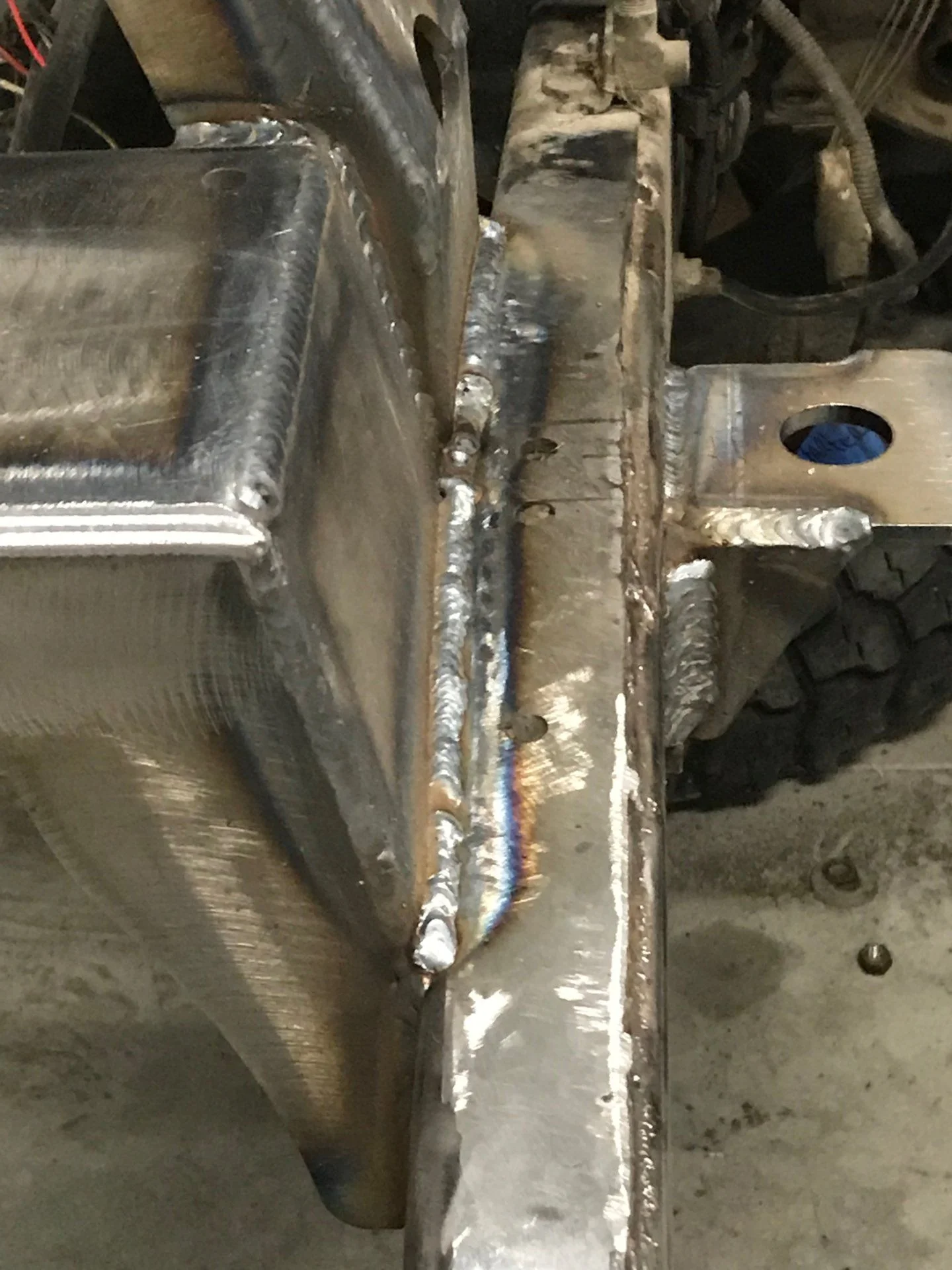

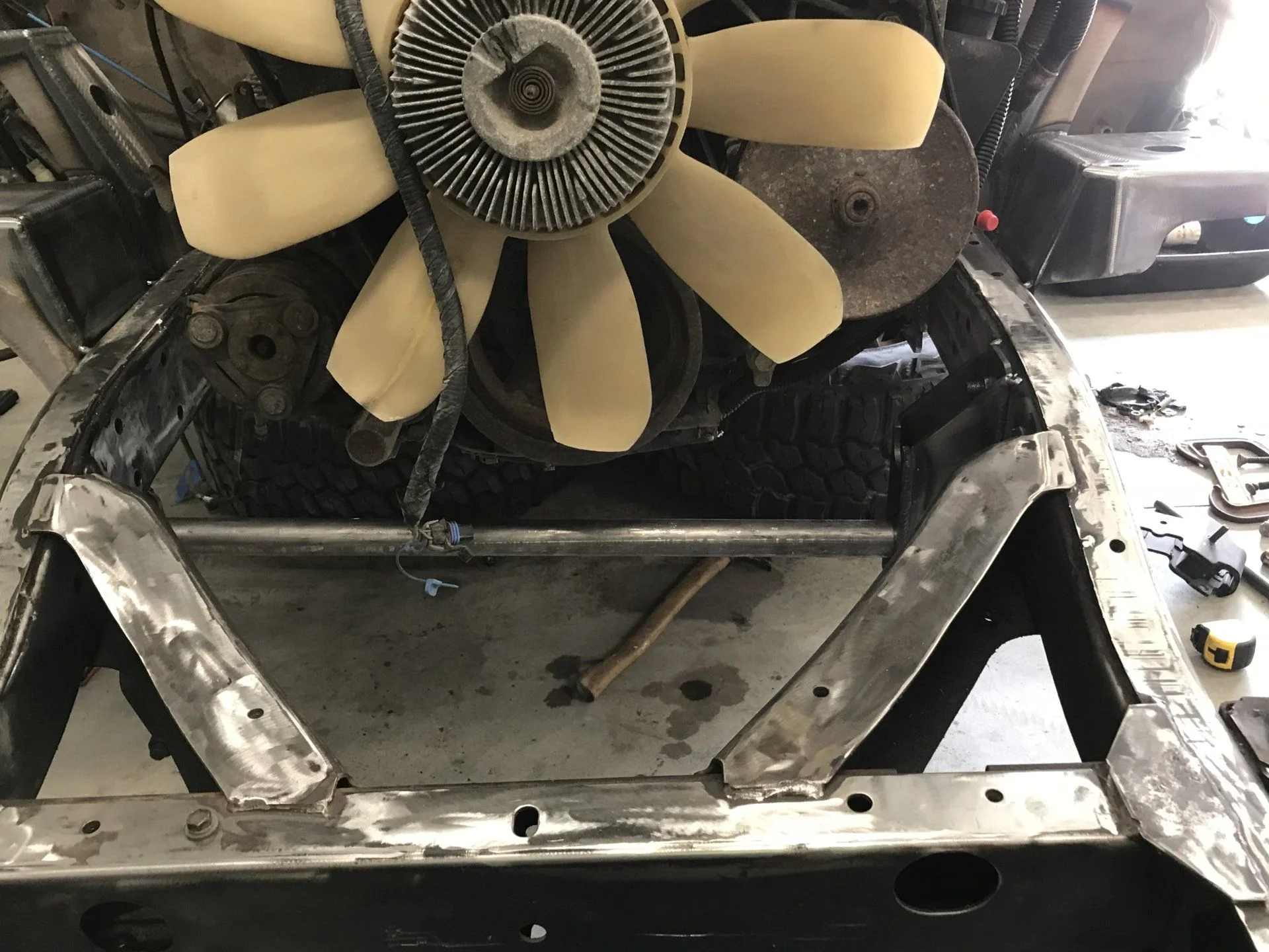

I been working for a few days on getting the engine align and tac in.
After dry fitting 10+ time it feels like finally burned in all the mounts and brackets for engine and coil front axel.

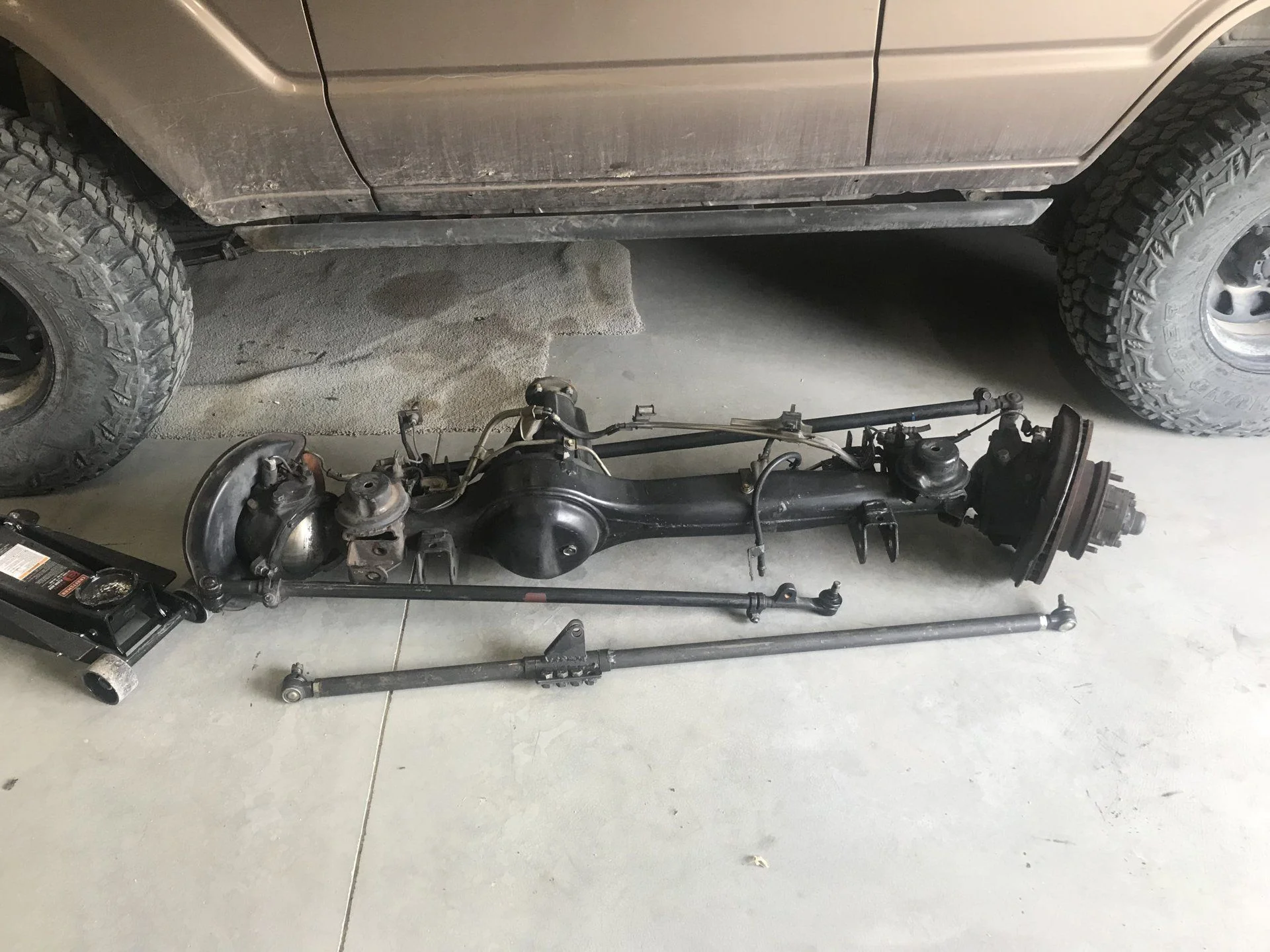

Now i'm working on rebuilding the front axel finishing putting in the locker setting backlash and marking the gears for wear.
I was hoping to finish the front end tomorrow tell I snapped the ARB bulkhead fitting on the third member s***.
I order the bulkhead fitting and hopefully get it this week and maybe have the front axle mounted in the frame next weekend.

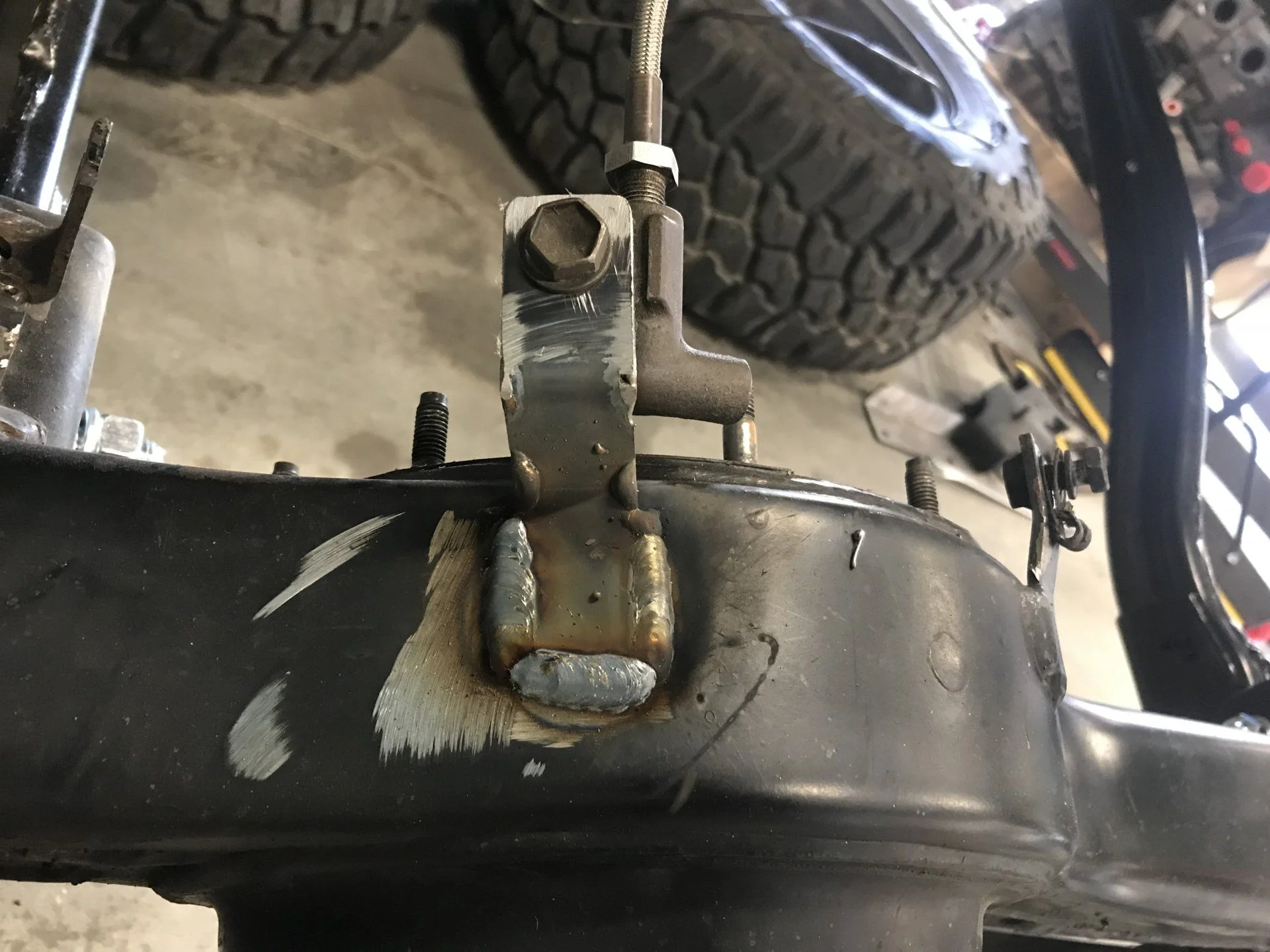

Put my axel in today and started working on the brake line.

The Trail Tailor coil kit is pretty straight forward.
For the kit you need complete 80 axel, hollows, control arms, pitman arm, springs and you have to redesign the brake lines so far.

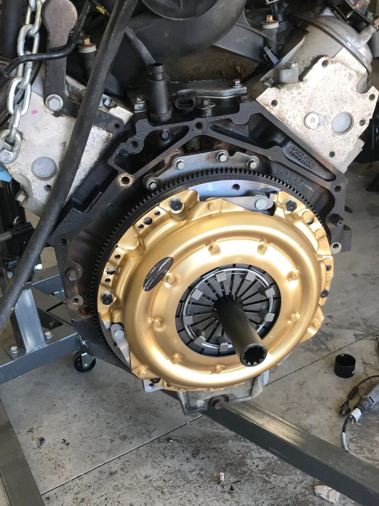

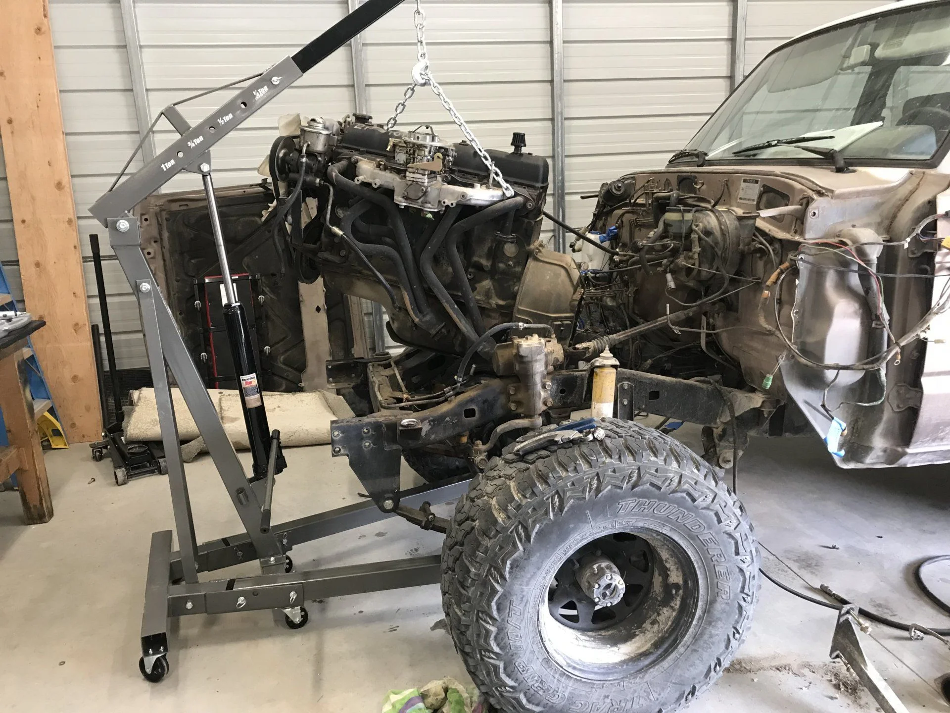

Well I been working a lot as well as on the FJ. I finish the brakes, clutch, and put my Engine in for the last time.
I've ordered a wiring harness and some other things from Mosley motors and should have them soon to get fired up.
