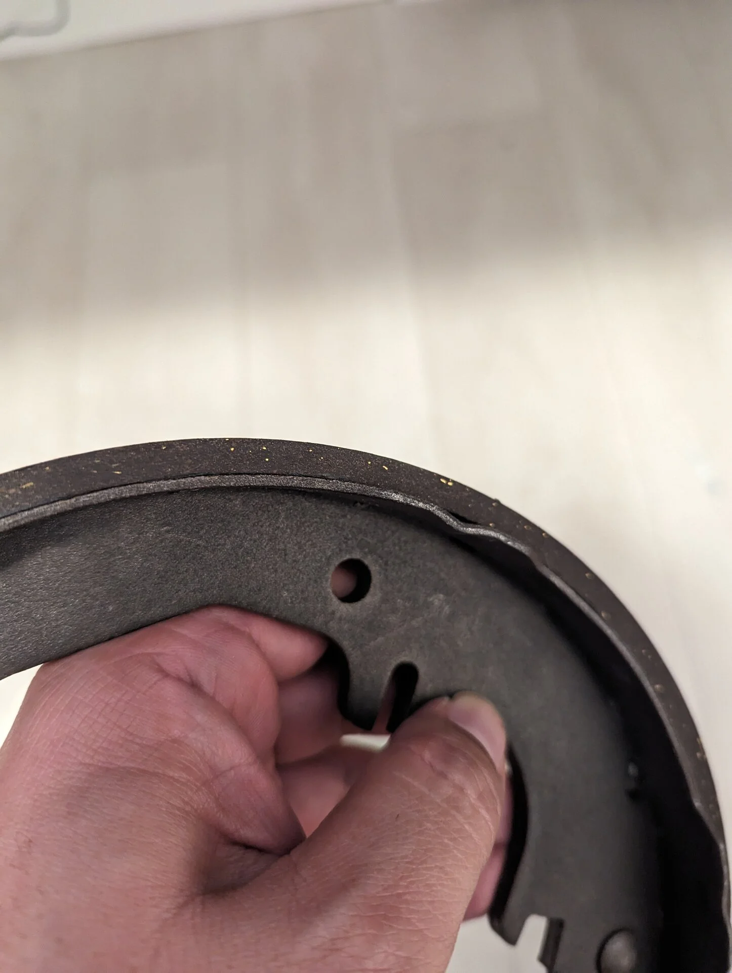

Also not sure I ever posted these, even on SM, but had some custom brake shoes made with meatier pad compound DIMs. Means the outside diameter of the shoes are just a tad larger so they bite into the inside of the drum earlier and more aggressively.
