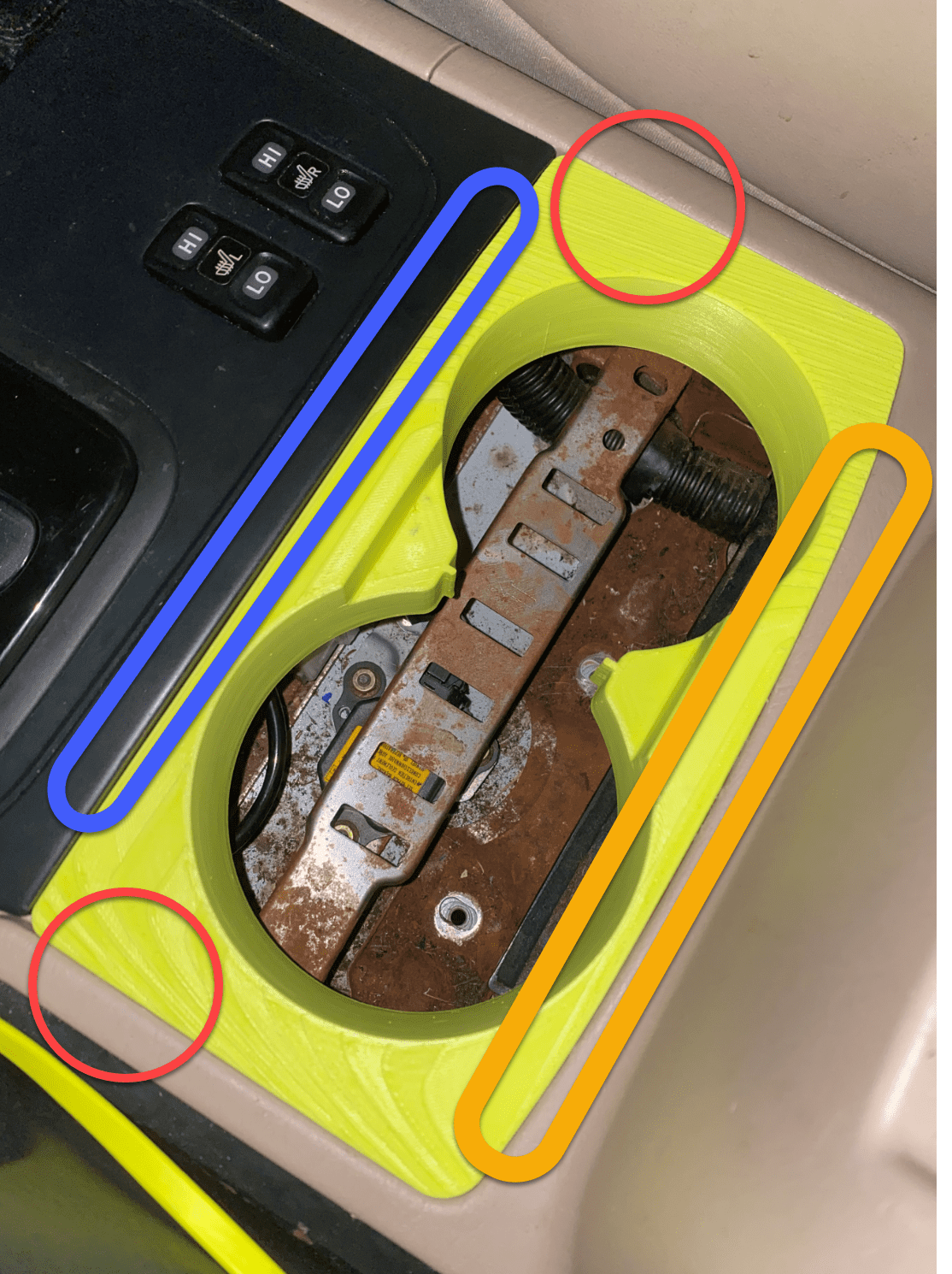

Update on the cupholder:

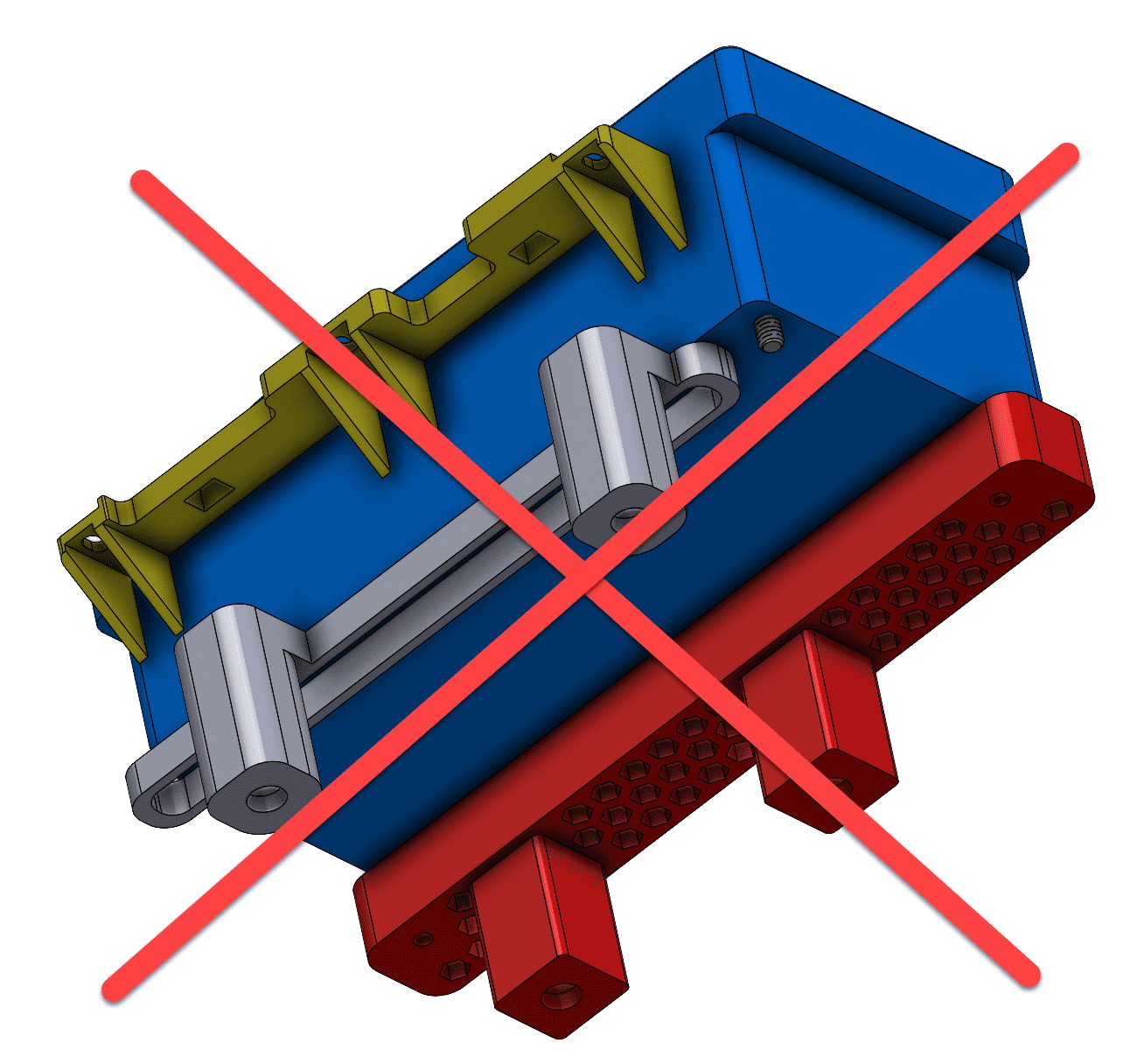

I scraped the previous plan that the cupholder is fixed to the vehicle through two brackets. Too many holes need to be aligned and the installation will be very difficult.

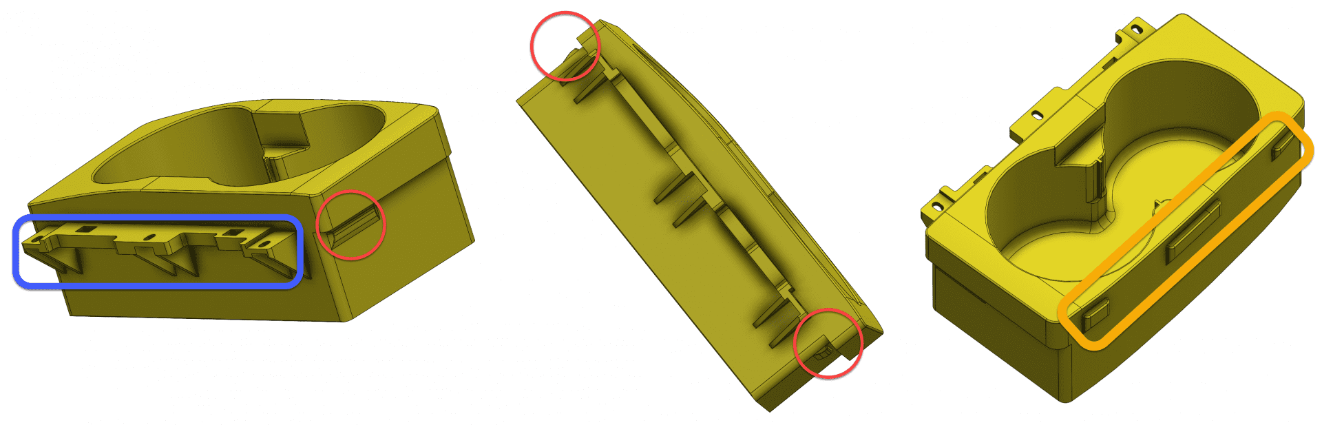

New plan is to use snap fit. Bump circled in red go under the left and right side of the center console. Bumps circled in yellow go under the back side. The backet circles in blue go under the shifter panel.

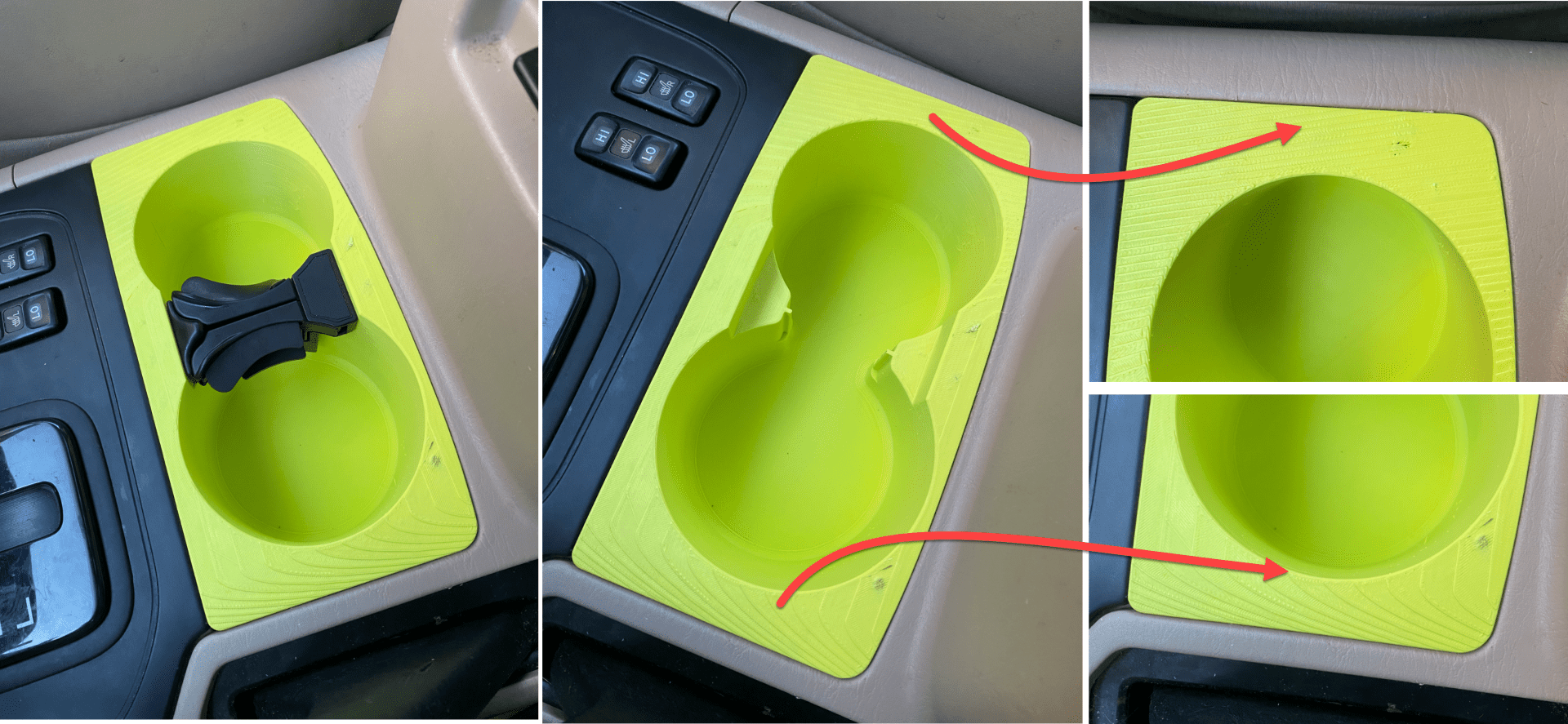

The prototype has a very secure fit with the factory panels. And the installation is much easier.
