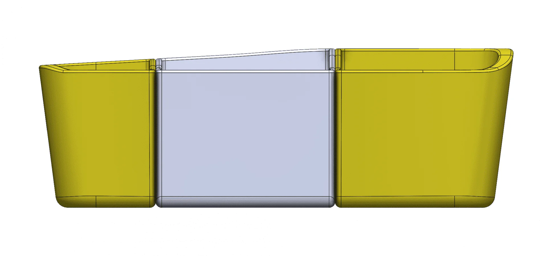

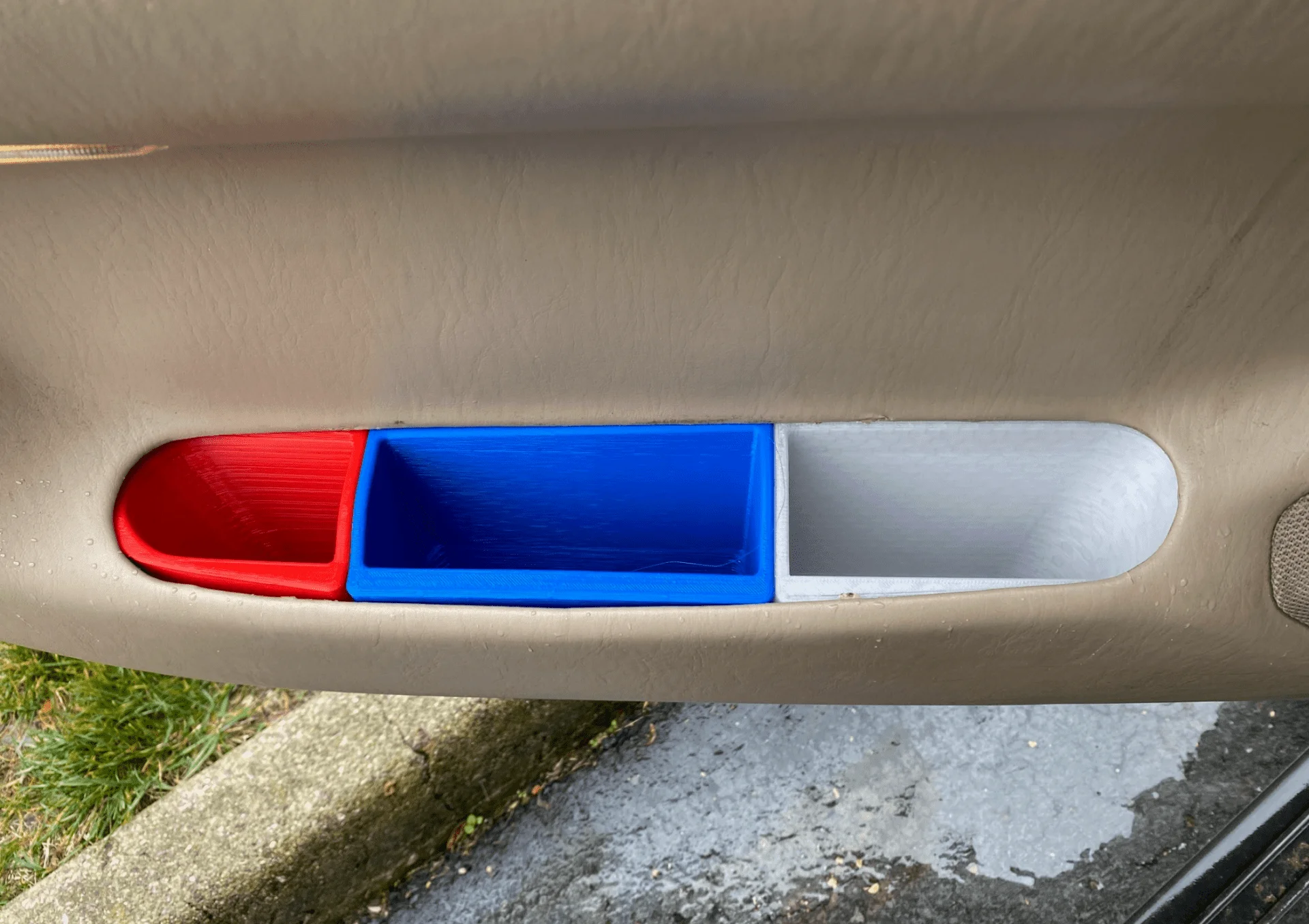

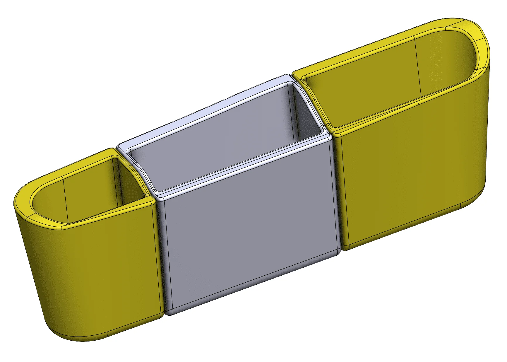

I'm super interested in those door pocket inserts, particularly for the driver side, glad to see you're working on it!
Agreed. In for some door pockets as soon as they're done.

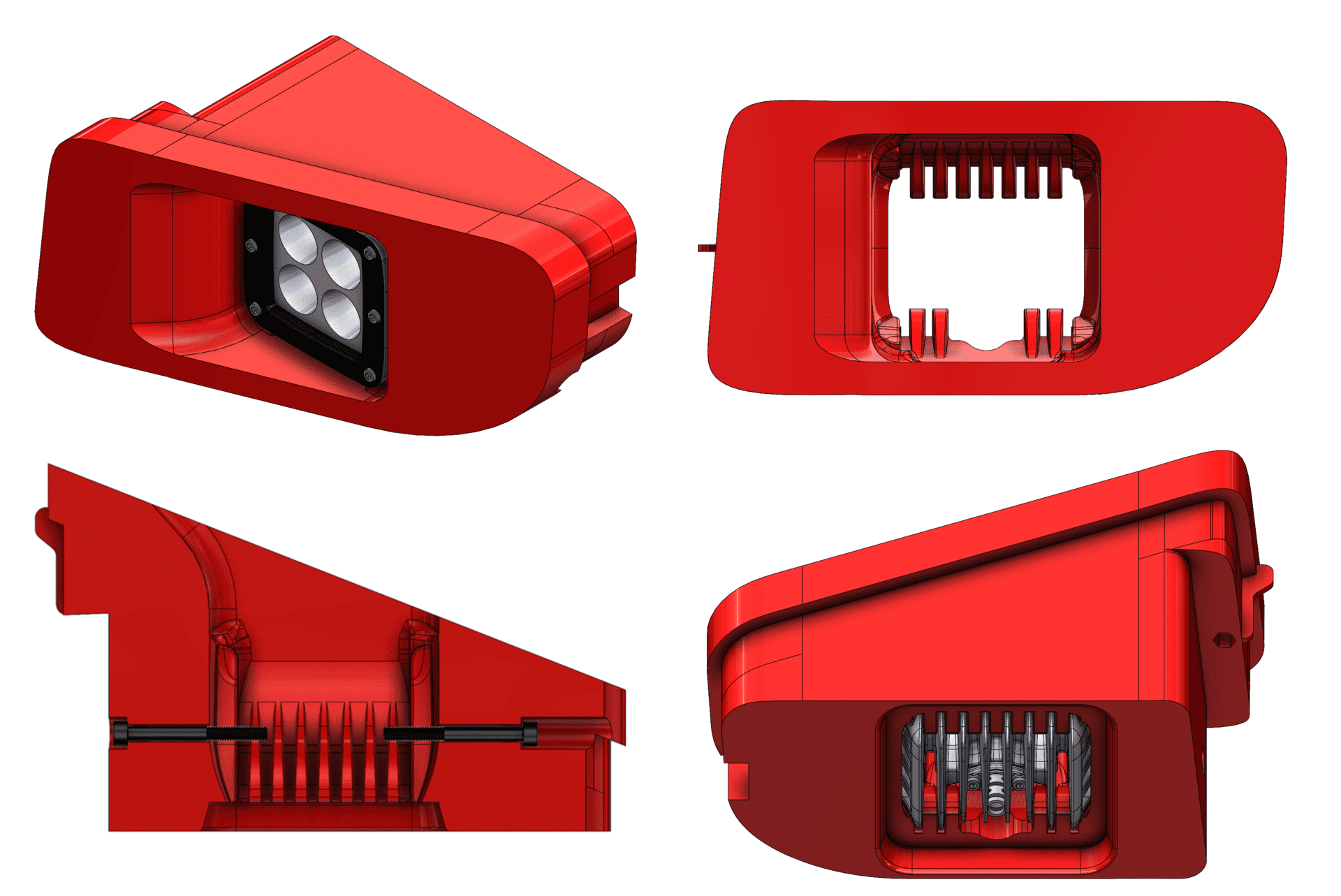

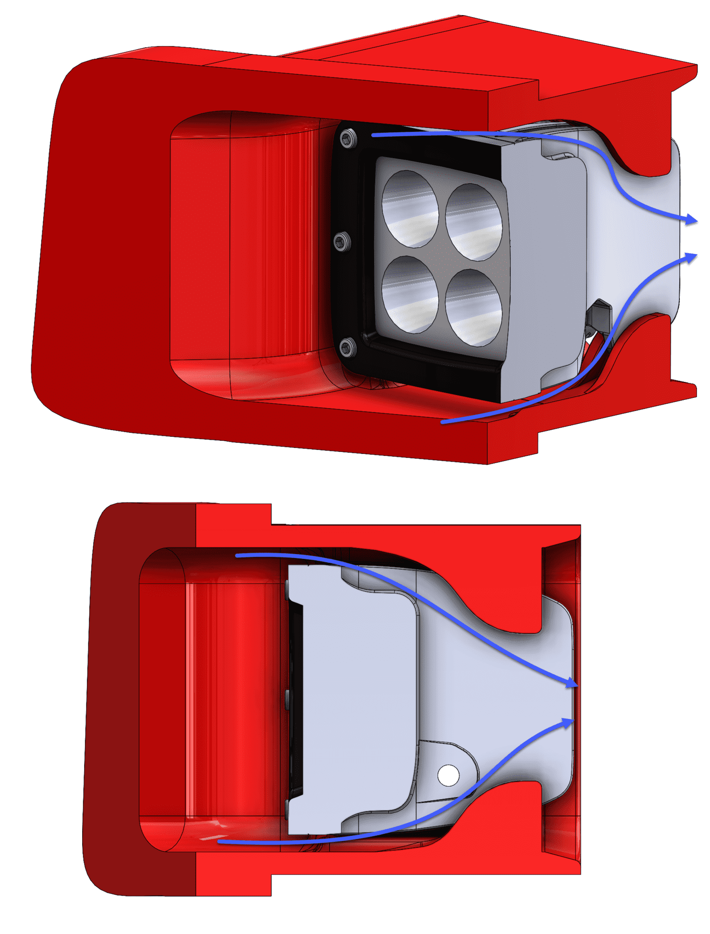

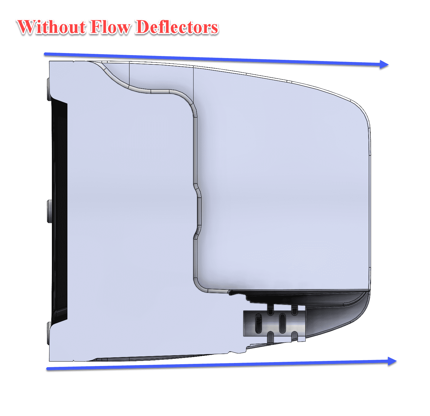

I changed the design to only mount one Rigid Industries D2 light instead of two. Mounting two is still possible but the wall thickness of the mount is pushed to several millimeters. I will explore the design for two D2 lights later. The major distinguish feature is the embedded flow deflectors. Without the deflectors, air would just pass the heatsink fins. I used to put D2 lights in confined space and they heat up quickly. With the deflectors, air should be directed to cover larger area of the heatsink fins.
Plan is to print in ASA material (good weather and UV resistant) and mount on my truck for several weeks and keep improving before being released.
Please feel free to comment and critique.

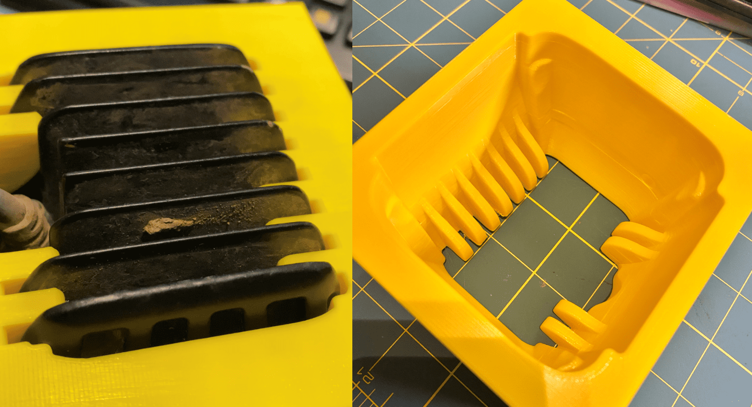

A test print:

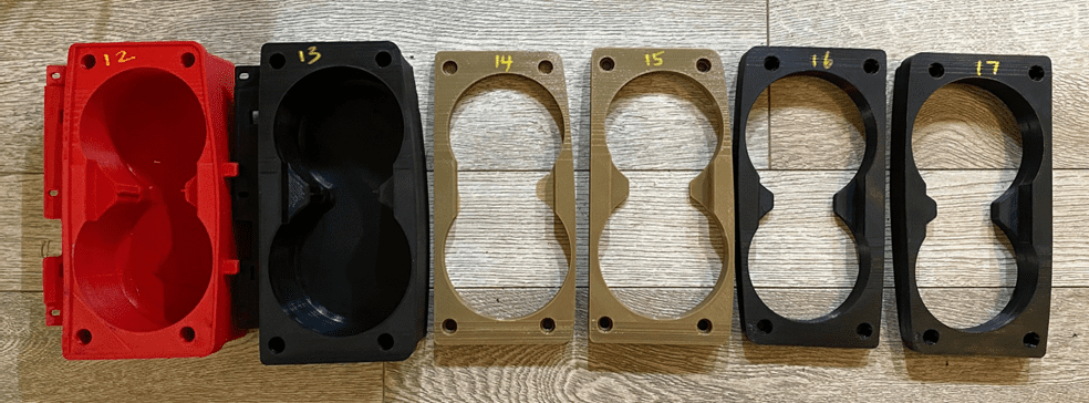

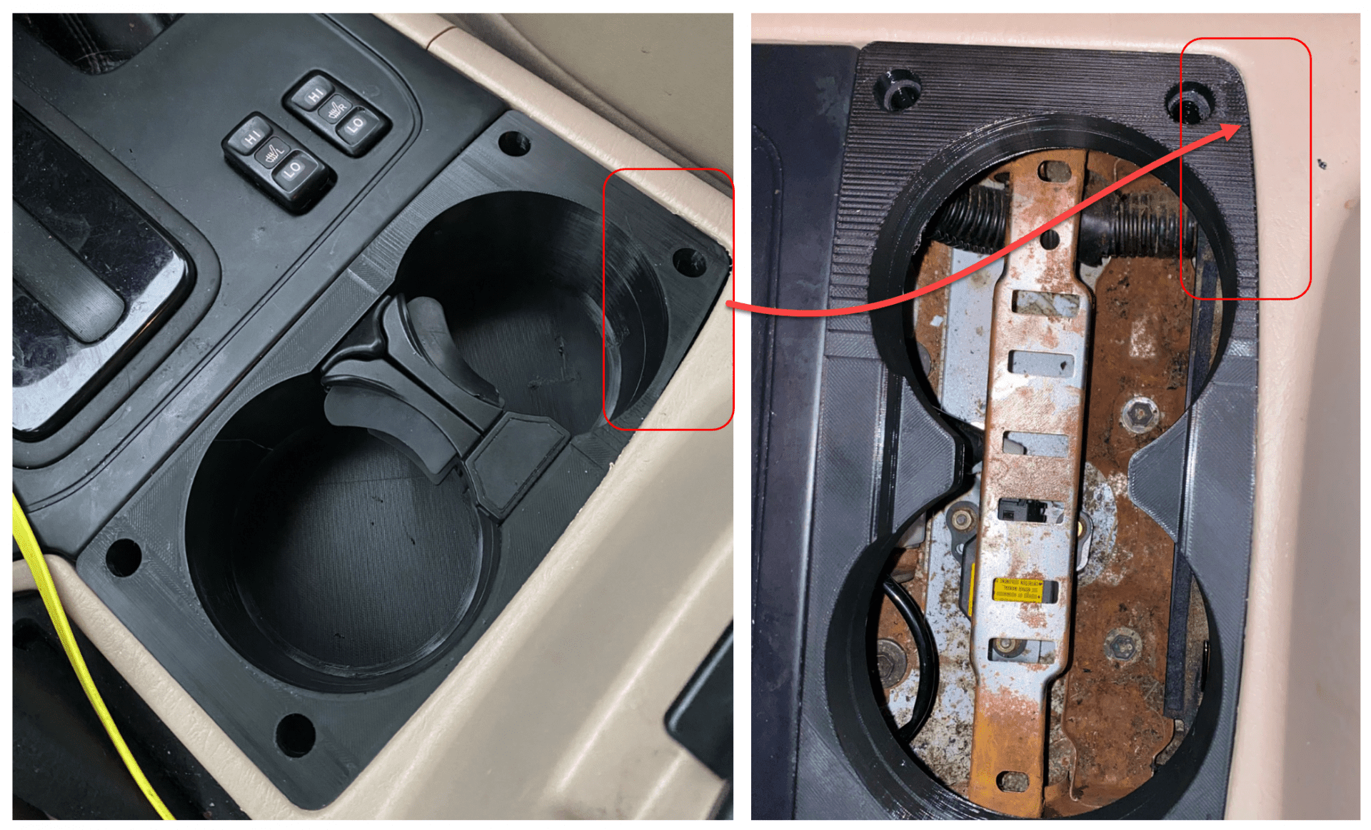

Did several design iterations this weekends:
Gap is almost closed.
The clearance between the bottom of the cupholder and the steel bracket is adjusted.
Sorry for the rust haha.
This is part of the iterations:
I want them to experiment winter cold and salt hahaWhen are these going to be available? I’m deffinately interested.

Do you think Baja Designs Squadron Lights with fit?Some update on the foglight mount.
A test print:

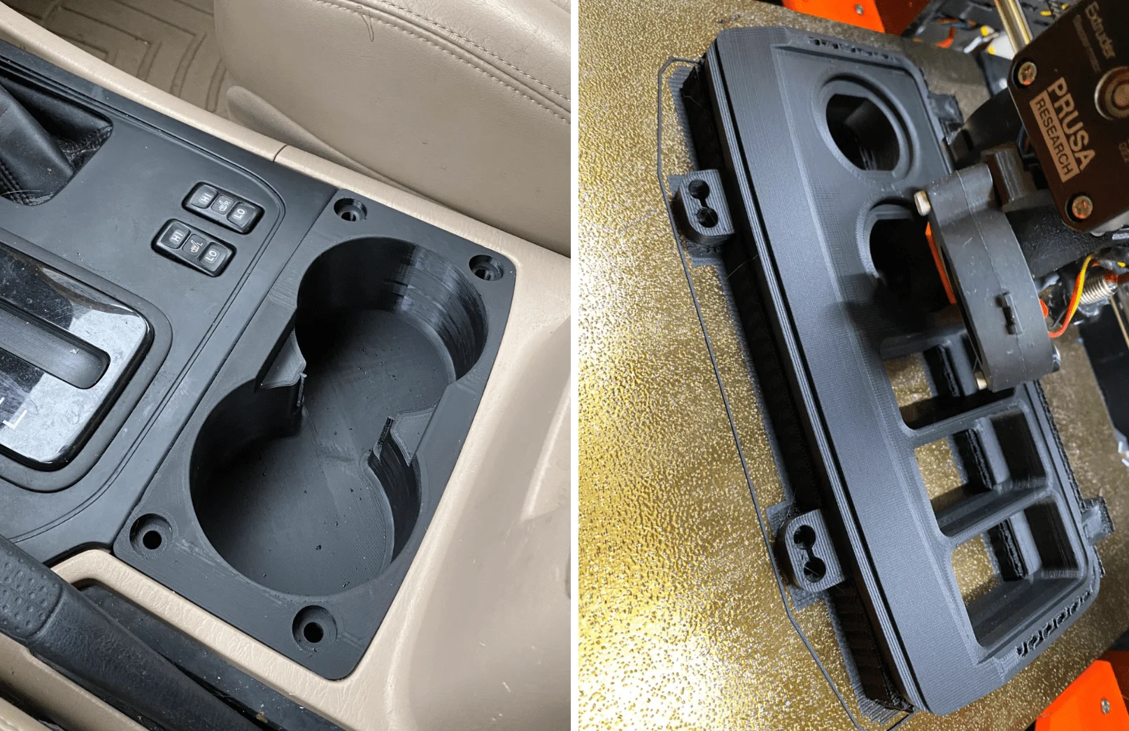

It reuses the butterfly. ( Can have a version that does not use that.)Hey Ben... could you recap what the new cupholder improves, keeps, etc.
- It looks like it reuses the OE pinball flipper things that are supposed to secure the cups - correct?
- Deeper?
- Larger diameter, i.e. holds bigger mugs, etc?
- Eliminates fold-down lid?
- Four holes remain, e.g. not a press-fit piece, the cupholder requires the four screws.

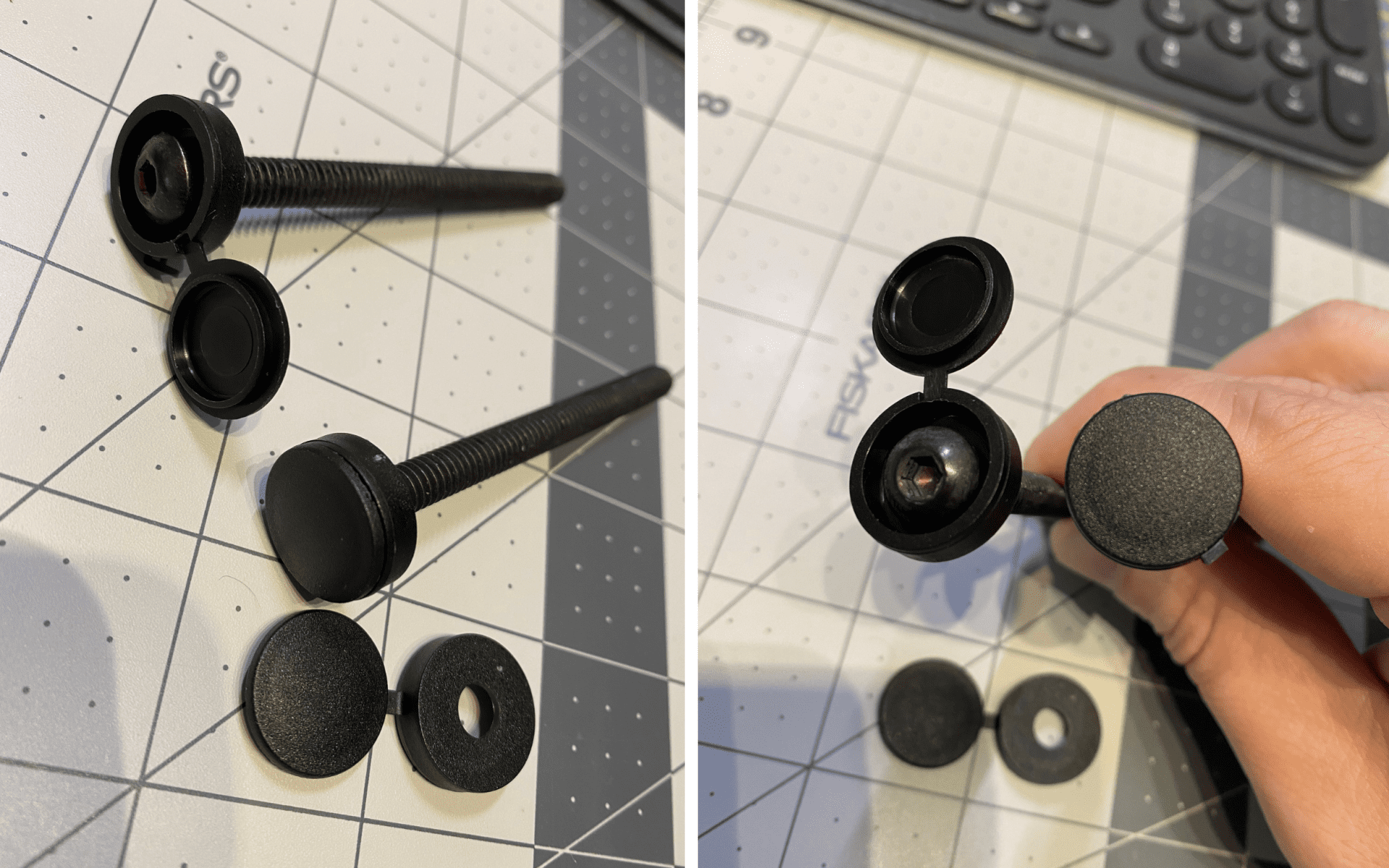

Yes have plugs. Will upload pic later today.Trivial question about the cupholder: the four holes on each corner are to screw it down ? Is there a sort of plug to go on top to make it look less industrial ?
