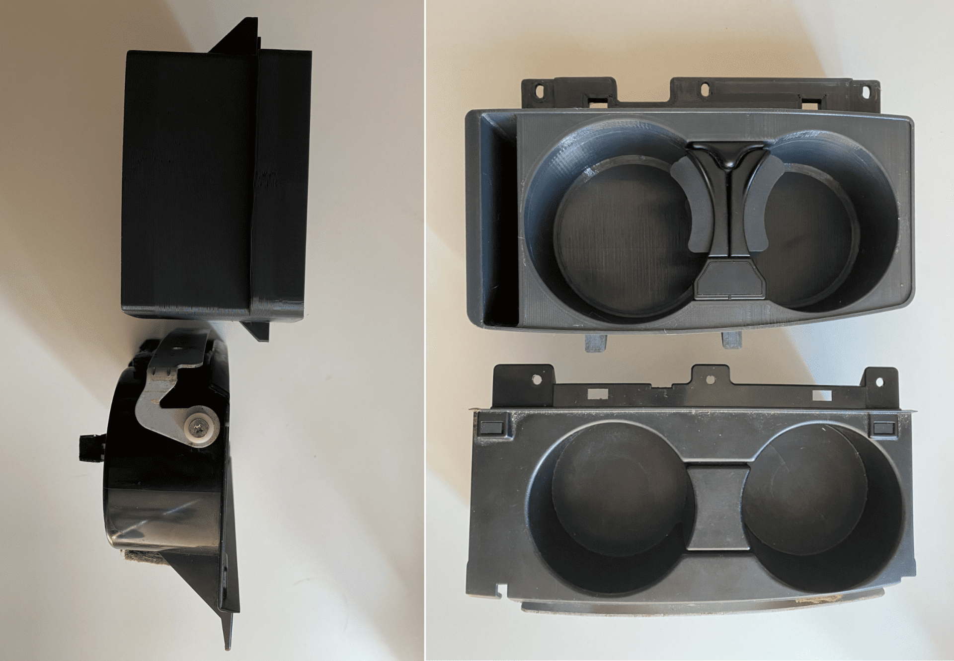

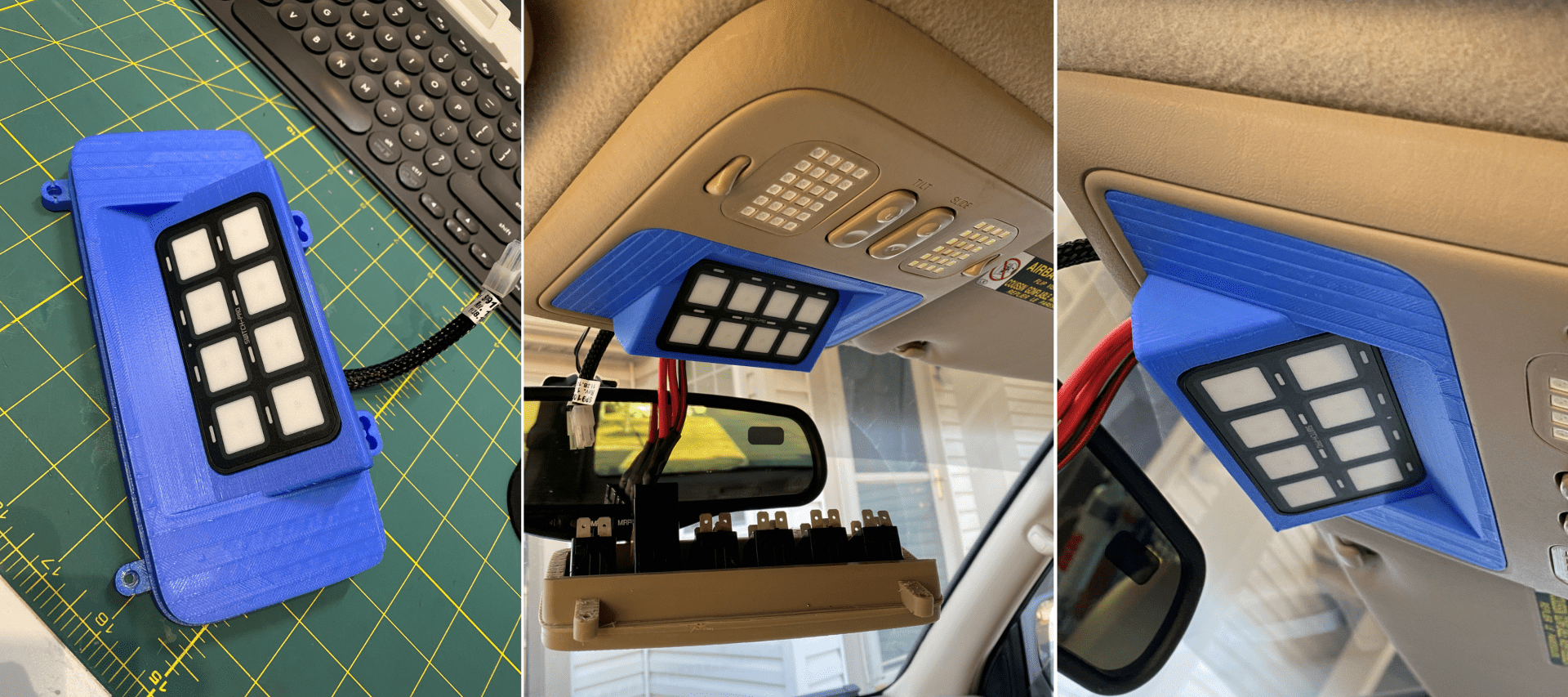

Finally a guy trust me with his switch-pros. Thanks @Trail Rated.
This is the prototype. The print lines is caused by very thick layers (0.3 mm) for fast print. Final product will use a dynamic layer thickness from 0.3 mm to 0.05 mm.
I already bought the 6 switch, but this is looking good enough, I might have to go this route instead!
This goes out today to @gregnash for evaluation.
Material is not the one I would use on the final product. I just grabbed what was available. I am planning to use a matte finish black material, probably carbon fiber PETG.

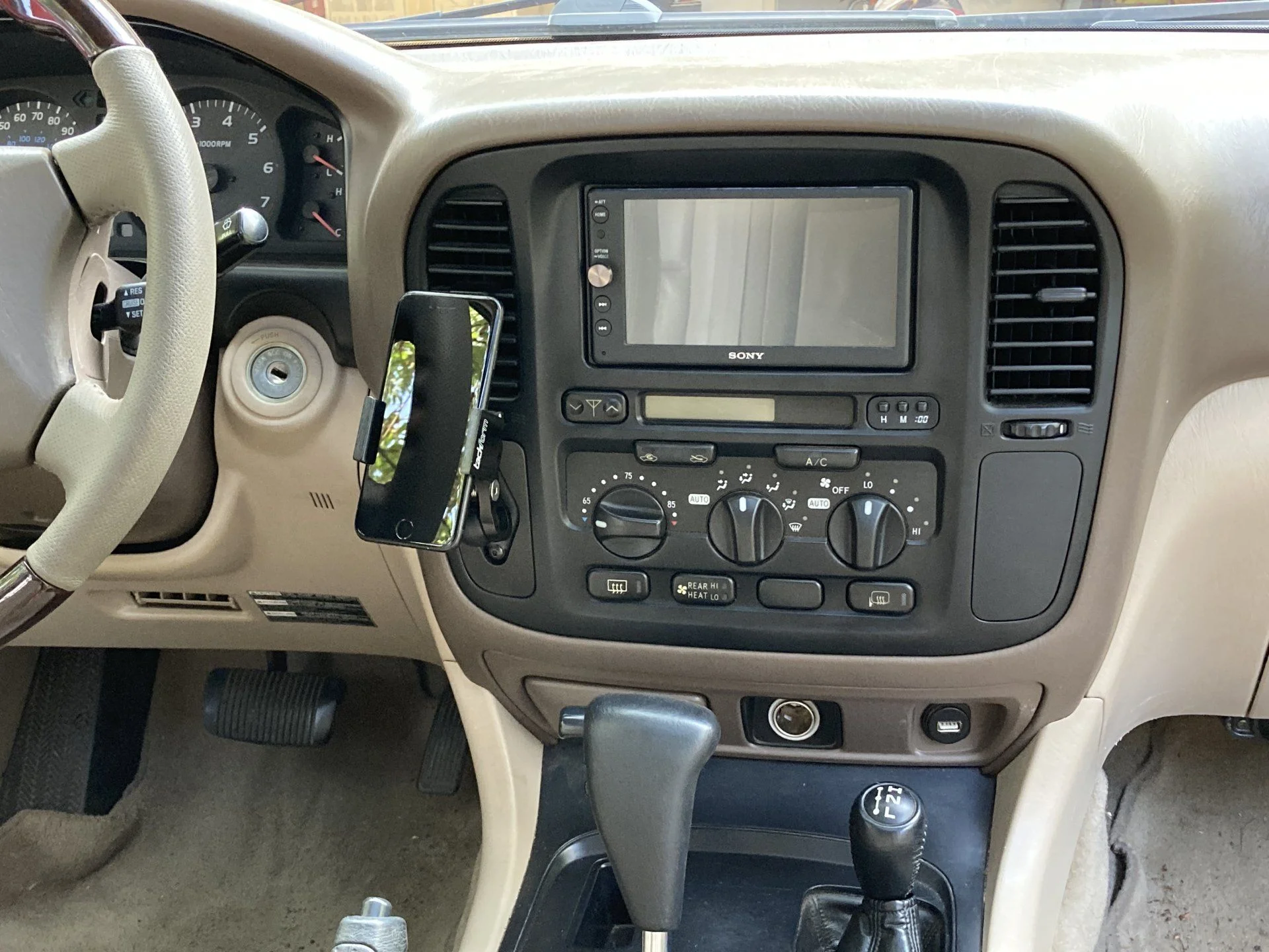

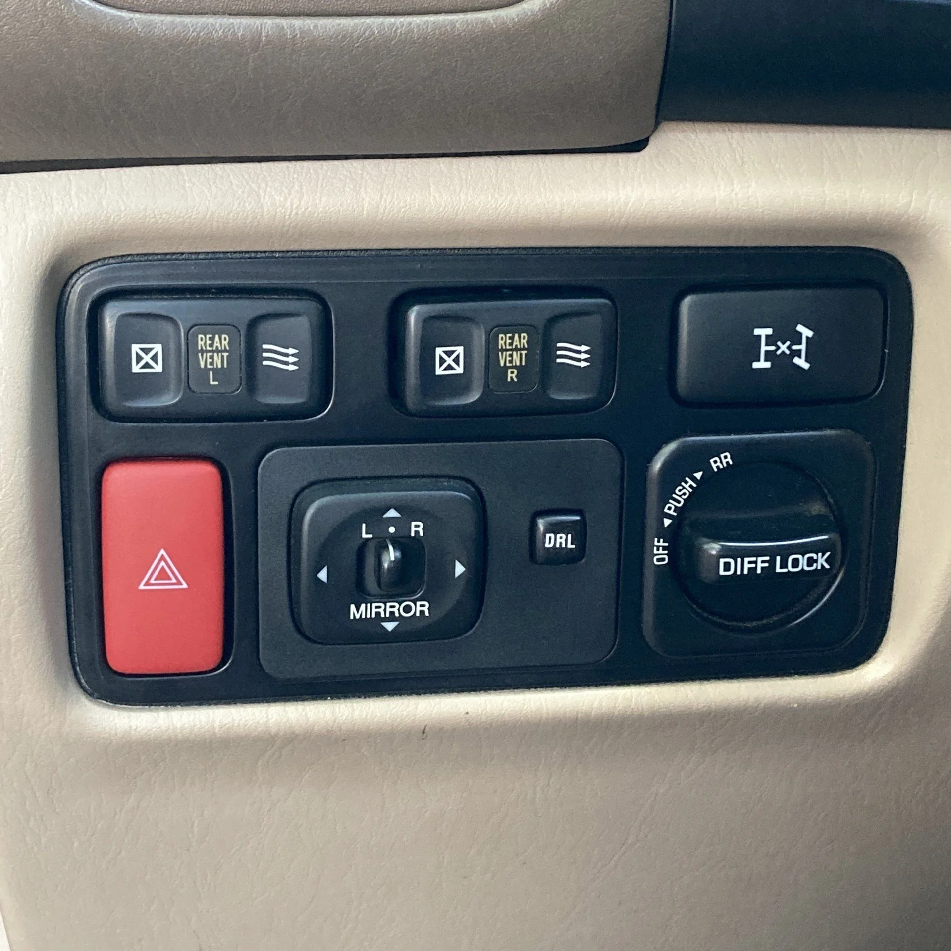

Installed @BenCC’s M2V2 Left Ram Ball mount and a phone holder. Relocated my Hazard and CDL switches to the left side panel. More complicated than it seems... had to re-wire some stuff, add a relay, and modify the internals of the new CDL switch to be push-on/push-off instead of momentary.
View attachment 2367672View attachment 2367673View attachment 2367674
Hazard switch P/N is 84332-26120, CDL switch P/N is 84725-35050.
Ball arm is:
Phone holder is:

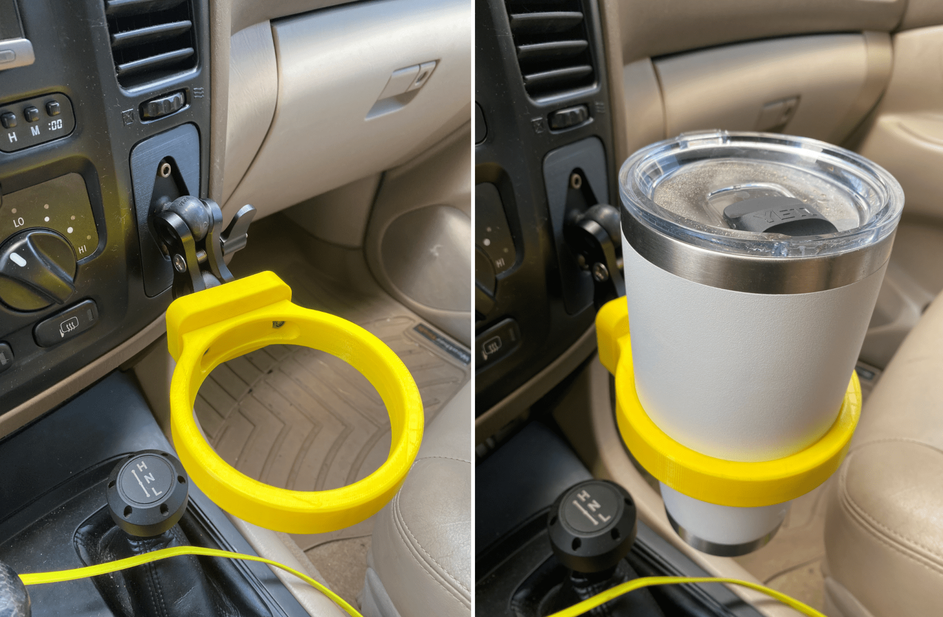

I finally got time to get proper shots of the M2V2 kit. This is available via @BenCC on ebay or YotaMD's webstore. We split revenues the same either way so take your pick!
