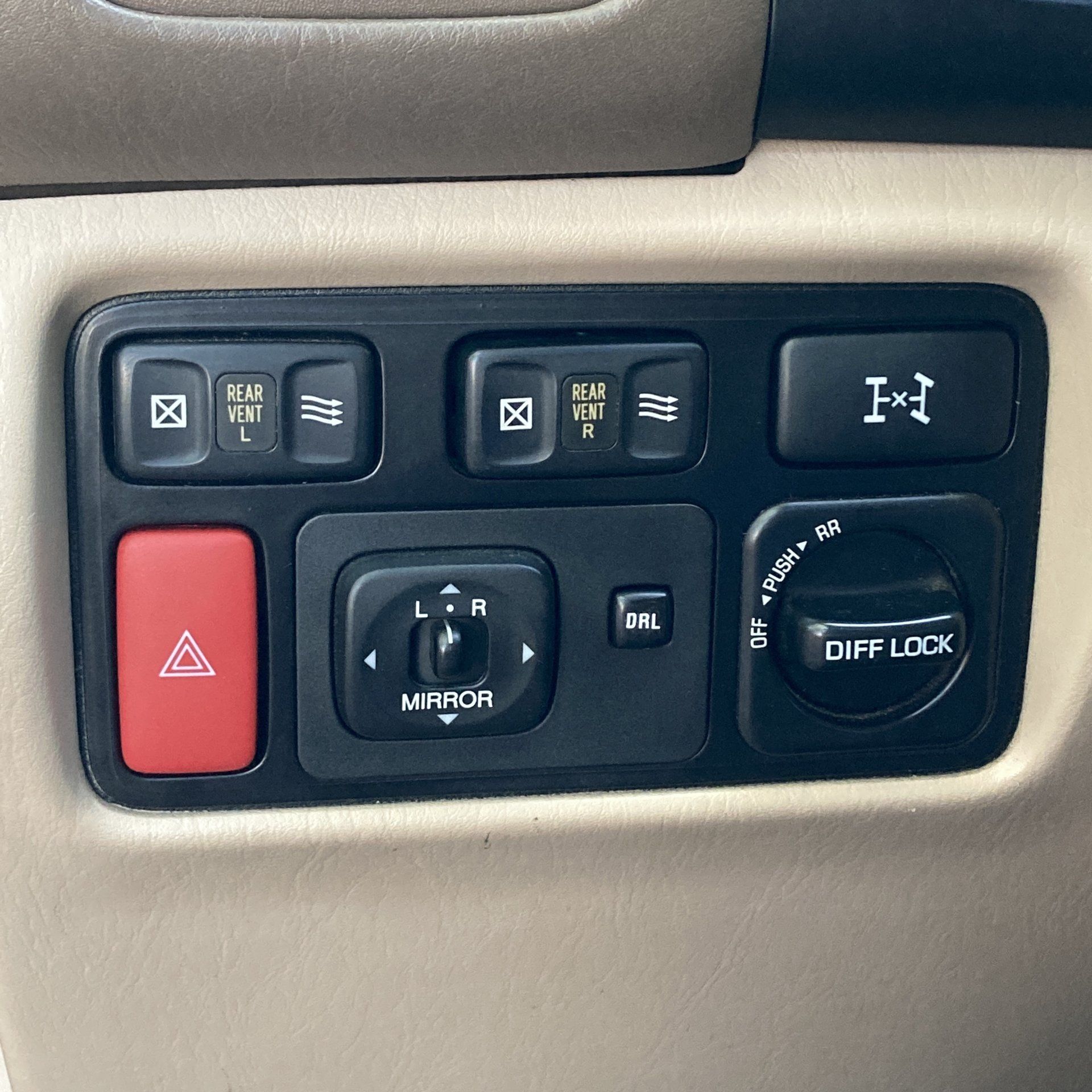

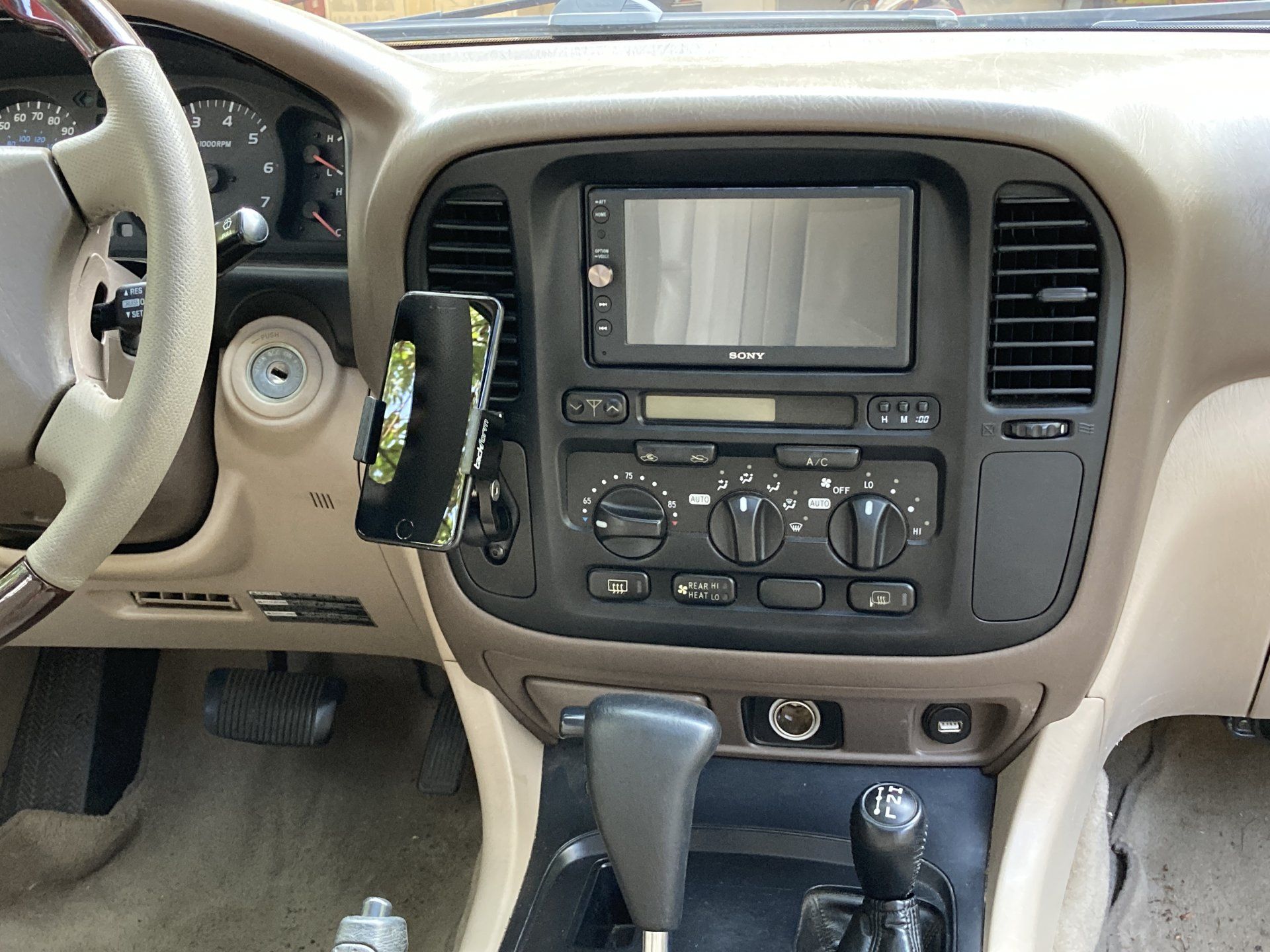

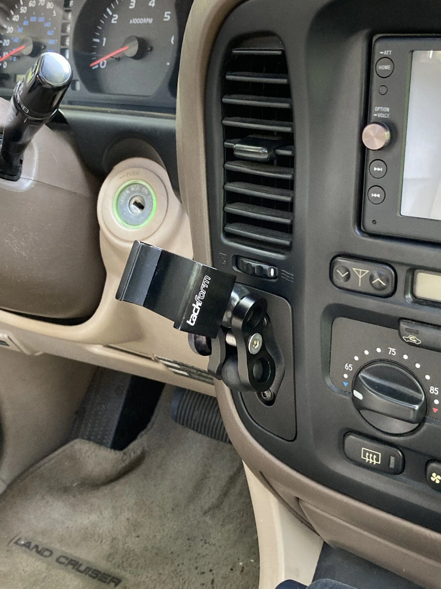

Installed @BenCC’s M2V2 Left Ram Ball mount and a phone holder. Relocated my Hazard and CDL switches to the left side panel. More complicated than it seems... had to re-wire some stuff, add a relay, and modify the internals of the new CDL switch to be push-on/push-off instead of momentary.
Hazard switch P/N is 84332-26120, CDL switch P/N is 84725-35050.
Ball arm is:
Phone holder is:
View attachment 2367672View attachment 2367673View attachment 2367674

I have the same phone holder! The arm looks good, added to my cart.

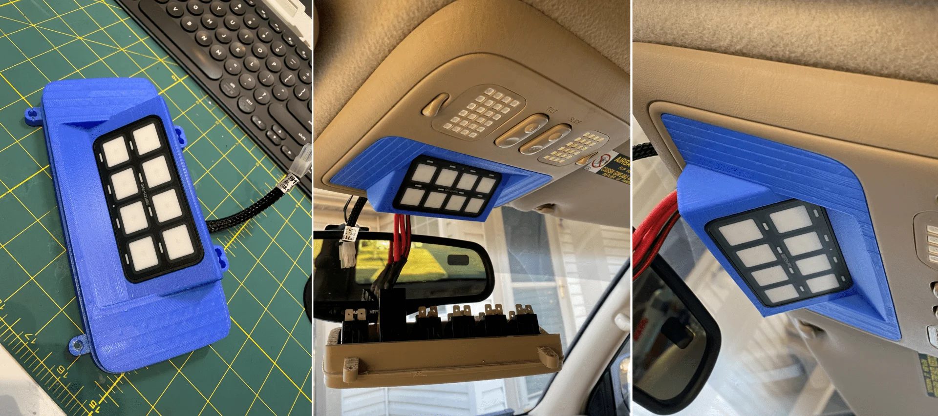

IMO, RAM mount in the overhead console is not safe. The combined weight of the ball, arm, holder, phone/pad is too much for the location.

Any plans or considerations for the ram/mic mounts for us with 03+ trucks? Thanks Ben. Your'e work is phenominal
Oh i wasnt clear, i dont want a ram mount over head, i was hoping your design for the ashtray replacement would be a bank of switches like M4v3 and a ram mount on the driver side.
this could be a good option for the 03+ Crowd that has no obvious spot for an integrated ram mount like early 100s
No plan for 03+ trucks. Sorry. Let me know if you can find a proper place for the RAM ball.
Maybe an air vent clip? Could be a lot of weight on that one stress point though... could be suitable for a radio clip though

Finally a guy trust me with his switch-pros. Thanks @Trail Rated.
This is the prototype. The print lines is caused by very thick layers (0.3 mm) for fast print. Final product will use a dynamic layer thickness from 0.3 mm to 0.05 mm.
