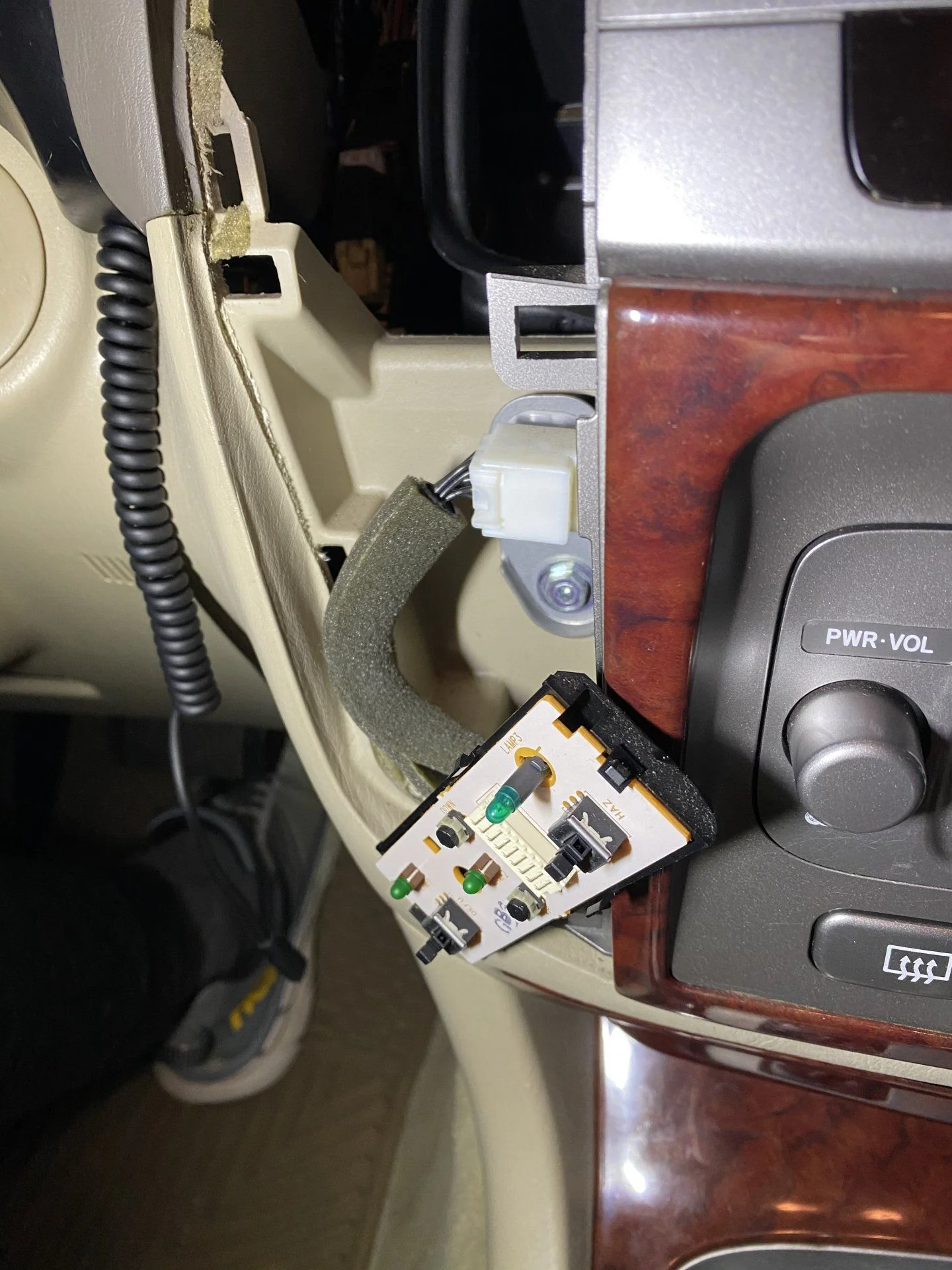

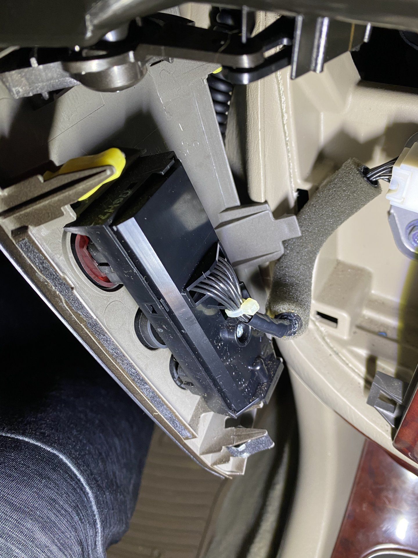

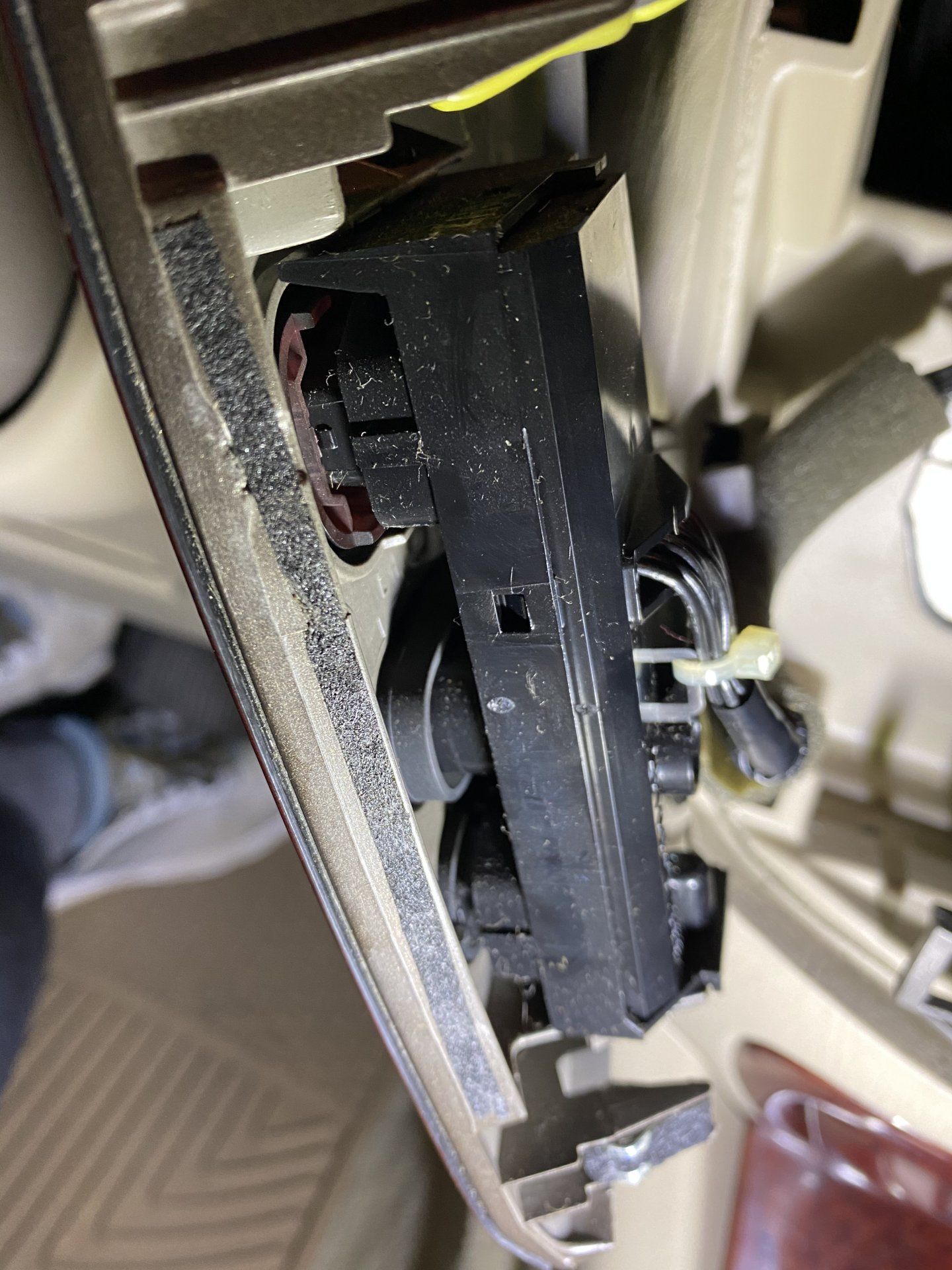

Finally got to taking this apart last night. On my 06 model, that panel is 1 big piece. Here are some photos of what's behind it.

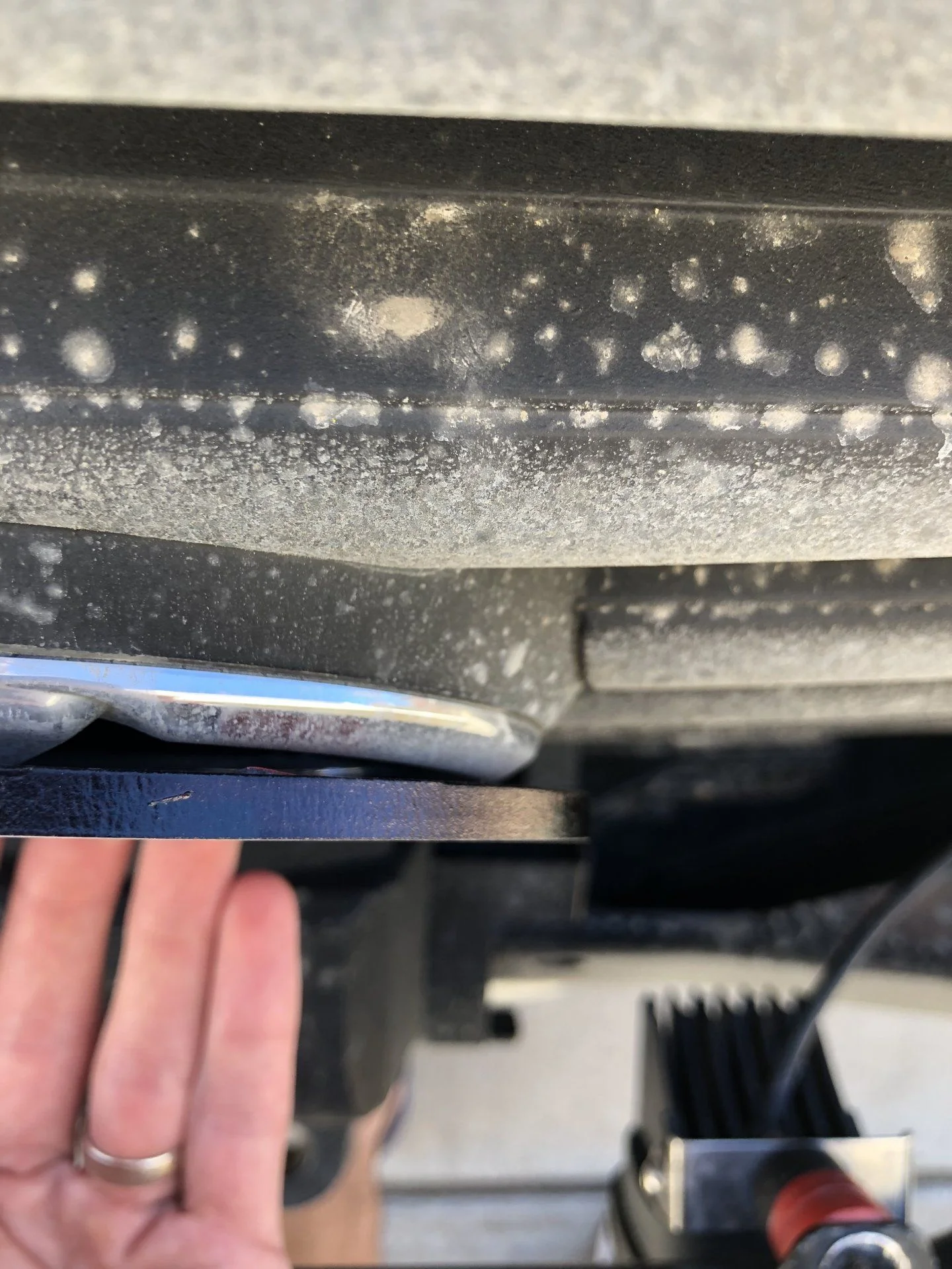

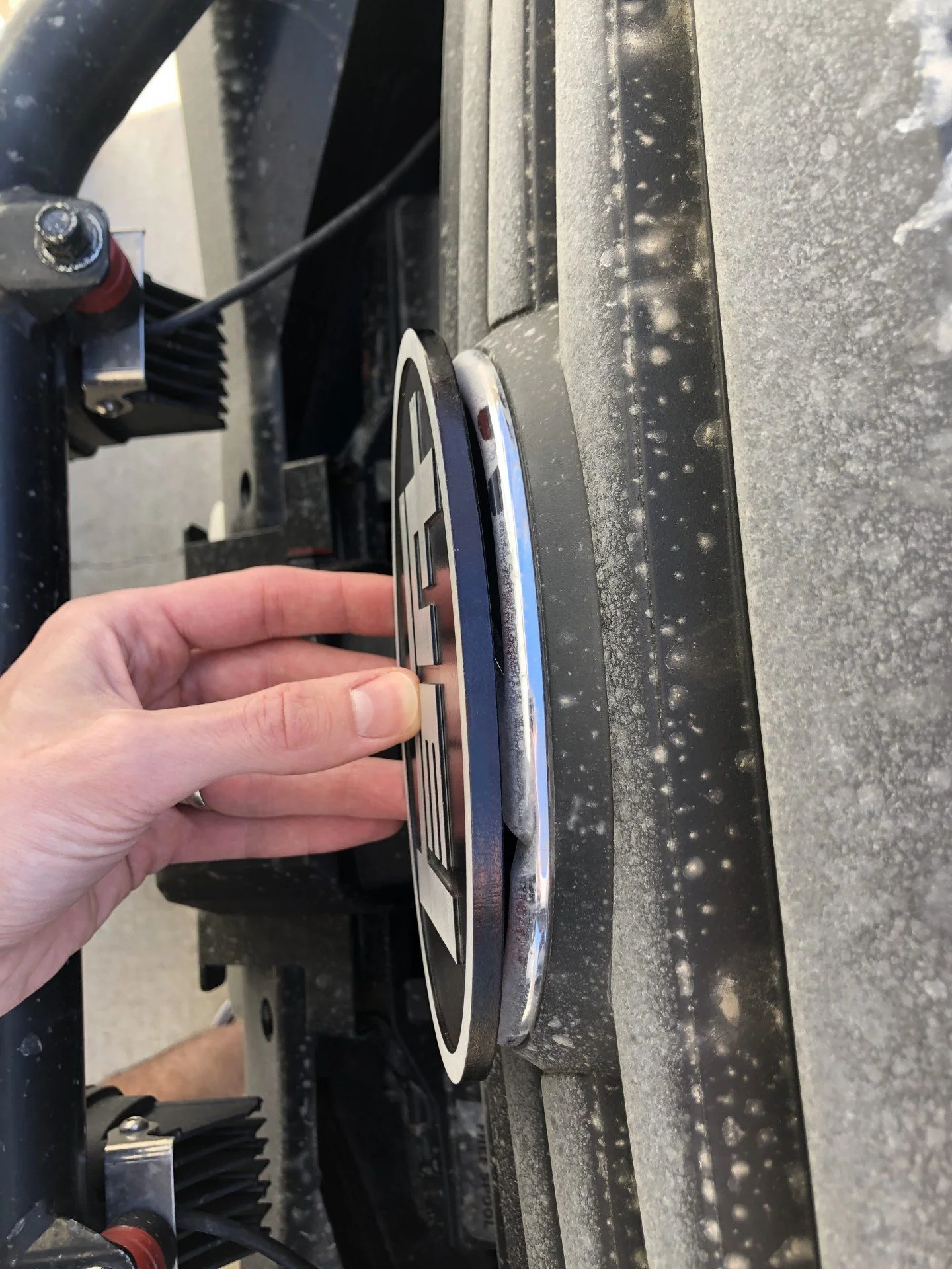

@BenCC I sent you an email, but figured I'd post here too. I ordered a TEQ badge for my 06 LX, and I'm not sure it'll fit. I haven't taken the "L" badge off yet, but just placing the TEQ badge on top it seems quite a bit larger. Is it supposed to be like this?

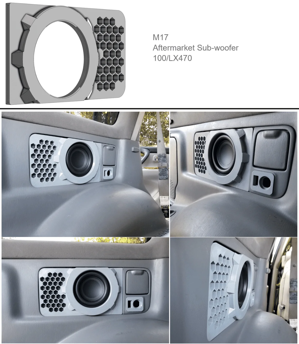

I made this subwoofer cover a long time ago.

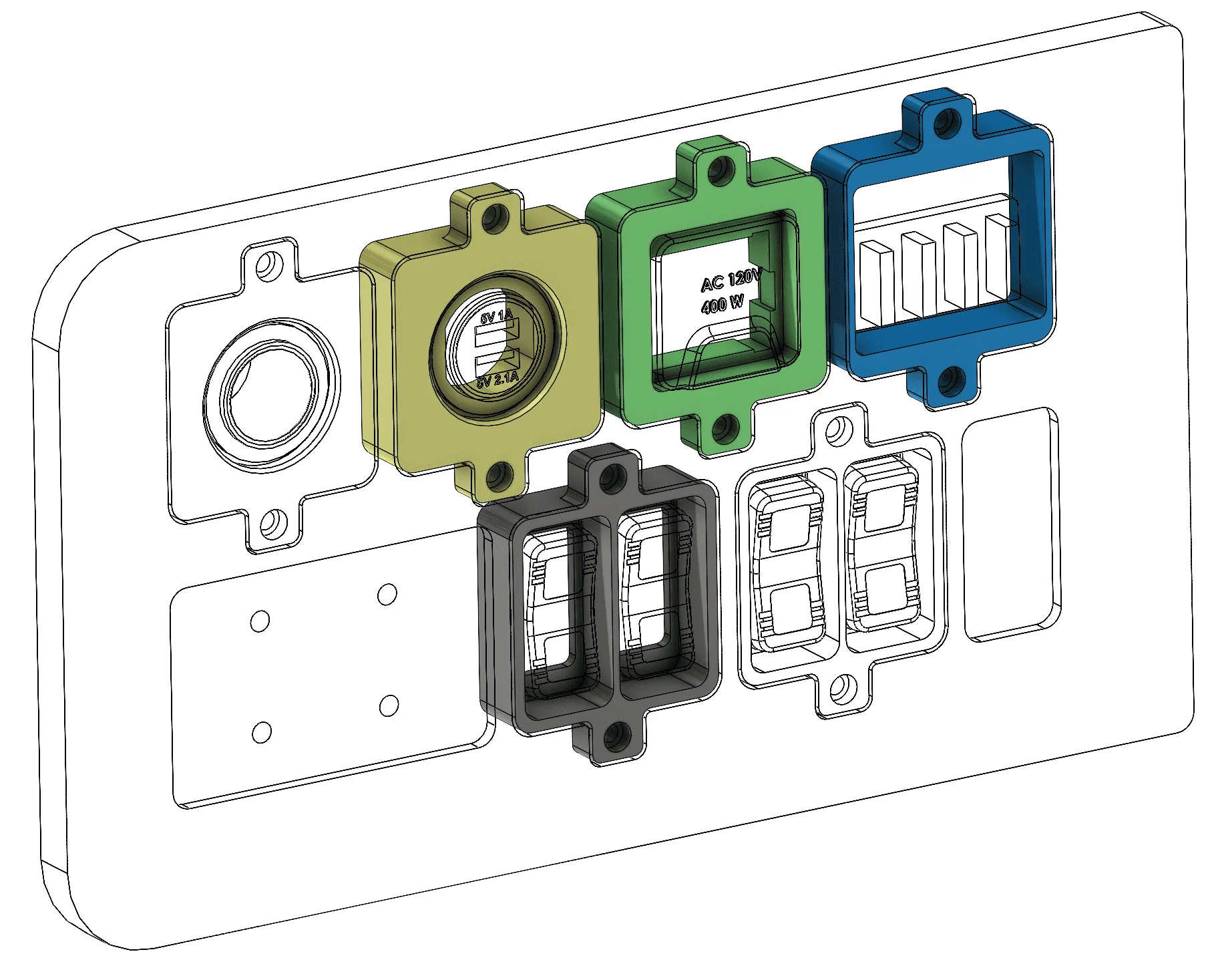

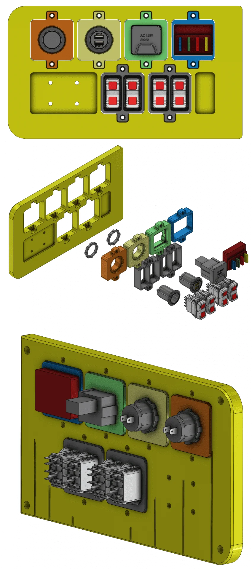

Someone asked me to convert the panel to a power distribution terminal. It only works if you have removed the factory sub. Here are a few sketches. Let me know what you guys think. Thanks. Also I am thinking to use this modular desgin on the ashtray replacement.
I wanted to make a modular design so the panel could be configurated for different needs. On the bottom left corner, it is a 4-hole AMPS pattern (What is the 4-Hole AMPS Pattern? - https://motogps.com.au/blog/what-is-the-4hole-amps-pattern/).
Four types of modules. Curretly I have modules for 12V socket/USB, 120V socket, fuses, switches.
