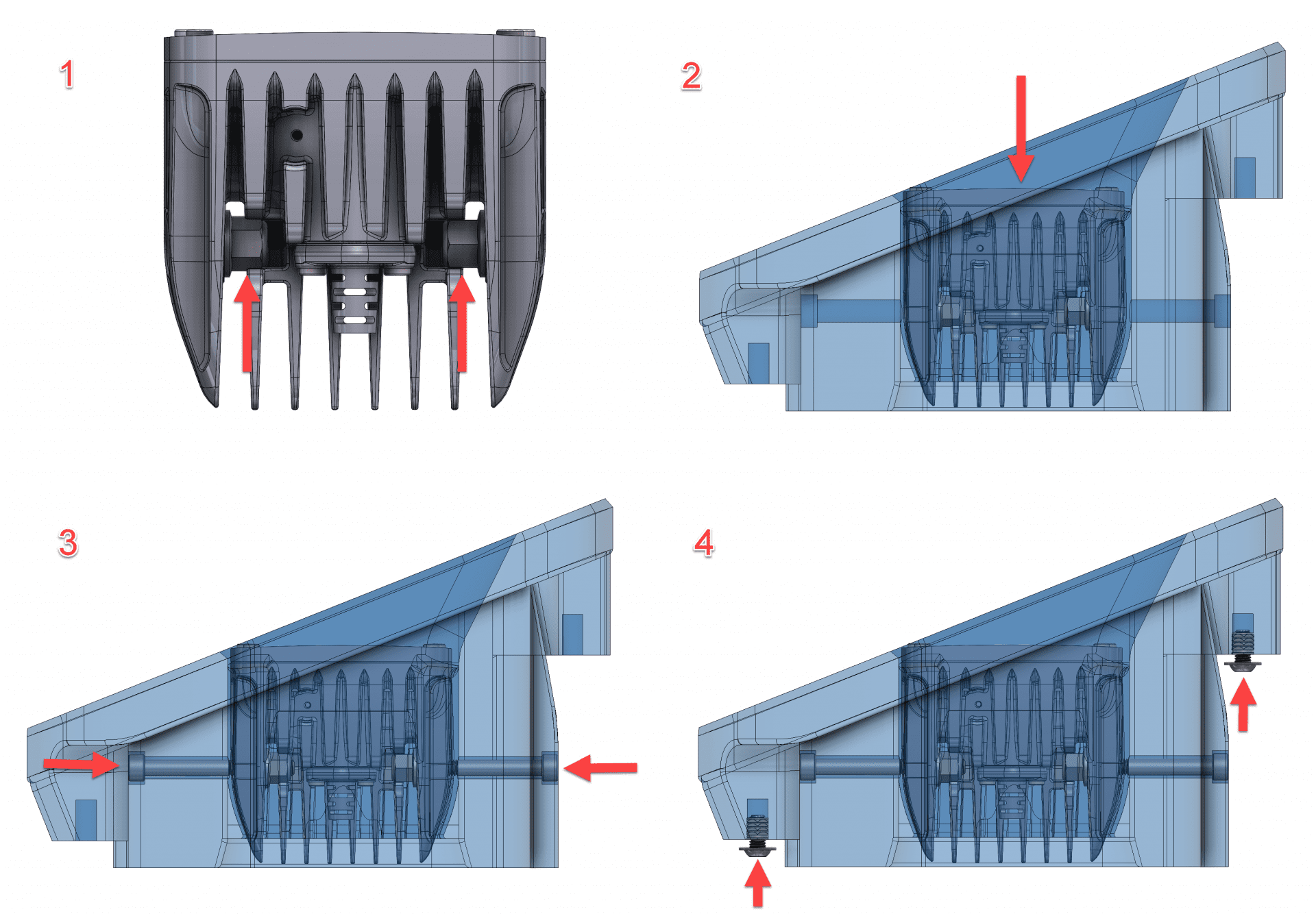

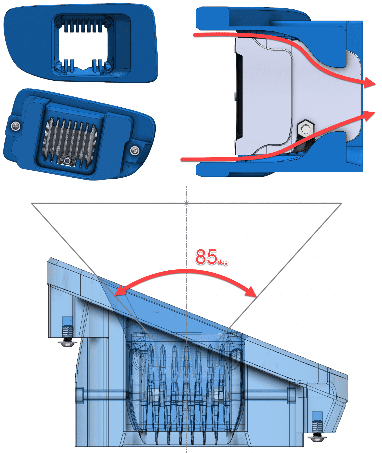

The fin/teeth structures are designed to force air to flow through the heatsink. The fin/teeth structures are not necessary for D2 lights to work. But for 3d printed parts, it barely adds to the fabrication cost. D2 fog lights are recommended. The mount is designed to accommodate the wide light pattern (85 deg).

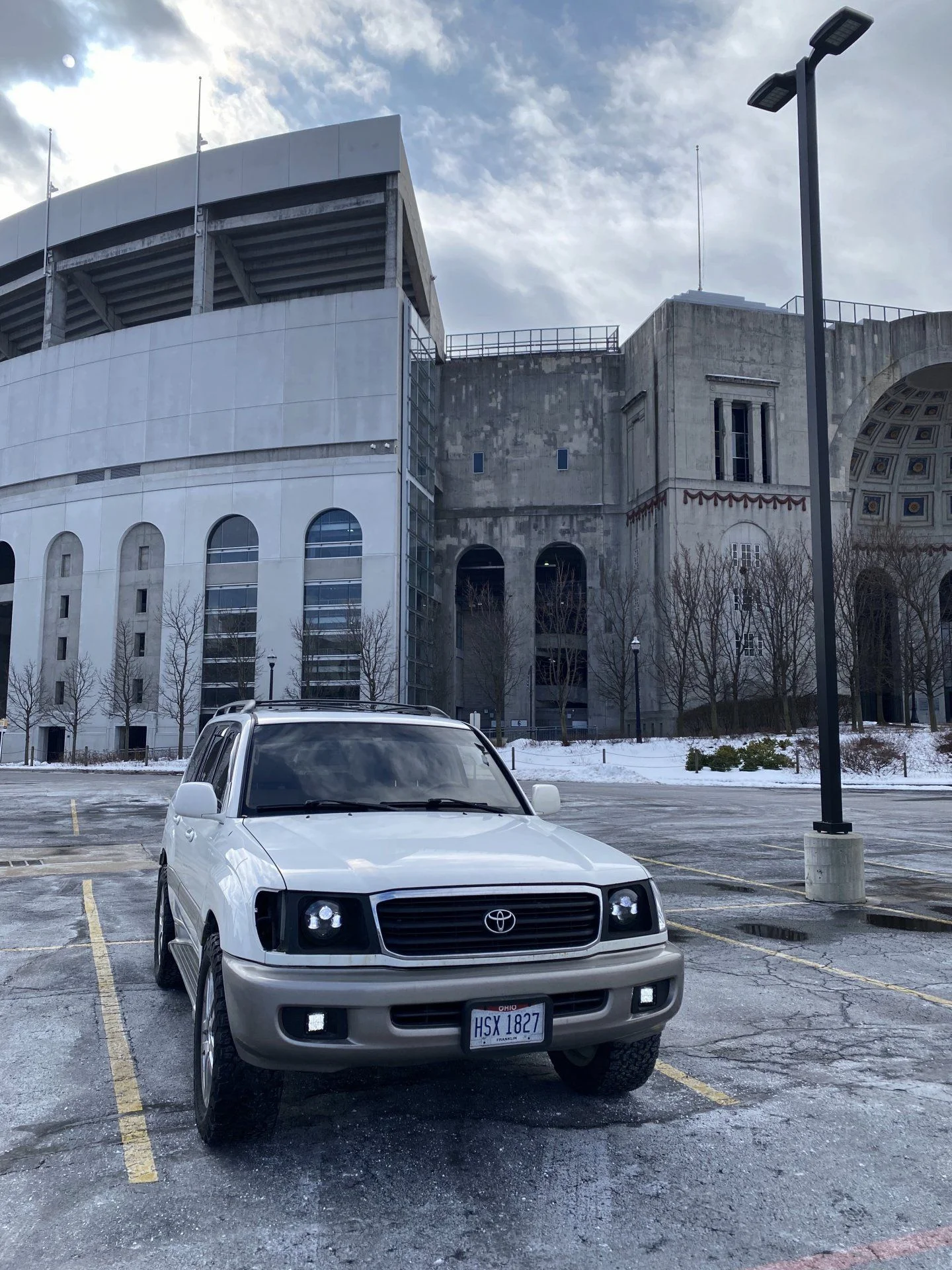

Would you say this is a big improvement over stock fogs? Hard to tell and I've had zero hands on look at any Rigid lights.

I didn’t not realize there was a difference. I’m in for a set of LX ones. I just drove through snow at night with the factory fogs and was decided on this upgrade

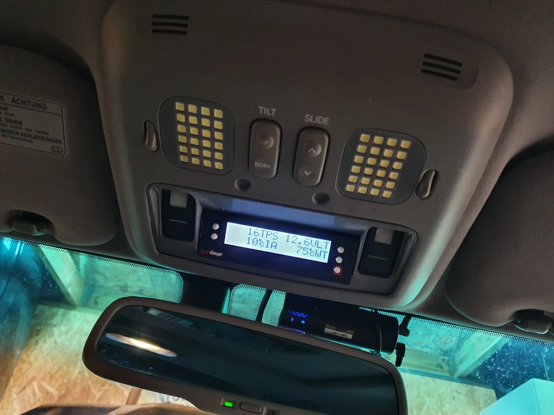

Removed my audio head unit this morning. Want to do something like this with scangauge and radio or something elese. This is only to show the idea.
