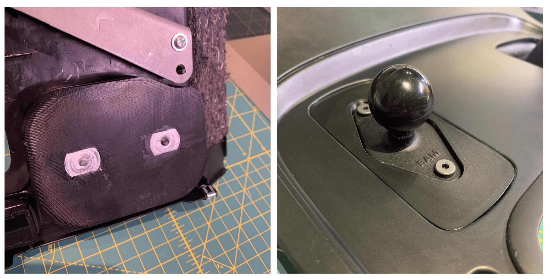

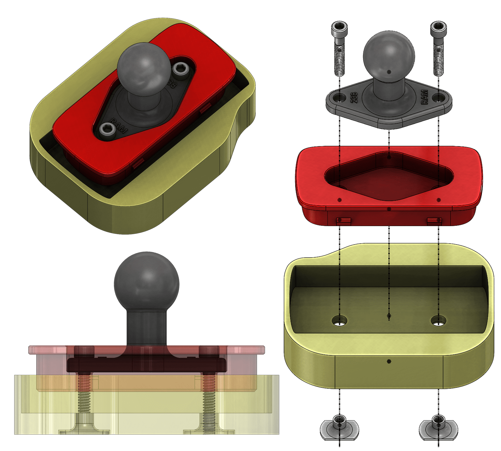

The original pocket cover only snaps into the main panel. If you fix a Ram ball mount directly on the original cover, with some load like an iPad, it tends to pop out. With this two-piece design, we should have a more secure fixture.
3 Design and Fabrication
The fasteners used will be provided. For reference, they are listed here.
Steel Narrow-Base Weld Nut
Alloy Steel Low-Profile Socket Head Screw, Black-Oxide, 10-24 Thread Size, 1" Long
Note: The measurement was taken on my 2000 LC. The pocket contour may be a little off from a LX. A little bit of sanding or trimming of the part may be needed.
