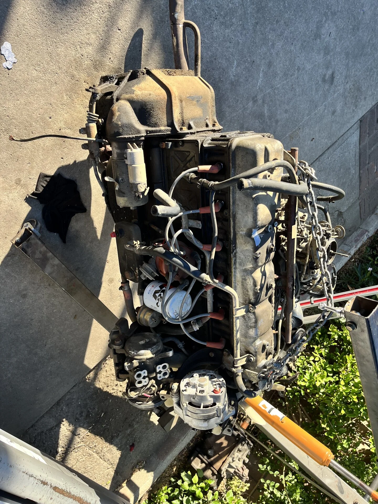

My upper bellhousing has a crack so I’m looking to source a good one. Thanks!

I was hoping no one would ask. The transmission was on a transmission jack (a cheap one from harbor freight because I don’t plan on doing this type of work regularly) so it was fully supported. I was trying install it because I had just replaced the clutch. I couldn’t get it to slide in even though I had the holes on the transmission and bell housing aligned, so I tried “walking” it in by getting longer bolts that would reach the Bellhousing and slowly rotating corner to corner on tightening the bolts. The bolts got hard to turn at times but I figured that was because I was rolling the transmission towards the Bellhousing. I was in the middle of cranking one and heard a crack. I stared inspecting things and found a vertical crack that split a bolt hole where the lower cover attaches to the Bellhousing. I was really surprised this happened because I wasn’t using an extender, just a normal ratchet. It’s definitely a learning lesson though. I’ve had lots of this on this truck.

the trans should slide right in when aligned correctly
should be no need to use the bolts to pull the trans into place

I saw someone did this about 10 years ago and you supplied them with a new housing. That made me feel a tiny bit better about things.
I did something similar with a 22RE in a 2wd Mini truck. I used the bolts to walk it in and I broke the side braces of the bellhousing. I readjust the clutch and it slide right in and I had to find a brace in the junkyard.
